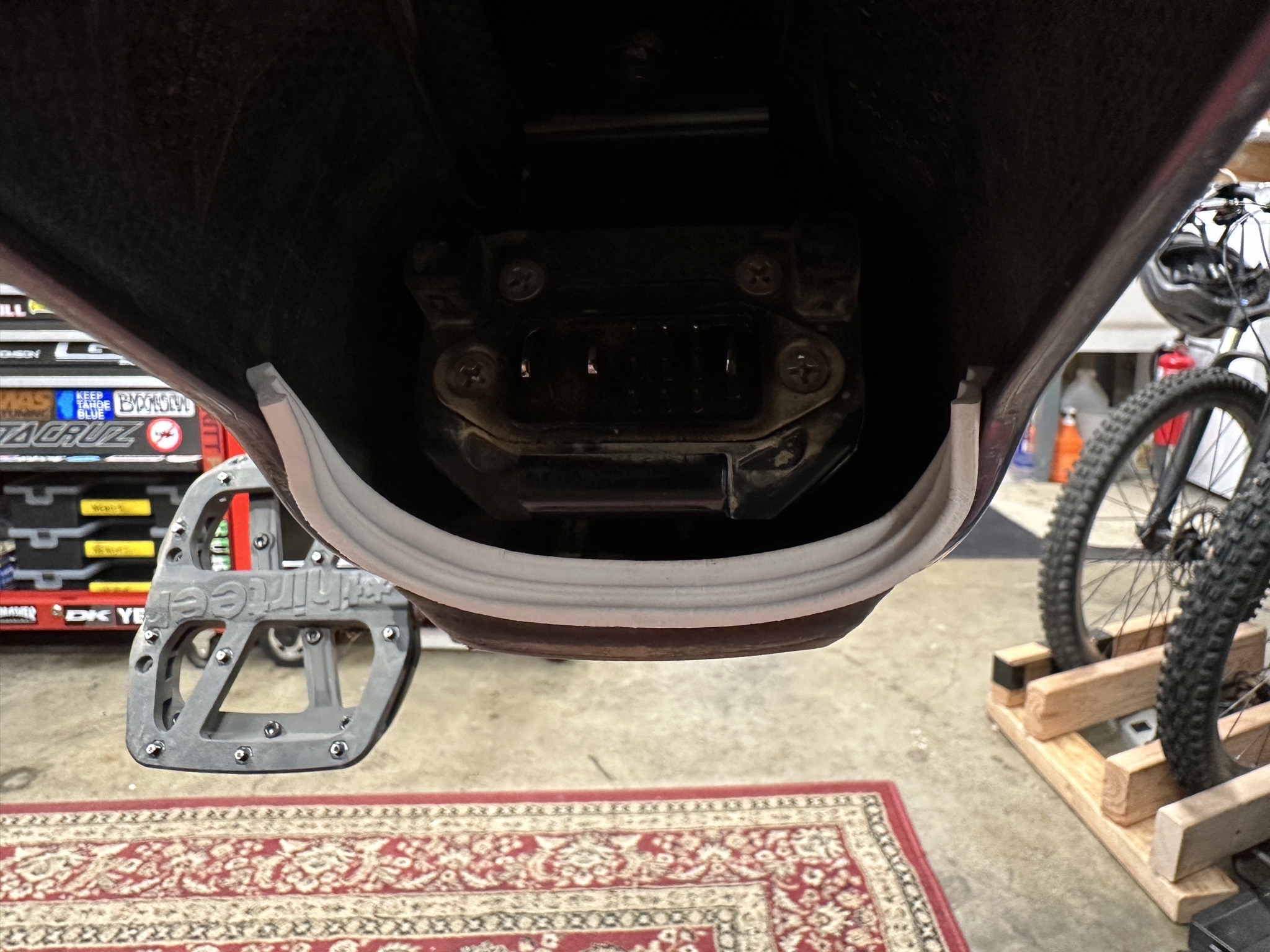

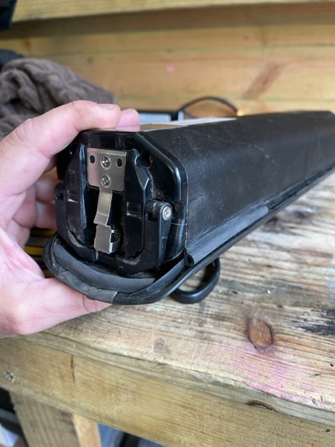

hey chief,i'd be interested to see a picture of your foam solution if possible??
the first ride i had on mine it was very wet and sandy and i was alarmed how much water and sand got in at the top and bottom of the battery cover.my solution was to buy a roll of polyester tape(doesnt leave residue when you unpeel)and i simply tape up the two gaps to stop any shit getting in.
Hey Leroy, I will post some pictures tomorrow for you. As an update I am now on motor number 3 in under a year! The bike shop have been superb (as they should be) but it’s getting very boring. If it happens again I might consider a change. However I’m told this latest EP8 has better sealed bearings etc, time will tell.

cheers chief,much appreciated.

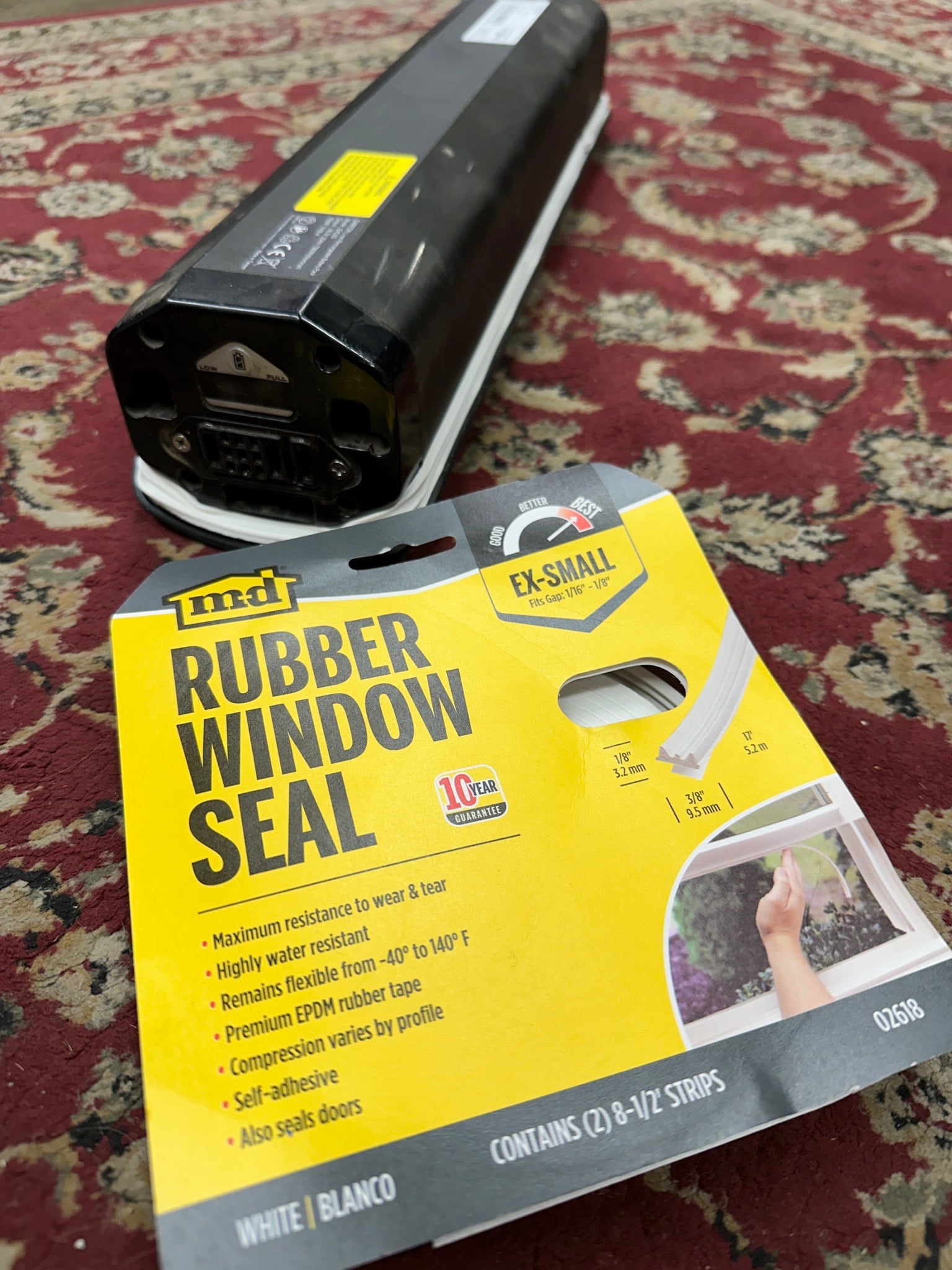

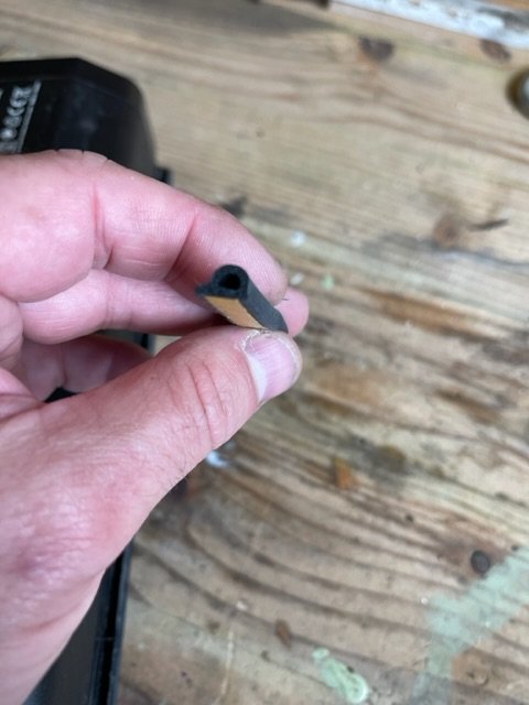

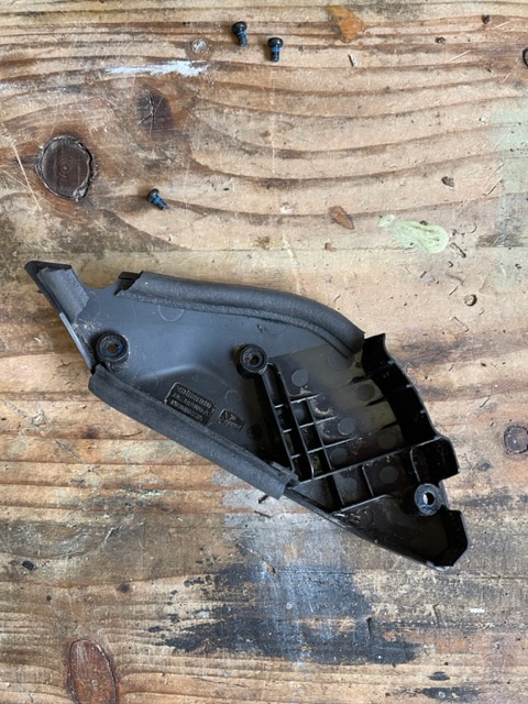

That looks like a good retrofit. Could you possibly tell me where you got this and maybe a part number?

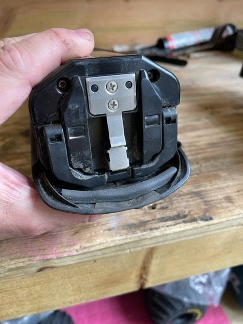

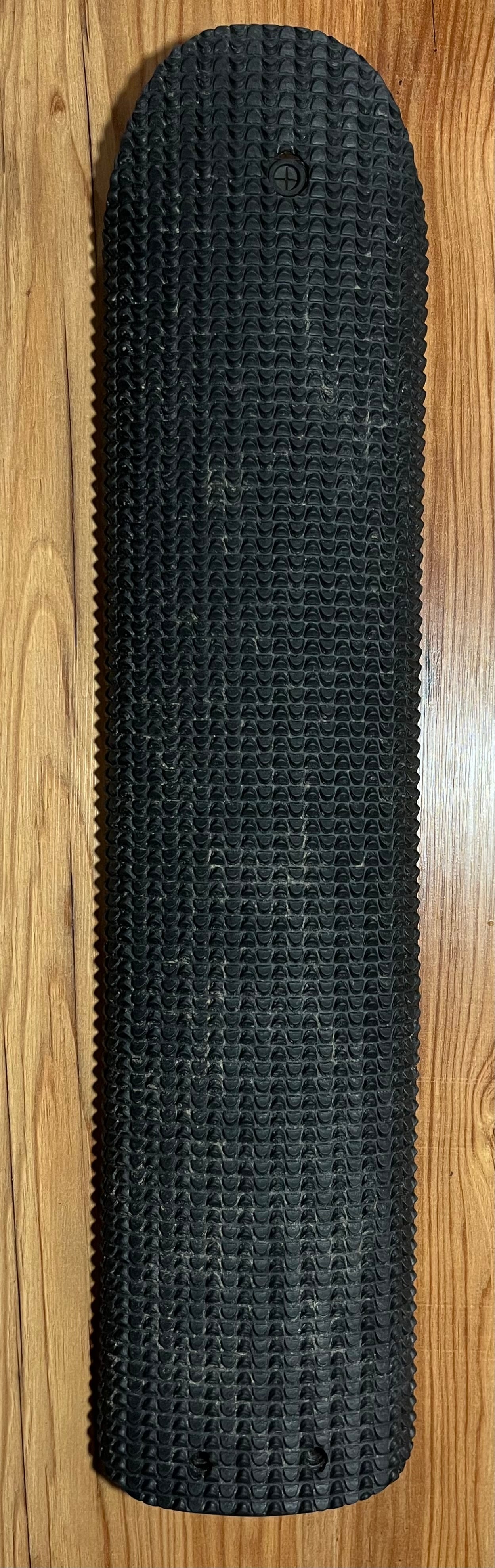

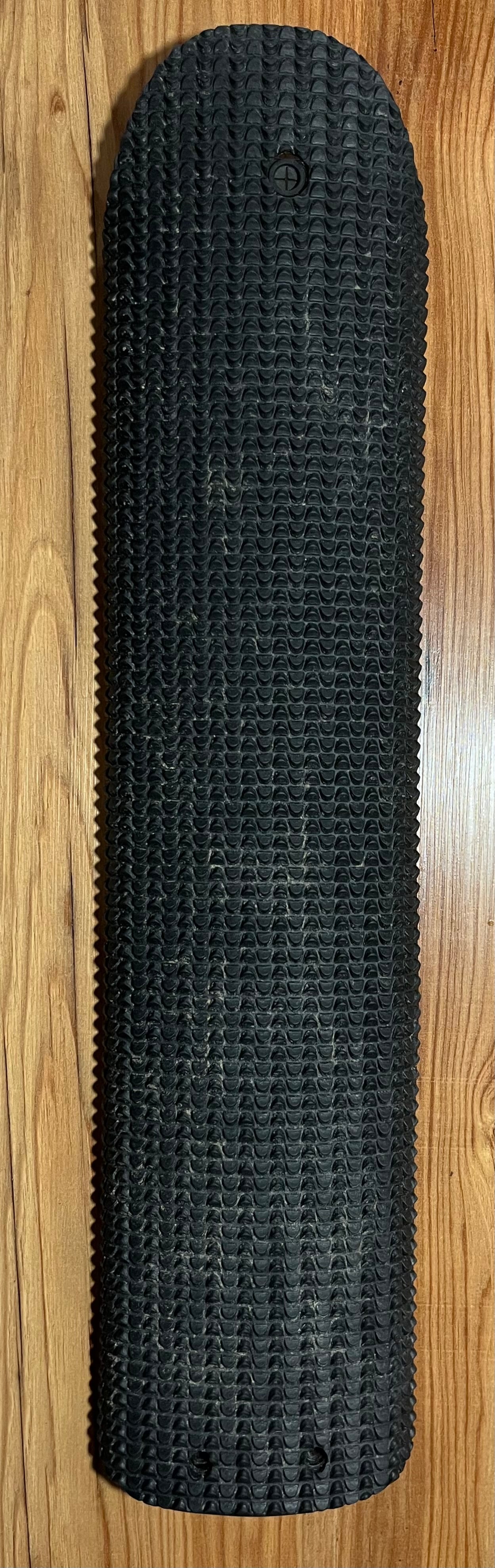

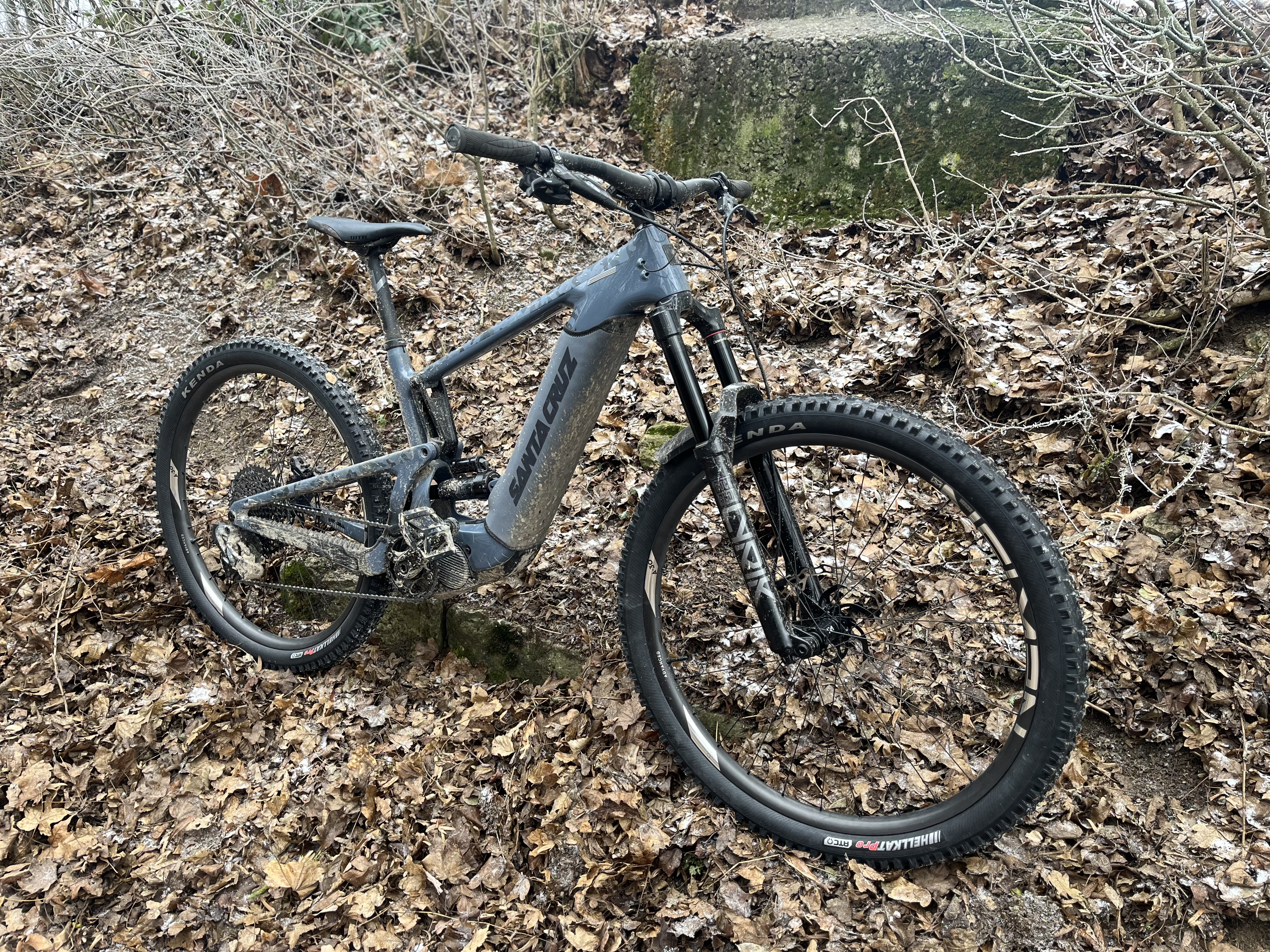

I solved it like this, no more dirt gets in at the top and the clattering of the stones on the battery cover is gone! I used a 2mm rubber profil…

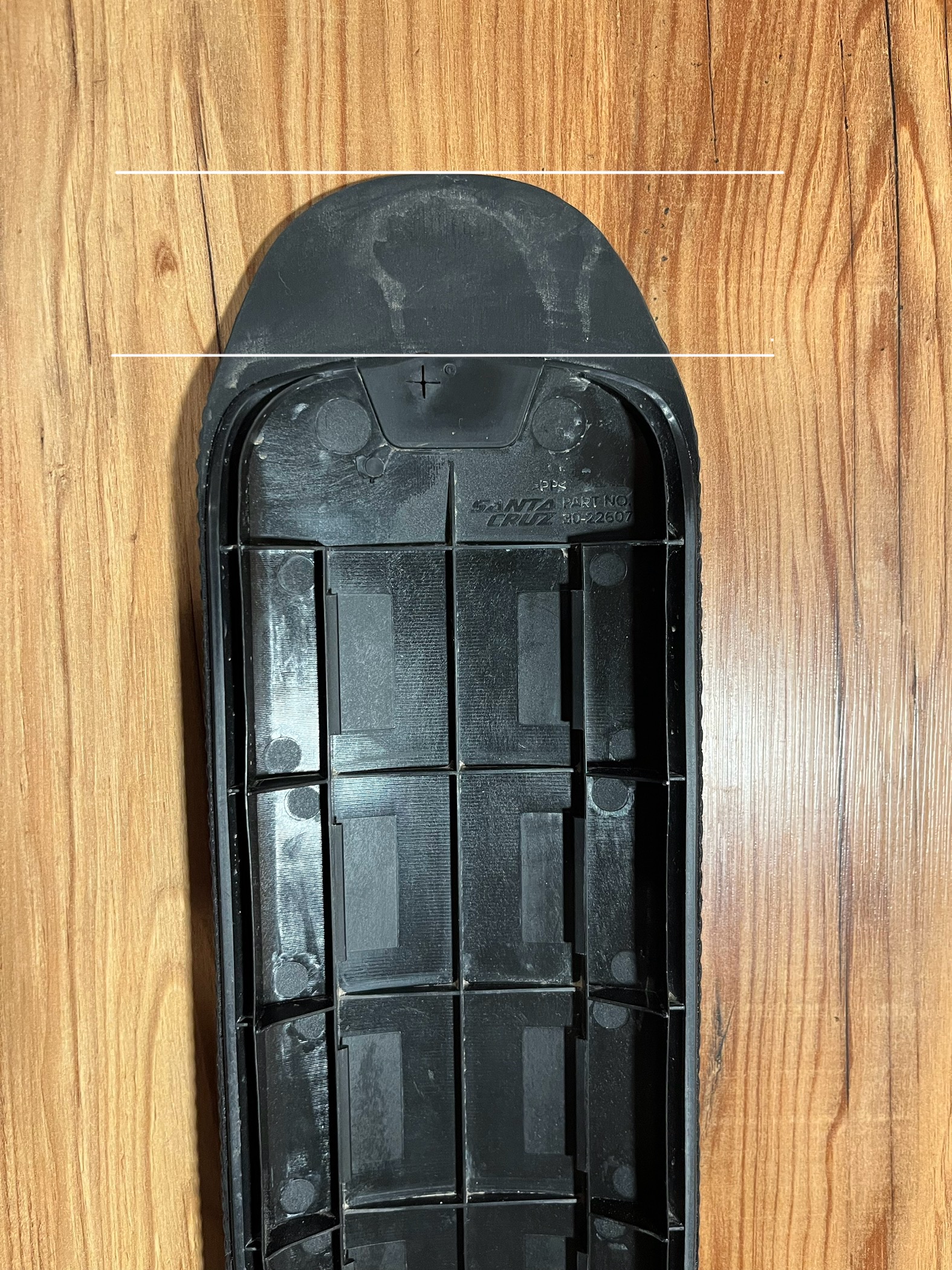

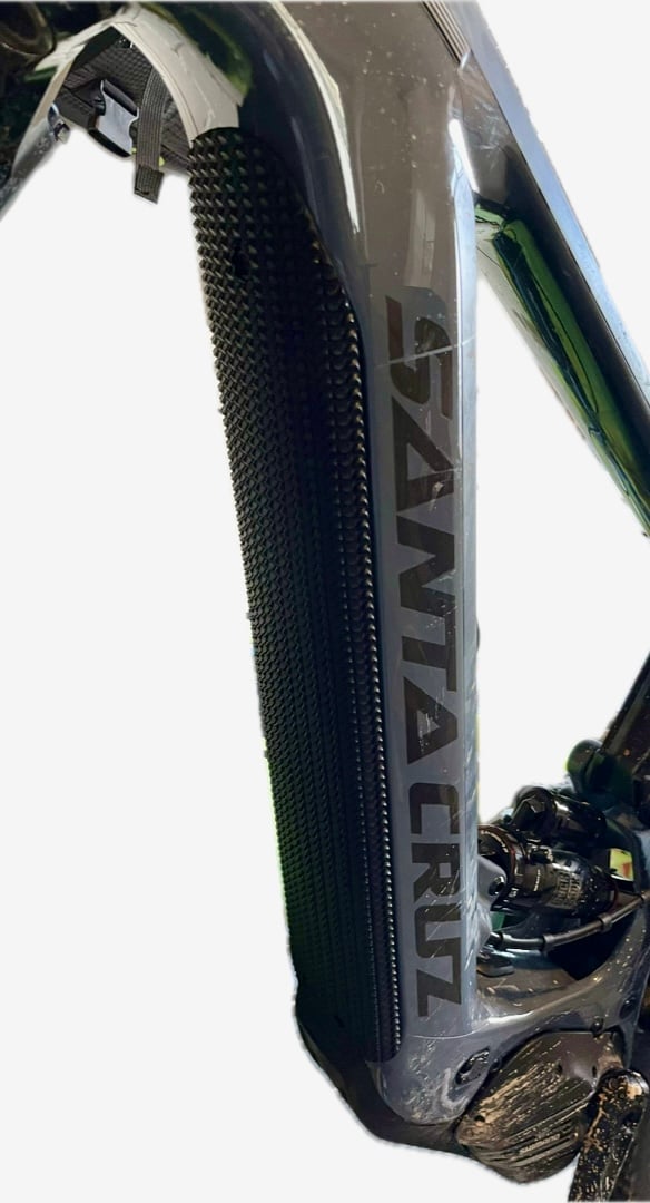

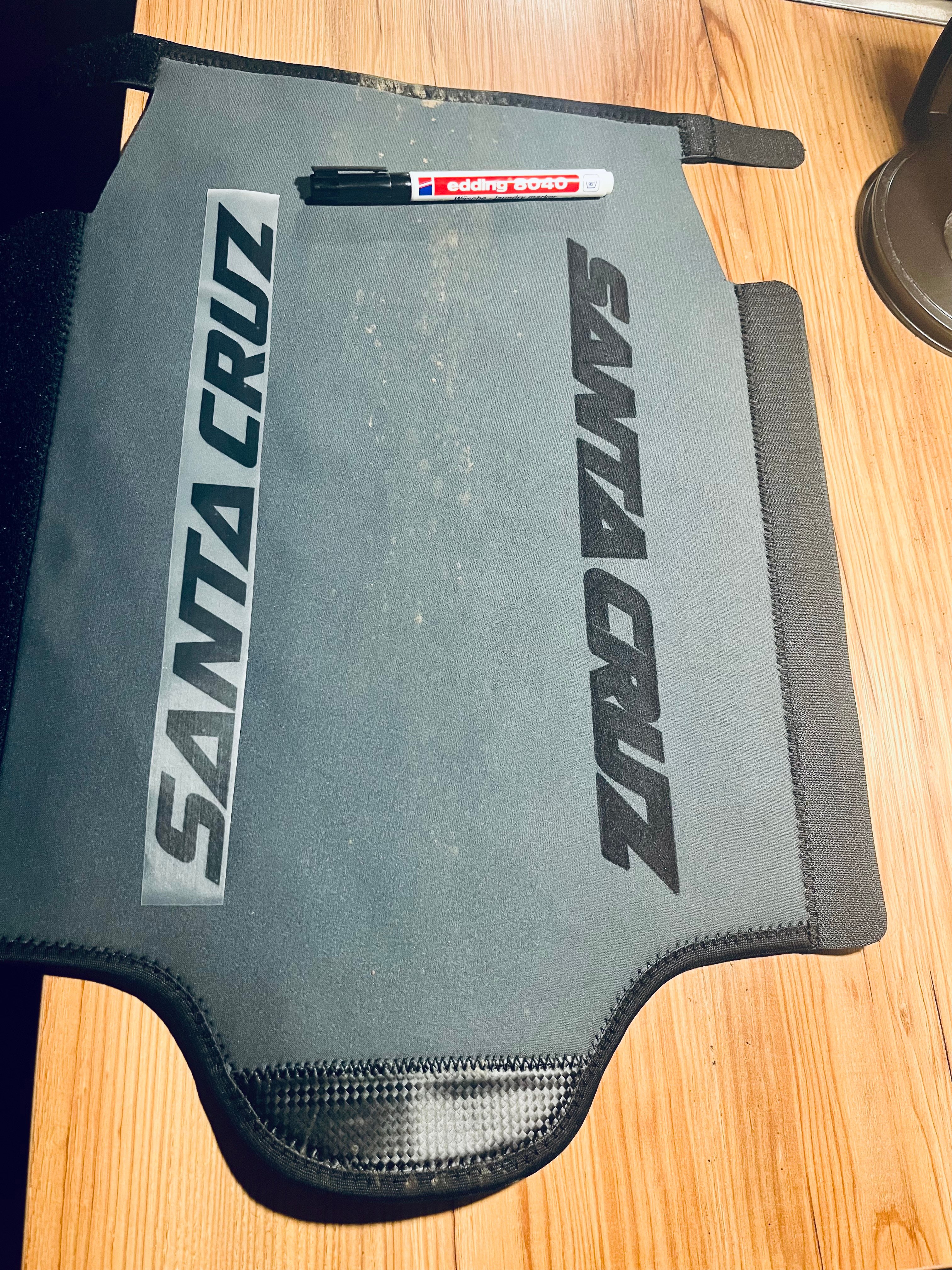

I bought a second Battery cover Kit 04-23713 for the Test. Open the 2 srews which fix the Cover to the battery, then you can slide down the Cover from the battery slowly. Put some strong double-sided tape to outside of the Cover and fix the rubber. Cut the rubber in the same form like the cover, give some extra Space on the top for overlap to the frame. Put a hole for the torx wrench inside, you can See the original hole from the Inside of the cover…Put 2 holes in the rubber for the mounting screws. Ready…slide the Cover back on the battery and fix the mounting screws in the original Position.

I bought a second Battery cover Kit 04-23713 for the Test. Open the 2 srews which fix the Cover to the battery, then you can slide down the Cover from the battery slowly. Put some strong double-sided tape to outside of the Cover and fix the rubber. Cut the rubber in the same form like the cover, give some extra Space on the top for overlap to the frame. Put a hole for the torx wrench inside, you can See the original hole from the Inside of the cover…Put 2 holes in the rubber for the mounting screws. Ready…slide the Cover back on the battery and fix the mounting screws in the original Position. View attachment 132986 View attachment 132987
This is rad! Gute Arbeit, Birdman!

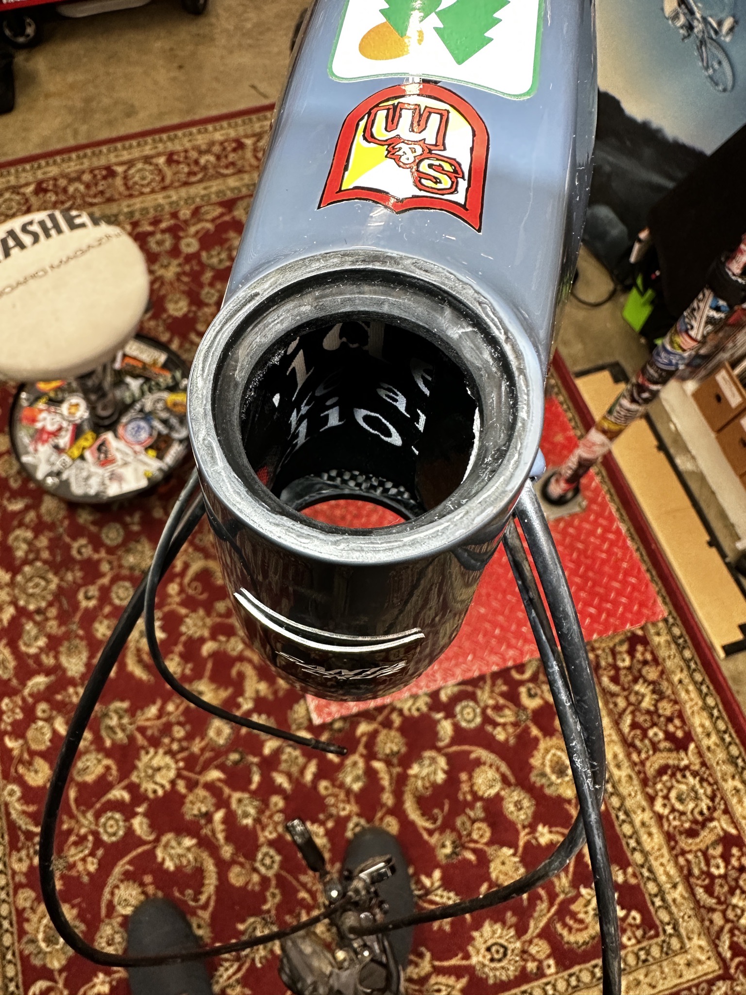

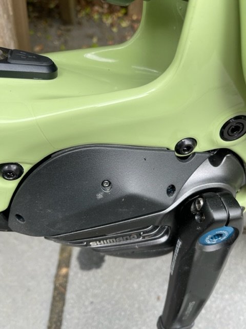

I did a similar thing to Chiefworm. The gaps all around the battery let an insane amount of dirt and dust into the frame, so everything gets filthy, from battery connections to the headset. First I taped a cut-down can coozie into the frame around the back of the headtube to help minimize dirt getting into the headset (I kept pulling it apart to clean/grease/rebuild because it was always filthy and creaking), and then a year later added self-adhesive rubber window seal all around the perimeter of the battery, and at the top and bottom of the frame opening. It started with the bike shutting off about every other ride, which eventually led to a new wiring harness, and the final fix, which was cleaning all the battery and frame contact points and then coating all contacts in dielectric grease. But having a seal for all the dirt can't be a bad thing, so did that as well. The window seal came from a local hardware store.
paulbarbu
Jun 15, 2020
12
7
Romania
View attachment 137618 View attachment 137619 View attachment 137620
Nice hack on the Headtube, will do something similar as well . Had to clean the headsets too often for the cracking noise and the amount of dirt on there.
Hope something like this will reduce the issue.
