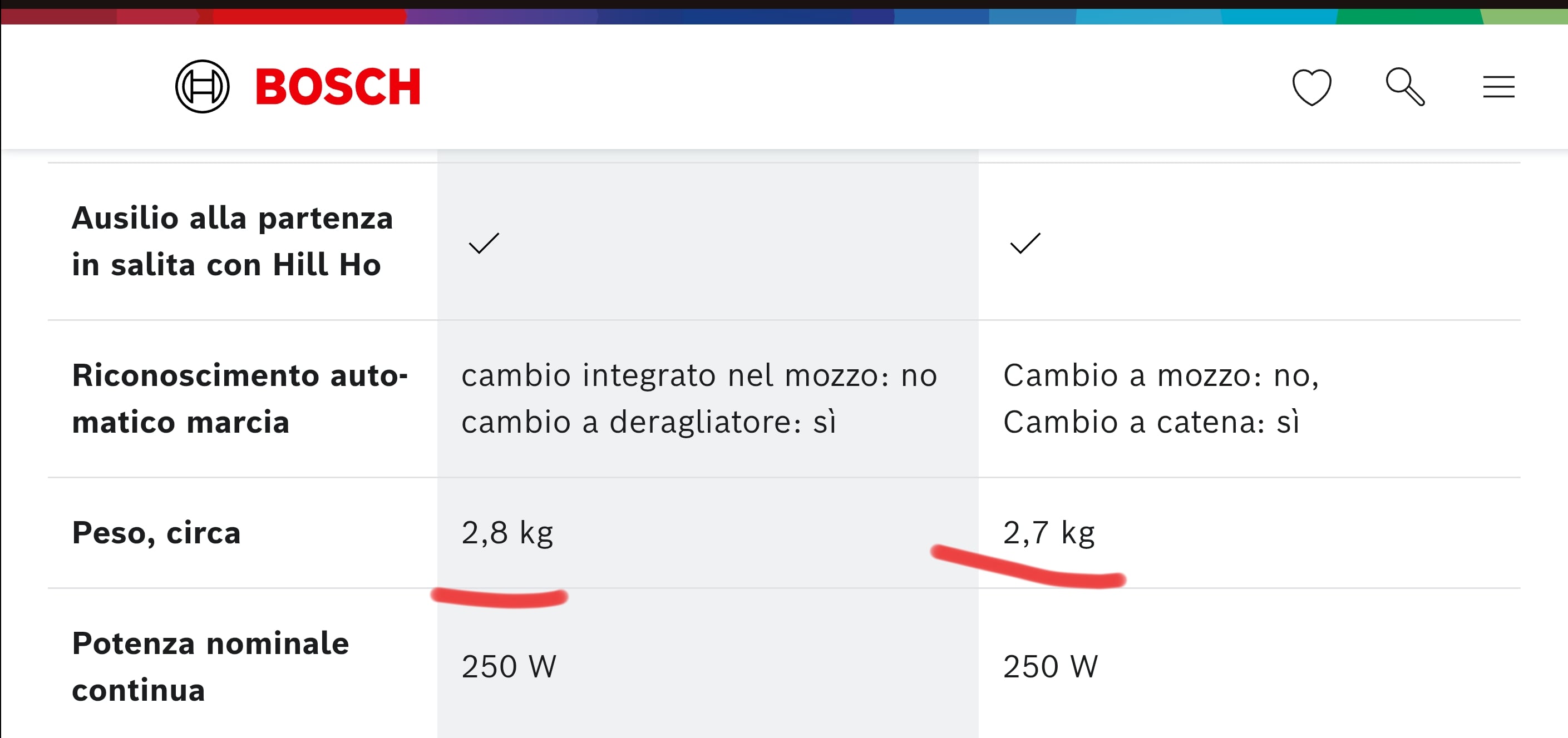

I'd think the CXR would drop more than 150 grams with the full magnesium case, ceramic bearings & Ti shafts. I know that's what the Gen4 race motor saved with just the Ti.
Did your weight info come from a reliable source?
If I can get this motor in the Regulator, I think my search for my next e-bike is over.
Yes, Bosch - approximately 100gr.
Thanks for that. Weight is a larger factor to me than the power difference.
One thing to consider is that with the DJI some sort of chain ring protection device needs to be figured out and that would add another 150 grams or so to the DJI and some cost.
On the video of Alex Bike Tester the guy from Bosch clearly says the only difference is the titanium axle and the ceramic bearings. The rest, magnesium case, parts etc is all the same.
