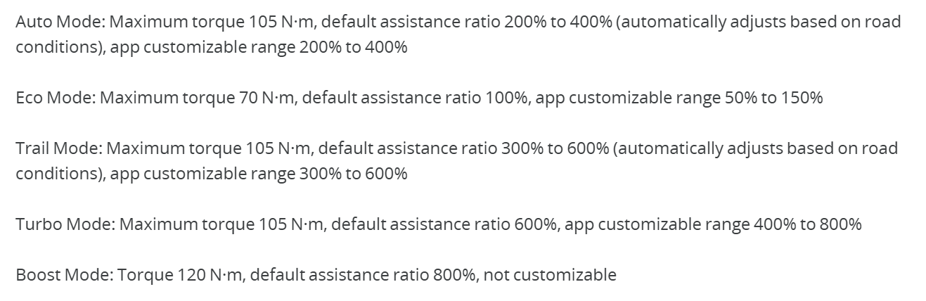

Oh and btw, did anyone notice that DJI will output 600 Watts with only 50 Watt rider input? That's 12x assistance, compared to 3.4x (Bosch) and 4x (Shimano). Amazing!
Where did you get this info from? The DJI website implies max 800% in Turbo (which is 850 W) and less in other modes:
