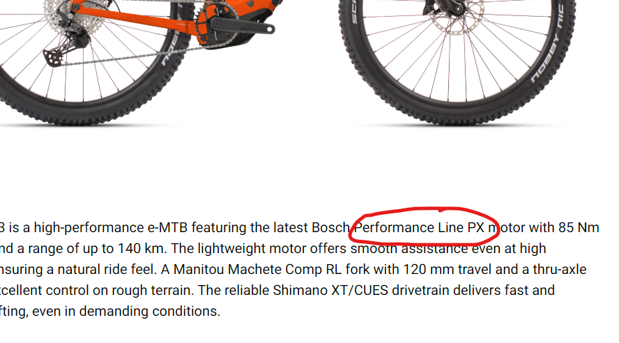

And the news doesn’t stop with the CX-R… the PX is on the way too, just like I mentioned here on April 7 :whistle::censored: Performance line CX-R and PX? Bosch might be cooking up something new...
Look at this:
Probably not 85nm. I think the specs will probably be something like this: 75 Nm, max support 300%
I’d bet on a “budget” version of the CX, with lower torque and max support percentage. Basically, it’ll slot in between the SX and the CX.
