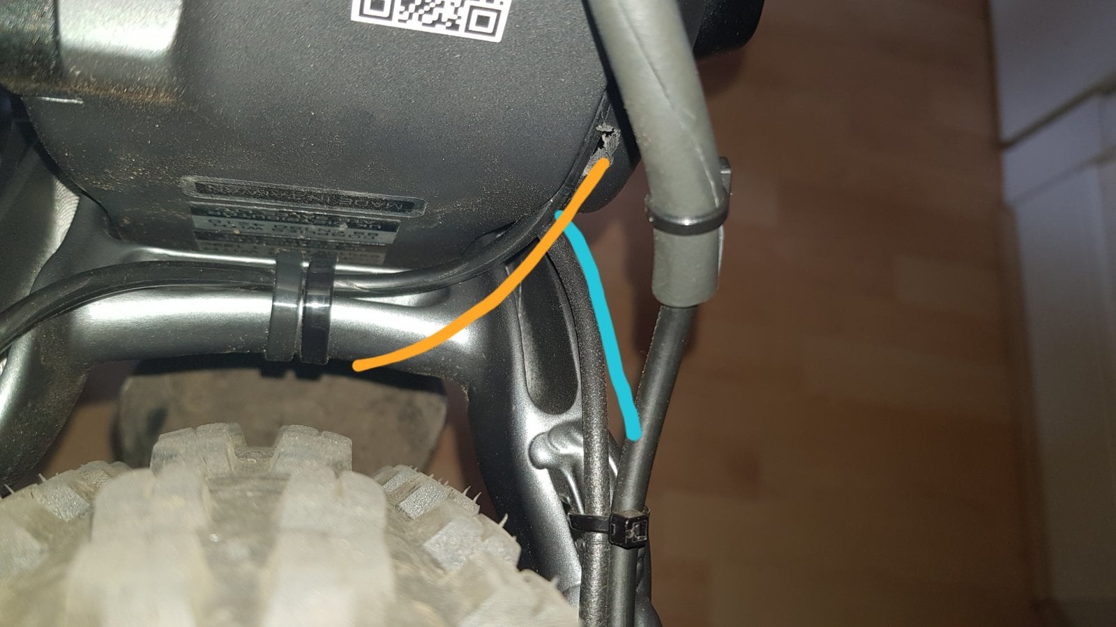

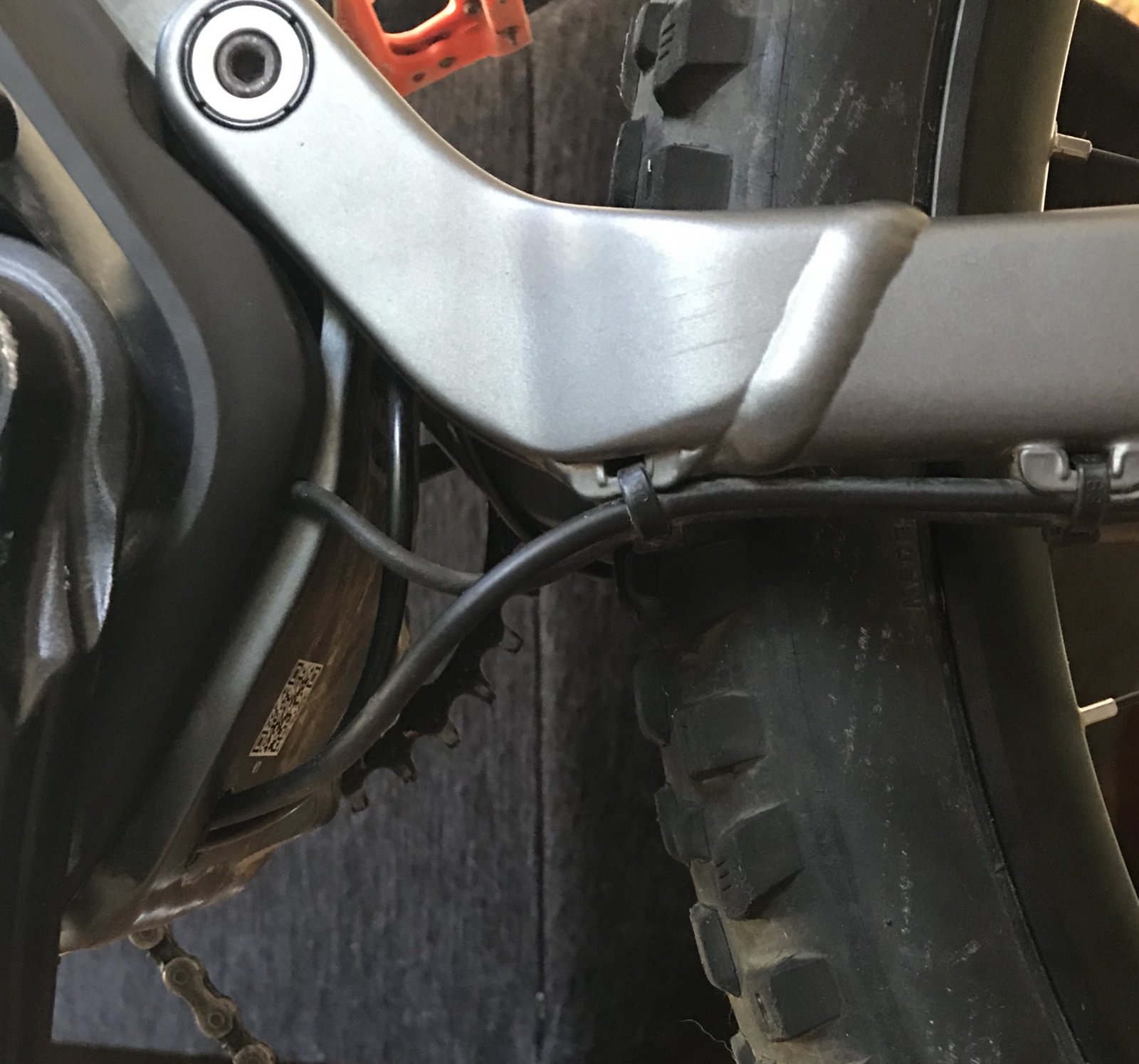

i just got mine delivered 2 days ago. i sent an email through to the LBS with pictures and links from this forum asking if they would be kind enough to re-route the cables. They called me the next day and said recent Whytes have the bottom cables re-routed already, the break hose is now the lowest cable poking out the back of the motor location aiming at the rear tire and not the ground. i had some old carburetor drain hose that i split open and zip tied around it, was thinking maybe hot glue or some kind of caulking would give me a flexible seal to reinforce the frame grommet but i dunno, i fear more for the pedals than the hose/cables after riding about town for a day.

It's the shifter cable that was the lowest (after dealer mod one) and will cop it when you drop down over rough ground/rocks. I would say those cables you've protected will be way out of the way anyway.

yeah the speed sensor follows blue to meet up with the break hose. The shifter cable routing pokes out of a little hole drilled in the plastic and follows orange, it is really out of the way.
Any chance you could take a bigger picture showing a bit more of your bike to give me a better idea of your routing please mate, looks good, I might copy your idea ?

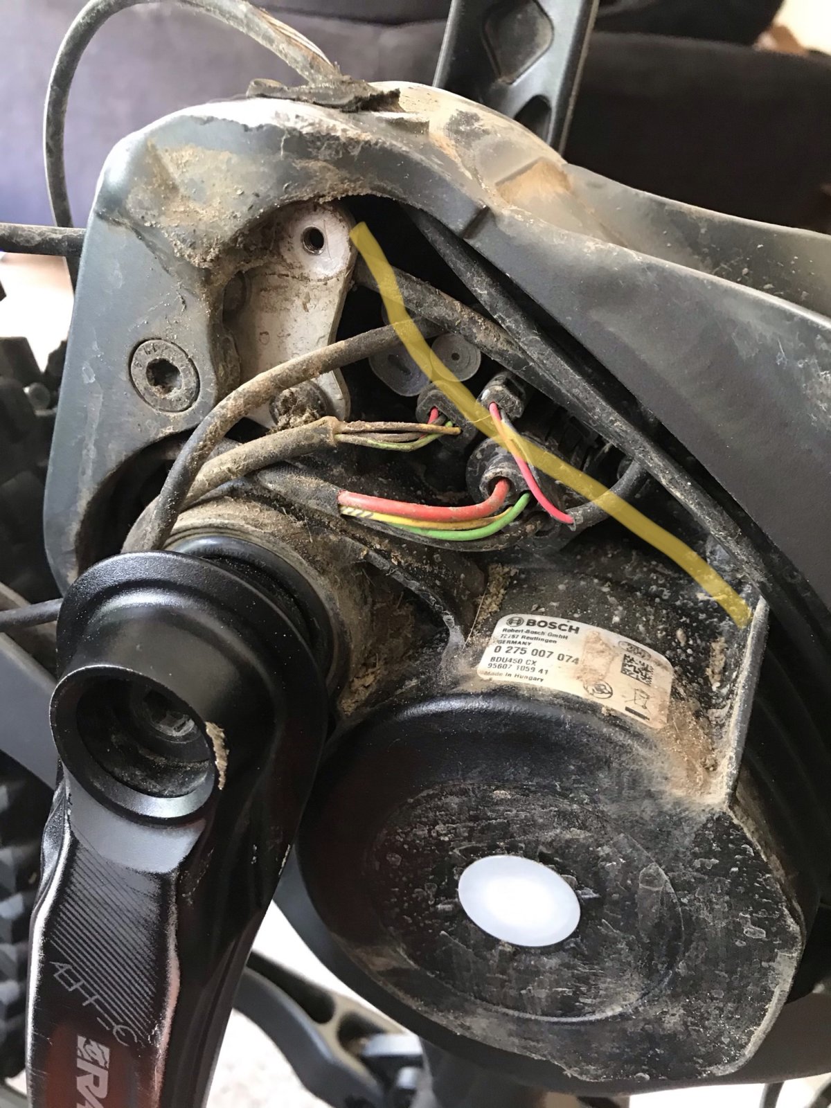

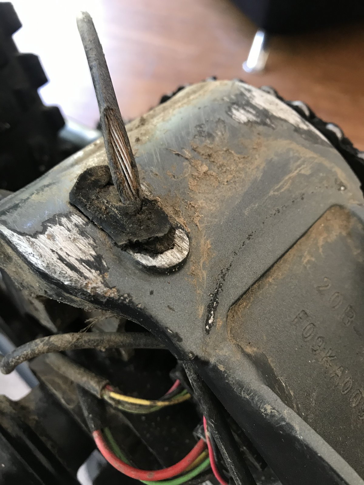

Had a bash at rerouting Rear mech cable myself today. A smashed up rear wheel stops actual bike play for me today. Probably took 90mins beginning to end. Saves me buying AXS!
It’s actually pretty simple to reroute, only needs motor cover taking off. Most difficult but was making room in the existing grommet which currently houses the brake hose.
It shifts cleanly, can’t tell if there is any additional friction caused by the small radius bends. Time will tell.
Yellow line is new route.
Erm ?
Nothing fouls on frame.
Nothing is going to catch these, it works nicely at full travel too.
A blob of black silicone sealant to keep it waterproof and jobs a good one I reckon.

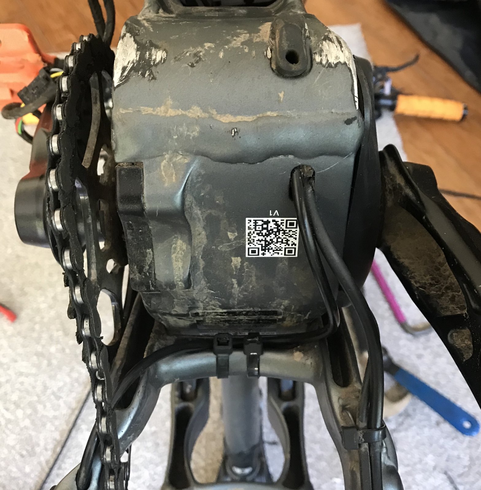

Do you have a technique for steering the shifter cable through the swingarm to the exit hole? this seemed to be my stumbling block, so I reverted to standard.
Yeah, easier way is remove rear sus bolts (the ones next to rear axle. You can then see into the chain stay, there is a hole for the cable just inside. It’s pretty easy to manipulate a cable inner through, then follow with the outer ?

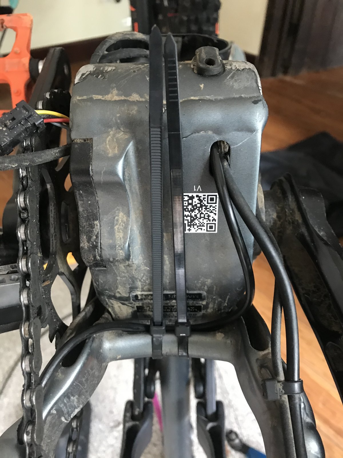

If you want to go belt and braces, I guess you could remove the brake hose entirely and feed both through a new grommet. I’m not that fussed, a blob of black sealant does the job. I’m of the camp that bikes are for using not for looking at ?
Sean there’s no clips in the way, it makes total sense when you get the cover off and see for yourself, obvs removing the battery makes it easier.
