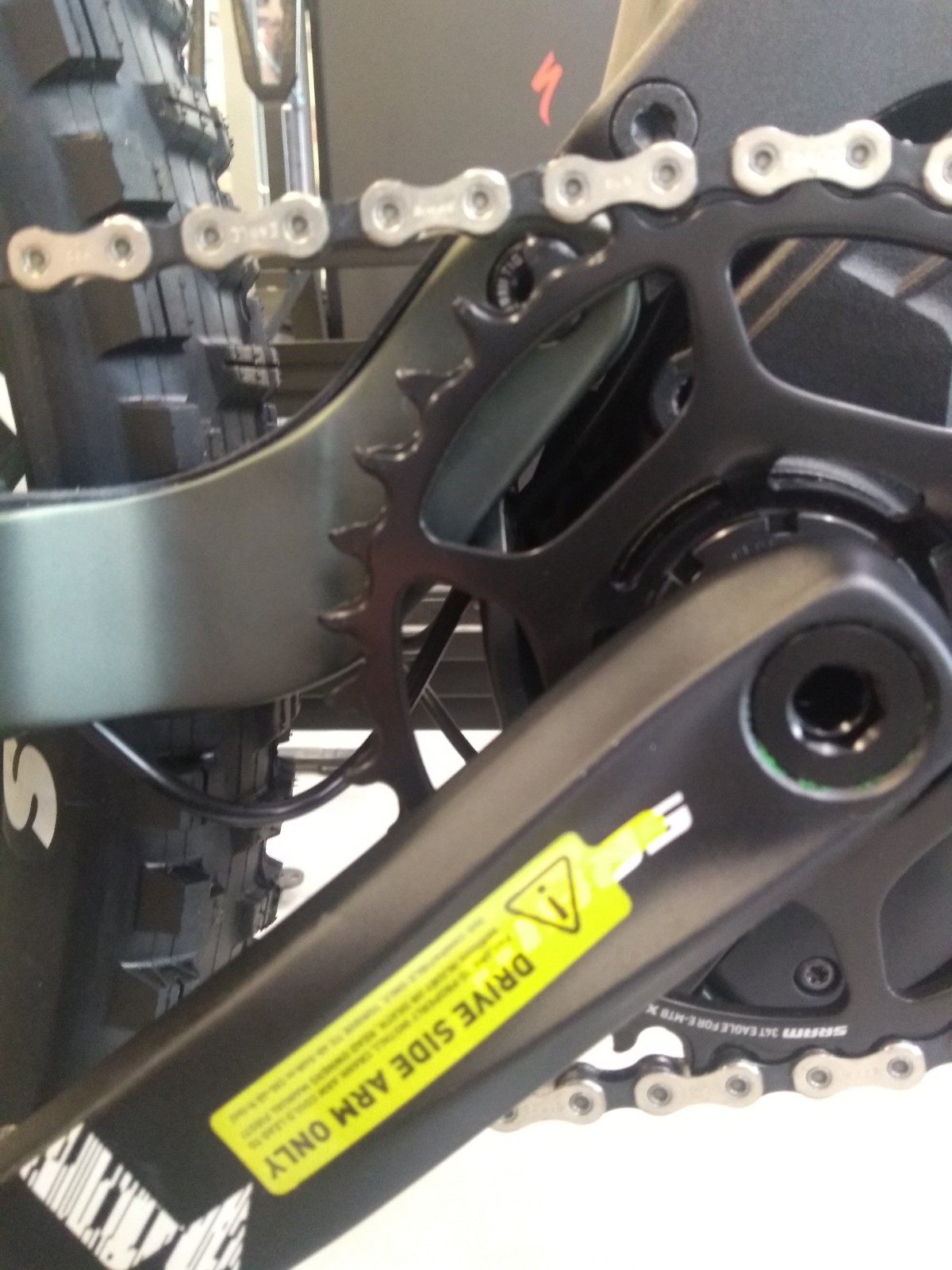

I see on the 2021 bikes, the gear cable goes over the motor and through a hole in the frame to the swingarm, eliminating the cable bend other DIY methods have resulted in. I couldn't see the full route of the cable at the front of the motor. Is there any difference here to the 2020 bikes? I might have to get my drill out!
See my thread on cable re-route for 2020 bikes.
You can achieve 90% of the same re-route as a 2021 bike without getting your drill out.
Only difference is the gear cable exits a little closer to the chainring, but I don't anticipate an issue

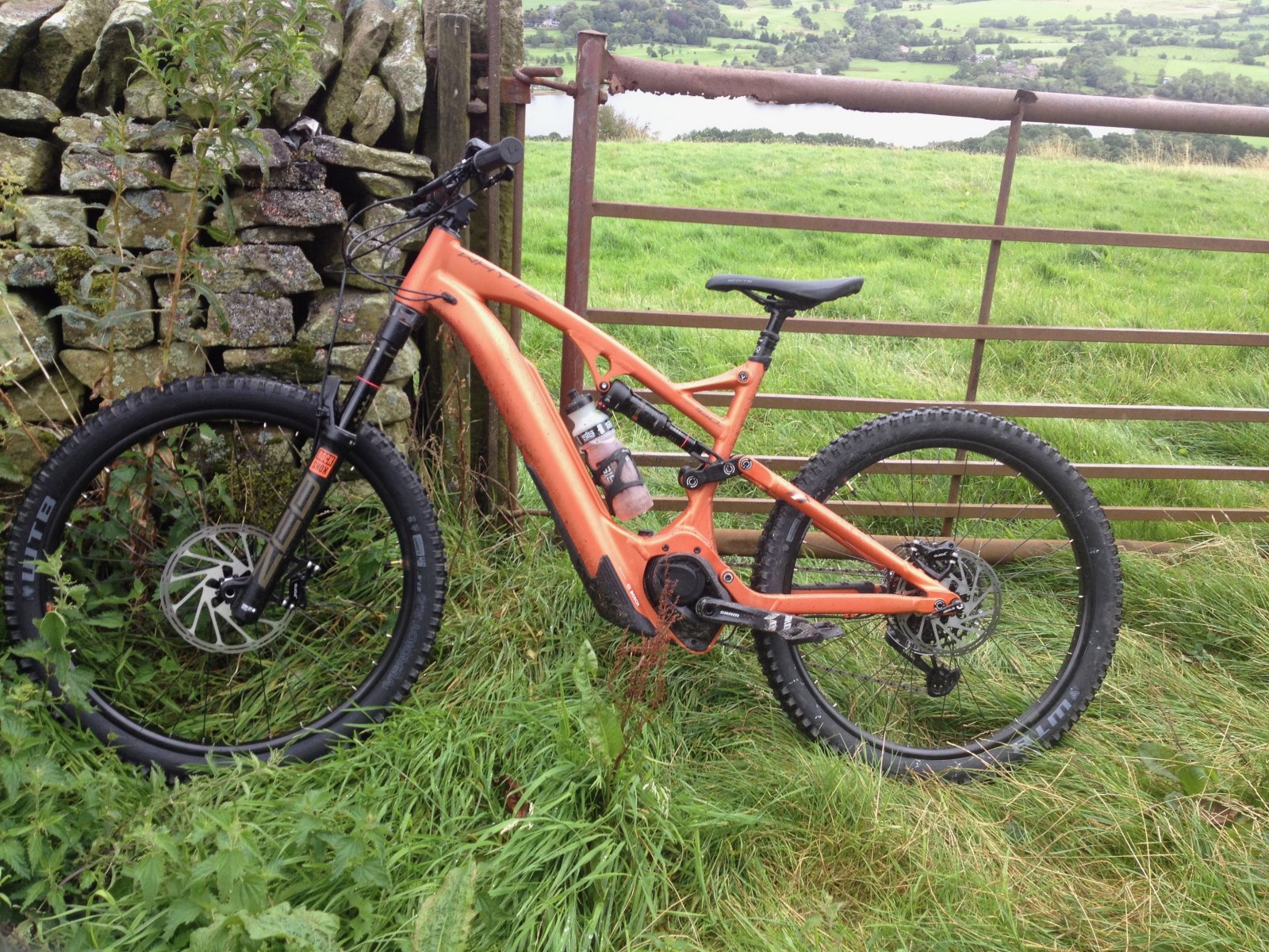

I only went to have a look and 3 hours latter I was having my first ride on my 160.
Cables are a little long and need reducing at some point. Can't believe the power from the motor, it does run over a little when you stop peddling.

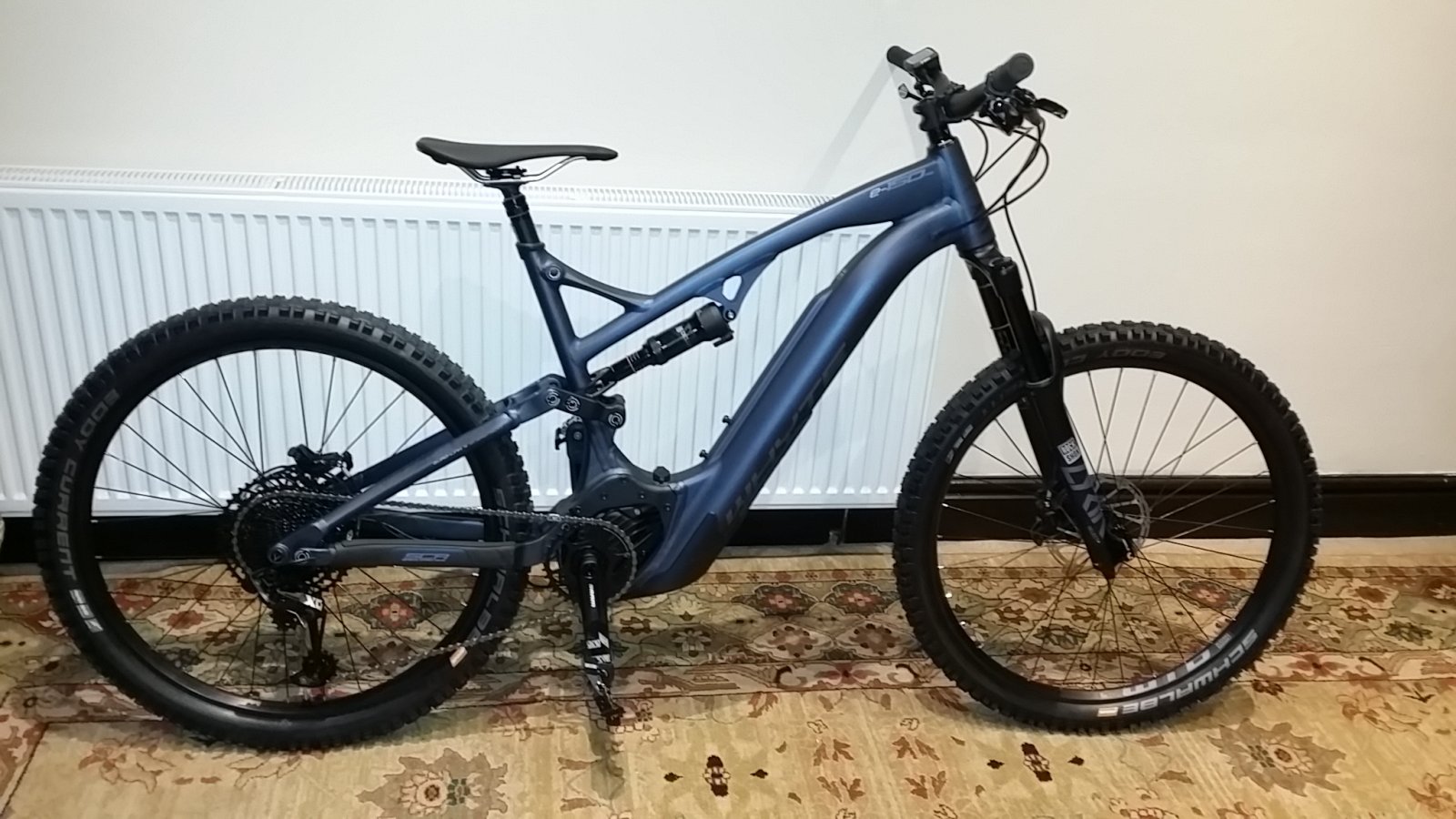

Brought the new Whyte ebike RS180 , picked up 2 weeks ago. Brought mine from Spokes of Bagshot, try and speak with James the owner.( they did have demos available) ordered picked up in 3 weeks. Had Kiox system fitted, running tubeless plus Hope F20 pedals fitted. Its the nuts. Awesome bike.

i popped into my lbs to see when they would have some and they had 4 160s
i only rode it up the road to get the fit right, I roughly new what to expect as I’ve owned a T130 before.
It seems , no test rides or discounts as they are selling them as soon as they get them.
Think they have 2 RS and one S which is a medium, I think a M and L in the RS.
It seems to be a great ride, I didn’t think 12 speed would work but it does.
I was unsure about going from a 140 bike to a 160 due to my type of riding but you
cant tell your on a big burly bike it’s great to ride.
However still need to get it set up right and will ride again today to dial everything in, should have a better idea by Sunday but so far very pleased.

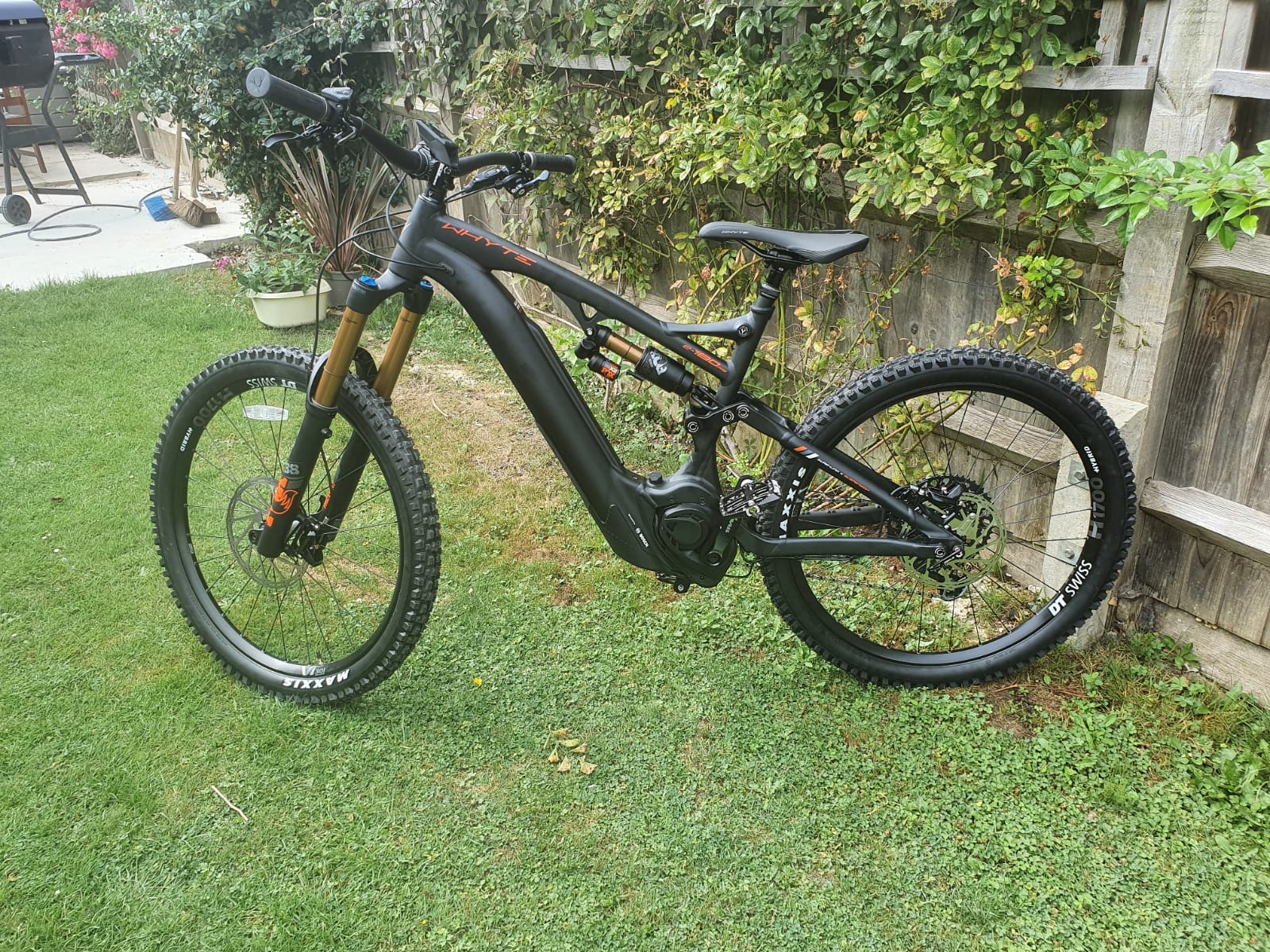

I loved my Focus and it was a trail bike, the 160 is completely different and is a full on all mountain bike. You just point it and say I'm going that way.
Zebs - Very stiff, combined with the wide bars it gives you great control and the front end is really stiff and planted on the rocky downhills.
You only get pressure and rebound settings, although they feel OK more work to do to see how plush I can get them to feel.
You only get 2 spacers, which for me makes the riding position a little low, just enough room to add one more and I've got the bars at the highest point. Feels good but a pity you don't have more to play with, I understand the design so , young guys won't have an issue, I can see why they are this way so you get some weight on the front end, being 60 with dodgy back I prefer a more upright position.
Frame - As you expect from a Whyte its very stiff and works well, at 5' 10" the large seems the way to go so the cockpit does not feel cramped.
Its a great ride and seems really well made and sorted.
Brakes - Very powerful with good modulation, they squeal like pigs when wet but soon dry out, you have to watch the power on a tarmac decent and its easy to lock the rear, they do the job well and no upgrades required.
Motor - I know a lot has been made of the power increase, I've not ridden this type before. At this point I'd say its the only weak point of the bike.....
Yes it delivers lots of power, which is not an issues if you are riding not technical stuff, however the weak point is how it delivers the power.
When you need to go slow and apply it gently over technical elements you can't, its feels like a bull in a china shop, alway on and in a rush, it makes it very hard to apply power as you need it. The worrying element is you can apply a slight amount of pressure and the motor will carry on running for a second or two.
I actually fell off on a muddy technical section, applied a bit of pressure and stoped peddling, motor carried on for two second and bounced me over two bumps which through me off the bike. Would not stop me buying one but power delivery is something that need sorting.
Overall a fantastic bike currently being let down by the poor power delivery of the newly updated motor.
