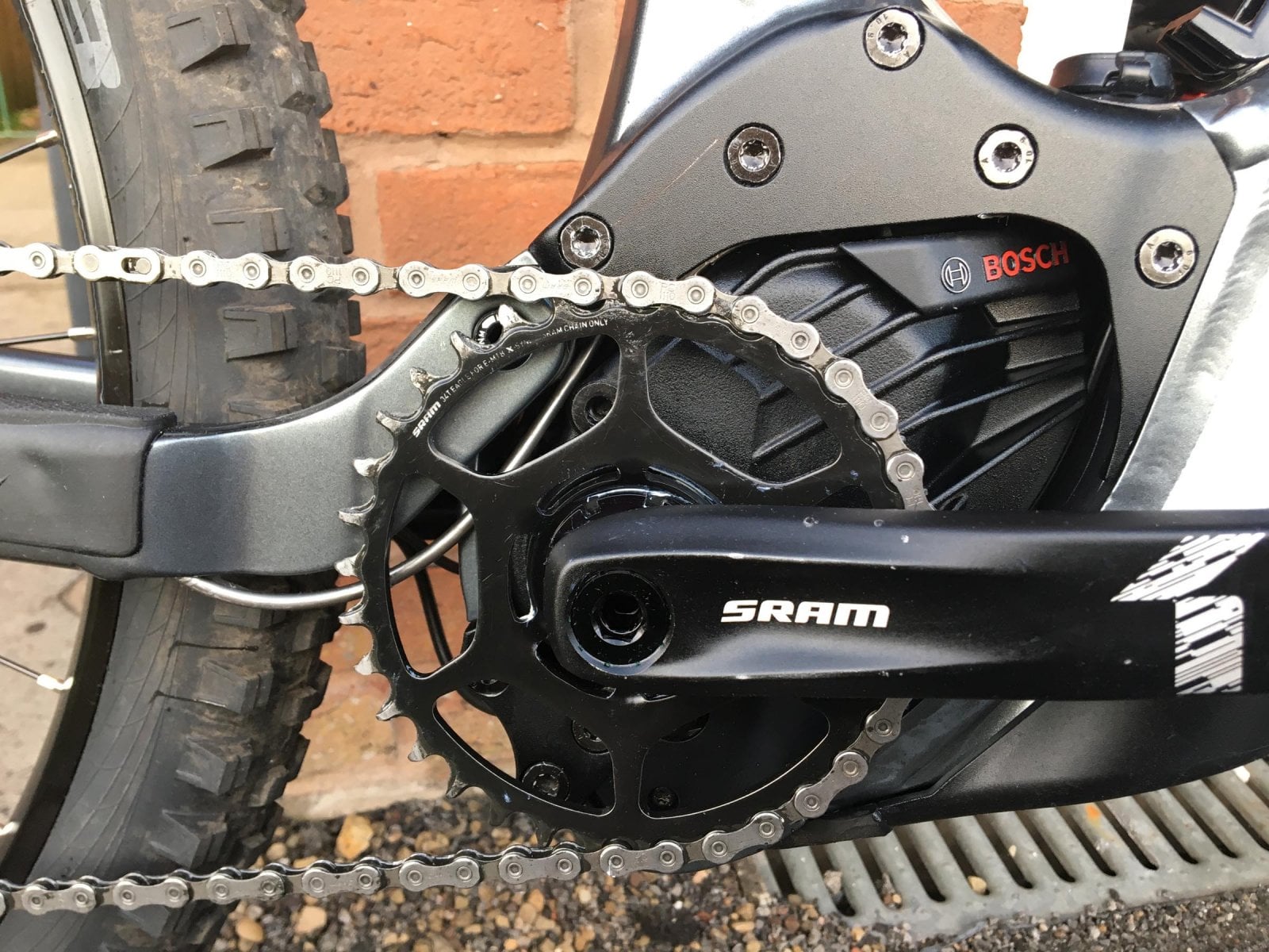

Here is my third and hopefully final shifter cable re-route on my 2020 E-150.

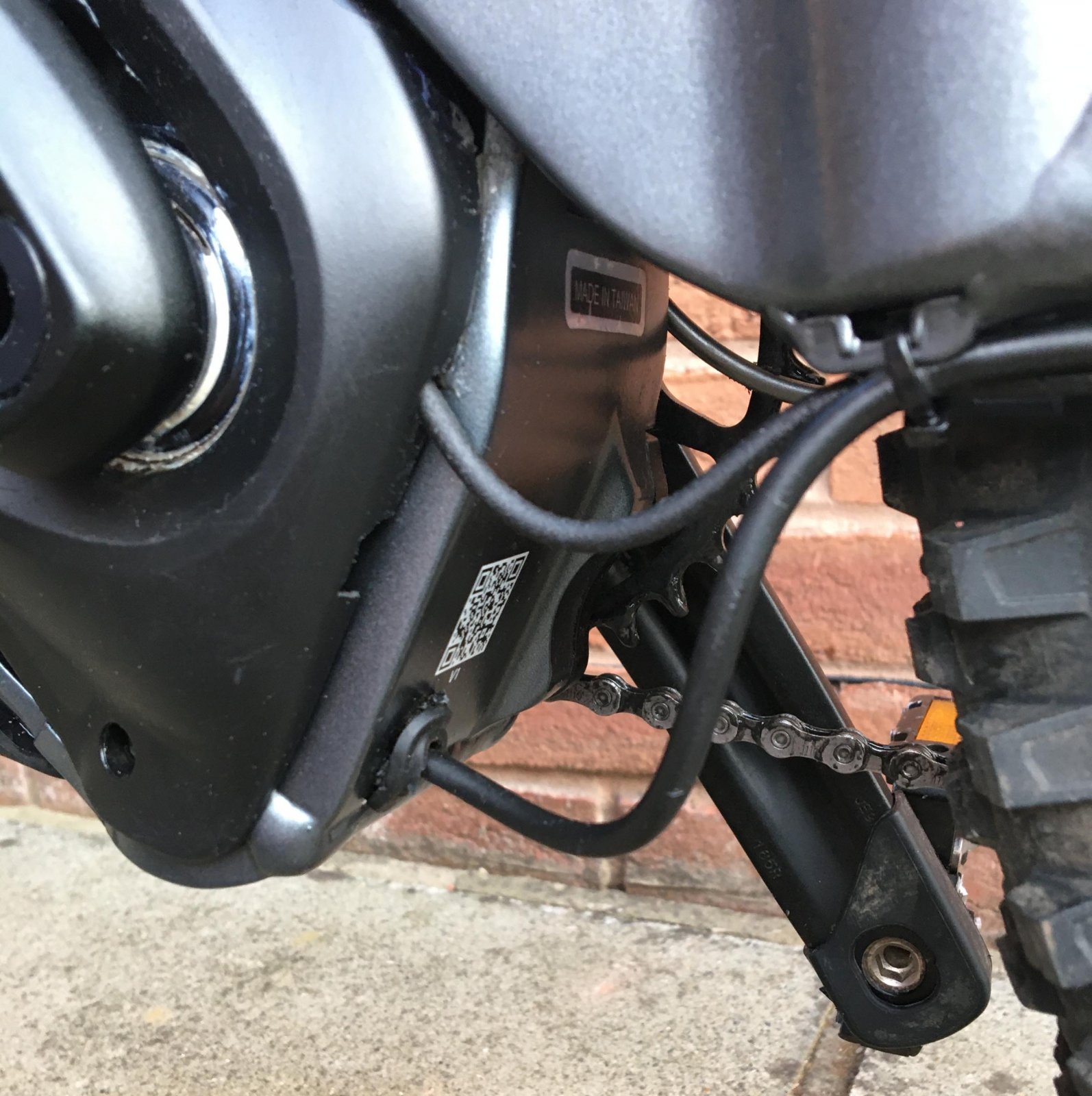

The original route exiting the motor casing below bottom bracket was way too vulnerable.
The first re-route, using the same hole as the brake hose was too restricted on my frame, not happy.
The second re-route via a second notch in the rear of the near-side motor cover was okay, but the tight radii of the cable from one side of the swing arm to the other created way too much resistance on the shifter cable.
Inspired by the photo's of the 2021 routing provided by N9VNS and Nakedebiker's re-route, I took a similar route on Saturday afternoon.
Pretty easy and straightforward to be honest, shifting now super clean, and so far cannot see a downside.

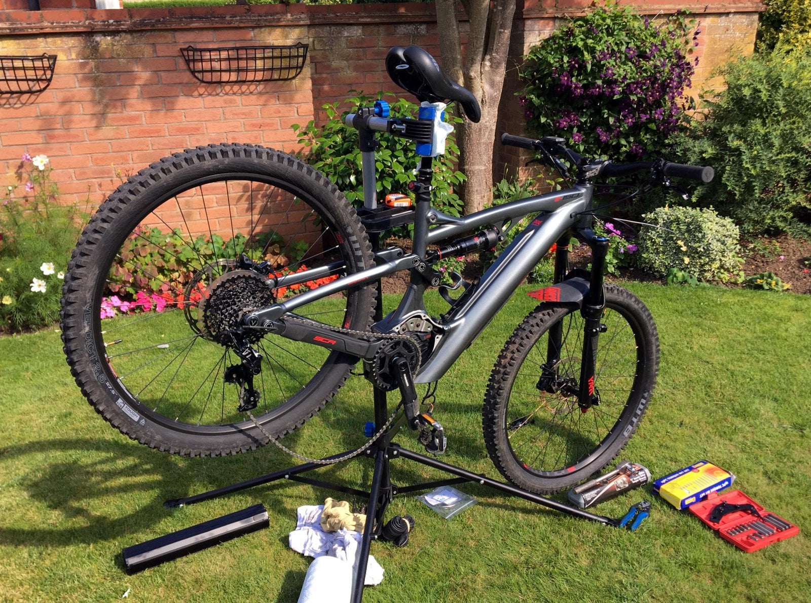

Garden workshop.
Although it's a bugger when you drop small screws in the grass :mad:
The cold beer is out of shot.

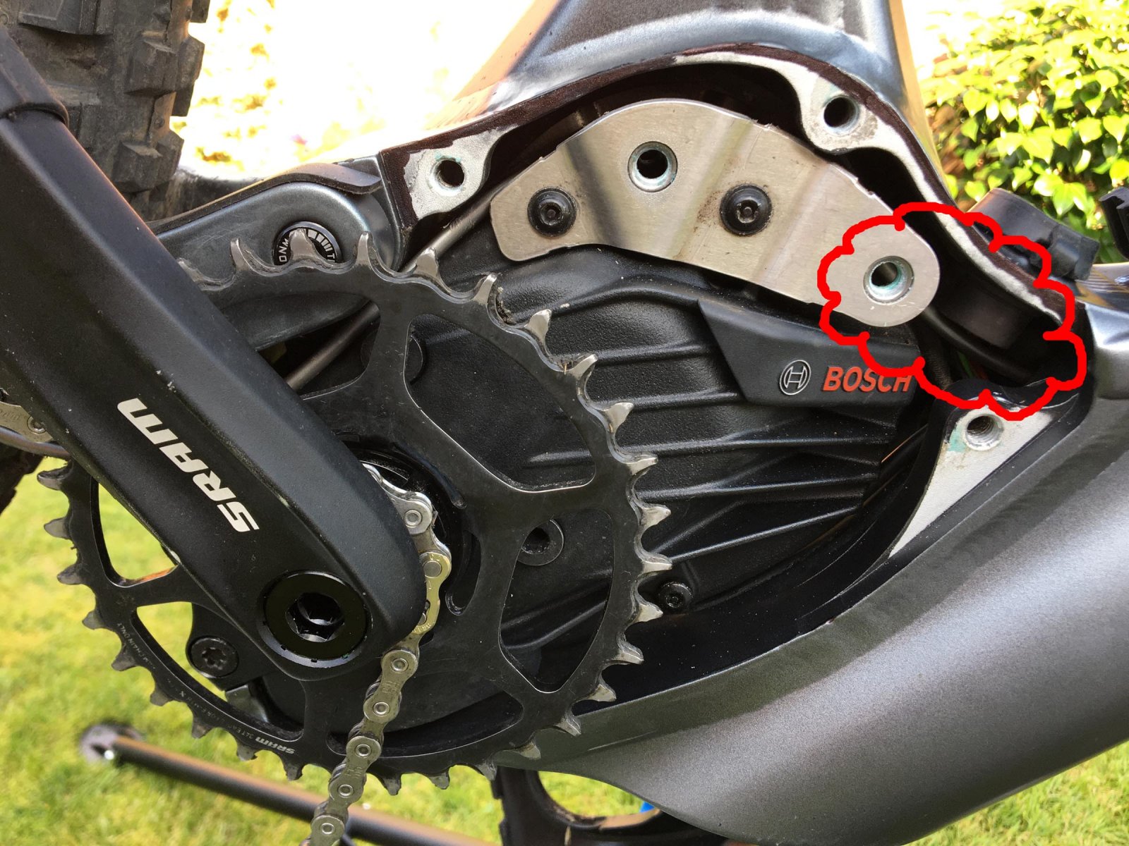

Remove the black painted alloy plate from above the motor casing on the drive side.
Five T40 bolts. They are torqued down petty tight, they are also very very soft, so use a good tool and take care, don't round them off.
With the plate removed you can clearly see the proposed route on the pictures below.

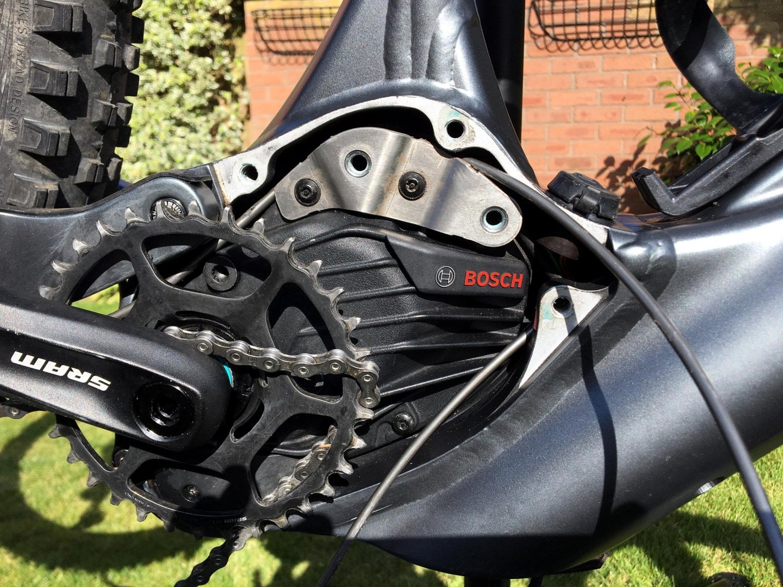

A bit of a fiddle to route the cable back into the hole into the down tube (below and in front of the charge point)
I fed the inner cable down through the down tube to use as a guide.
Feed all the outer cable through, back up the down tube and back out to your shifter.
Leaving the slack that you require ( I trimmed about 100mm from the original length)
Once happy, run a new inner through, reset the tension on the derailleur, put it back together and go ride.

After feeding through all the slack it looks like this (below), make sure smooth and nothing fouling.
Put the near side and drive side covers back, and tighten the bolts being careful not to round off or strip a thread.
The exposed shifter cable is sat beneath the chain stay, behind the chain ring.
It is well clear of the chain ring, and I can't see a scenario where this is going to be an issue.
I am happy with the amount of slack at the pivot point, and after a 30 mile ride shows no signs of chaffing or resistance due to suspension movement.
Shift quality is as crisp as it gets. (y)
All nice and neat, and no longer vulnerable

If you are replacing the outer, then leave the inner in place to use as a guide to draw the outer. A pain if you don't. You will get the jist.
The only further improvement I could make, would be to drill the rear of the motor casing and route exactly as the 2021 models.
But I would not be happy drilling the frame without dropping the motor out. Might also compromise in the unlikely event of a frame warranty issue.
I will see how the cable holds up on this this routing.
It looks good enough that hopefully I won't have to bother.

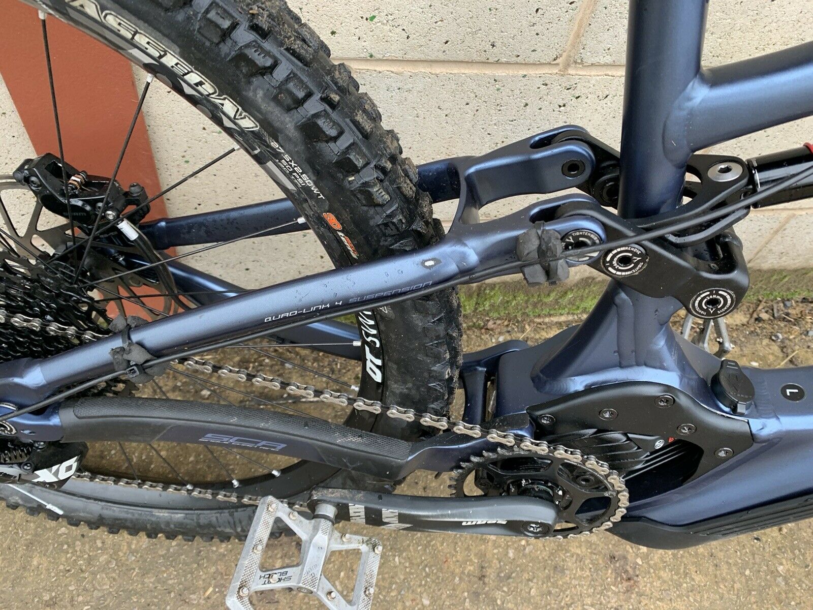

Taking another look at your cable reroute, was there any jointing/sealer compound between the casing joint faces. Just wanted to get things right in my head before I start the same mod on my RS-150.....aka the JCB GT....
Cheers EMF.
Clubby
Oct 3, 2020
159
132
Tayside
Routing been annoying me and miss the AXS that I’ve got in my hardtail, so order mech and reverb from Europe before import charges come back in January.
Will I be able just to pull the outers through the frame without taking the motor cover off? Looks like quite a convoluted route through there.
Tribey
Jan 1, 2019
307
225
South Devon, UK
The left hand cover is only two bolts to make it lose and you can leave the left crank on if you wish and just wiggle the cover back a bit to get access, and is probably the easiest bit of the job.
I'd probably pull the inner from the shifter, then remove the battery and pull the outer cable down to the motor, then pull the other half of the outer cable back through the swingarm to the motor.
Clubby
Oct 3, 2020
159
132
Tayside
My cable de-route all went very smoothly (unlike the original cabling).
Removed the inner with the shifter, pulled outer through chainstay to bottom bracket area, then pulled entire length out from the front. No need to remove any covers or the battery. Dropper cabling all came out easily from the front as well. Result!
AXS set up was a breeze, and I now also have 170mm of dropper to play with. Temporarily plugged the cable holes with moto foam to keep mud out, but may do a neater job with some Sugru if I can be bothered.
Love how AXS works. Hideously expensive just to change gears but difficult to go back once you've tried it.
