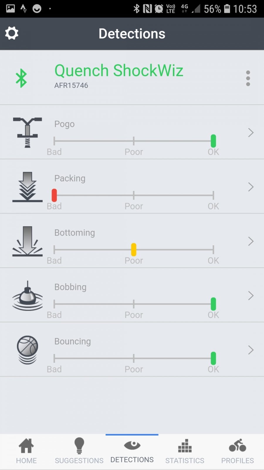

Third proper ride yesterday at Bedgebury using the shop's Shockwiz to get an idea of how the suspension setup is. A great ride, got a couple of laps done in a few hours and I'm really starting to gain more confidence in the bike. Got to really push it down into the berm and keep the weight down all the way round to avoid it pushing on.

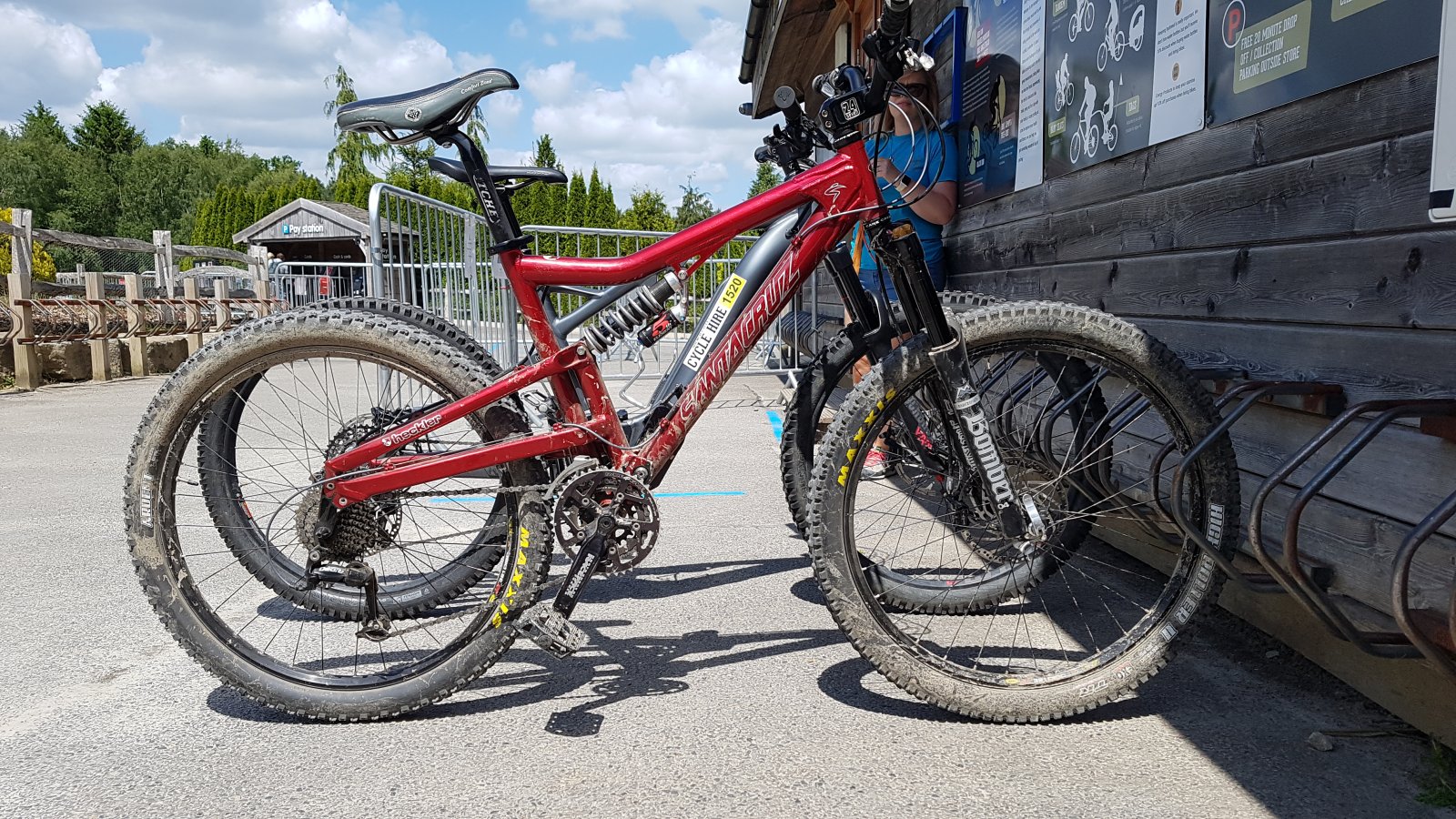

I'm not knocking acoustics, I still ride my '04 Heckler for fitness and fun - I'll always love it but it's now mostly a week day ride rather than weekends. I built it before my eldest son was born so it's part of the family. I'm still going to take it to BPW when the uplift reopens - gratuitous Heckler pic with a demo e150s behind:

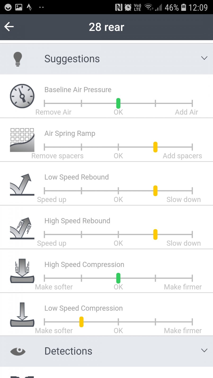

The shockwiz did show the rear wasn't working that well, even with the recommended 190psi so I'm going to try running a bit more air and making the rebound a bit faster:

The shockwiz is a clever thing. The fork is working well, it suggests maybe adding another spacer but I'd like another session with it when I get the chance and concentrate on the rear shock rather than doing both ends.

that looks like a decent bit of kit! is this a screen of the rear shock? what do they mean by "packing"?
I was able to bottom out my forks on black graded trails until it was over half way closed, i wasn't going that fast or deliberately trying to either. seems there was a reason they included 2 fork tokens out of the box, i will try and throw one token in as soon as and see how it behaves.

@Whybro Yeah that's a screenshot of the detection screen for the rear, showing what behaviour it's picked up. I didn't get a screenshot of the suggestions screen for the rear because I hadn't set the profiles up correctly and it didn't save.
Packing, as I understand it, is where you're taking big hits and the shock hasn't extended fully after the first one so the next hit happens with the shock still compressed - Rebound not fast enough, maybe not enough air pressure.

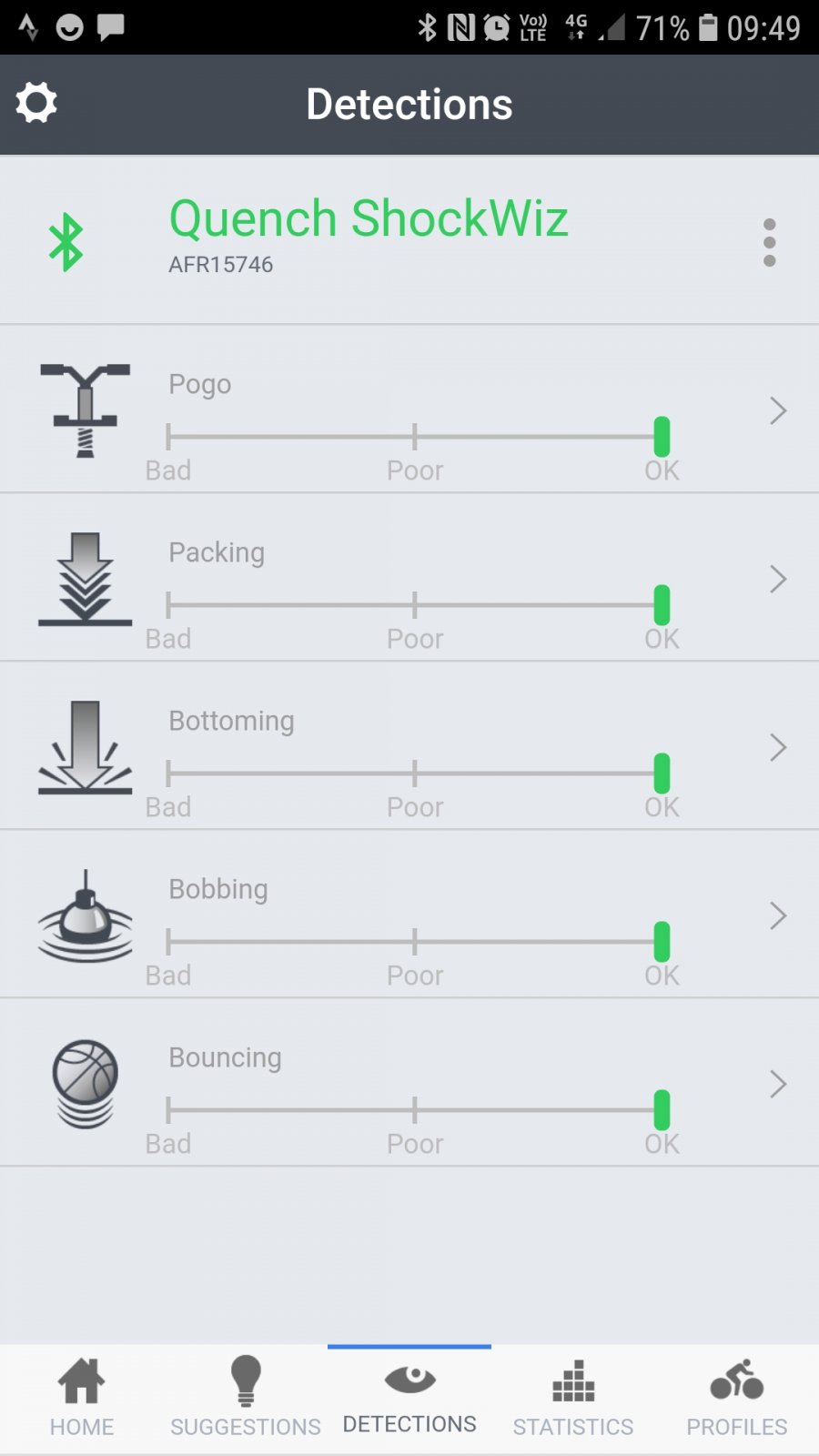

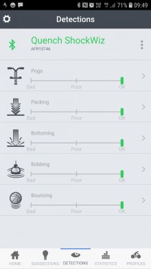

@EMTBSEAN Yes it is the little back box that attaches to the fork or shock and reads the air pressure variations as you ride. I rented it for £10 for 4 hours, they're like 250 ish new. Maybe worth buying if there's a group of you going to use it but for me just to get an idea of how my suspension is performing, the rental was fine.
You pair it to your phone via bluetooth and see the results in the shockwiz app from play/ios store. Once it's been calibrated by letting the air out the fork then extending it, pumping it up, compressing it a few times (bit of a ballache, 2 person job on the front) you get a screen like this:

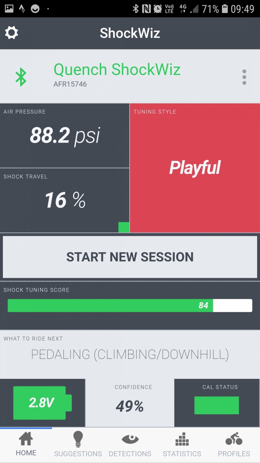

You can set the riding style you want, I've got it set for playful for 'poppiness'. Start riding and it'll feed back suggestions and detections when its got enough data, this is my front fork (ignore it saying 28 rear, my mess up with the profiles):

I think it's making a mild suggestion that I add a spacer to the fork/slow down rebound etc. Would have been interesting to see the suggestions for the rear with the packing being detected as bad, probably strong suggestions to add air pressure and increase rebound speed. Next time I'm at Bedgebury I'll have another go with it.
This is my first air shock so not sure what to expect of it, how it should feel etc so this is a useful bit of kit and pretty good for setting a baseline. Hth.
