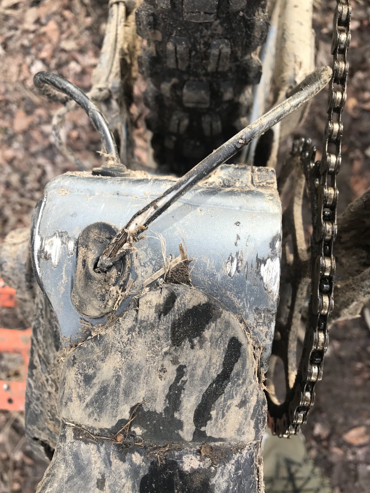

With the heatshrink, there’s different types, usually categorised by shrinkage ratio. For that application I’d suggest using the largest 3:1 tube that will shrink down to the cable size as that will give the thickest coverage and then add several layers. Adhesive lined tube will stay in place better too.

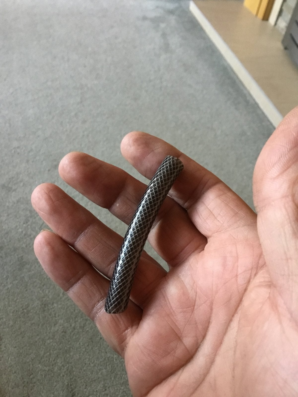

The heat shrink is not hardy enough for the job and will not last very long. Try using some of this: 3/8
It also comes in 1/4 bore and can be used as sacrificial layer. I use it at work in the Air conditioning industry.
Good luck
Thanks, I was only expanding on the previous post about heatshrink, but your idea is probably better.
I don't need it as I bought a bike that was designed by someone who was aware of the existence and rear derailleurs and the consequential need for a cable... :ROFLMAO:
Of course, all you Whyte owners could just switch to Di2 or AXS, load the Money Cannon!
Talk about double standards... bought my wife an E150s last Friday got it home when sat on the garage floor cup of tea in hand really started to struggle with the low slung cable,she’s a little less rash than me so i’m Sure she will be fine,but I just couldn’t pluck the courage up and went Levo Comp.
Where did you get the tube from, can you buy small bits, I have a bike on order and want to protect the cable from the start. So will get some ready. Thanks for the tip. (y)
Hi Mikey,
I use it at work so I always have plenty in Stock. It Generally comes in a 30 meter roll which is a bit over the top for your needs. It’s fairly inexpensive though, try here: Braided Condensate Hose 1/4" x 30m Black
Good luck
For heatshrink to work, you'd have to feed the existing cable through it. Are you doing this? that would take alot of work.
And the reinforced pipe, I take it you're slicing it, end to end, and wrapping it around the cable? Is that right?

I had an old hybrid tyre, I have cut a length out of the tough centre section.
Feathered it in so that the leading edge sits beneath the plastic bash guard, then secured to gear cable and guard with zip ties.
A bit Heath Robinson, but you can't really see it, and pretty confident it will provide a degree of additional protection.
