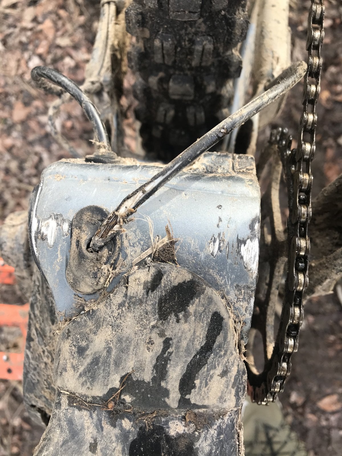

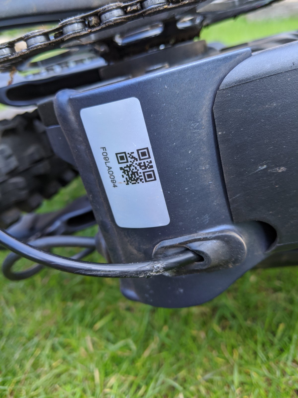

Just wondering if anyone has hit that bottom cable. I managed to do it on the very first ride out. Gutted
Yep. I’m on my third gear cable in 1000km ? thinking of whacking a strip of old tyre over it.
The bike is awesome, just needs proper technique to get over rocks (I’m working on it ?)
Hells bells man. In a weird way you have made me feel better that it wasn't just me!! Looks like it takes a beating before failing though? Have you looked at the routing the cable or protecting it? I've also asked Whyte for an explanation but no one is replying because of Covid-19.

The rubber you can get from Whyte. Mine is just there until I get some Kydex that I will shape and fit as a skidplate to cover the whole BB as it is so low.

Matthew, I had a look at re-routing the gear cable, but was put off by the task of feeding it through the swingarm. How easy was that?
Yeah it takes a beating, as soon as it’s wet then the cable will seize pretty fast. I will look at re routing it, frankly I’ll just get LBS to do it.

I was in touch with a company called rockguardz today and they have a skid plate for the e150 on the way. It doesn't cover the cable though.
How about putting the cables through something like this?
You probably could. I can get 10mm stainless steel copex in work but its just annoying that you have to on a new bike. Why would Whyte route it that way in the first place.
Totally agree, its doubly annoying on the Whyte because the put a lot of thought into making such a great riding bike, and then do the routing like someone who has never ridden rocky trails
It’s a big flaw that needs sorting. Maybe for MY21?? My other ride is an evil insurgent which I run in xlow. Never have any problems with that bike. (Evil is 334mm vs E180 336mm bb height)
The evil manuals for fun and I run the recommended 30% sag. I guess it’s always poor technique whacking the bb shell on anything, just a shame there is a sacrificial cable on the whyte!
The bb shell on my 180 is starting to look “lived in” ?
Yeah the heat shrink isn't that tough though in terms of impacts, you need something that dissipates a hit away form the cables, or at least takes the brunt of the force, and doesn't risk splitting though to the cables.
I tried the corrugated plastic tube, it was a short piece of split tube I had, secured with tie wraps, but lost it in a couple of rides. I then tried a short length of garden hose, which looked promising, but was bright (hozelock) green and yellow. Worked well but looked daft. I keep looking for black hose.
In the meantime I wrap it in multiple layers of black duct tape. It wouldn't offer much protection against a big hit. But acts as a sacrificial layer against lighter scrapes and general wear. You can tell its working by how scruffy it gets. I just top it up now and again. Working adequately for me, until something better comes along.
You haven't looked at the re routing for it? I found the other thread on here where someone has routed the gear cable out with the brake cable but I'm not sure if I have the skills for that.
With the heatshrink, there’s different types, usually categorised by shrinkage ratio. For that application I’d suggest using the largest 3:1 tube that will shrink down to the cable size as that will give the thickest coverage and then add several layers. Adhesive lined tube will stay in place better too.
Not seen any detail of the routing short of a picture.
I was going to live with it until I either had to replace the cable, or had cause to take the motor out.
I was going to look at options then.
I am a little wary, as if it was that easy, I am sure Whyte would have resolved it.
Agreed. I think the issue is that in rotating the motor upwards at the front the exit holes from the motor casing are now pointing downwards rather than aligning with the chainstay. That means Whyte's only options were to drill alternative holes in the casing (unlikely to make Bosch happy!), route over the top of the motor (potentially tricky for maintenance and might result in poor shifting) or do what they did. Not an easy one to solve.
