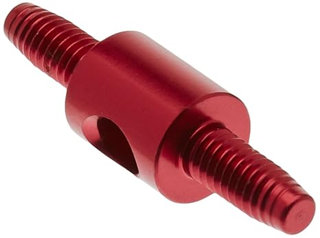

If you really don't want to drop the motor using a rockshox reverb hose joining tool. like this:
Threaded into your old and new cable outer you may well be able to pull the new outer through while carefully pulling out the old.
