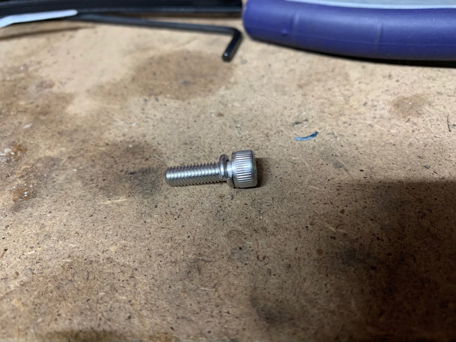

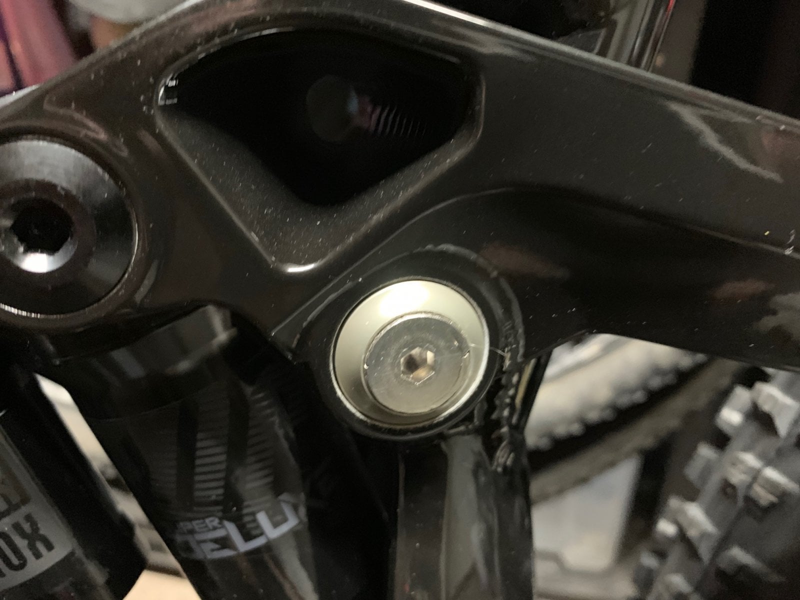

A couple questions - this was in the bike box but I cant find where it might need to go - any ideas?
Also, Is this normal for the left side - none of the other bolt are like this?
Its a spare bolt from one of the fitted items.. not sure which though.

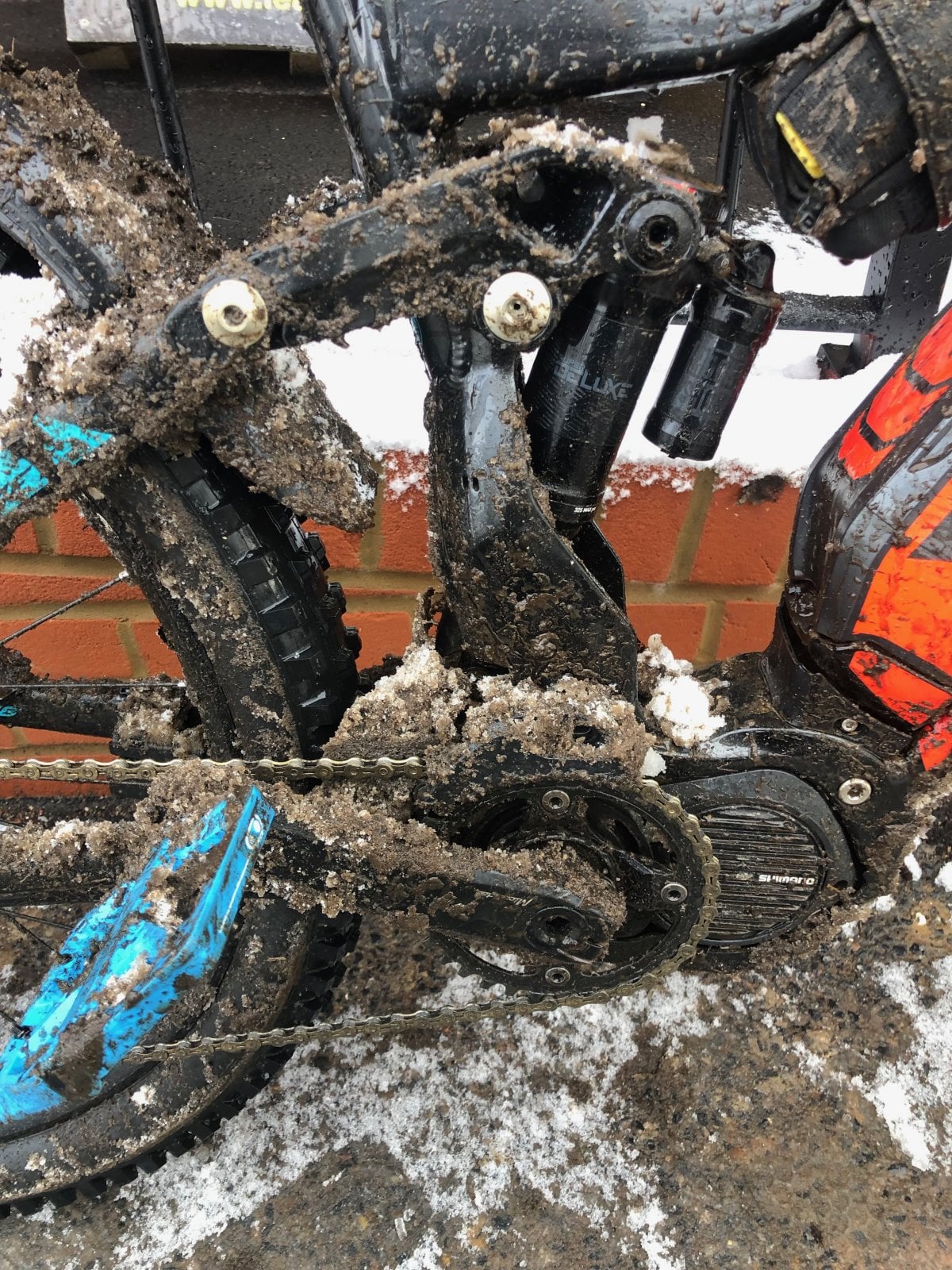

That's the V Link pivot linkage and yes its correct:
