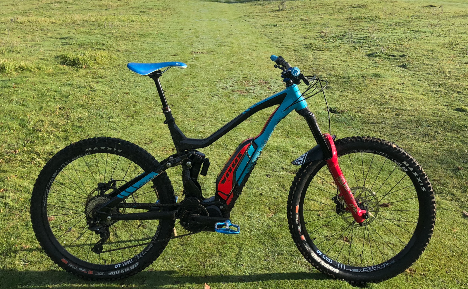

I went 180mm on mine.
The offset on the Lyric RC Solo Air that comes with the 2018 bike is 42 mm, whereas the offset on the 180mm Lyrik RC2's is 46mm (they also do a 51mm offset option).
By my calcs this has reduced the trail from 117mm to 113mm (calcs done using this
Bicycle Trail Calculator | yojimg.net )
I am no expert on these things, but the bike feels more manoeuvrable, yet just as stable. Of course a lot of this is to do with shiny new part syndrome and the fact that the Lyrik RC2 is a fecking beast, but it does genuinely feel like the mod that got the bike exactly how i want it.
