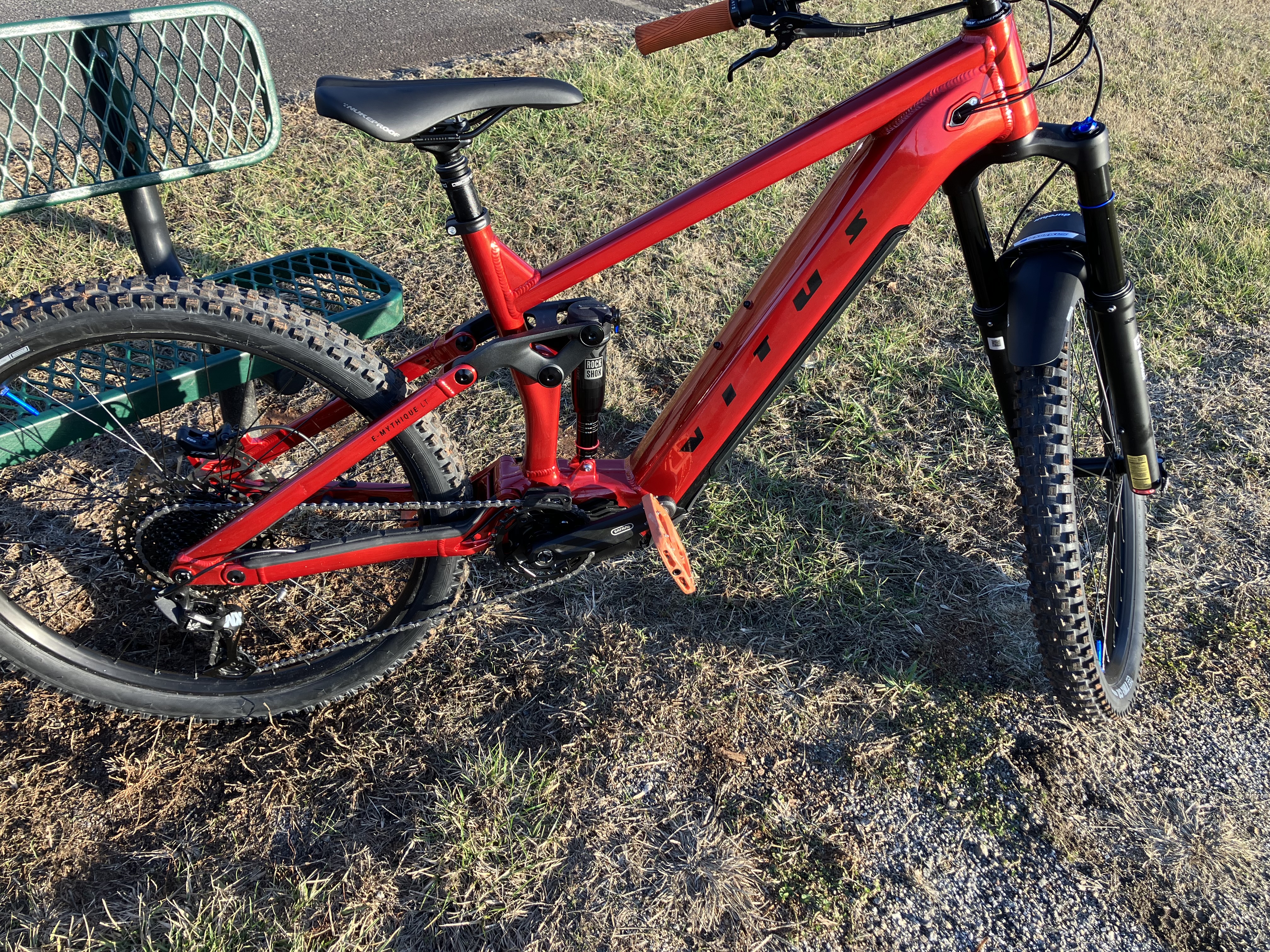

My wife and I have been looking for out next bikes for a while. Been looking at the Vitus E-Mythique, but with the problems with Vitus had me hesitant. When they shut down Vitus USA I figured all was lost. Then Planet Cyclery must have bought all the US stock because they popped up with some. It peaked my interest but I was still hesitant. Then they put them 50% off. I couldn't wait any longer. I purchased a large for myself and a small for her.
When they came it was very interesting. Her's came first. It was well packaged and included tubeless valves already installed and no tubes installed. It also did not include sealant. It came with a multi tool and charger. The dropper post was not installed at all. Only the cable housing was routed. I had to do a complete install including installing the lever and trim the housing and cable to length. It didn't bother me because I usually have to trim the housing down anyway. They are normally way to long and make tidying the cables difficult. I pulled the tires off the rims to install her preference of tubeless valves (amazon valves that I really like in her favorite color, purple). I installed cushcore pro in her rear tire while I had it off. The casing of the rear tire is very stiff. I just installed to Maxxis double down tires on another bike and the rear Vee tire is very comparable in stiffness.
Mine came a couple days later. It was packaged well too. It had the dropper post already installed and completely mounted. It did not come with a multi tool or sealant. Mine also had a small dent on the seat stay. Not enough to see, but you could feel it. It doesn't bother me and there's probably nothing I can do about it since there's not another large for sale in this country. I had ran out of sealant and had to order more. When it arrived and I went to install it in the wheels, my leaked from almost every spoke. I had to untape and retape the wheels on mine. I had to dial in the shifting and brakes on both bikes.
Went on our first brief 10 mile ride this evening. First impression are very good. The rear suspension is super supple and reactive. The fork is okay. There's a loud clunking that comes from the fork on bumps and drops I haven't been able to figure out. I'm going to turn the compression up some tomorrow and see what happens. Usually as a big fellow I have to leave fork compression open almost all the way. I followed @Zimmerface recommendation and set the rear shock up to 32% sag. The ride at this setting is nice and supple but I'm going to need some tokens. I used over 80% of the shock and didn't do any big jumps or drops today.
The tires were surprising. I'm usually a Maxxis or nothing guy, but I don't hate them. The front feels grippy and soft. My son was riding my old bike that has Maxxgripp tires on it and they collected mud much worse than the front Vee (Monday and Tuesday we received 5 inches of rain in 48 hours). That generally means it's not quite as soft. The rear is a little hard but seems to do well.
The brakes bedded in well. They are surprisingly good. I had to do a lever bleed on the wife's front brake to get a consistent feel with the rear lever. It's been good since. They don't blow me away, but I haven't wanted any more.
The bike handles incredible. I have a Yamaha Moro (full 27.5), a Polygon Mt.Bromo (full 29er) and now the Vitus. The Moro feels like a kitchen knife, okay at everything but great at nothing. The Bromo feels like an axe. Incredible good at plowing and doing its job as an enduro racer. The Vitus feels like a scalpel. Although all the bikes should weigh the same (I haven't scaled them all personally, but I will), the Vitus feels much lighter on the trail. It turns like a dream and is easy to lift over obstacles. I rode most of the ride in Eco and felt that was plenty. I finished the last of the ride on trail to play around and holy cow this is a fast bike. I like the feeling of trail and it really feels dialed in well. Powerful but not overpowering a tight single track. I found myself not needing to downshift nearly as much or at all. It was really impressive. I will probably ride in Eco normally, but bump it to trail to blast around.
I'm not to impressed with the drivetrain and it'll probably be the first thing to go. It does everything I ask of it but nothing well.

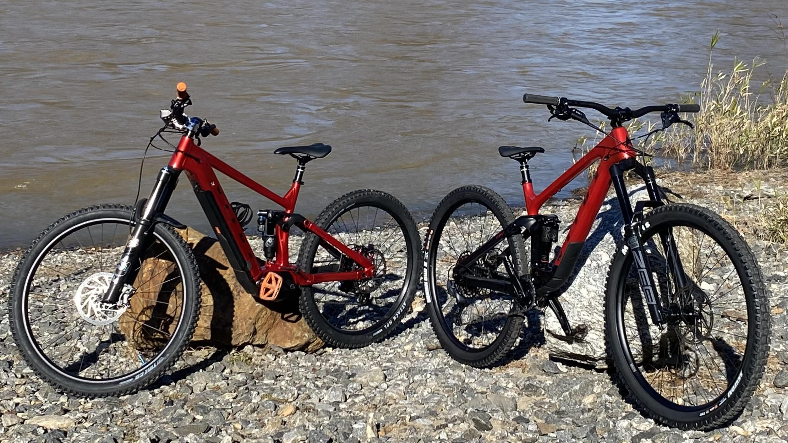

We are going to doing upgrades over time and will document them here. The build plan for the bikes are;
Wifes
PNW Grips and Pedals
Diety 50mm riser bars (transferred from her old bike)
Diety stem
Marzocchi z1 coil fork
Marzocchi Bomber CR shock to eventually be tuned by Avalanche
Shimano SLX drivetrain
Shimano SLX 4 7120 brakes
Ergon saddle
170 dropper from my bike
Nukeproof Neutron wheels with Maxxis Assegai DD Maxgripp and DHR2 DD Maxxterra
Mine
PNW grips and pedals (also clipless from time to time)
DMR stem
Fox 38 factory
Fox DHX fractory
Shimano XT 8120 brakes
Shimano XT drivetrain
Ergon saddle
Fox factory 200mm dropper
Hunt All Mountian wheels and Maxxis Assegai DD Maxgripp and DHR2 DD Maxxterra
The plan is to keep these bike for a long time. With the ability to keep the electronics going for years we should be good. I'm extremely happy with the bike and can't wait to get it out again. My wife on the other hand said hers felt small and had a hard time finding her power setting. She doesn't handle change well and needs a little more time on the bike.

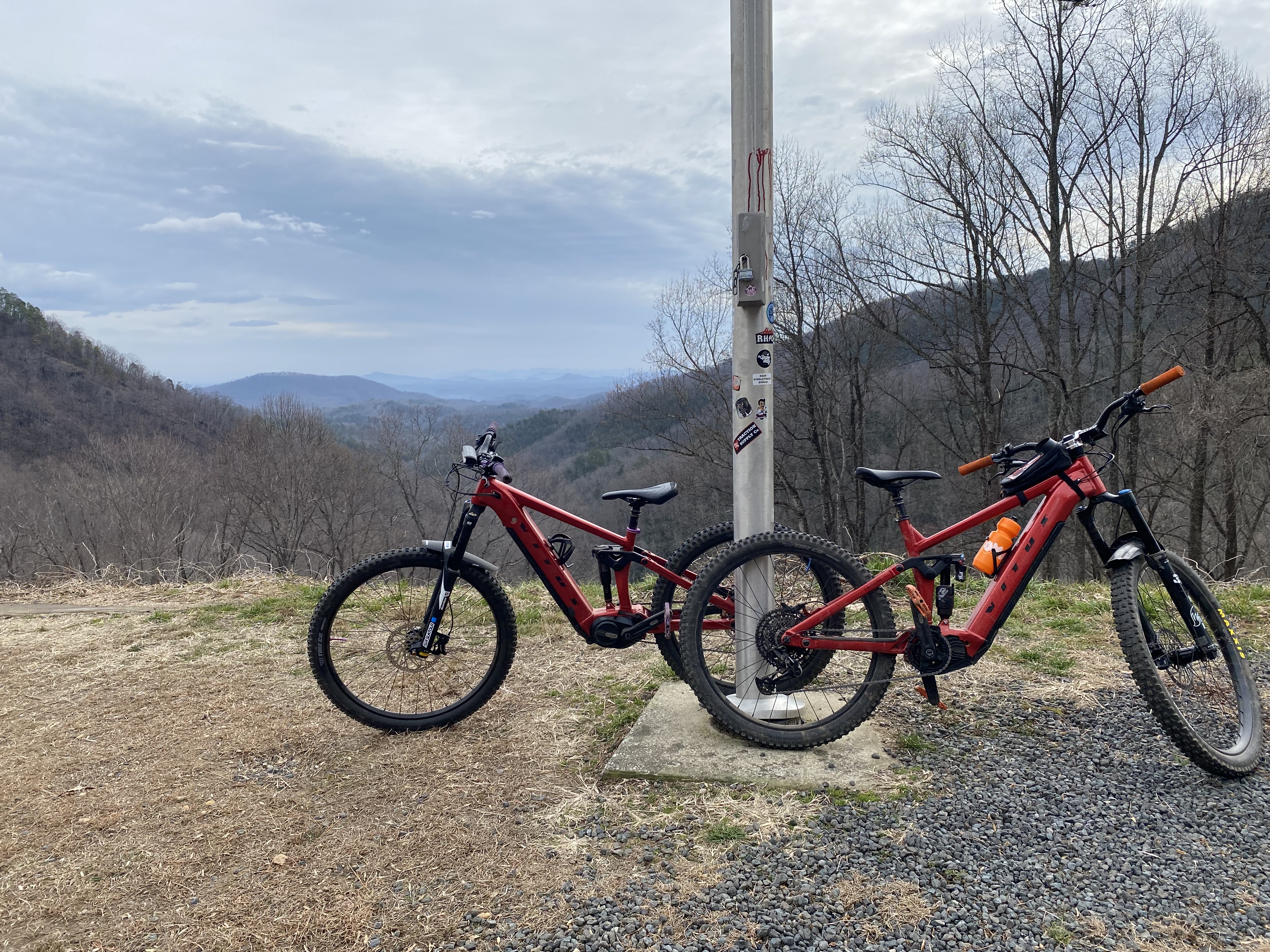

Went on a weekend trip with the wife and put another almost 100 miles on the bikes. Got a really good feel for everything on several different trail styles from cross country adventure style riding to black diamond natural downhill trails. The more I ride the bike the more I like it. Its really nimble and flick-able in the turns and handles the rough well.
I was still riding the borrowed 160mm fox 38 performance and the x2 performance elite. Really like this combo. I mentioned in the fork and shock thread that I picked up a 170mm performance elite fork for my bike. I'm going to get another x2 performance elite for mine also. I think this will stay true to the "budget brawler" theme of the bike. I also mentioned I'm thinking of trying a coil. The guys at Vitus seem to like this bike with a coil.
I stuck the front wheel of another bike on mine that had a DD Maxxgrip Assegai for the trip. Did not notice how bad the Vee's were till I put a good time on there. Either my go-to tires (DD Maxxgrip Assegai/DH Maxxgrip DHR2) or a set of the new continental's will make their way on the bike very shortly.
We did one day that was over 20 miles with 3500ft of climbing and descending. Its a single climb trail with 2 different downhill trails back to the bottom. The climb is about 6.5 miles on the first one. We put the bikes in trail and averaged 15mph up the climbing road! It was great! Then we got ready to do the downhill trail and I realized we had used over 40% battery on the first way up. I started to get worried about running out of battery so I put the bike in E+ on the downhill and then made the way back up the return road on E (averaging around 6mph). Finished the rest of the ride (which was around 15 more miles) with 30% battery left. E really sips the battery.
Had a few minor issues with my bike, but none with the wifes. About 1 mile into the 20+ mile day my crank started feeling odd so I looked down to check it out and it fell off! The crank retaining bolt was missing. I put the crank back on and tightened the pinch bolts down and continued on. I had to stop and tighten them one more time during the ride. The crank looks good but I'm going to replace it for peace of mind. Besides, its 12 dollars for 2 crank bolts or 25 for 2 cranks and bolts. I have a set of 152mm cranks and bolt on the way. I will put those on the wife's bike and sick her cranks on mine. Then we'll have a spare. Then when I got home and was unloading the bike I realized the knob to release the battery was missing. It must have fell off somewhere. I'm struggling finding a part number for it currently. Its not a terrible deal because I currently cannot remove my battery due to me being a dummy and leaving the keys on the bumper and driving off.😡
The brakes have continued to impress me. We had one point where we descended 1300ft in less than 2 miles. They were smoking hot but never faded. My wifes got to the point where you could smell them. Still worked well. Still running the factory resin pads. I definitely want to upgrade to the TRP DH Evo's to get more power. By the bottom if the big trail my pointer fingers were tired!
I still cannot get the drivetrain to shift clean, crisp or quick. Still really not happy with that.
Overall I'm VERY impressed with the bike. Cannot wait to get the builds complete and more miles and trails on this bike!

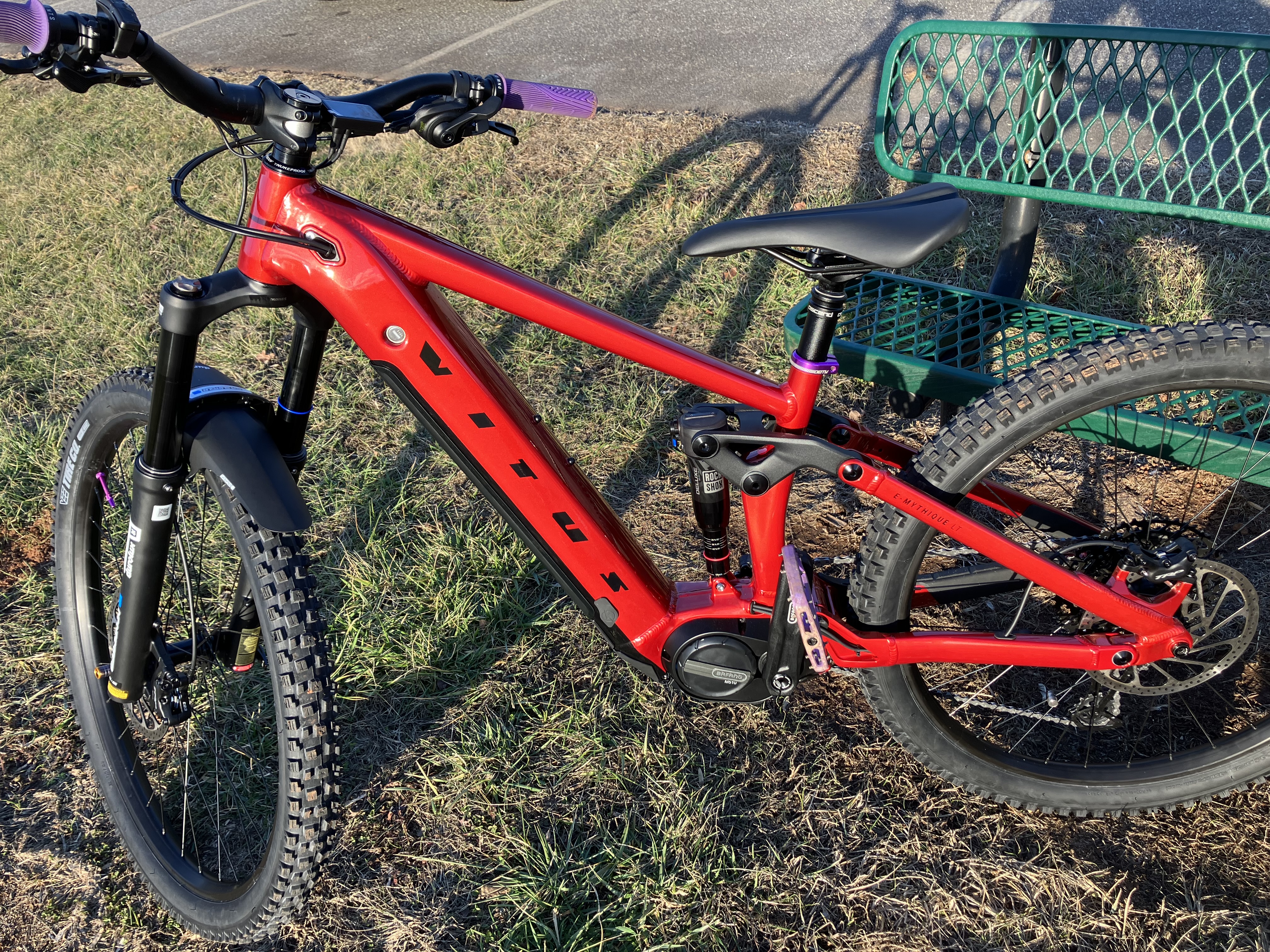

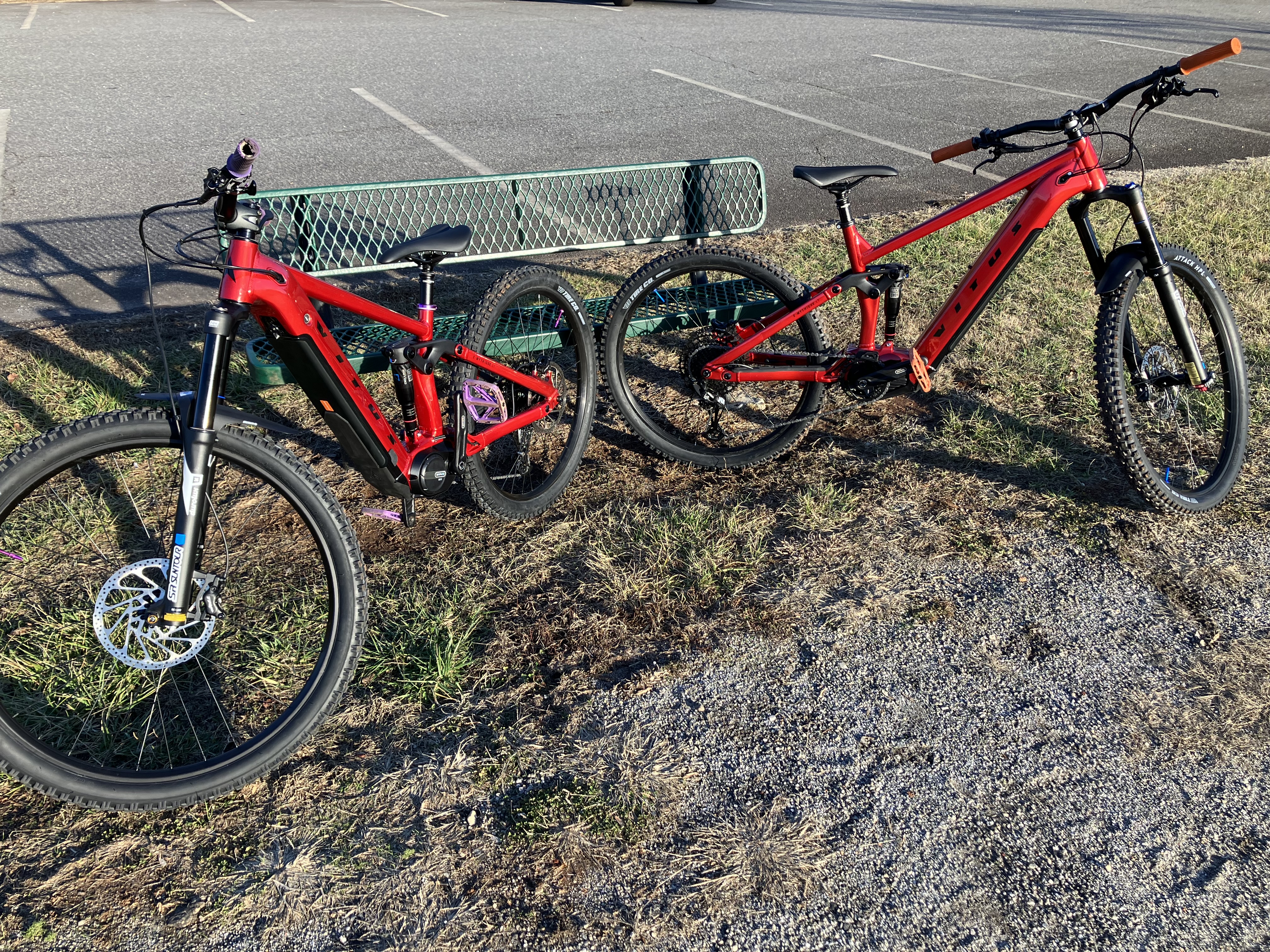

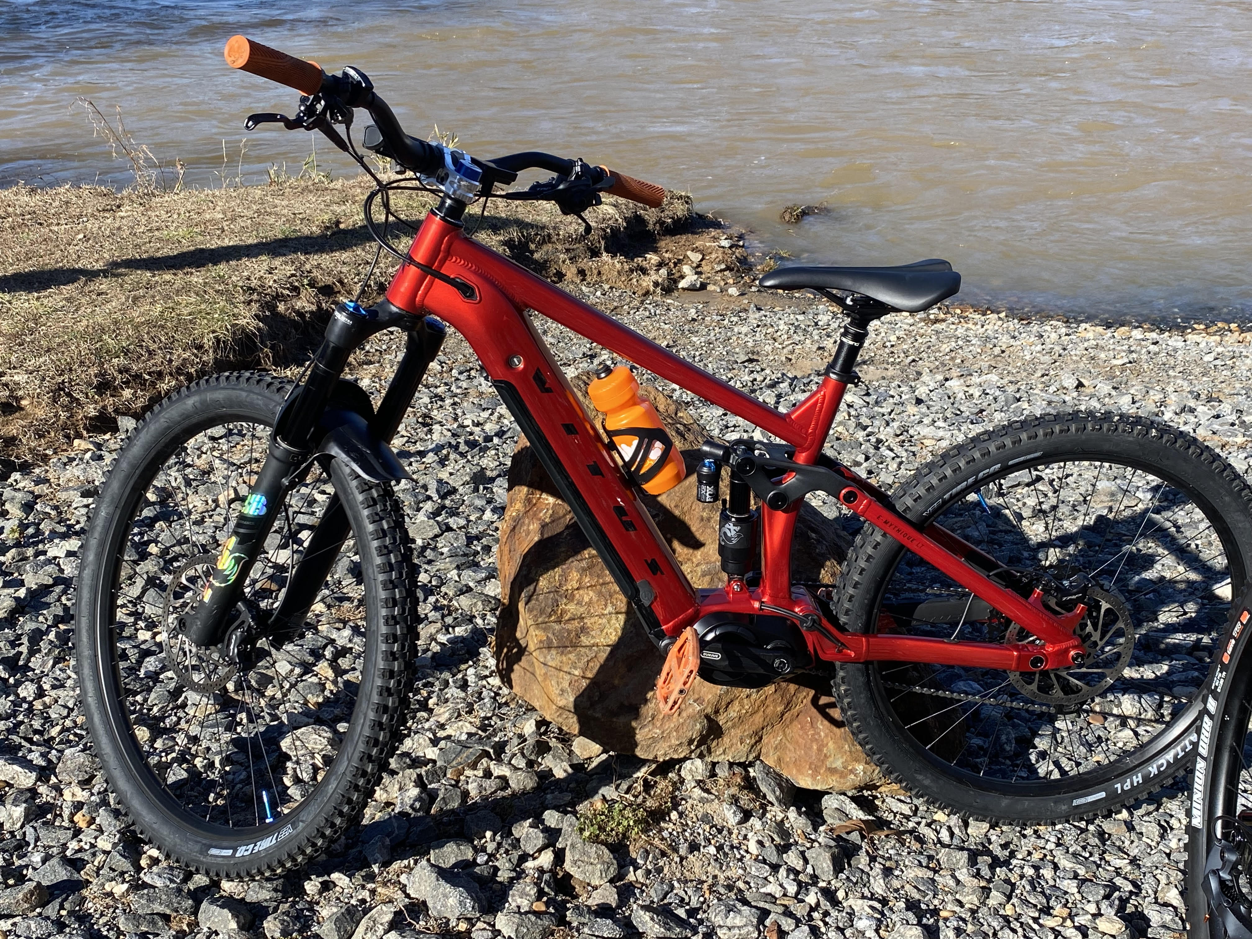

Got 260 miles on the bike so far. Still really loving it. It has received some upgrades. Planes changed on my bike due to finding some deals on parts. The plan was fox performance elite stuff all around but fox had a major sale in the US. It was less than $100 difference from the fox factory to performance elite so I splurged on mine. Picked up a fox factory 38, fox factory DHX and fox factory dropper for less than $1000.
First, I'm in love with the coil. It rides so well that major square edge roots now feel like braking bumps. Its incredible. Every ride out I am getting PR's or setting records. I feel like the bike can handle anything.
The new suspension has me riding so hard that I've bent the rear wheel. It may be fixable, not sure. I've dropped it off at my wheel guy but since its spring he's 3-4 weeks out. Luckily I had a set of Nukeproof Nutrons I was going to put on the wife's bike so I swapped them on with some random Maxxis tires I had. They are both just EXO tires and I'm struggling with that. I have to run 35-40psi to keep the rear from squirming while riding hard. Two rides on the Nutrons and the rear has a little wobble and a loose spoke already :( I'm gonna need a set of STRONG wheels, DH casing tires and probably rear cushcore.
That brings me to the negative. The bike is now pretty heavy. Much heavier that I was expecting. I didn't weigh it stock (I really whished I did now) but it now weighs 59.6lbs! I really did not expect it to be that heavy. Now the wheel thing makes sense.
I received my parts from Bafang and swapped in the new upper battery mount. I dumped all the pins out of the lock so it now can be turned with anything. I'm waiting to make sure everything is good before I do the wife's. So far its been fine on some back diamond trails with several 3-5ft drops. Also picked up a spare display with the new Bluetooth 5.1. So may play around with Go+. Also got a BESST tool on the way.
Also did the @Zimmerframe rear pivot guard with a spare front zip tie fender. Seem to work well!
I still have wheels, tires, drivetrain and brakes to go but the bikes are getting there. These bikes are great. I'm glad we got them as cheap as we did. When done I should be around $4500 in the bike all together. For the way this thing rides nothing can touch that.

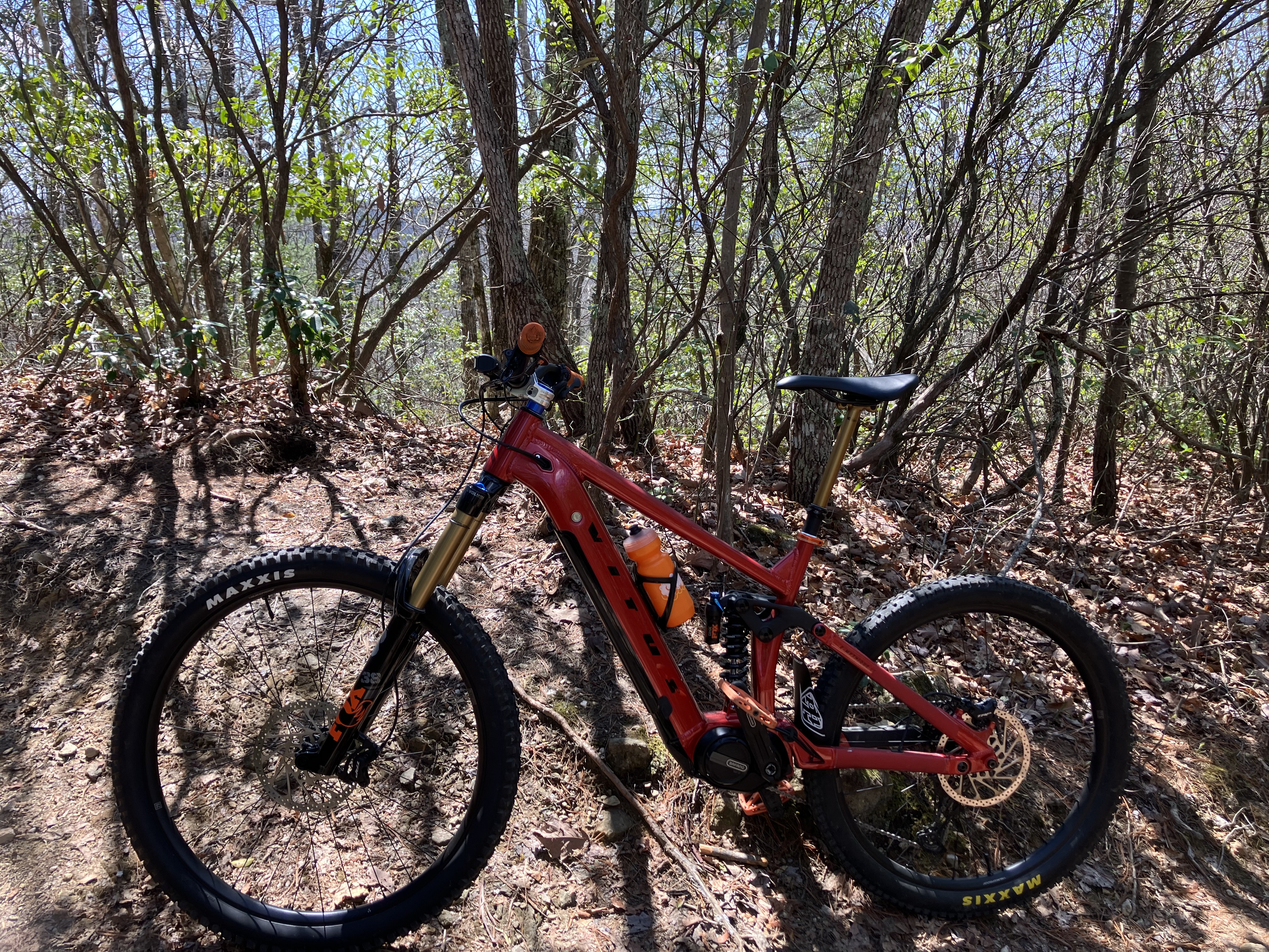

No pics but I wound up with Hunt All-Mountain wheels and Maxxis DD tires. Made a huge difference. Really happy with them.
Also picked up an XT shifter and derailler. Installed that and used the Sram cassette and chain. Everything seems pretty happy. Doen't shift quite as quick as hyperglide but its better than the NX crap. I never could get the shifting where I was happy with it. When the Sram stuff wears out I'll swap hyperglide stuff on.
