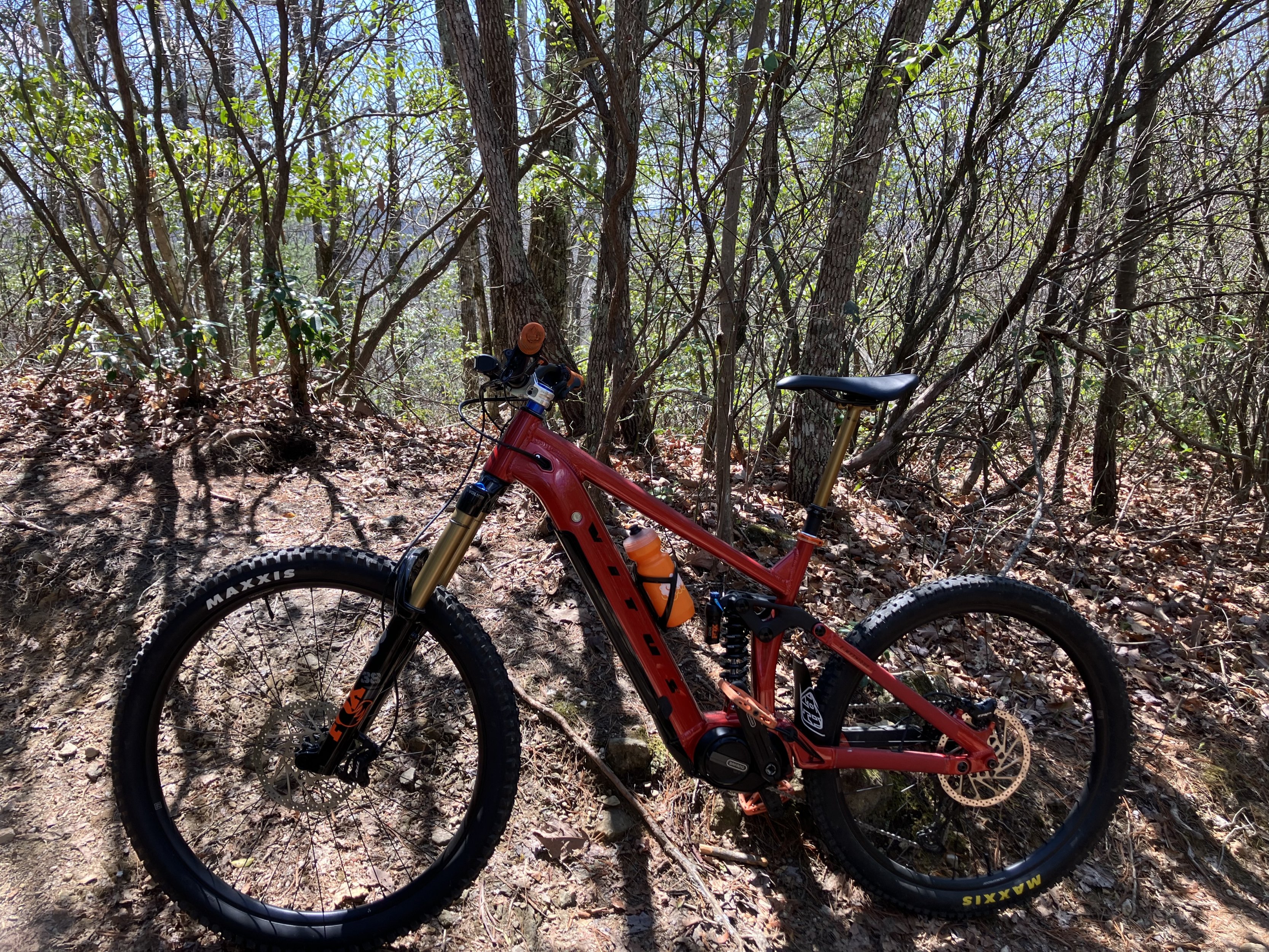

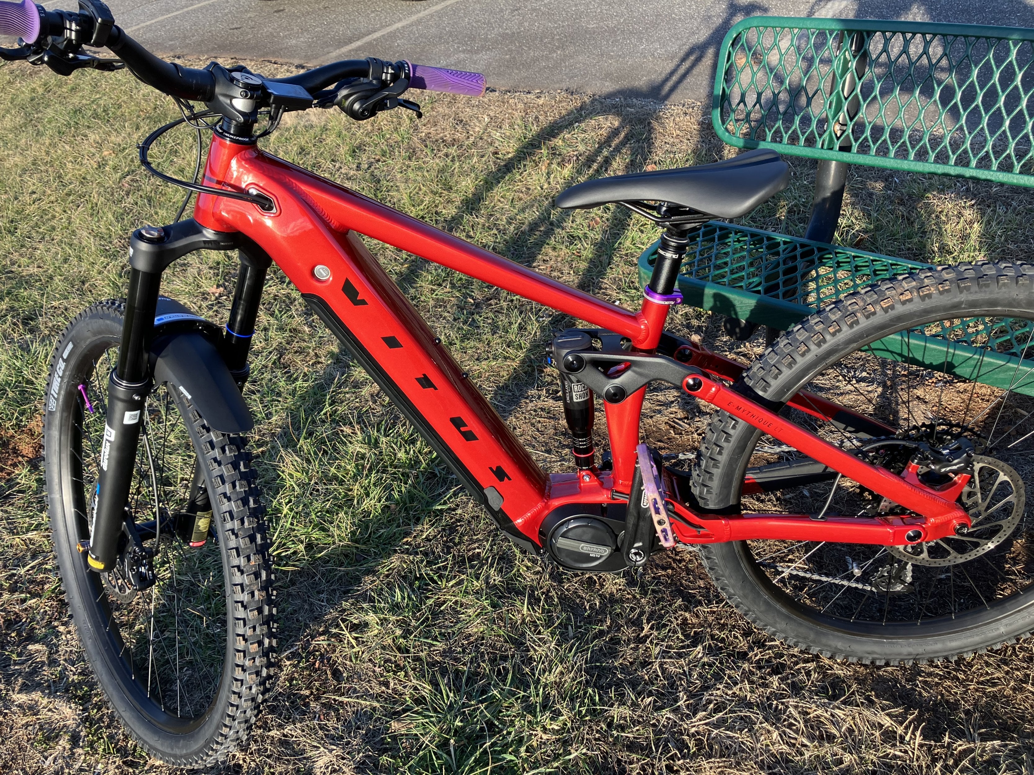

We are going to doing upgrades over time and will document them here. The build plan for the bikes are;
Wifes
PNW Grips and Pedals
Diety 50mm riser bars (transferred from her old bike)
Diety stem
Marzocchi z1 coil fork
Marzocchi Bomber CR shock to eventually be tuned by Avalanche
Shimano SLX drivetrain
Shimano SLX 4 7120 brakes
Ergon saddle
170 dropper from my bike
Nukeproof Neutron wheels with Maxxis Assegai DD Maxgripp and DHR2 DD Maxxterra
Mine
PNW grips and pedals (also clipless from time to time)
DMR stem
Fox 38 factory
Fox DHX fractory
Shimano XT 8120 brakes
Shimano XT drivetrain
Ergon saddle
Fox factory 200mm dropper
Hunt All Mountian wheels and Maxxis Assegai DD Maxgripp and DHR2 DD Maxxterra
The plan is to keep these bike for a long time. With the ability to keep the electronics going for years we should be good. I'm extremely happy with the bike and can't wait to get it out again. My wife on the other hand said hers felt small and had a hard time finding her power setting. She doesn't handle change well and needs a little more time on the bike.

I had to remove my wife's motor to install and adjust the dropper post. I noticed the wiring was very neatly routed and much easier to install and remove the motor than the yamaha. The cable housing would not slide up the seat tube by pushing it. It seemed to be dragging on something near the lower battery mount. I wanted to unscrew it and see if I could move the cable housing but the screws that hold the lower battery mount are behind the glued on pad. I don't really want to mess with gluing it back down.
