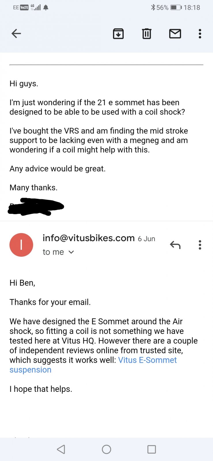

I can also confirm that the paint is pathetic on the blue bike. Literally every ride it was coming back with new scratches without any crashes. Luckily the marks have been hidden with the Invisiframe kit and now it doesn't mark so easily. It's easily the easiest bike to mark that I've ever had and I'm not one to normally mind a few battle scars but I couldn't leave it to get worse.
Cracking little bike though. The rattle doesn't bother me as its normally only heard when going downhill. I did find the rear shock to lack mid stroke support and had to fit a megneg which has helped a lot. I'd love to coil it but am scared the suspension design won't work.

The leverage curve is a lot more progressive than the old Esommet and it seems pretty clear Vitus chose to change it for the sole reason of making the frame compatible with coil shocks. I'm surprised you were struggling for mid stroke support with the stock air shock. Before fitting the MegNeg Did you try simply running a little higher shock pressure and running less sag?
Honestly I did, yes. I found the higher pressure and lower sag to just feel harsh off the top. The megneg has helped a lot. I even messaged vitus about the coil and the reply said that the bike had been designed around an air shock and that the coil was not tested by them. Bike feels great now but deffinately lacked mid stroke support.
hmm... interesting. that's exactly what Vitus said regarding the 2018/19 ESommet despite Brayton riding a 2019 with a coil shock. I just had to look back and check you were talking about the 2021 ;)

Yeah. That will always be the trade off when increasing spring rate and reducing sag
hmm... interesting. (that's exactly what Vitus said regarding the 2018/19 ESommet). I just had to look back and check you were talking about the 2021 ;)
Just to confirm ?
This was whilst I was still setting up the megneg and trying different bands etc.

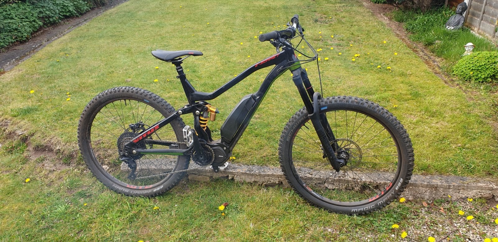

Just to confirm ?
From the vitus site....
"Leverage Rate: We've straightened out the curve on the E-Sommet vs the 2020 versions and increased the progressivity from 8% to 25%. This change improves small bump sensitivity and mid stroke support. The increase in progression also helps with end stroke control and allows better compatibility with coil shocks."
I've put a fox x2 on mine but got the horn for an 11/6 or Ohlins
