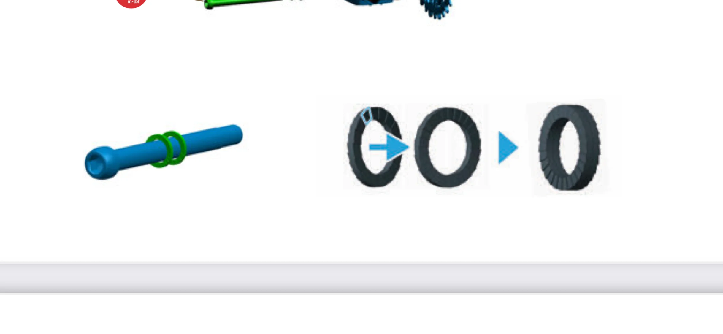

Does anyone have an official fix for the motor creaking? Mine creaks badly. There were no shims installed from the factory. Bolts and motor contact points are greased and torqued to spec.
A video of the creaking is attached in the Google Drive link:
Speak to your dealer. Ask them for the top hat washers. They say to put them on the outside. However, put them on the inside. I used a very small amount of epoxy under the brim of the top hat washer. Bike was totally silent after that. Washers then also act as a shim too. As I'm on the M1 I also added the STFU chain silencer to the chainstay, reduced motor rattle at least 50% through reduced chain slap. I was pretty stoked with the noise reduction.
so you put those inbetween the frame and the motor? or additional ones?
Does anyone have dimensions of the filling rings? And what material are they made of? Maybe order washers somewhere before the frame is delivered. Anyone else info about the European container that will be delivered? Cheers!
I was told end of May…

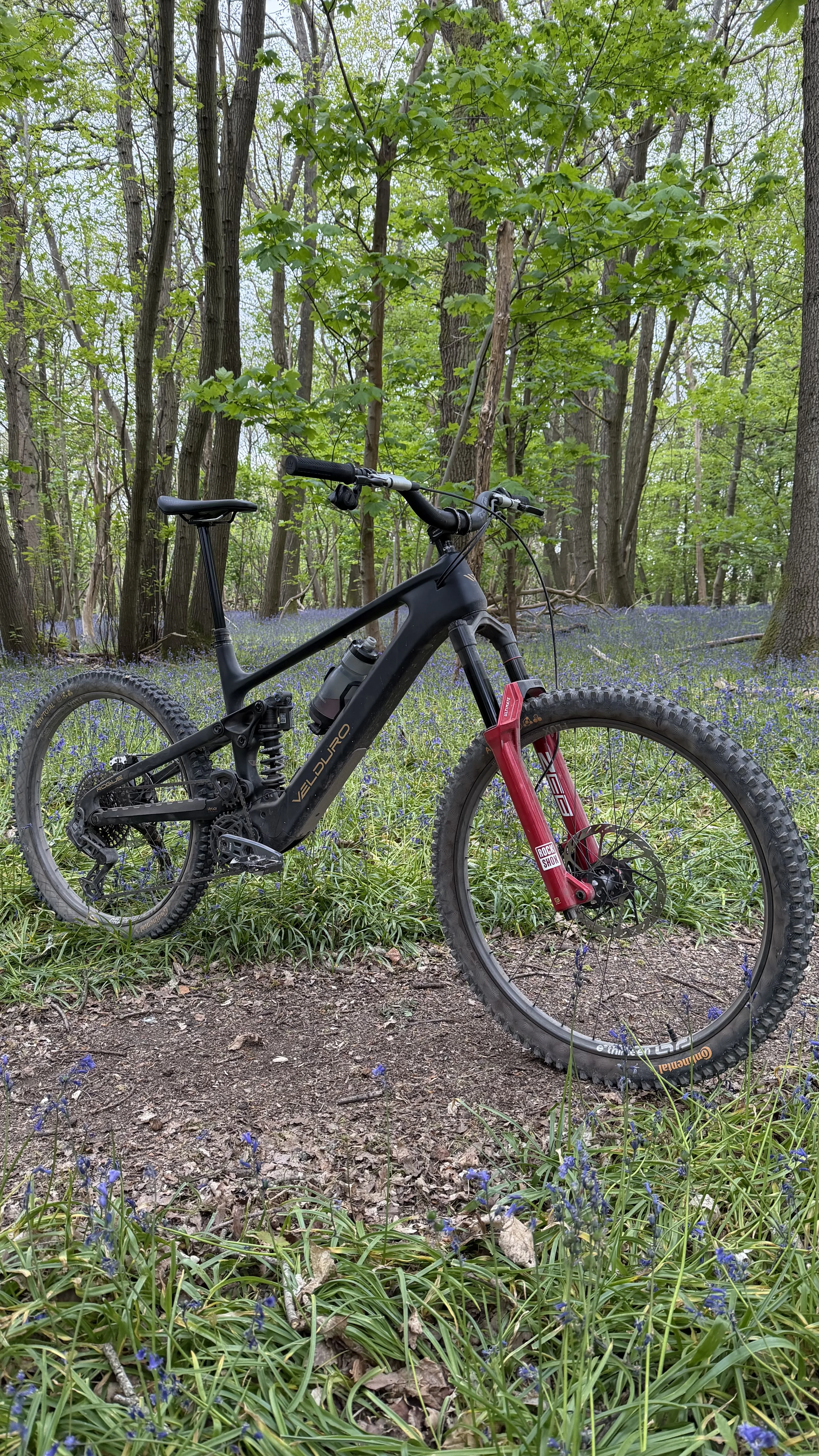

Decent ride today to get my bike dialled in. In fact it was superb from the outset.
Suspension is excellent - small bump, bigger impacts, all excellently handled. Jumps with high confidence. Suspension in more poppy than I expected, 500lb spring helps so thinking I’ll just keep it (even though it’s a bit heavier than I need).
Rear suspension is well damped, ramps up quickly in the PRO setting and gives approx 170mm of travel in this configuration.
Running it with flip chip in 29er, with MX setup drops the BB a bit too. Handled some fast flat loose corners well.
There’s a little bit of noise from the idler, not bothersome, but noticeable over the other Avinox bikes I’ve tested.
Stack is low, so 70mm riser bars help a ton here. Was thinking of trying with 180mm out front to raise it up a bit, but rode so well today I don’t want to change the balance before I test it some more.
