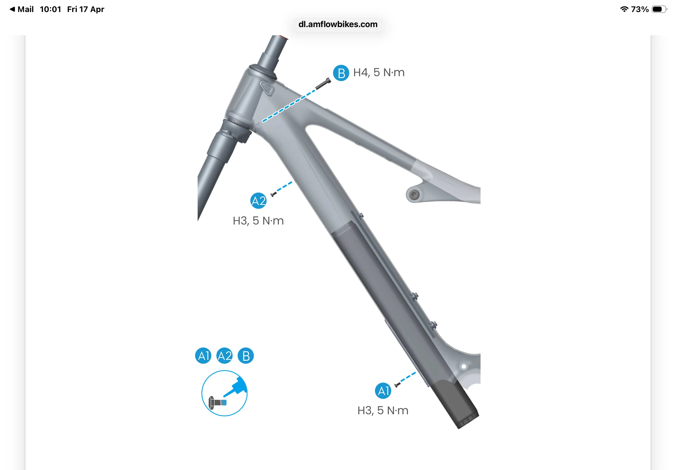

More importantly… the top battery mount bolt is missing - is it some where in all the parts?
Build has started
Hi, on the Amflow Pl the 600wh battery is attached via the top bolt A2 (missing on yours) and the one lower down near the bash guard A1. On the 800wh battery the top battery fastening is done right at the top under the display B. See picture. I presume this explains your situation but this is best guess. Should say in your manual. 👍

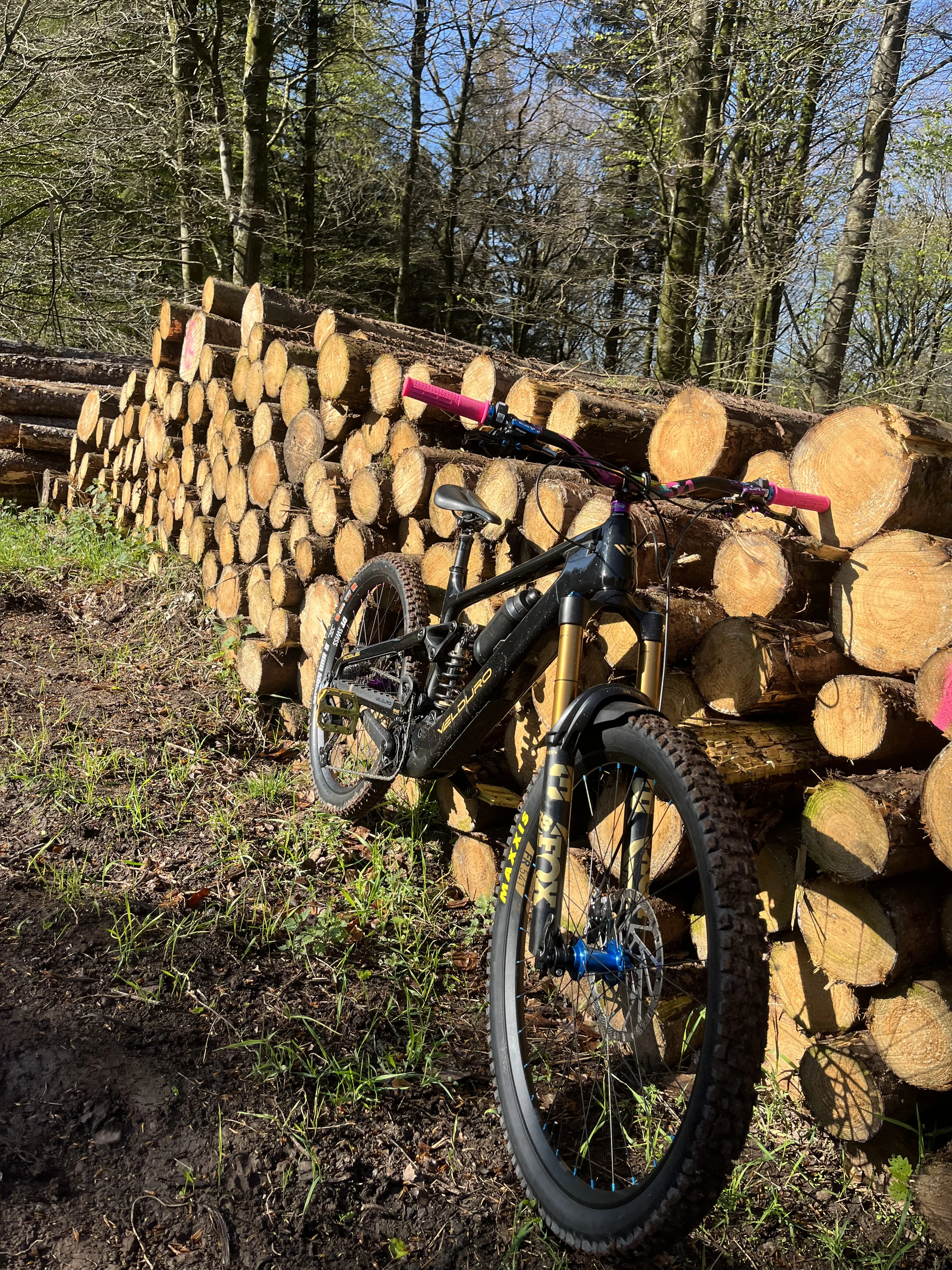

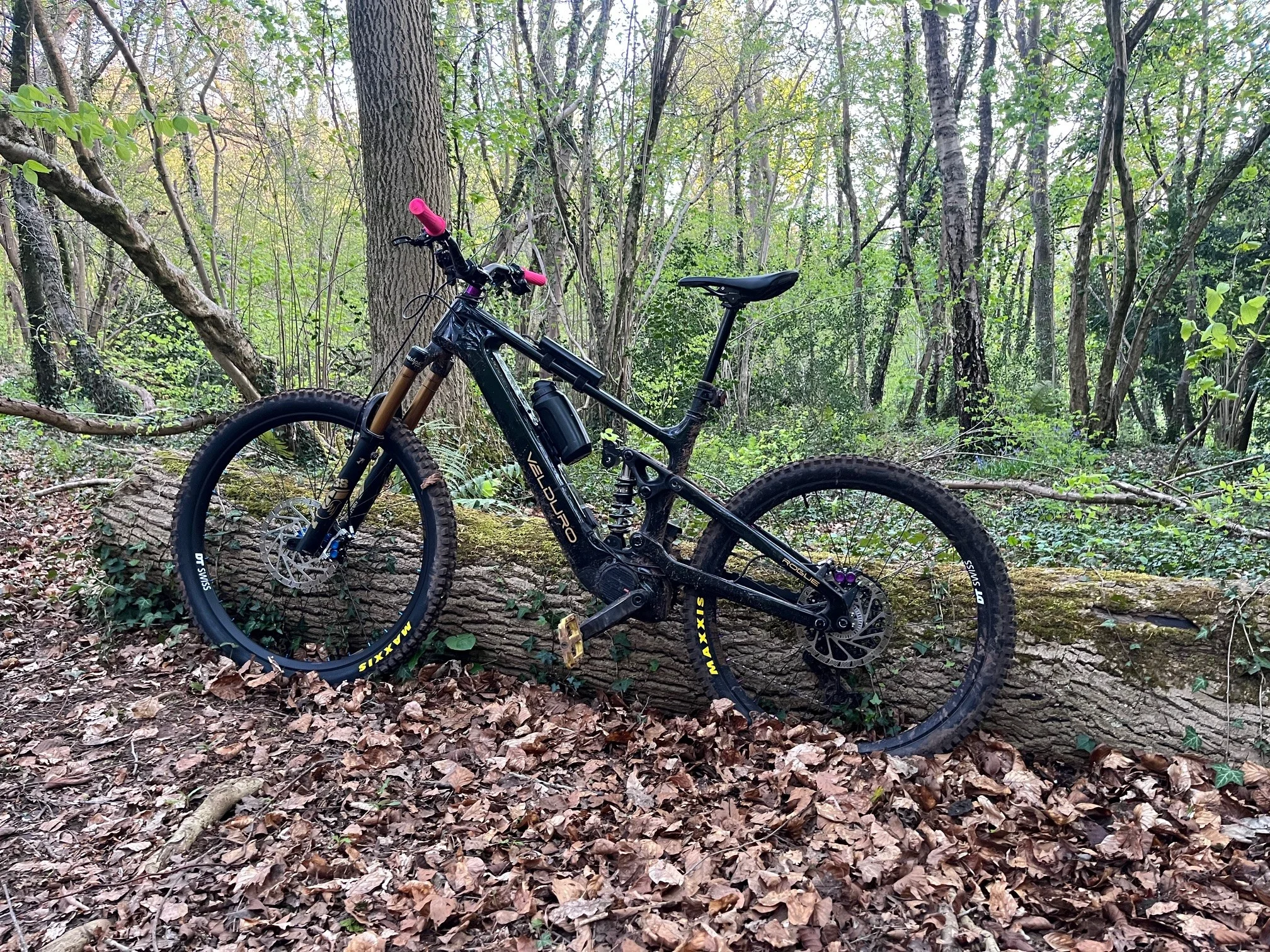

I’m built!!
Just some bolt checks and gunk in the tyres and 1st ride tomorrow 🎉
Some hose/cable trimming and may upsize my dropper as 210 is to low at full height to be done as well but that can wait

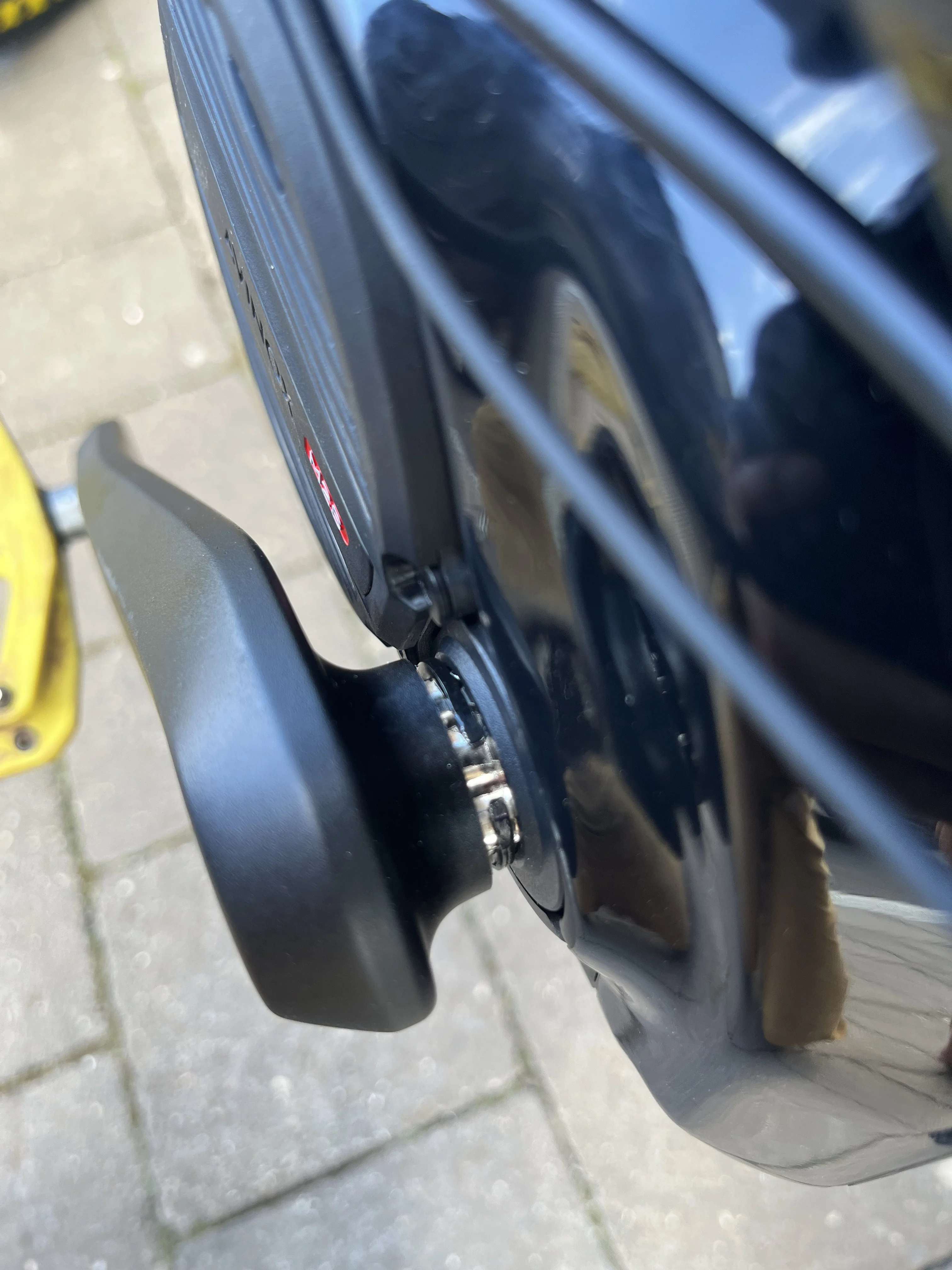

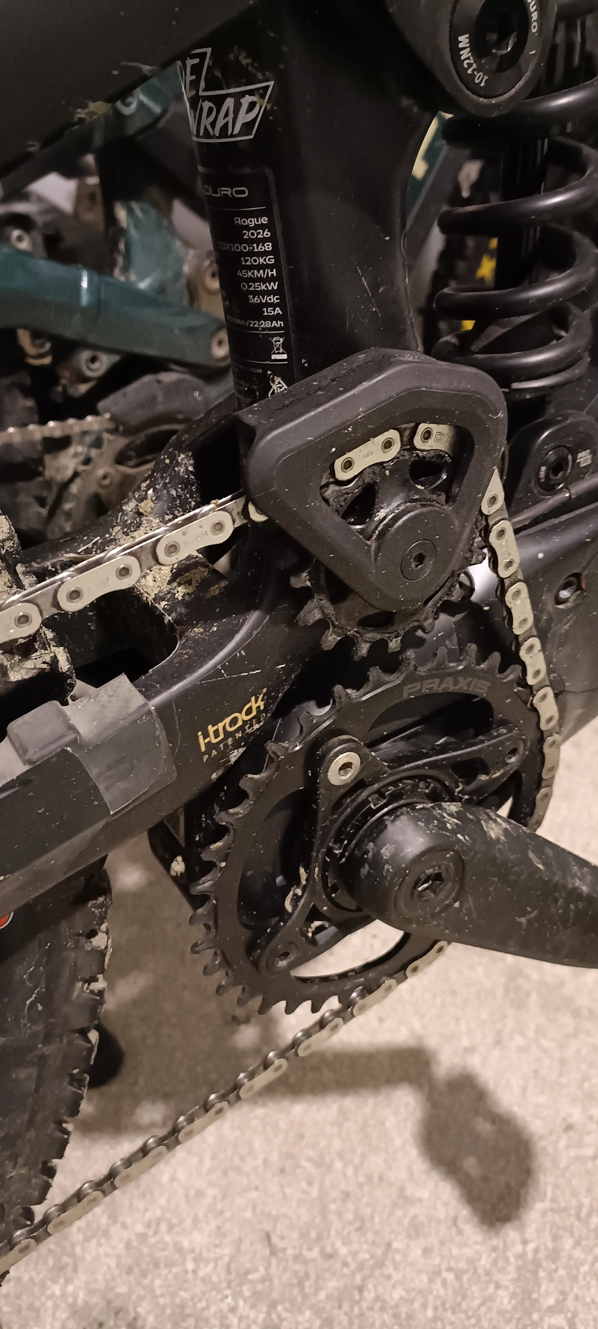

Does the non-drive side crank arm pull on more than this? It feels tight but has lots of space behind.
I’m built!!
Definitely. Looks dry. Did you grease it as per manual?
Ive snapped a crank bolt by swinging on it before so use a torque wrench to 50nm.
Dave this is definitely not on enough mate. I built mine up like this, creaked like heck. It will go on far enough so you can just see the grooves. At least 2 to 3mm more looking at this. The Avinox cranks are built from average aluminum too and mine kept backing off even at 50nm. I put a very small amount of thread lock in the spindle and problem solved too. Enjoy your first ride!!

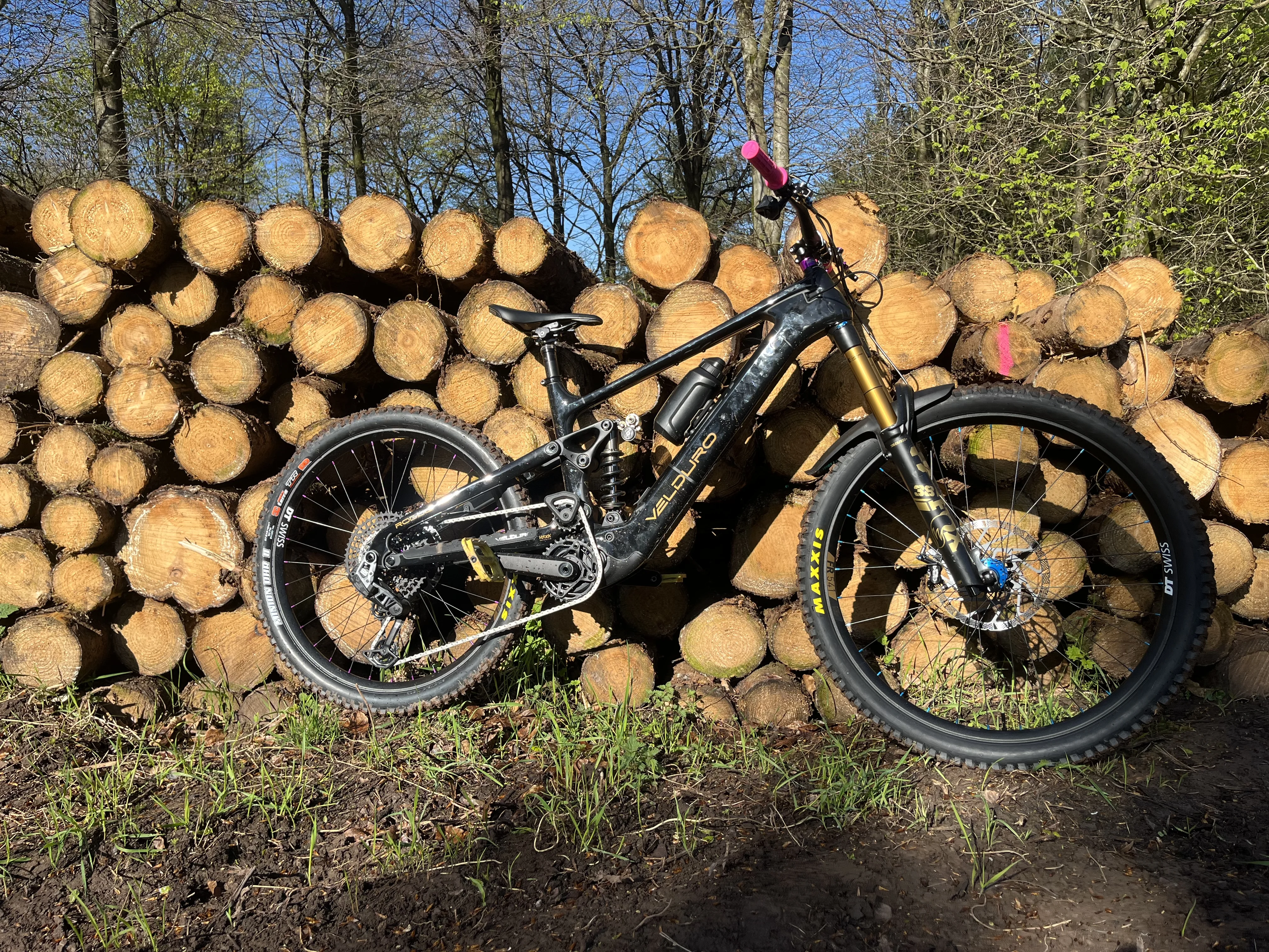

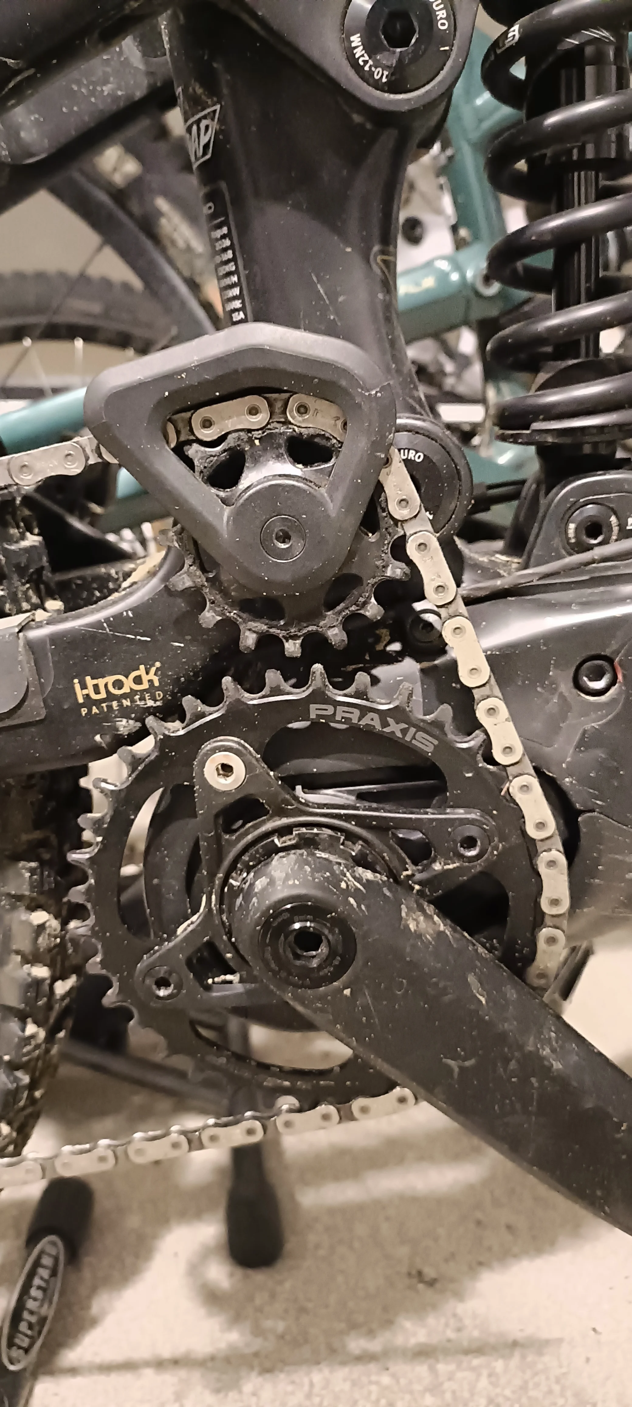

1st ride with the Praxis 36t chainring. Seemed a lot quieter - at times the idler gear noise seemed non existent, at other times it was there but only just. Did 2 PBs on Strava but couldnt say these were due to the chainring - more likely that the trails were damp and therefore grippier.

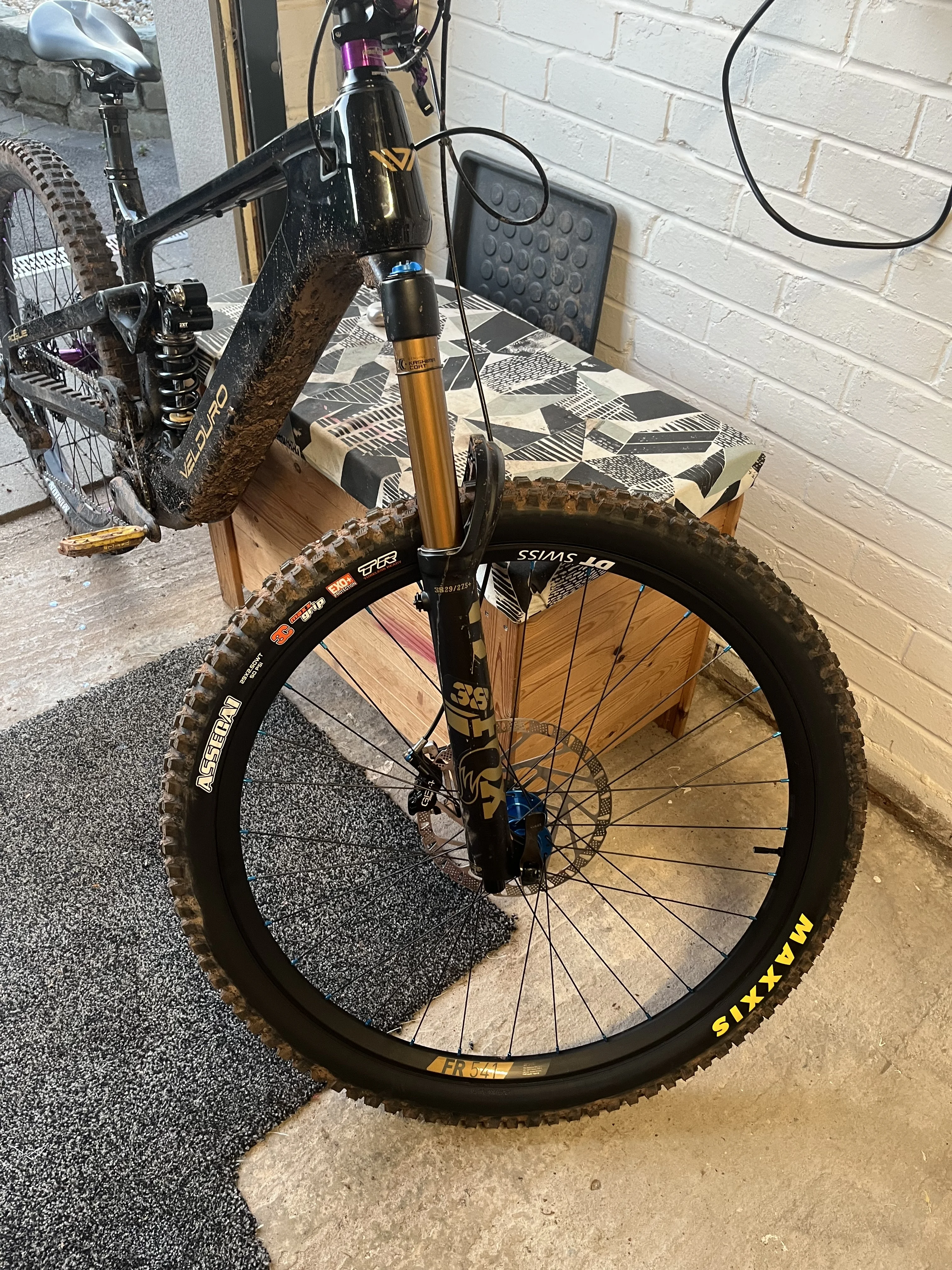

is your front tire on backwards?
No - none that I can see. Local Velduro dealer says he fits them to most bikes he assembles.
Yeah, it makes sense. With that much power available you can live with a bit longer gear ratio on uphills. And I have one specific jump that I like a lot, but where you need to pedal for 3 or 4 revolutions after coming out of a corner to get to the right speed. And with 34/11 and a 27,5 rear wheel it's just hard to hit the right speed. 36/11 should help (a bit at least).
One more question: are you using the bashguard? Maybe that's the reason Velduro states the maximum as 34 teeth, because everything else sticks out below?
No bashguard. Dont ride too many rocks and the steel chainring will deal with anything else ;)

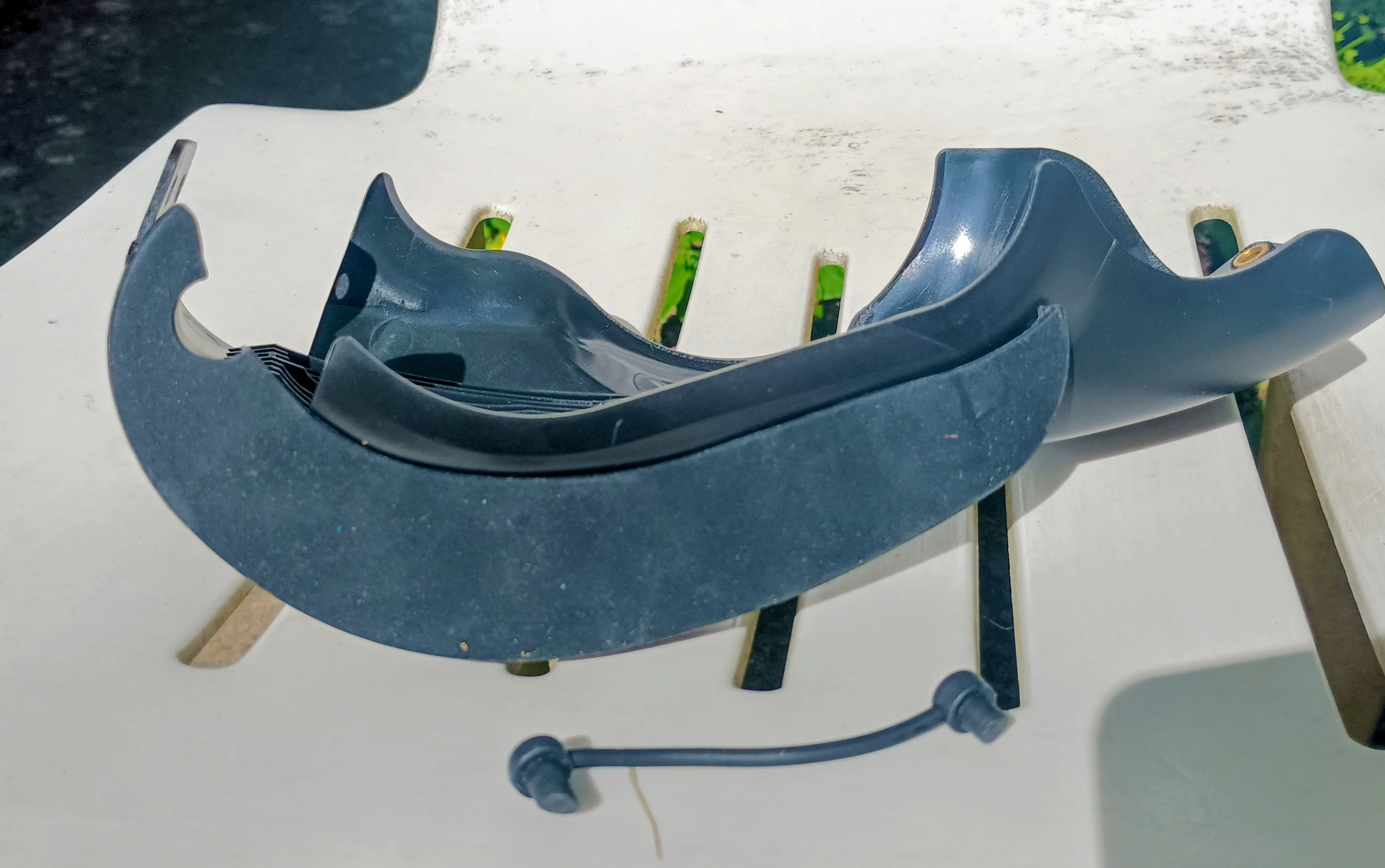

Could someone make a detailed photo of the routing of the axs powercable?
I am tinkering with a housing design for 3D-printing and want to see in what orientation I should make the exit of the cable.
