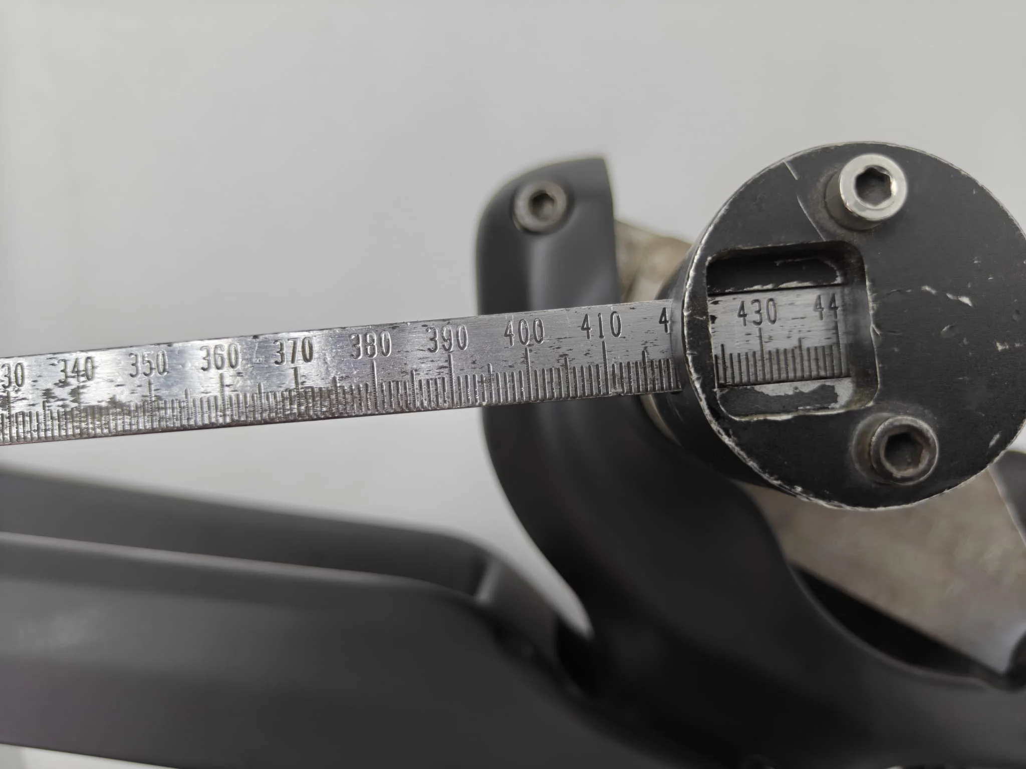

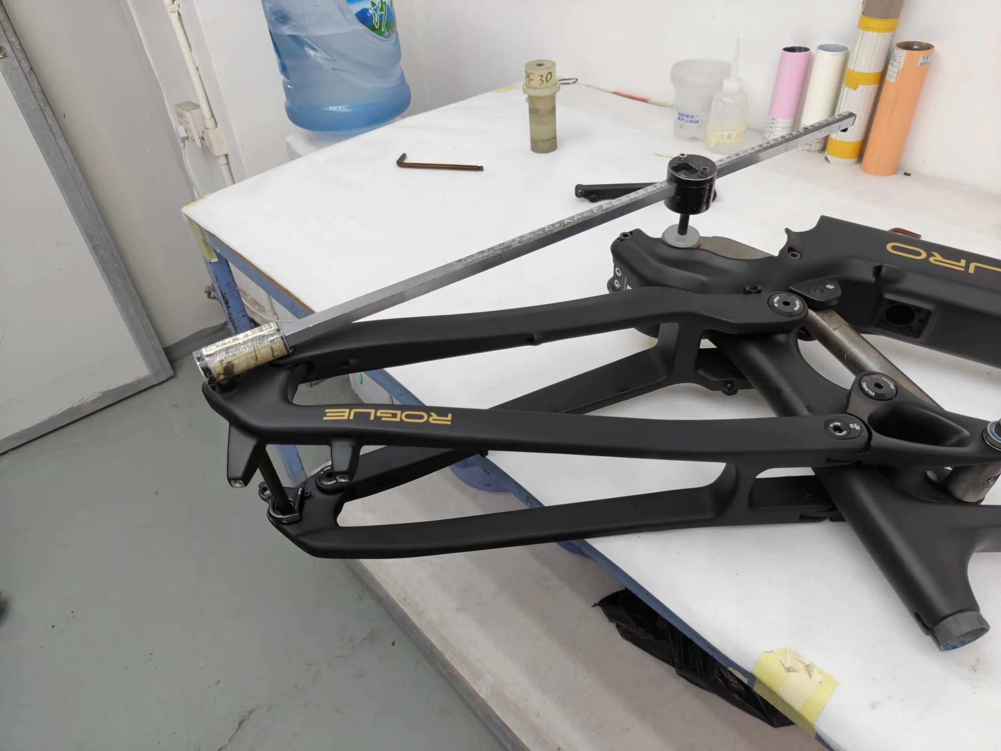

@cozzy if you have an L frame can you do me a favor when you have the occasion could you measure from the top of the charging port to the crossing of the frame like here:​
Thanks a lot​
Thanks a lot​
I would say 425mm before the radius.

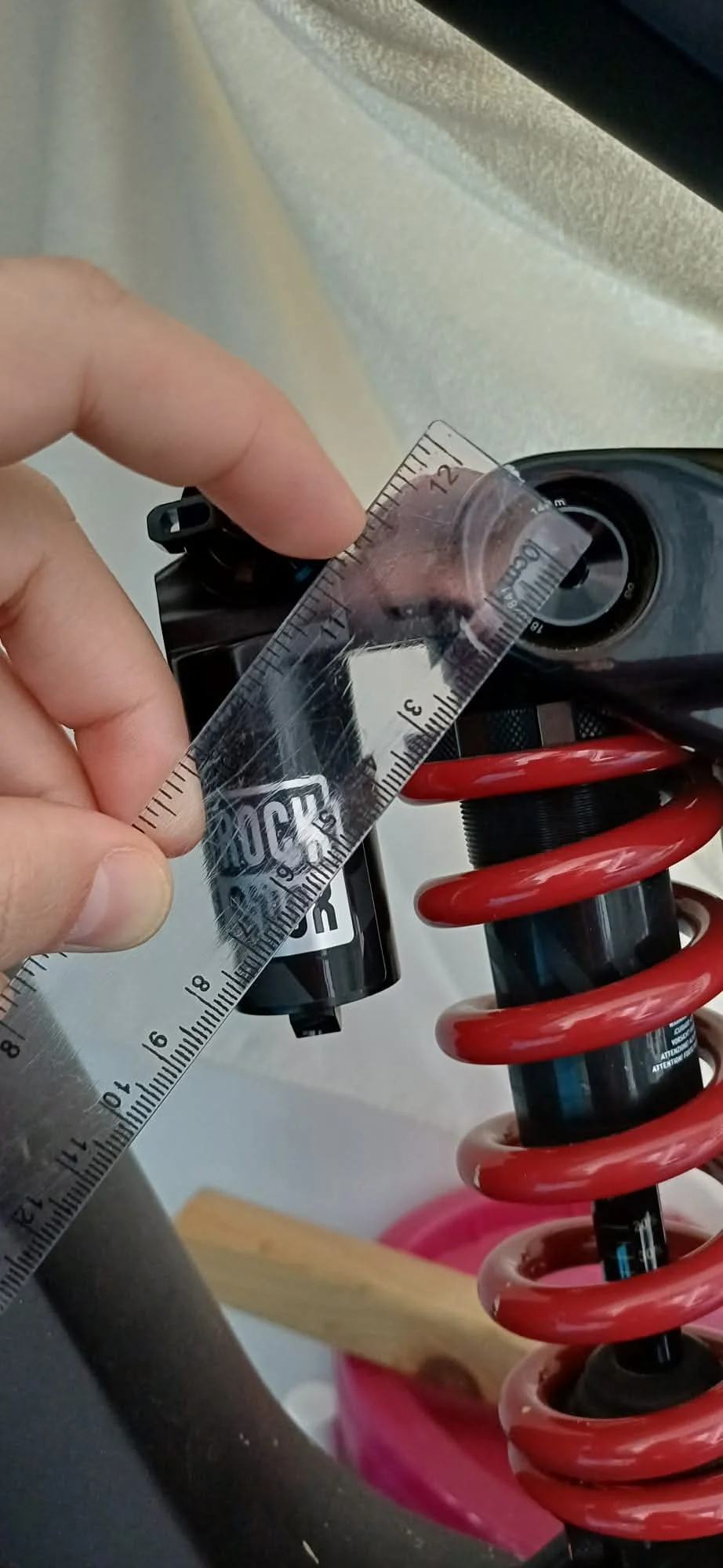

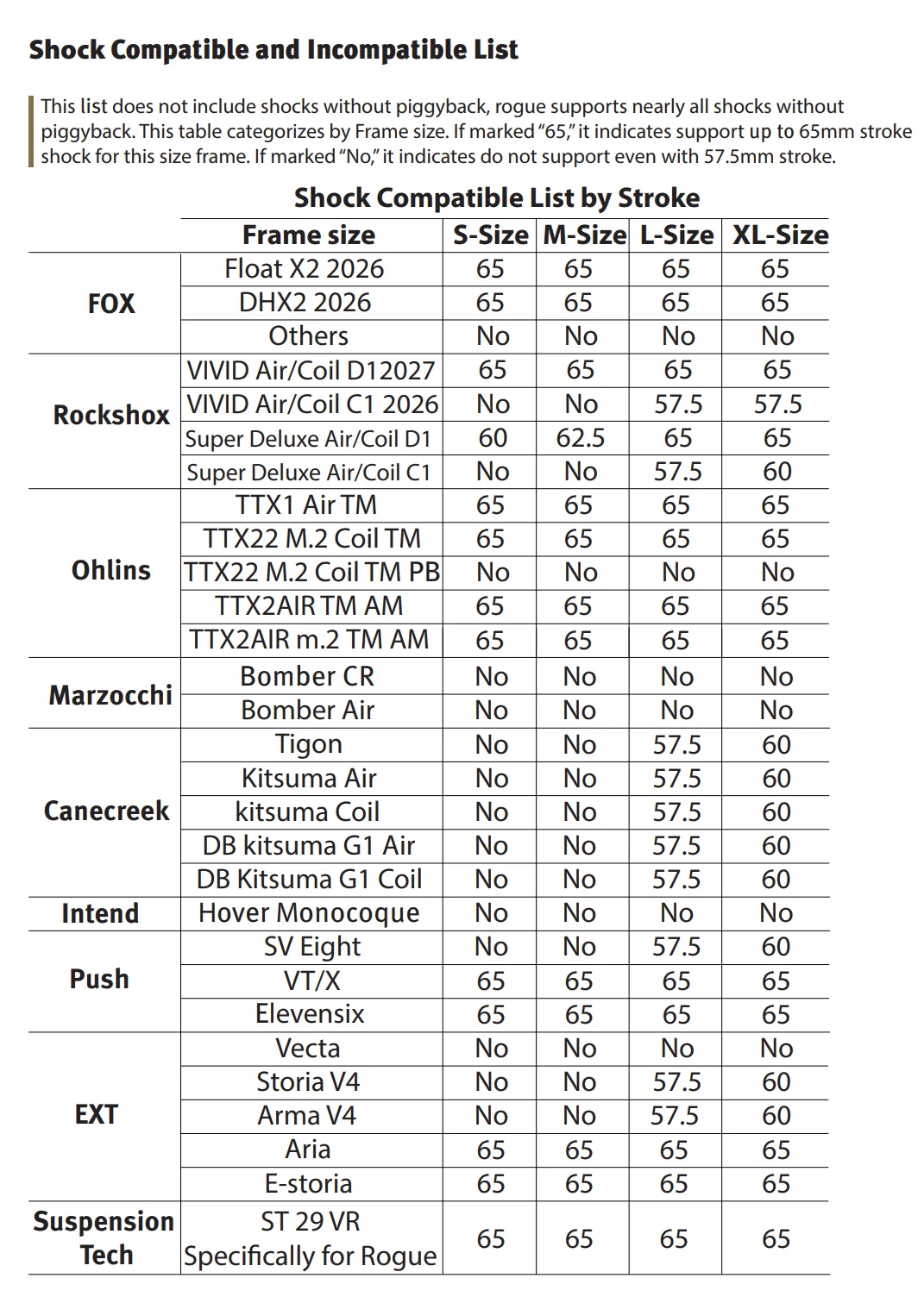

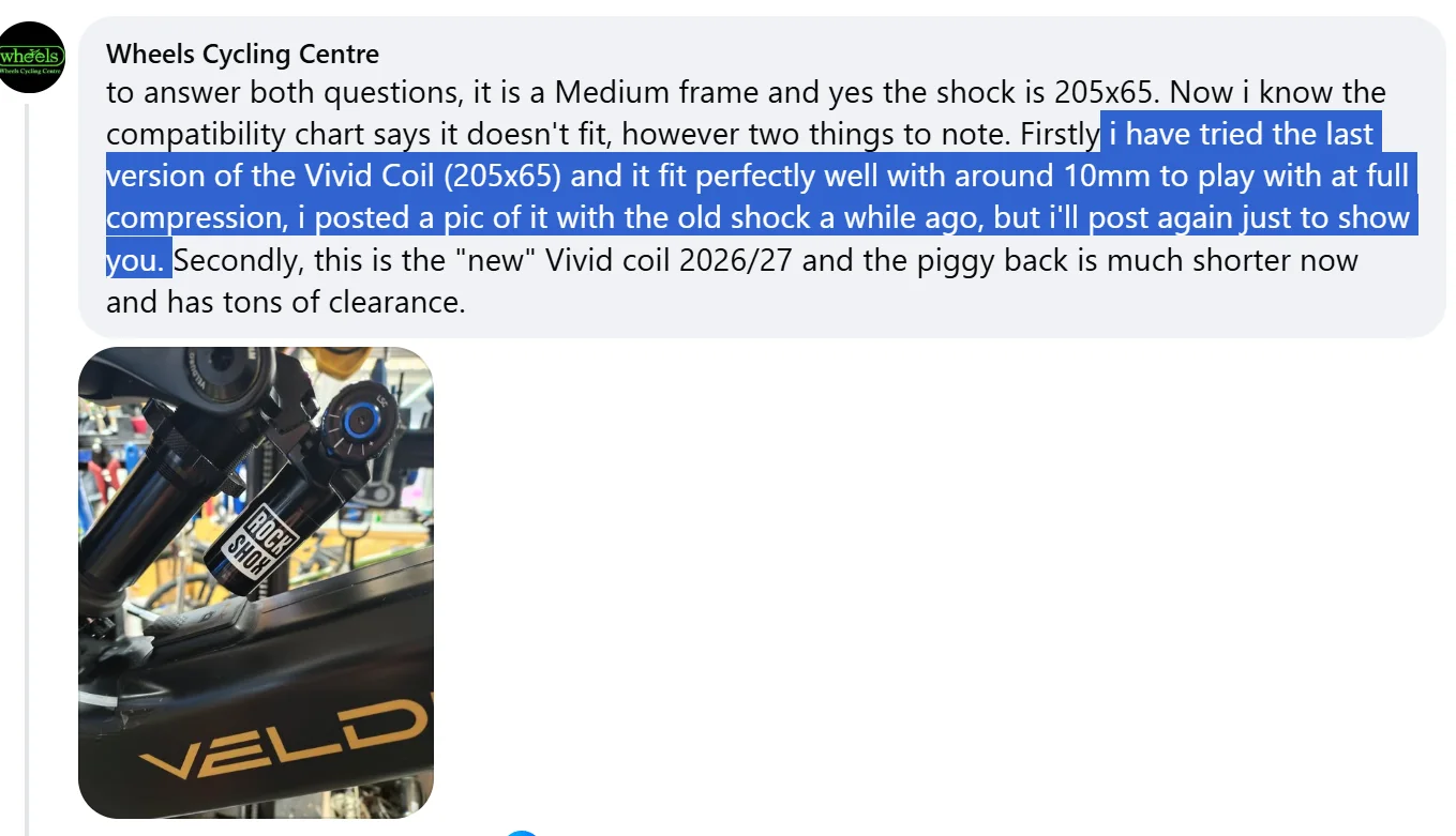

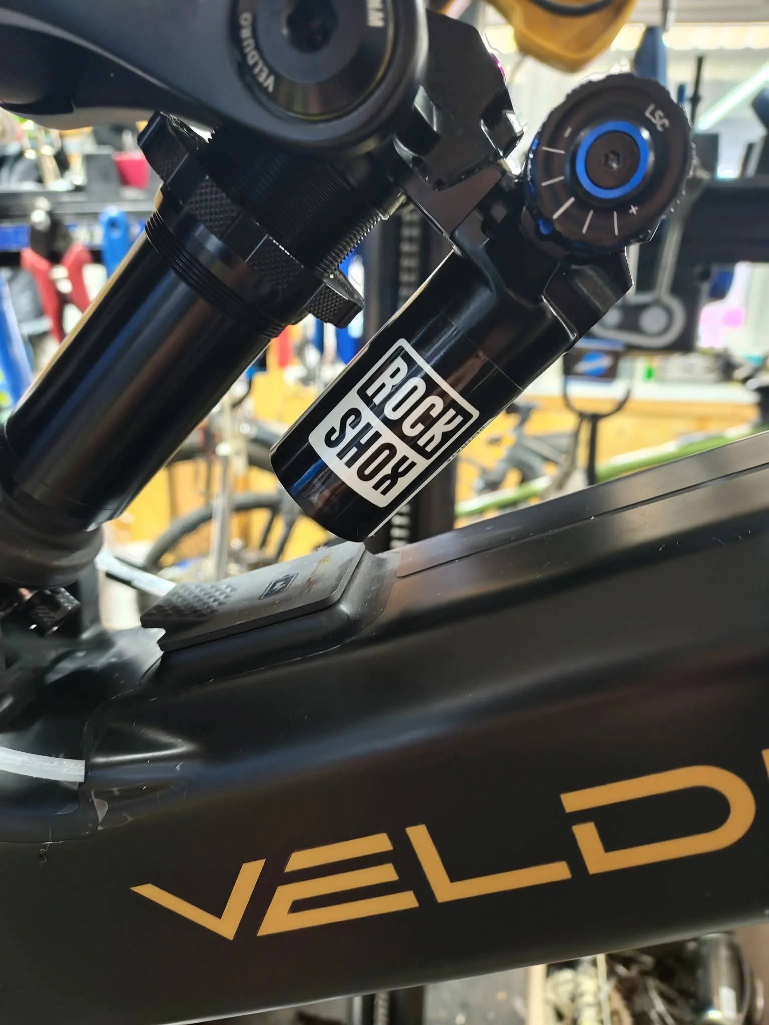

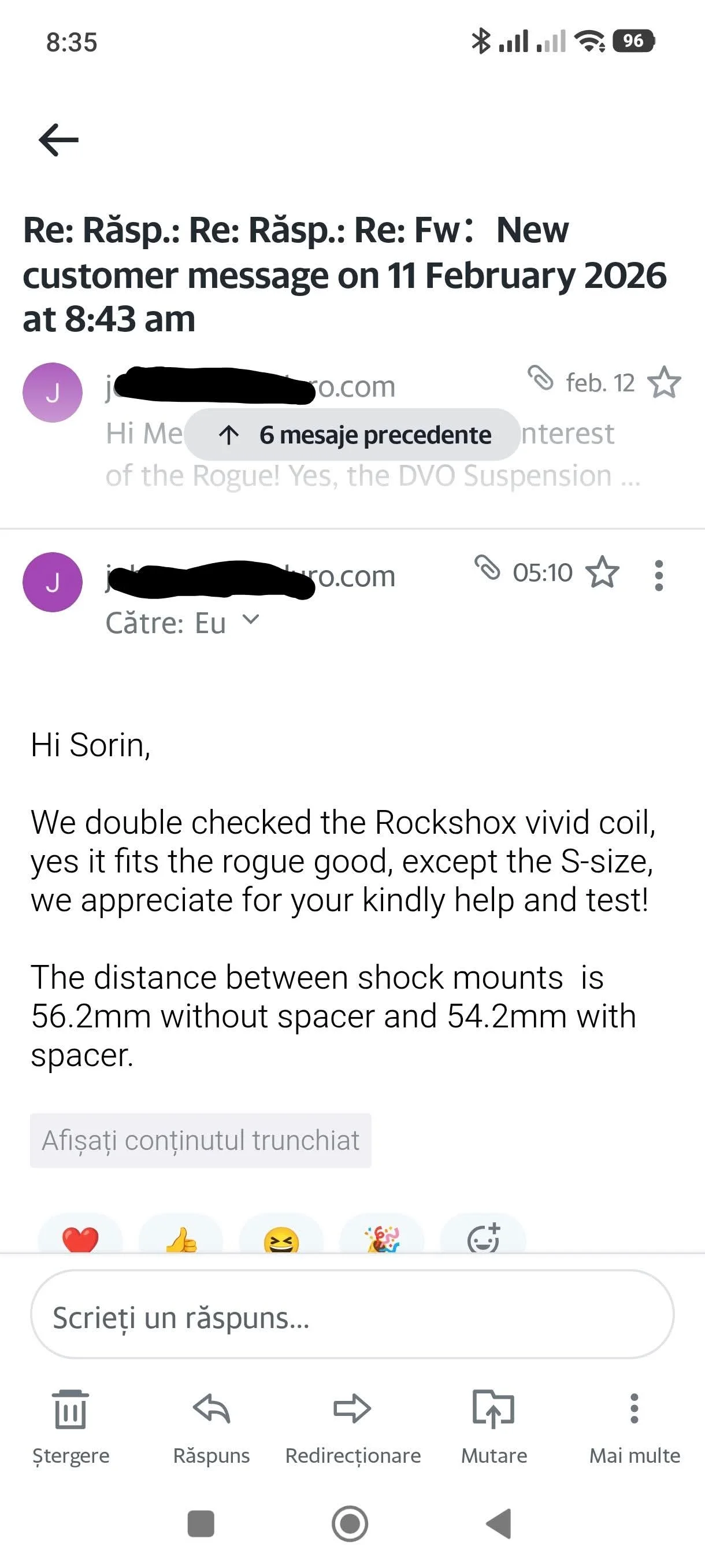

Someone on Facebook says even the old C1 version of the Vivid Coil fit a medium, but the updated chart still says it doesn't. If it does fit, maybe some other 'incompatible' shocks also fit? Like maybe the EXT Vecta/Storia and first gen Ohlins?
the issue is that a static tryout does not show the full picture. If you put a fully compressed damper (no air/coil) in the frame that's standing in your workshop there might be enough clearance. What is much harder to evaluate is what happens under load. All the parts of the frame have some degree of flex. One specific damper might work for most people, and for some others it works most of the time. But when some 100kg giant plus gear bottoms out hard on a particular large drop the piggy back might crash into the frame.
And since Velduro themselves state they are very conservative in their assumptions many dampers are ruled out. If you have one that is not officially compatible but fits with good clearance in static condition you might be lucky it works also in the rough. Velduro just will not guarantee it.
10mm flex inside a carbon triangle?
There is no way to get carbon flex this much in that direction. There may be a bigger amount of torsional flex as we would believe, but not in a way that the piggyback would hit the frame when it has 100mm clearance with fully compressed shock!

The current Chain stay length is 440 with a tolerance of +- 1mm see below. We are flying in the 450 rear triangles to arrive in UK on May 10th they will be free issued to anyone who has ordered an XL bike or frame and to anyone else through our website. Please allow 10 days for customs and UK internal delivery.

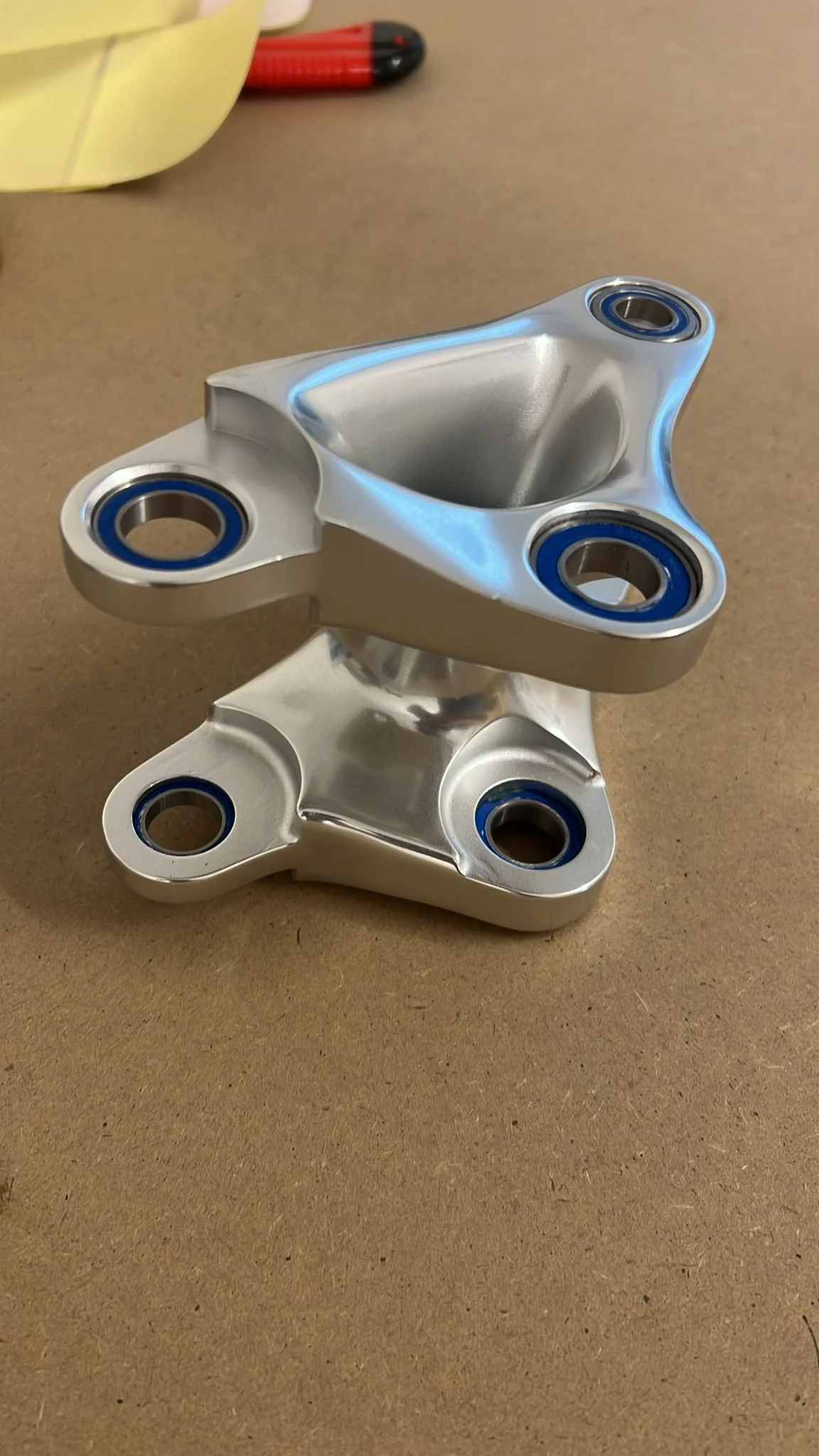

Below is a CnC'd version of the linkage, Rob has one and there is just one more available in the UK. Currently we are not stocking them. They are exactly the same in all dimensions as the black Version.

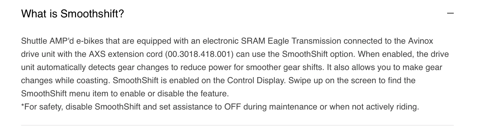

@Velduro UK : can you tell us what kind of AXS power cable is needed to connect the M2S with SRAM AXS derailleurs? I hear that it's not the same one as for the M1, but what is it? Do you have a partnumber? It's used in the Rogue R, but I can't find anything more specific.

will this longer stay also fit the large frame? what will be the price for those who want to purchase one?
From Velduro Global
Model number: EP-EAC-ECD-A1
Specs:
00.3018.418.001 EP EAC CBL EXTCRD 780MM HIGO Z405
... and still no DVO shocklist. Whadda what WOT!? The Jade X is a def yes @65mm stroke on a Medium.
