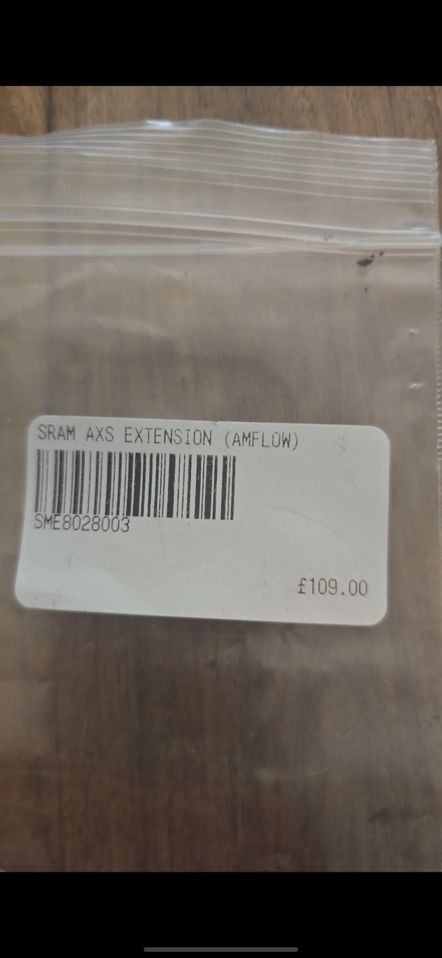

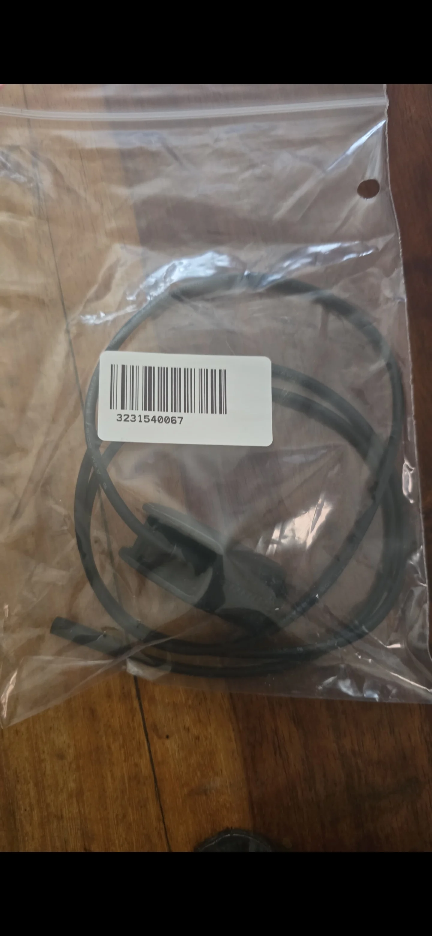

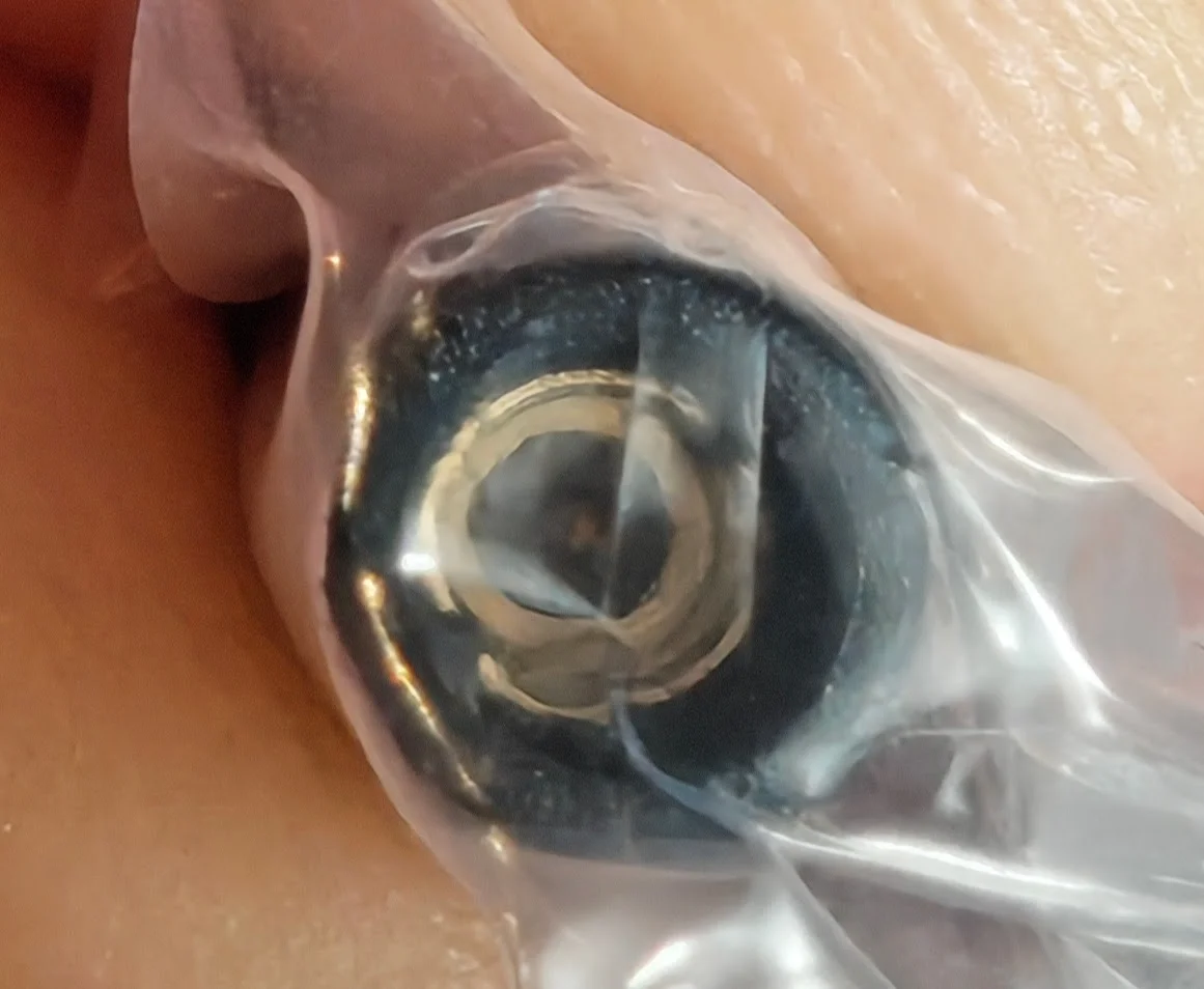

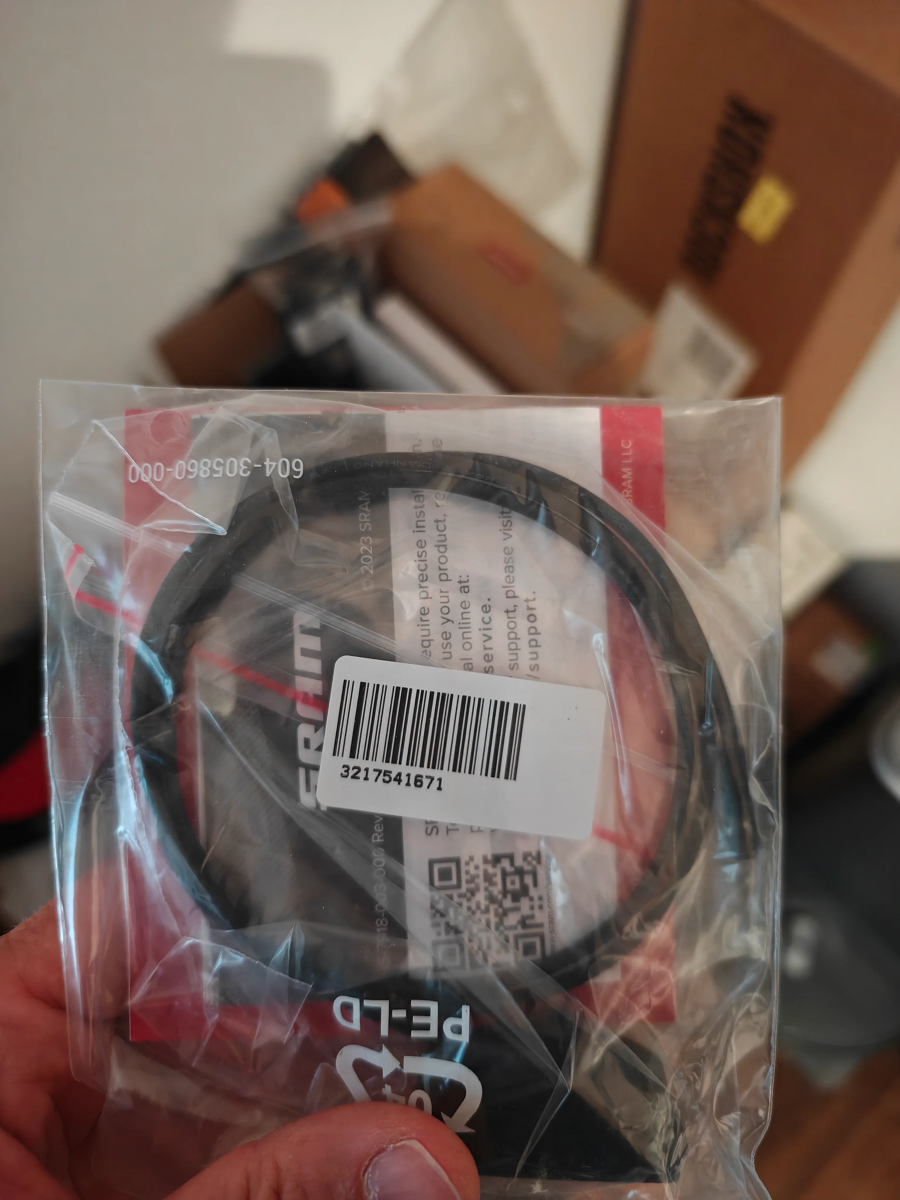

Stripped down the frame today to install the axs cable and it doesn't fit. The cable I have has a single pin connector :(. £109 wasted as I bought it back in January and not able to return
Can someone please tell me the correct part number I need for the cable so I can get the smoothshift
Can someone please tell me the correct part number I need for the cable so I can get the smoothshiftView attachment 181440View attachment 181441

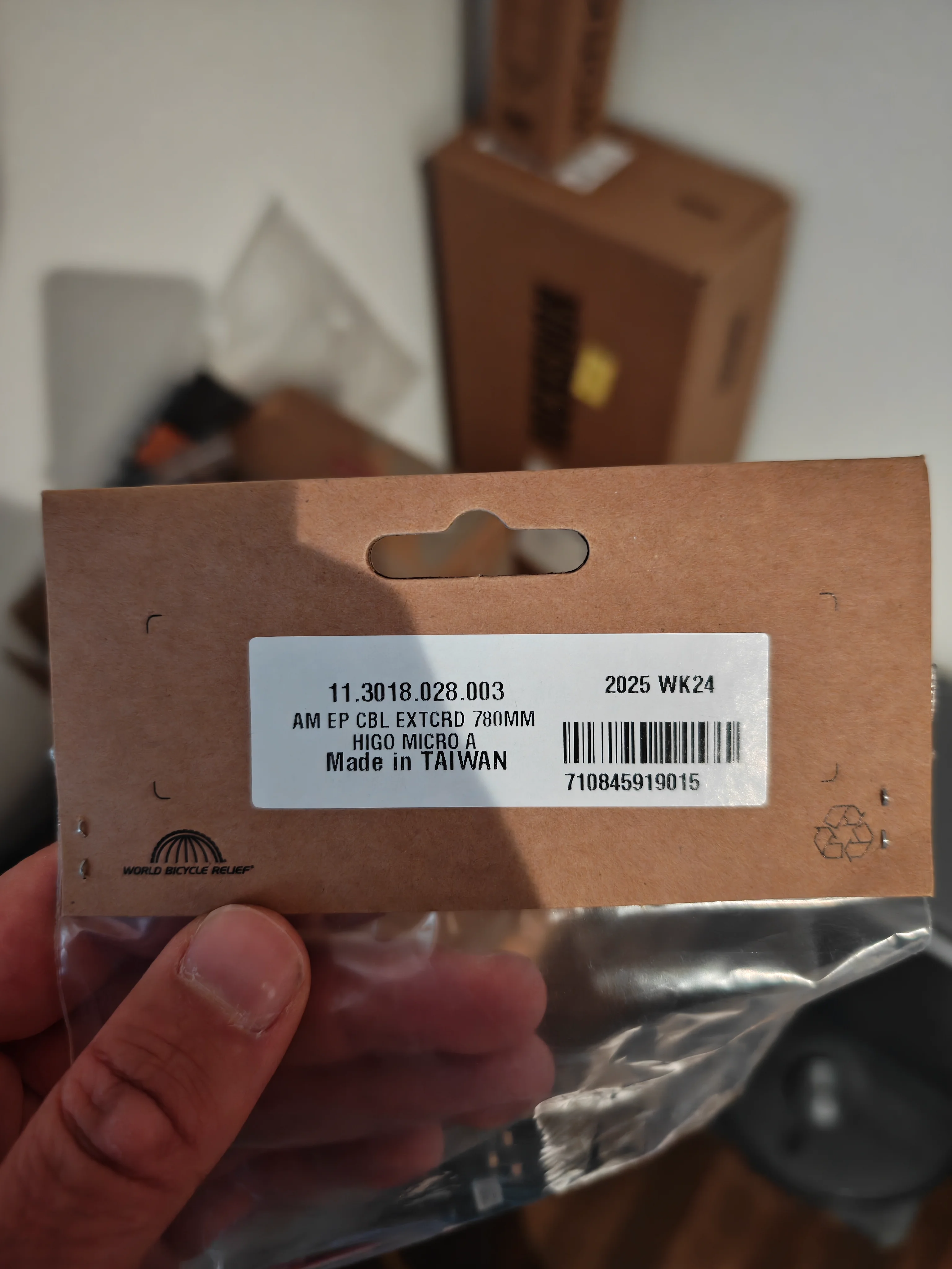

I've ordered another cable labeled 'Higo Micro A' (see photos attached).

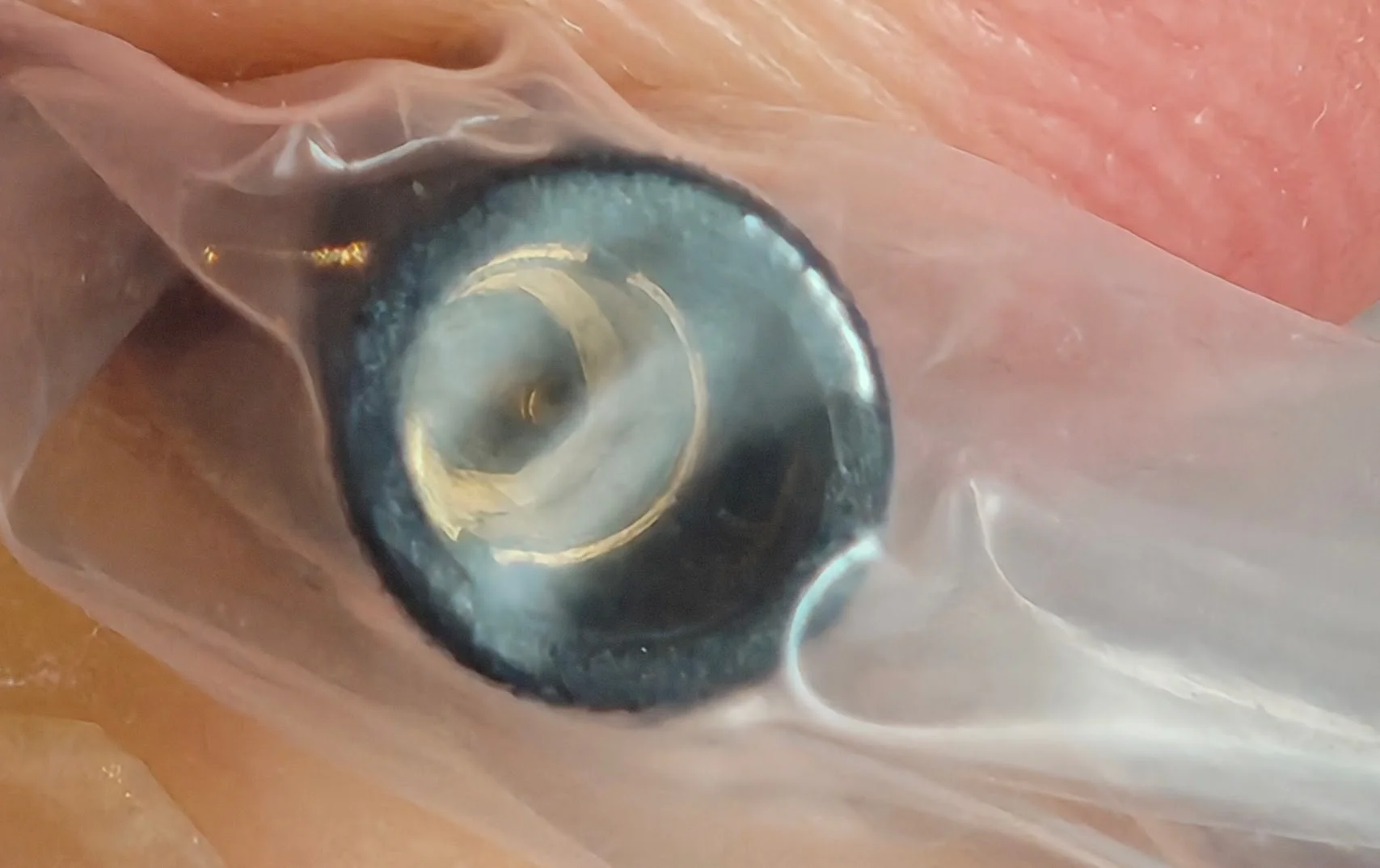

Can you show the end connector of that cable?

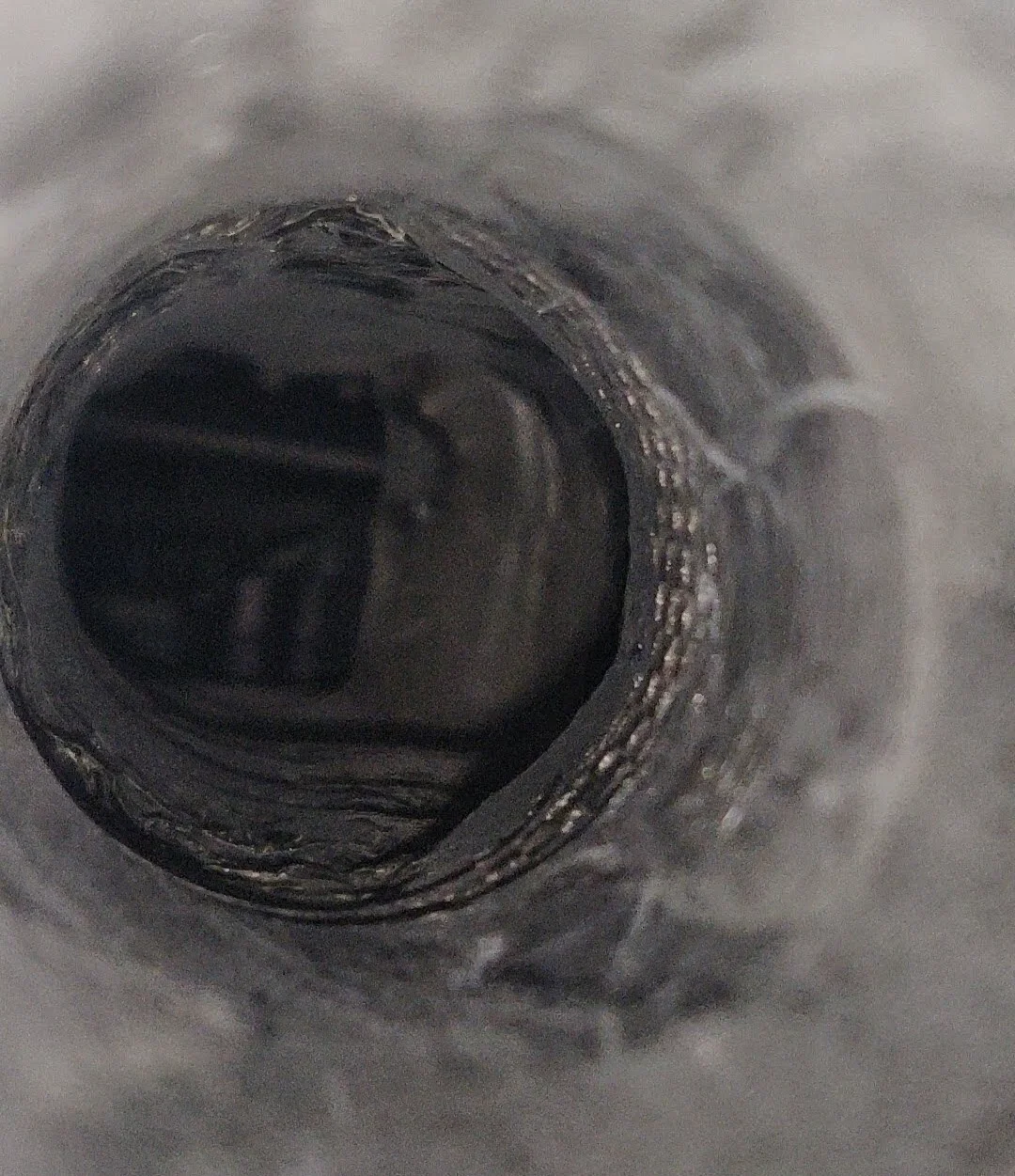

I've tried to get a clear shot through the plastic, just in case I have to return it if it turns out to be the wrong part.

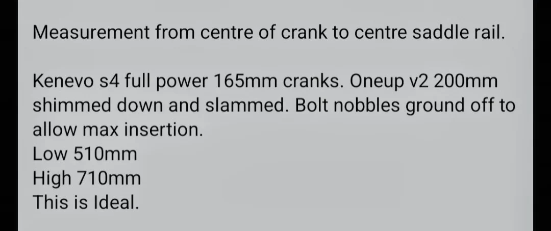

How tall are you? How do you find the saddle height high and low?
Cheers, I might experiment with my v3 210mm from my Enduro 1st to get best high and low points before putting my new 210mm in.
Plus I’ll be using an Switchgrade hat adds a bit and gives extra drop on back tilt.
A disappointing 5 10 after a recent measurement.
Im setting it up the same as my kenevo initially, should be about right.
From my last 2 bikes, 800mm high is right but I’m thinking with all the power I won’t need to max my height….
Equally lowest low is always the aim isn’t it.

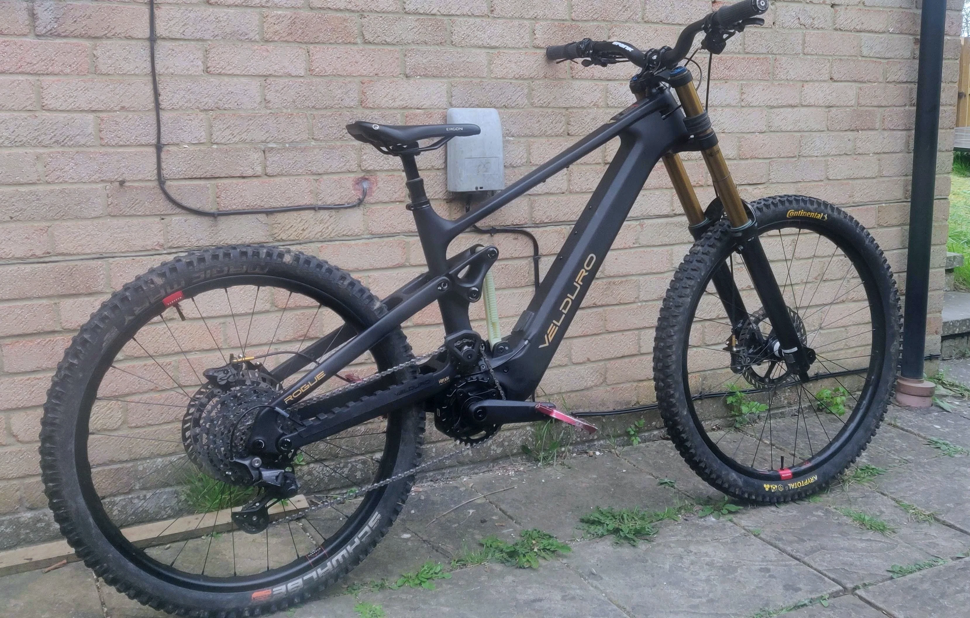

Build pretty much complete bar shock.
Need to measure up and order some matte helitape for down and top tube, chain and seat stays.
A hope 17mm Q mount for the rear brake, got a 20mm on it currently.
Probably drop down to a 43/11 linkglide cassette once ive got some rides in from the 48/11.
All the frame bolts were loose, pivots, udh hanger, motor cover, bottle screws etc, so ensure you check them.
Its quite a fiddle to run the cables, dropped the motor and battery out to access the internal channels.
Oh and need to research single crown forks, haven't owned one for years.
Haven't even switched it on yet, or looked at the app, vpn etc.
There seems to be a complete unavailability of 12a fast chargers in the uk, ordered one from Italy. Hopefully won't get battered too much on import. Bike isnt much use to me without it.

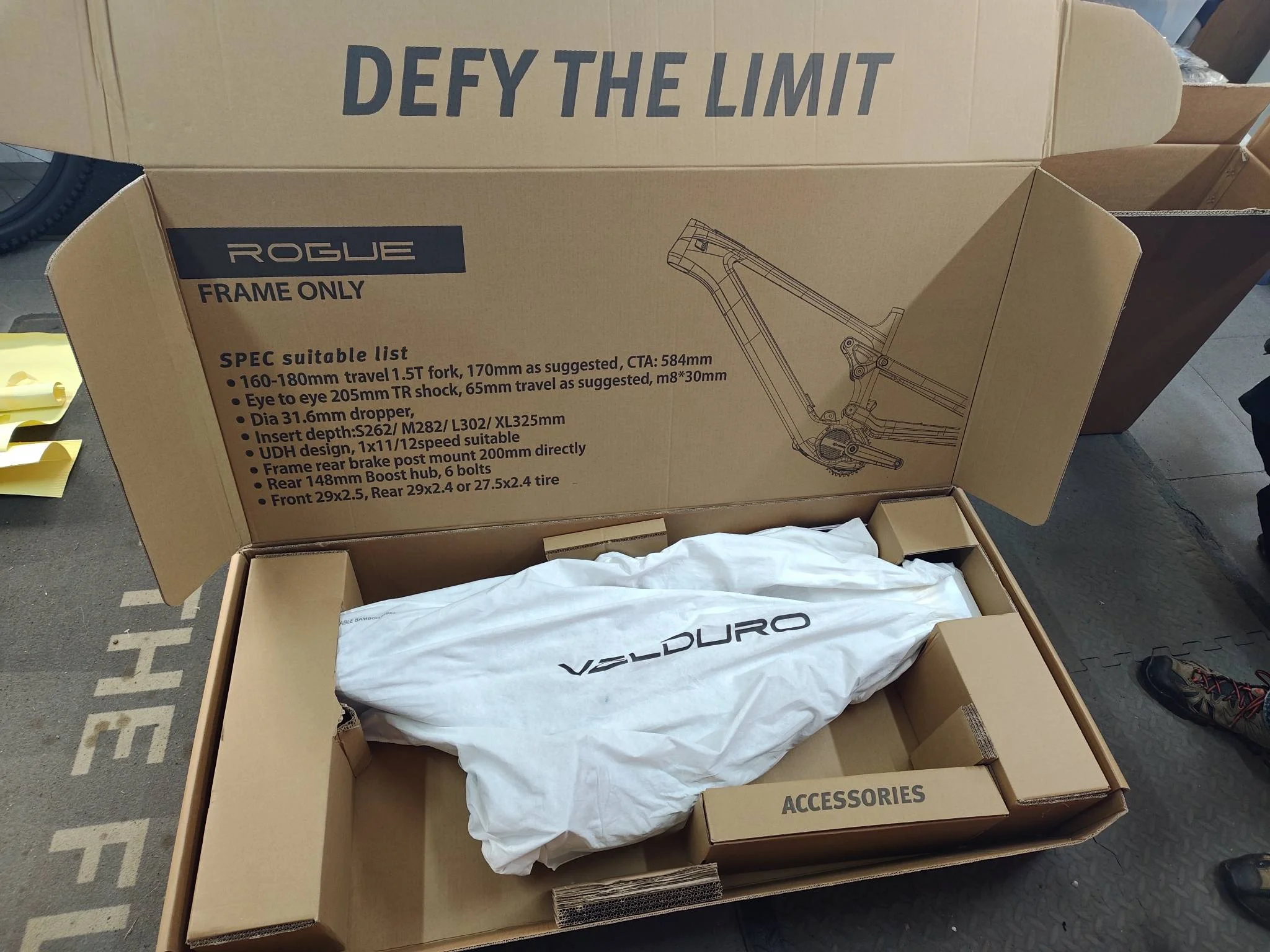

Can someone make a picture of all the accessories that you get with the frame?
Is the headset already pressed in?
Is the Avinox Spider Lockring Tool included?

Headset cups pressed in
Headset
Spider tool included
Spider and 34t chainring
Rubber bungs for unused frame cable ports
Speed sensor disc
Cranks
4a charger (booo)
Mini screwdriver for sim card slot
Seatpost clamp
Rear axle
2 handlebar remotes
No bashguard, extra apparently
I think that was it.
