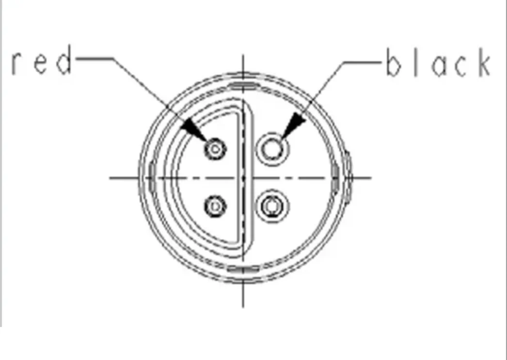

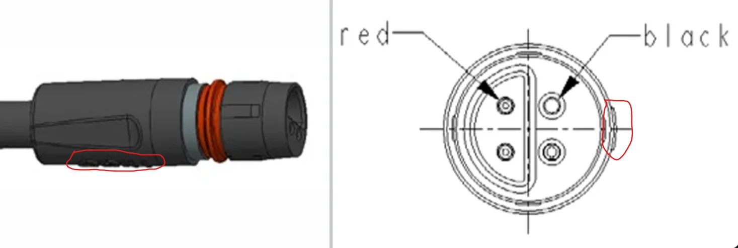

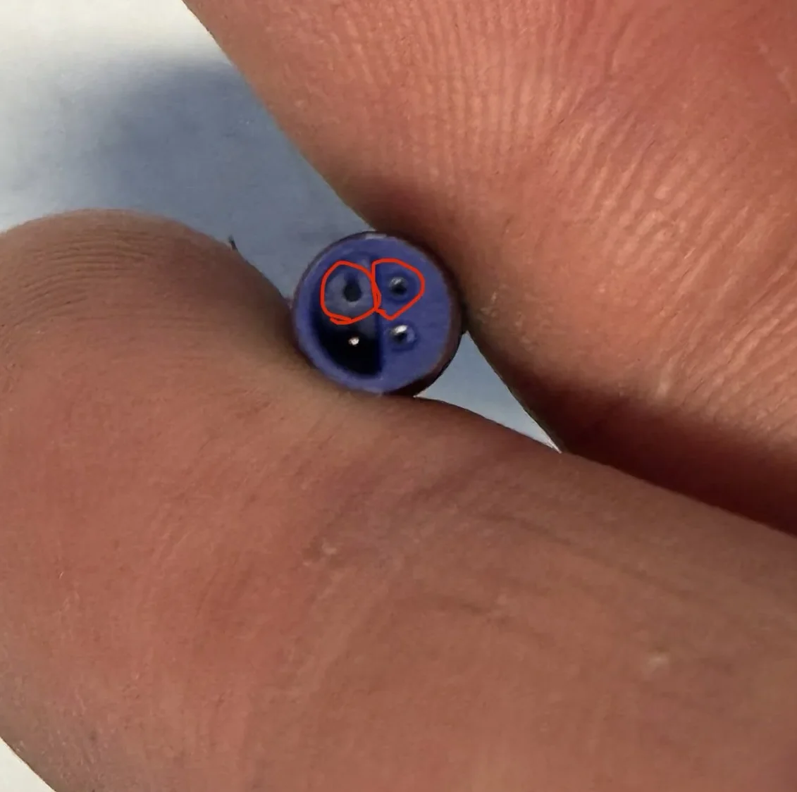

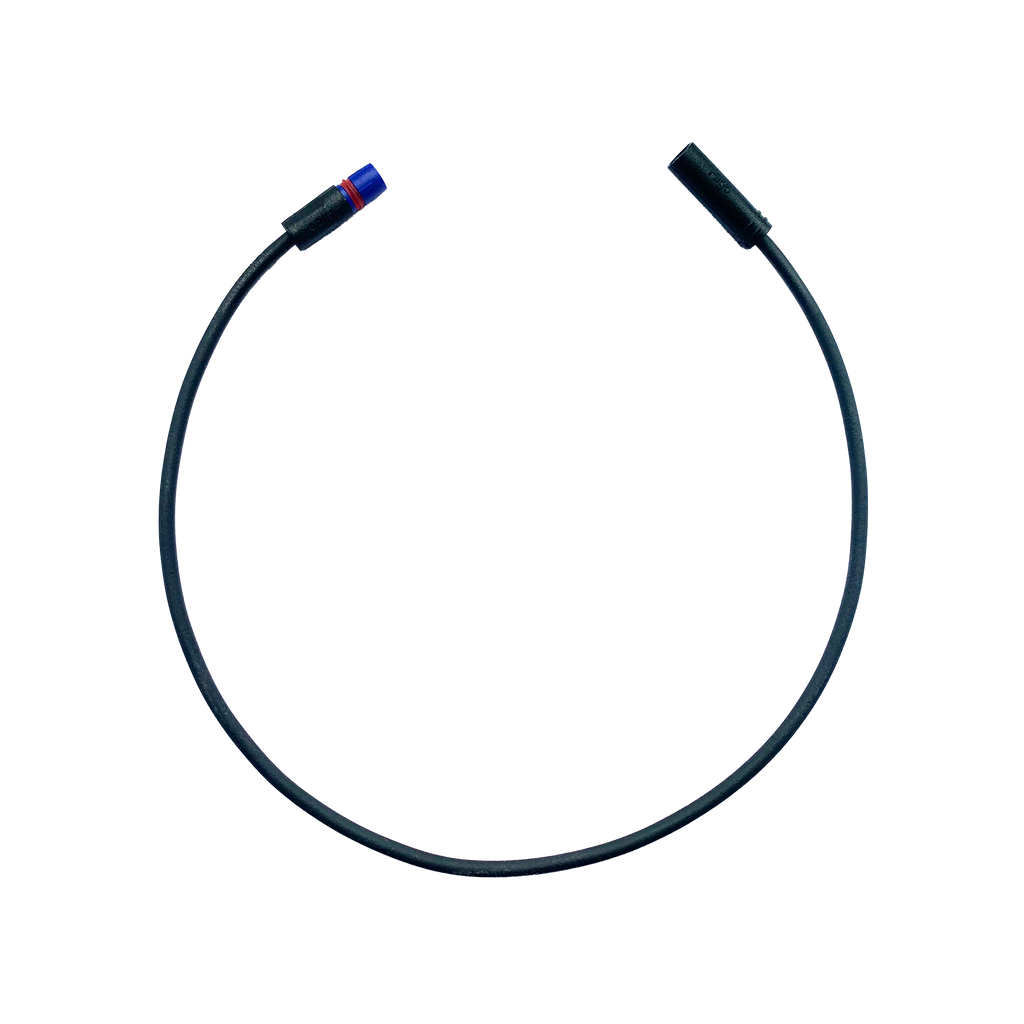

There is no way. I just got my Avinox light cable. I just checked the pinout. If I’m right, it’s the exact opposite of the SRAM one. Is that correct? See photos. Or is the red output the recessed part? Then it would be correct.
That’s the light cable. The red circles are the ones that are connected to the wires.
That’s the SRAM spec sheet.

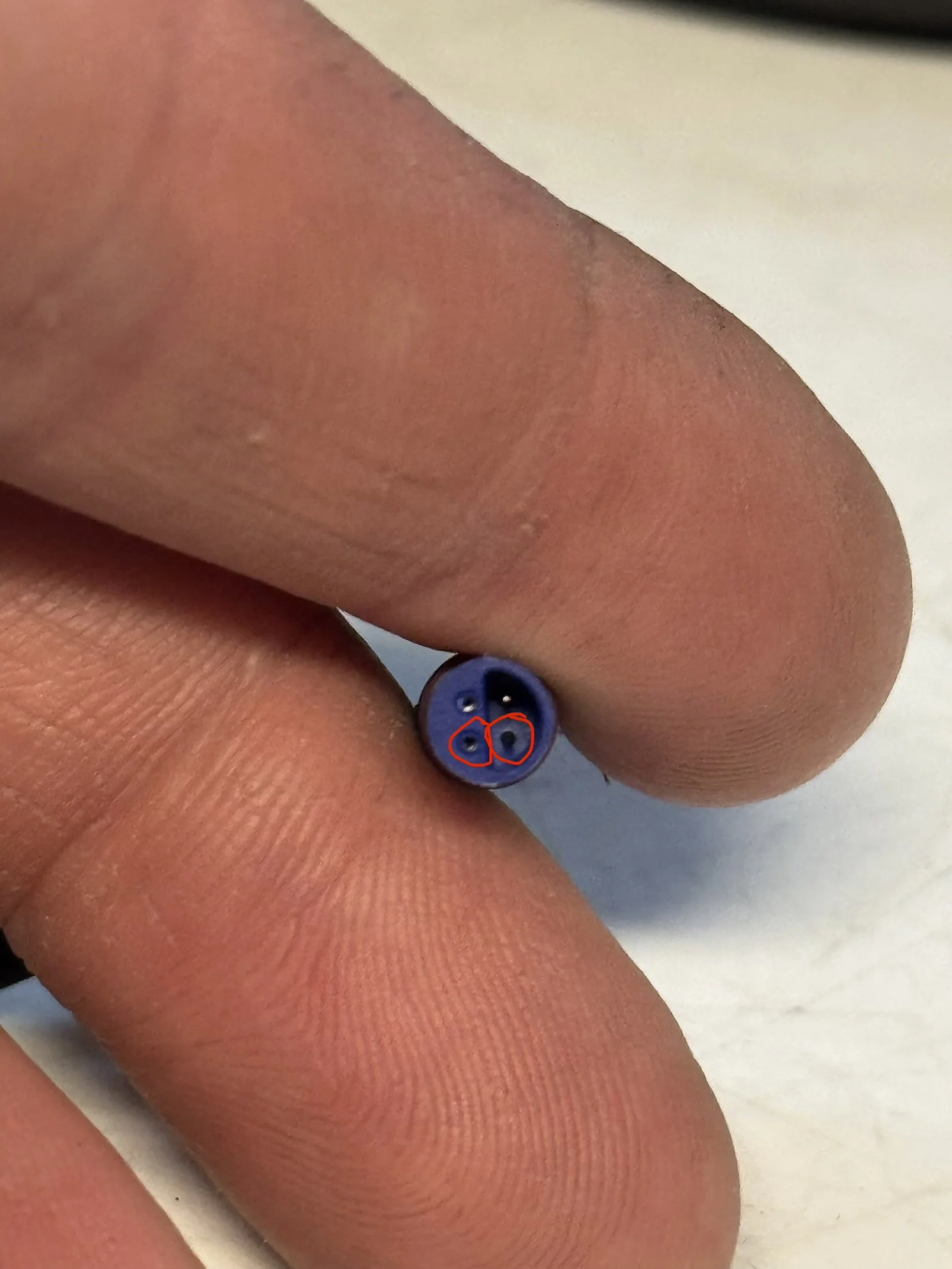

have you tested them with a voltage tester?
Yeah, the ones in my picture with the red circle have continuity with the wires in the cable.

I think it could be correct, but I’m not sure about the SRAM drawing. What is the recessed part and which one isn’t?

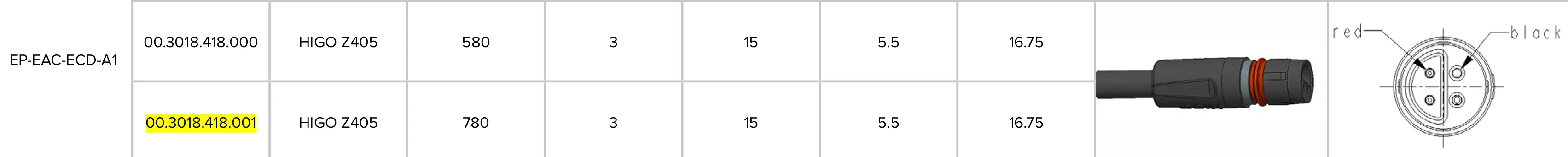

have you also ordred this one?

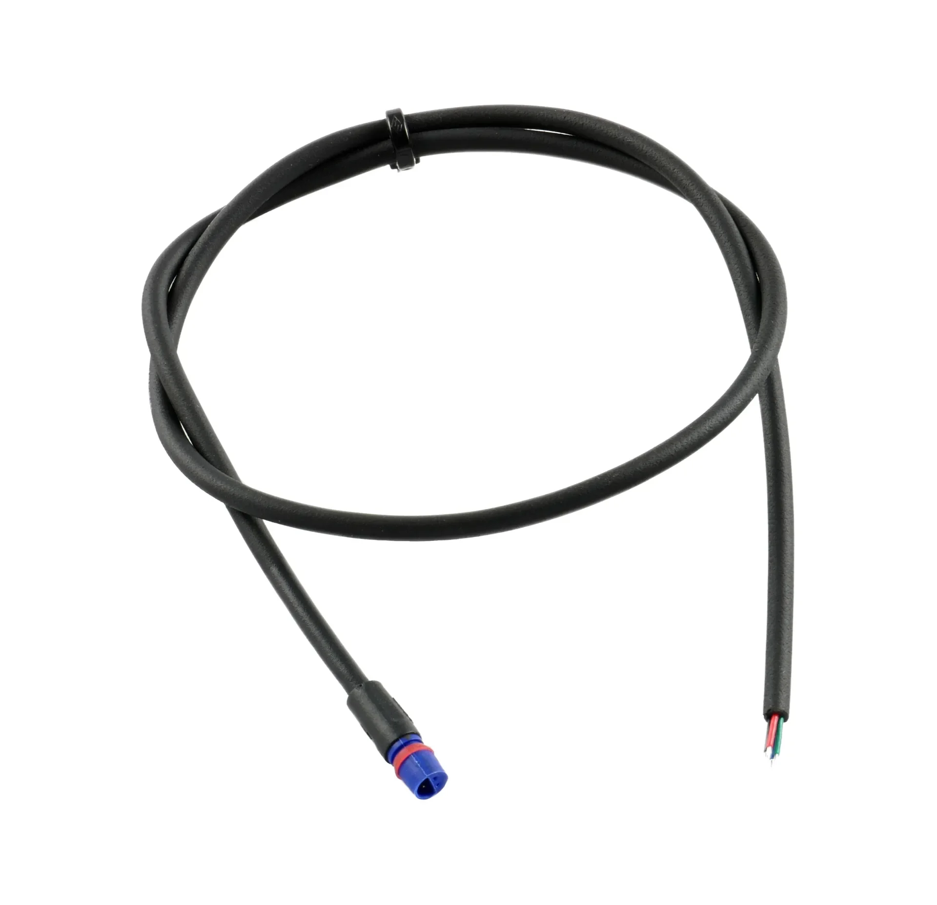

Oh nice, this one has all 4 wires. You’re good. Mine has only 2 wires. It’s the Supernova adapter cable for their lights.
Could this be used/adapted to run other lights? I’ve got a big power magic shine 8000 and it would be nice not to have to strap its battery to the frame!
Yes, but I’m not sure what the watt limit for the output is. But most likely you’re good. Its 12v

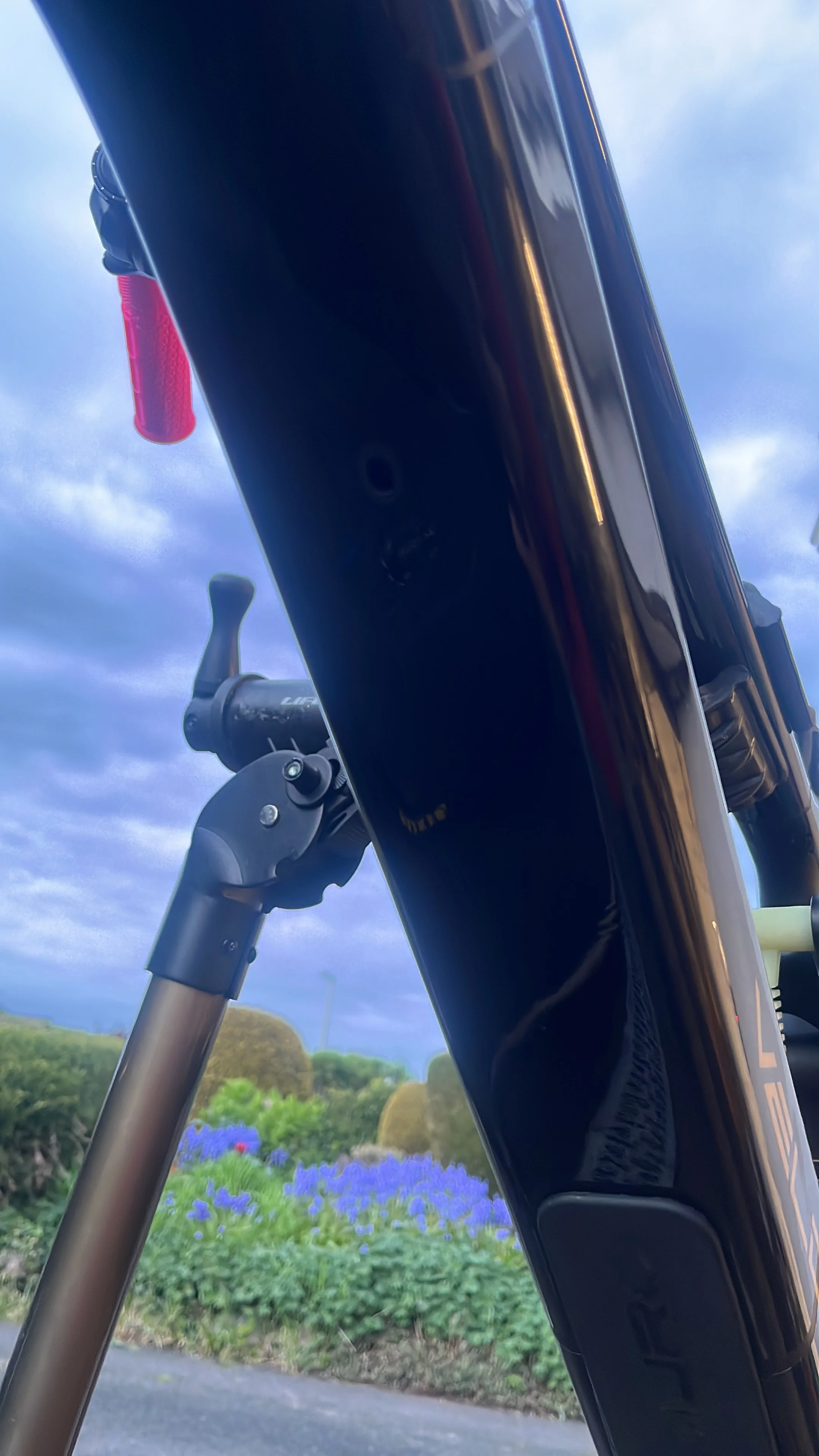

You haven't read the manual have you 😉. That hole is for a 600 battery.
Did you get yours from ace with the e-storia bundle?
I have - I now recall that! I’m sure my battery in loose, it it will be out soon for cable/hose routing so will sort then.

isn’t the 800wh mounted with a screw from the top under the display or do i mix it up with the crestline?
Yep. Thats the one. Silly design really. The trek tq set up is way better. There is a bit of a technique to it and once you get that you're away. Do the bottom bolt up first then the top, helps locate it. Near impossible doing it the other way. Trust me 😆
