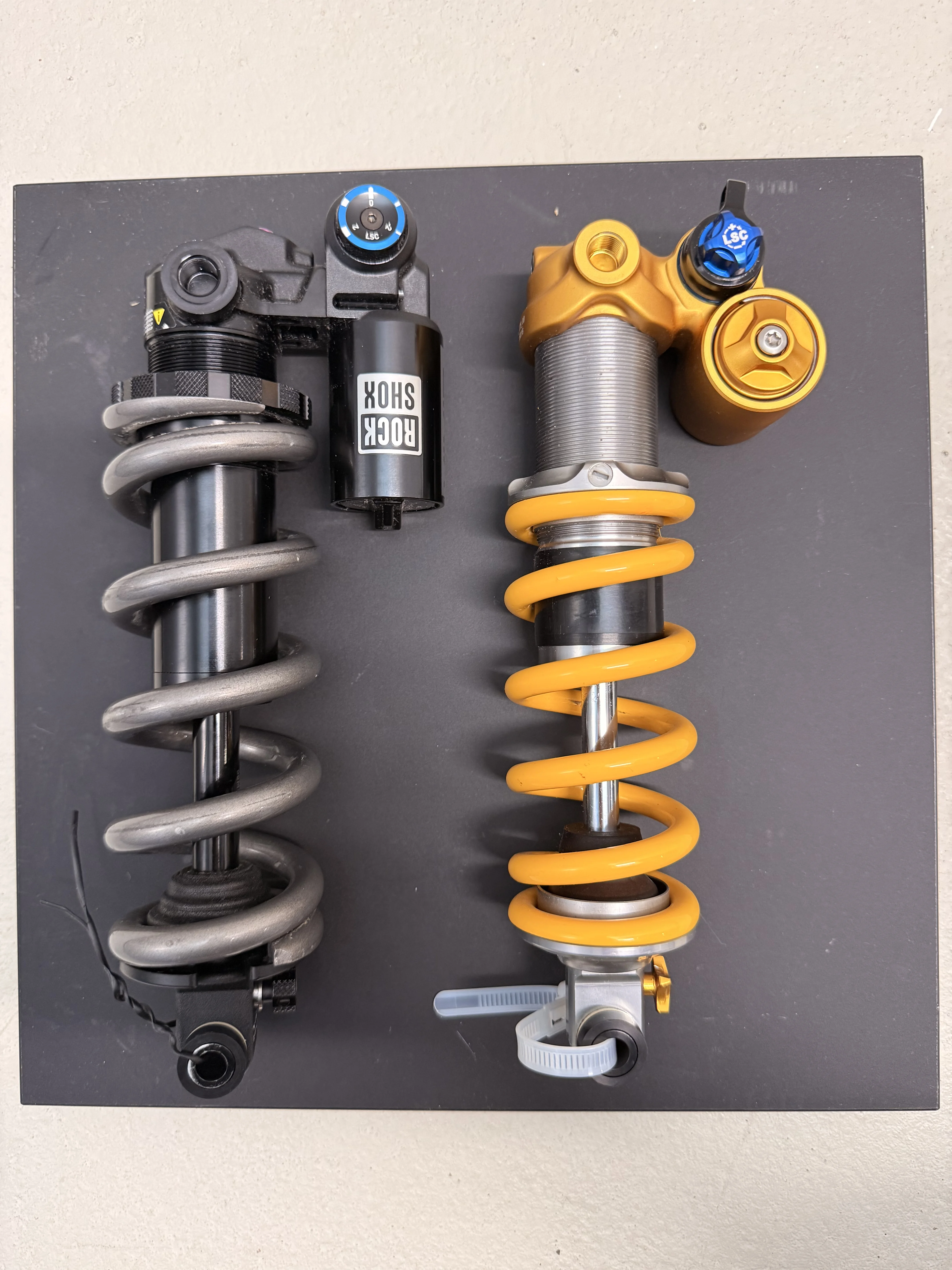

Collected the shock from ace yesterday after a few delays and fitted it in the trailcentre carpark.
Just a gentle shakedown ride to make adjustments and ensure nothing came loose .
Bike rode well and is very quiet.
Unsure on the supplied spring when I checked sag last night though. Its a 575lb at 100kg. 15mm movement which is only 23%. I'll measure again today.
I have a spare 600 which is no good unless i get fatter. I generally loose about 7kg over summer now I'm riding again. Maybe will look for a 550. Annoying i had one but sold it last year.
I have a spare 600 which is no good unless i get fatter. Maybe will look for a 550. Annoying i had one but sold it.

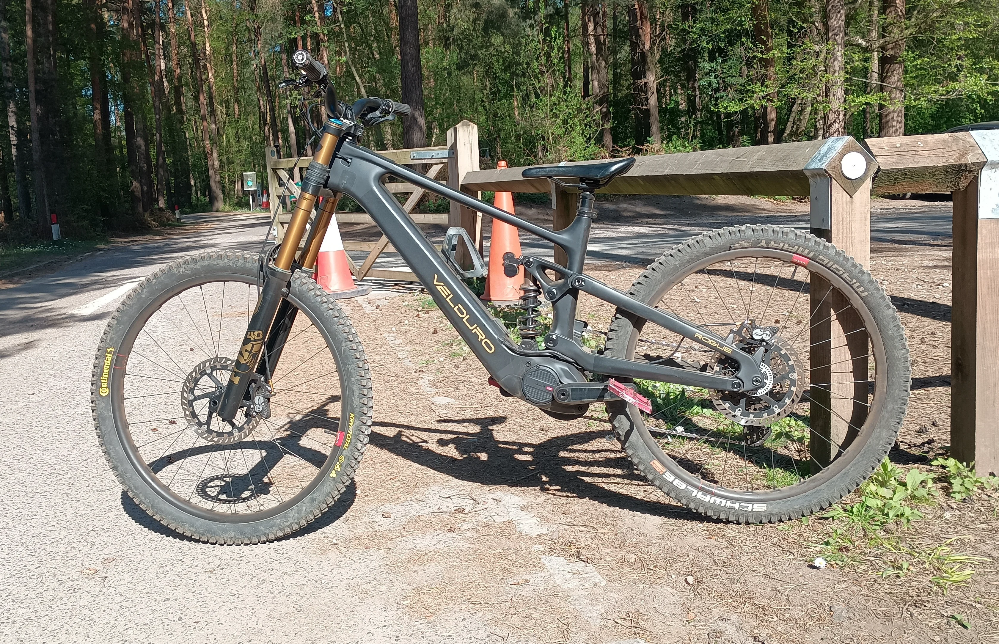

looks mean with the dc, how’s the turning radius?
Its fine for the places i ride. The 40 has 18mm of offset in the crown which helps. I haven't owned a single crown fork for about 6 years so im used to it. I may still try 38 though.
From the picture it seems that you are on Pro on the chip so 170mm travel on the back, how much sag you want to reach?

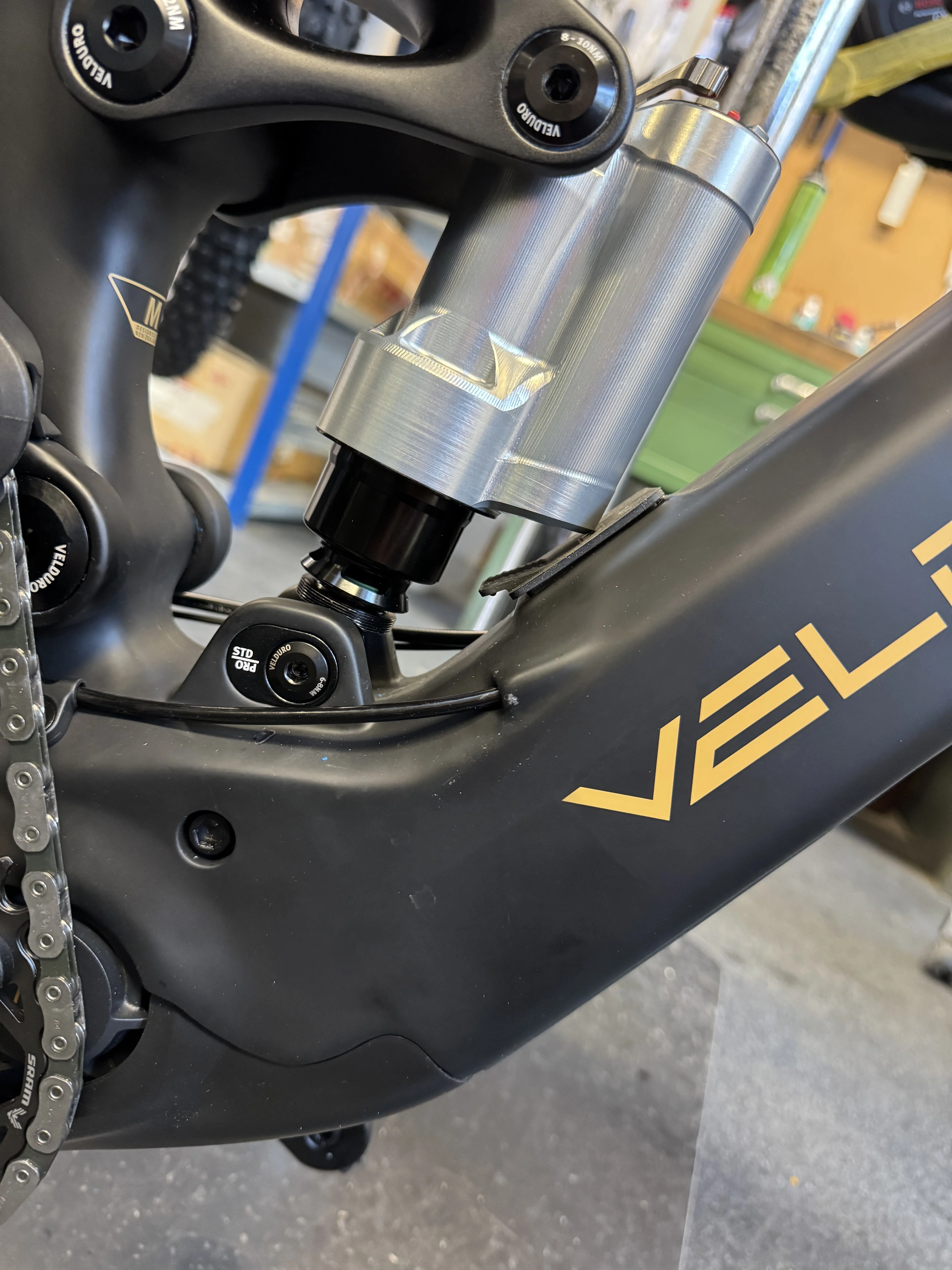

I tried to mount the Hover opt and it’s not working in the frame M. The pigi back slamed to the charging port.
On what size frame you’ll mount it?
So, I was able to test the Hove MC in size M. At full bottom out, it touches the charging port cover a little. It might be worse under hard compression when the frame flexes. But I think you’re good. I also took the bottom out rubber ring off for the test. With the bottom out ring, it will stop earlier. You can also use a 2.5 mm stroke reduction.
There is also some space under the charging port cover.
I also made a video of the test, but I can’t attach it to the post.

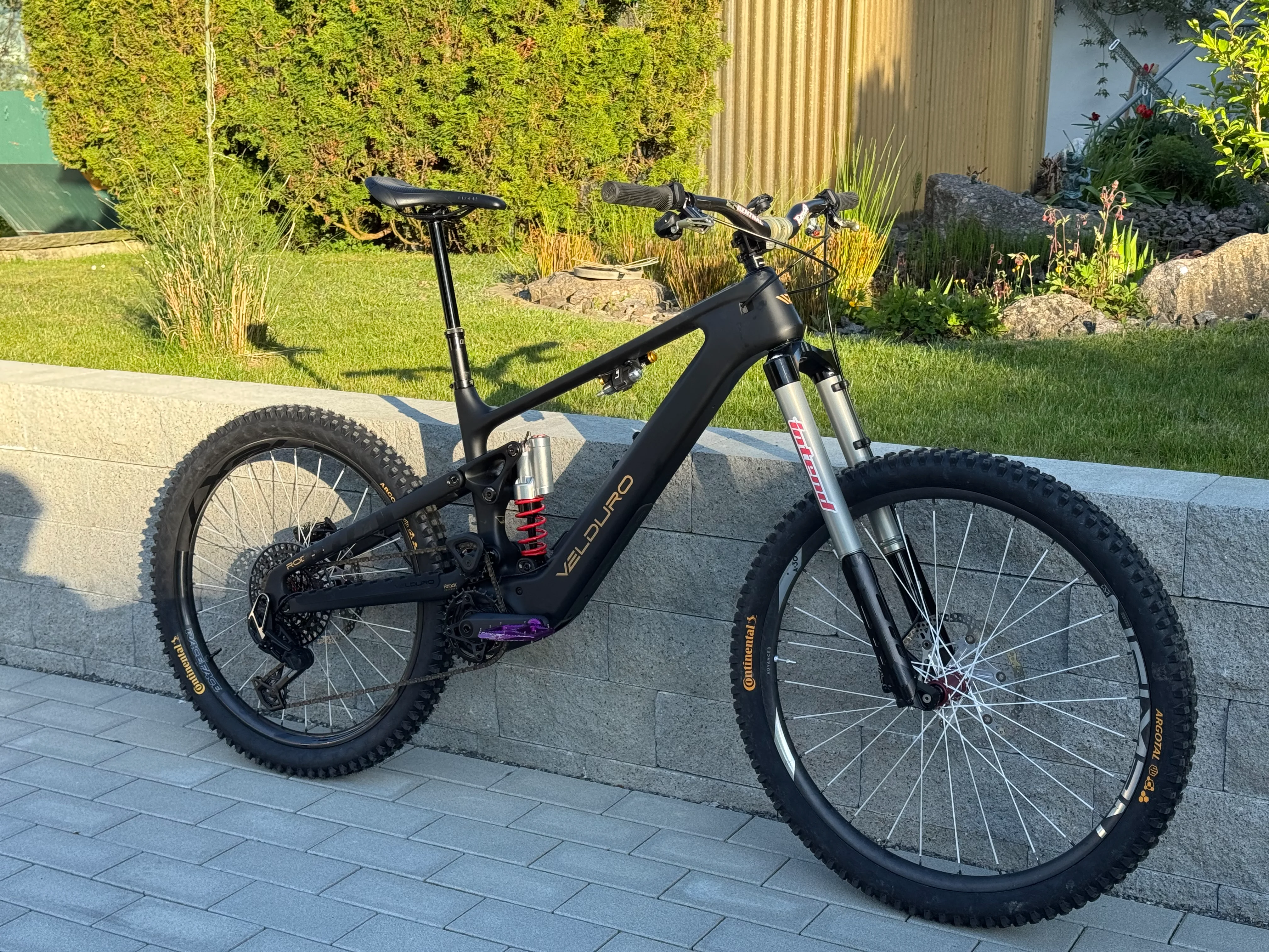

New Build with the Intend Moto V2. Weight 23.52kg
Specs:
- Rogue Size L
- Intend Moto V2. 180mm / 65mm
- Intend Trinity DH / 220mm Hope CL Rotors
- Sram XO Transmission connectet to the Avinox Motor
- Custom Carbon Wheelset with Berdspokes & Erase V2 Hubs. Mullet
- One Up Pedals. Yeah, I know the color doesn’t match.
- F+R Argotal DH Casing 2.4". Front SuperSoft, Rear Soft
- Rear E-MTB CushCore
- OneUp 240mm Dropper with a Hope Lever
- Renthal Carbon Bar 40mm Rise
- Renthal 40mm Stem
- PNW Loam Grips
- Fidlock Mount
- CO2 Cardrige & Tire Plugs.
- Ergon E-MTB Saddle
- QuadLock mount
