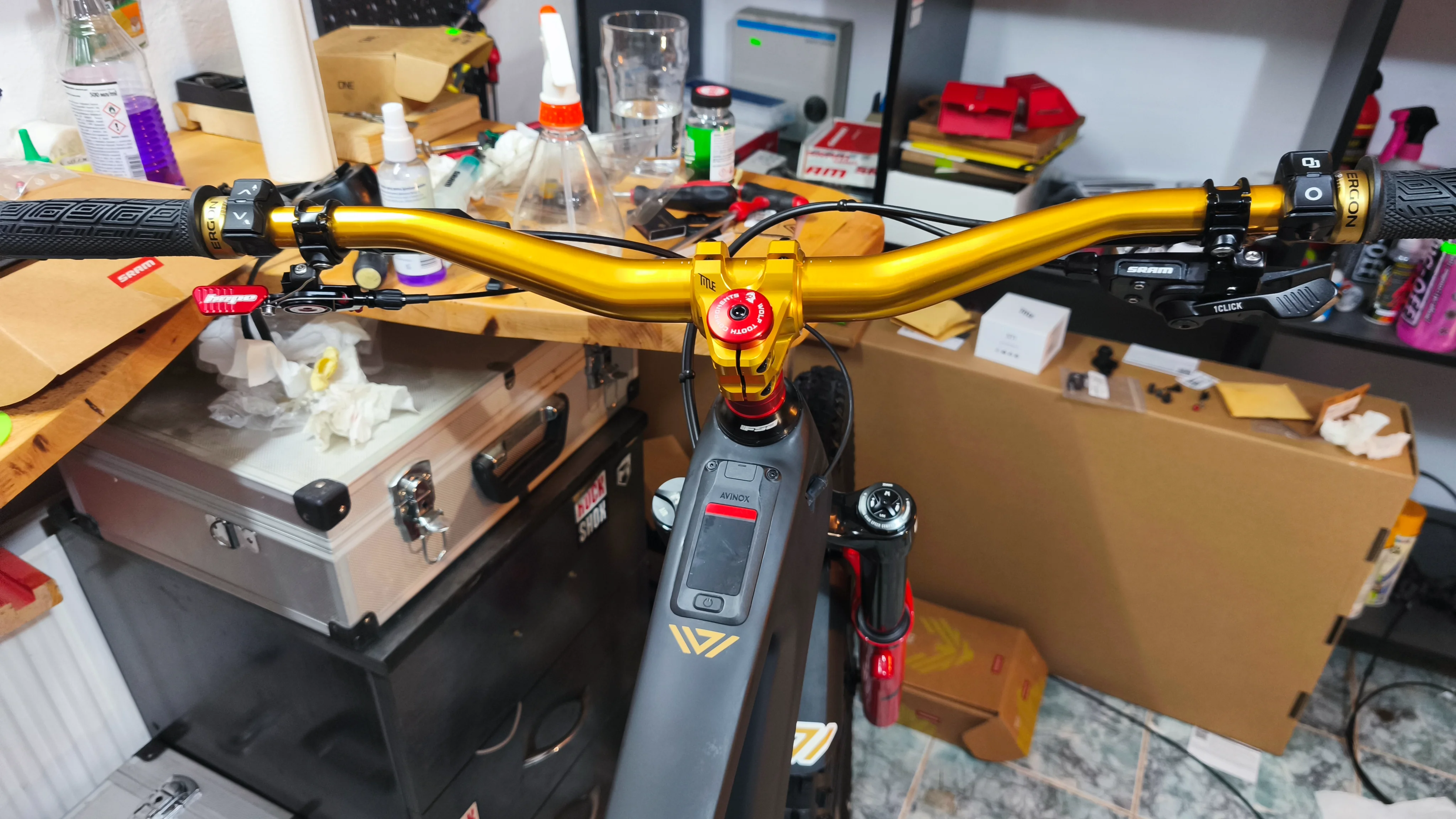

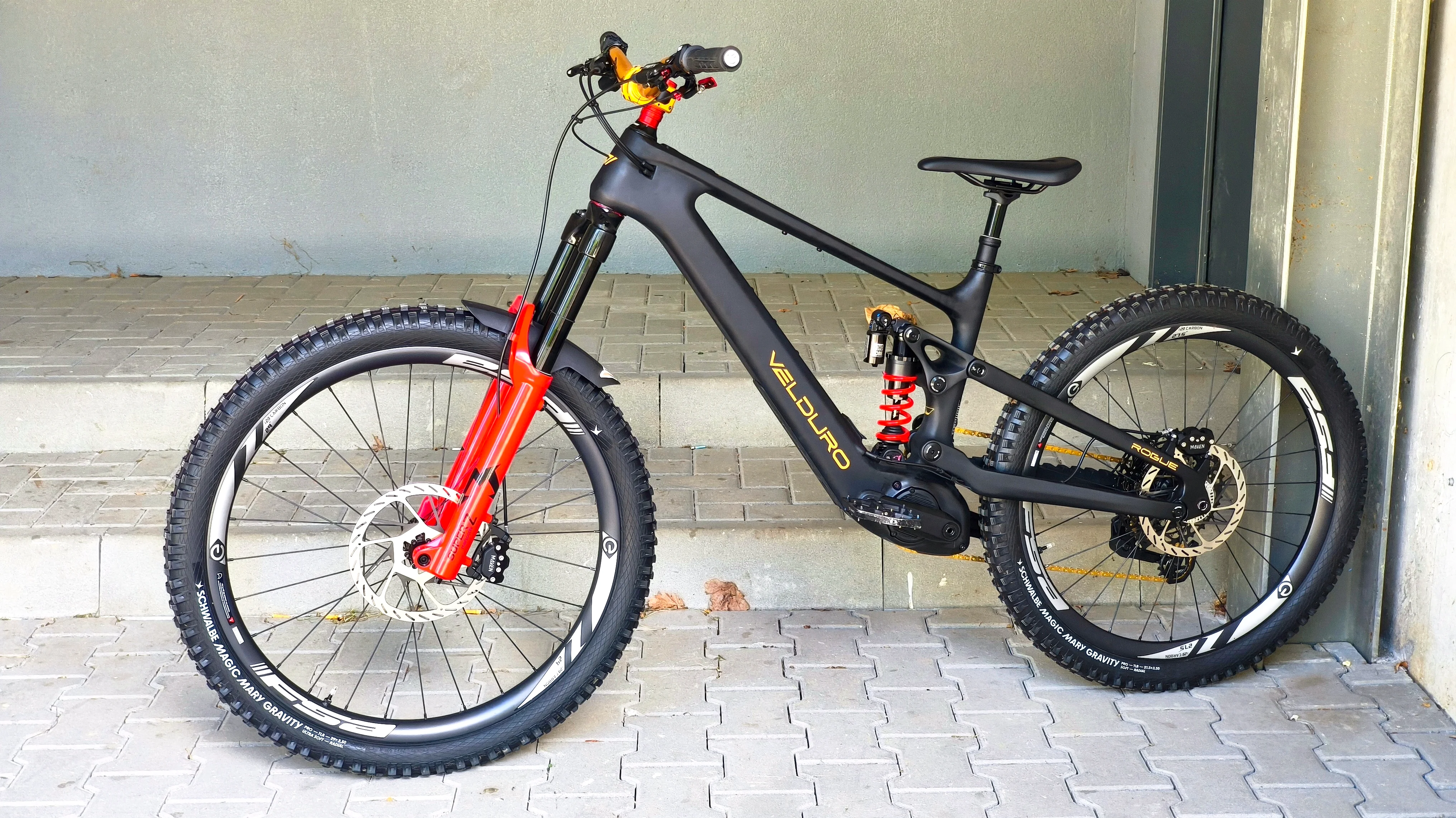

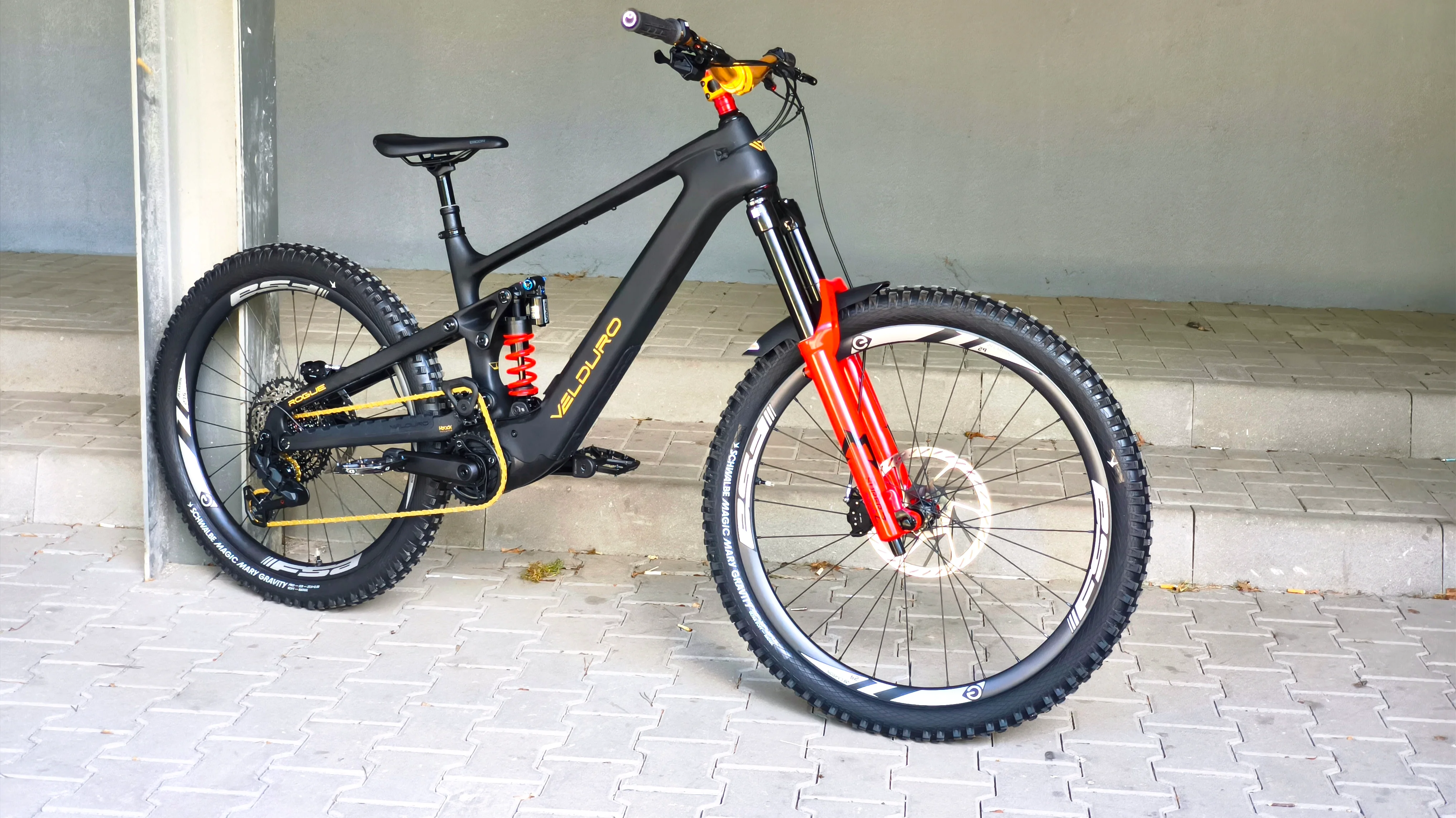

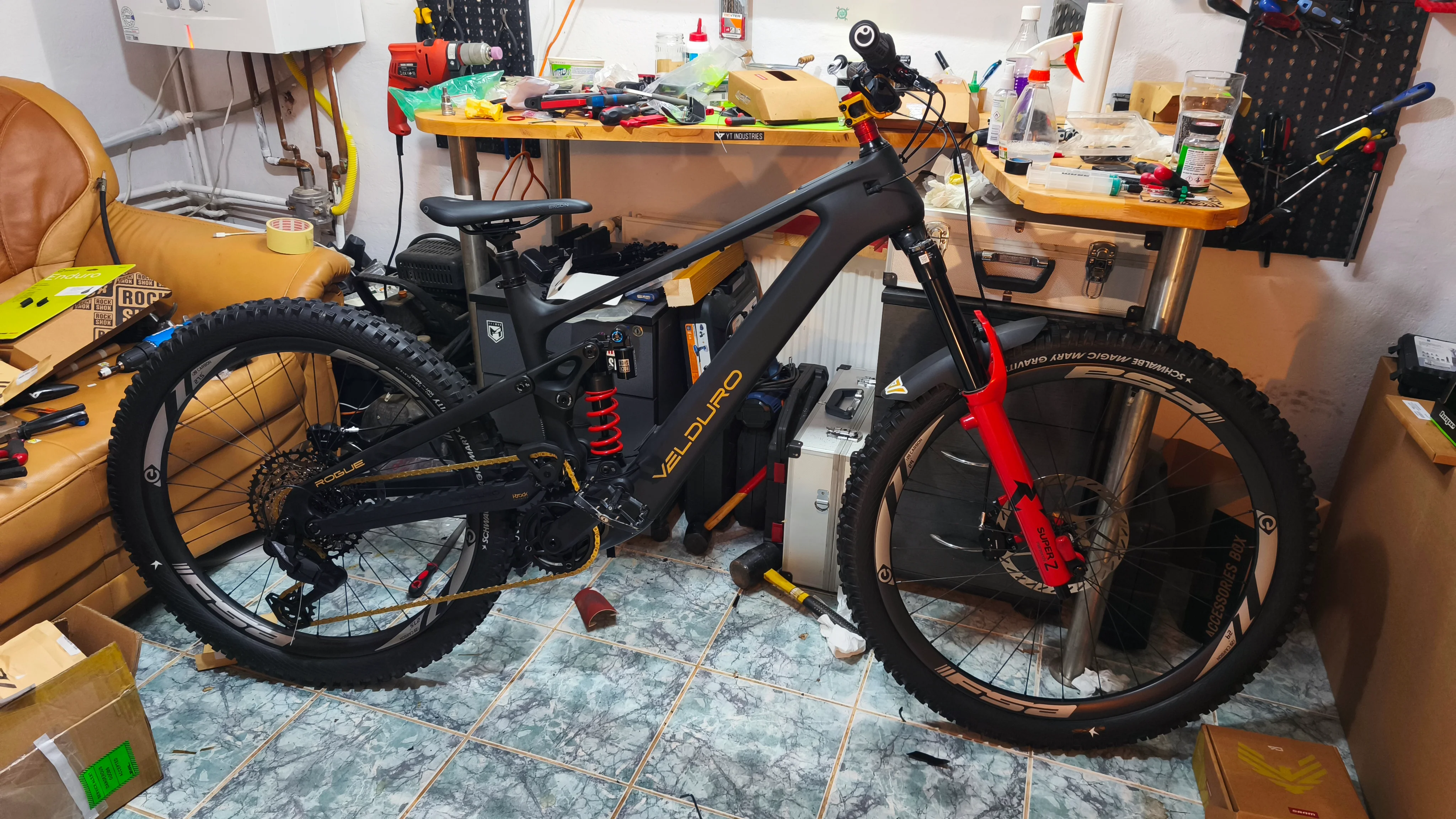

I think it’s worth the wait—the bike is really interesting, well built, and has some great details. Sorry for the mess around the bike, but I only managed to put it together last night.
As for the components:
Velduro Rogue frame without shock.
Marzocchi Super Z 38 fork, 180 mm travel.

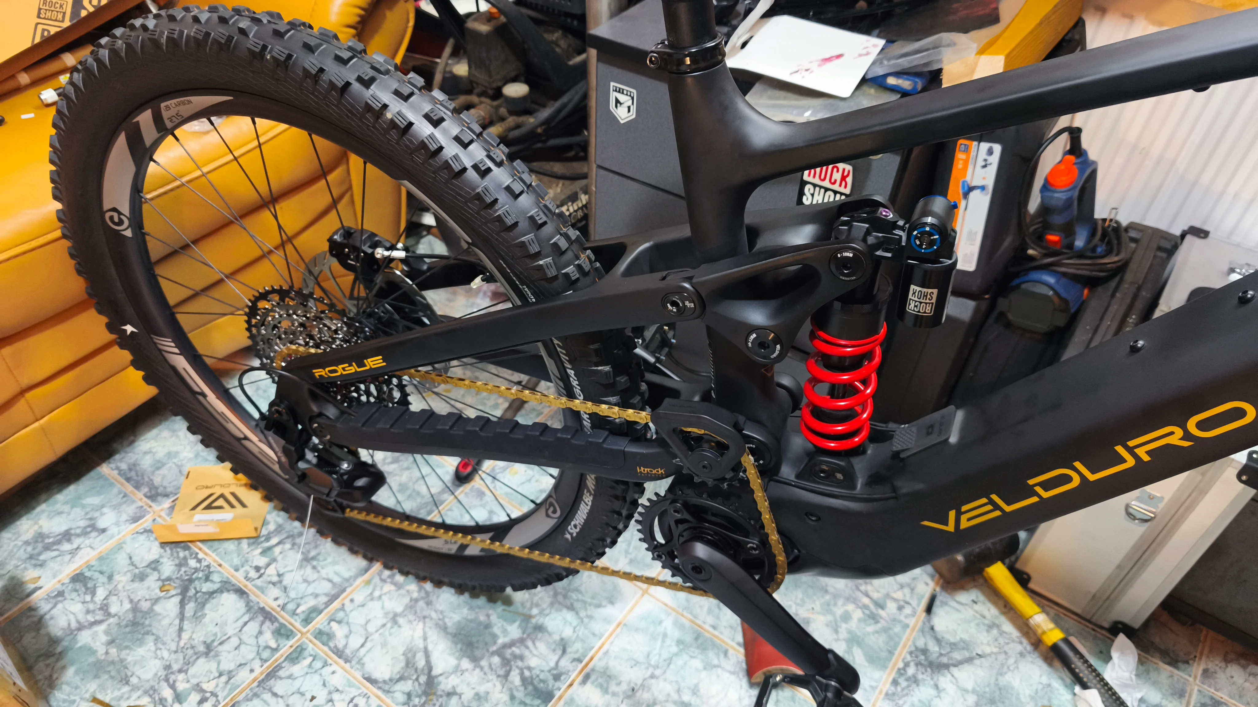

RockShox Vivid 2027 shock, 205x65, with H&R spring plus spacer… in total the spring with the spacer is 141 mm, perfect so the spring collar doesn’t hit the frame.
Carbon FSR i29 Gradient wheels, 29/27.5.
SRAM Maven Silver brakes with SRAM discs 220 front / 200 rear.
Tille cockpit – handlebar plus 35 mm stem.
Magic Mary radial tires.
SRAM Eagle 70 mechanical drivetrain with 90 shifter.
I’m 178 cm tall and I chose size L because I have a long torso and long arms. All my bikes have been one size larger.

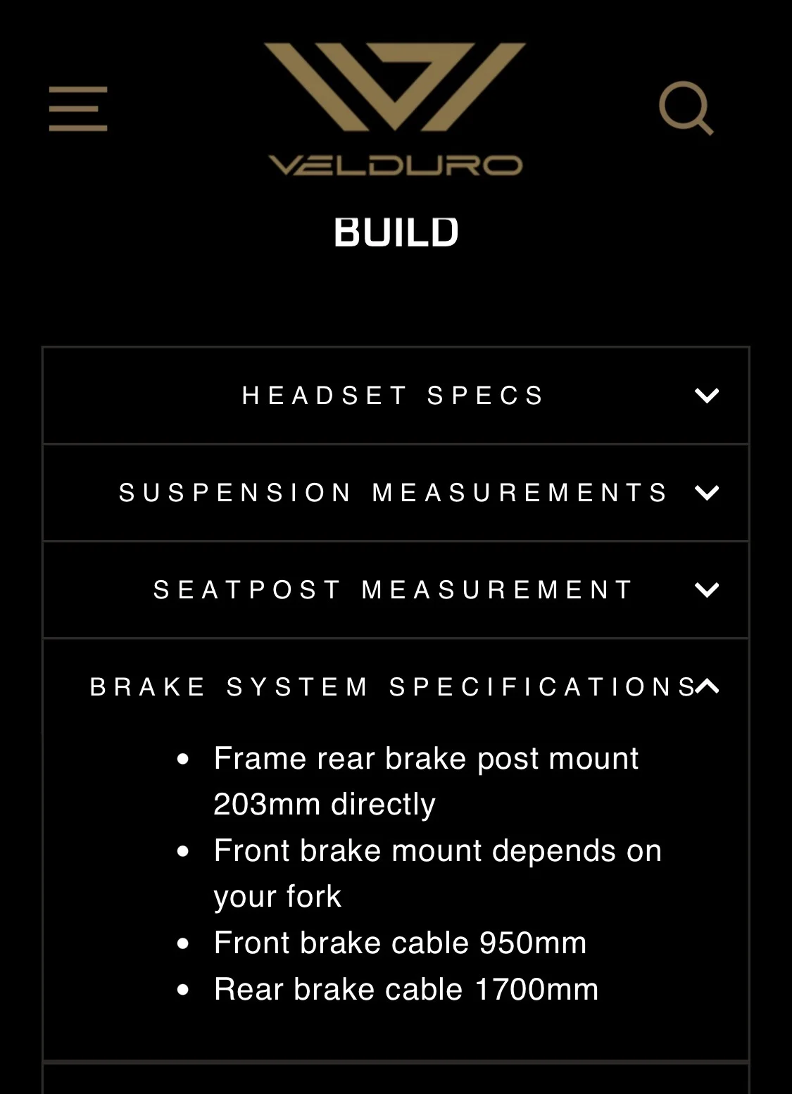

Looks great! Do you know that the back break mount is 203 so with a 200mm disk is not optimal. To be honest I don’t get why they did 203…

Thats what i thought initially, but a 203 fits greater. Scroll back and you will find i took a picture of both.
THIS IS FOR UK AND IRELAND ONLY, for other areas please consult your local dealer.
All "full build Rouge X bikes**" that have landed in the UK and Ireland so far came with 203mm rotors and all "frameset" kits should be fitted with 203mm rotors.
** Regarding Rogue R complete bikes only.
The first delivery of Rogue R full builds to the UK and Ireland on container one came with a 200mm rotor, this was an error. The 200mm rotor should and must be changed to a 203mm rotor which we will supply FoC to our customers in the UK. If you have purchased a Rogue R full build please contact your dealer or us directly through our website and we will arrange to supply you with a 203mm Rotor FoC.
All Rogue frames coming into the UK and Ireland from May 2026 onwards have been updated to accept either 200mm or 203mm rotors (with the correct spacer).

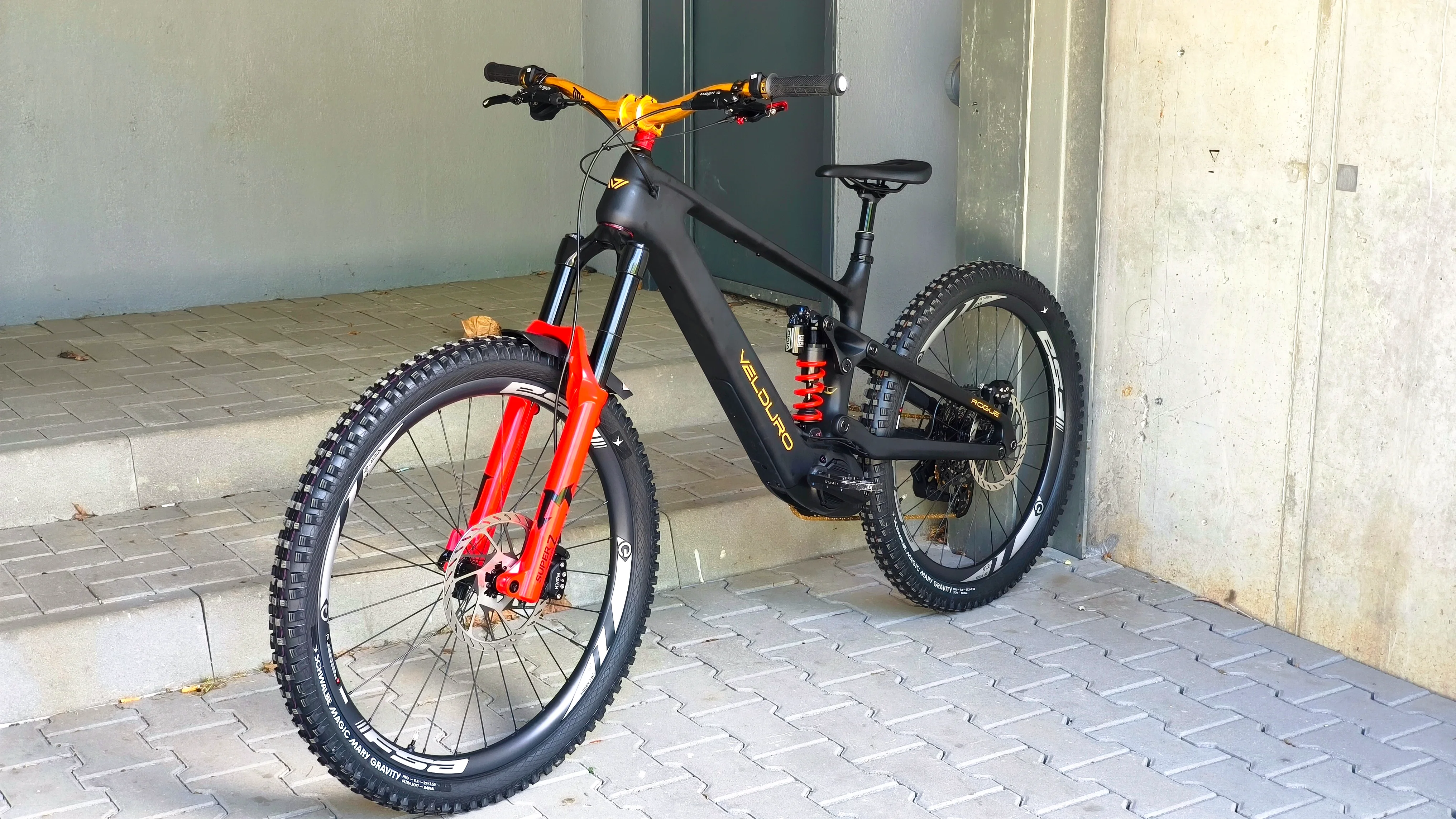

And the photos with the bike. I won’t say anything about the M2S motor—plenty of people have already said enough, and said it well! But the bike is fantastic. I love how I feel on it: it’s playful, it lifts off the ground really nicely, and it handles rough stuff without any issues. Super quiet too—no noise at all.
Looks like you are in 29" flipchip still. Is that intentional?
