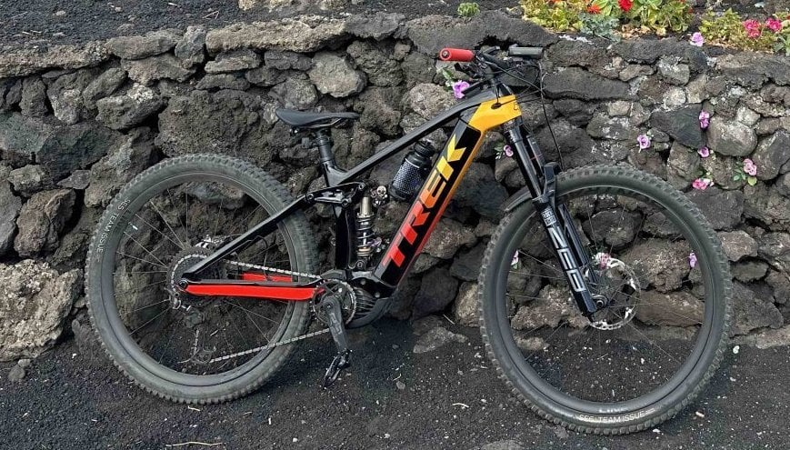

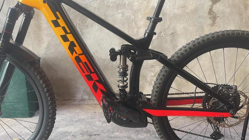

A friend of mine (with my same bike, same color, same Size M) put a EXT eStoria 205/57,5 on his Rail 9.8 2022.
He's very satisfied and as you see, bottle cage is still usable.
I'm in doubt to do the same or going 205/60mm (if it fits); how much will the escursion grow from original 150mm?
Thanks
That will be a 230x57.5 a 205 shock won’t fit a Rail.

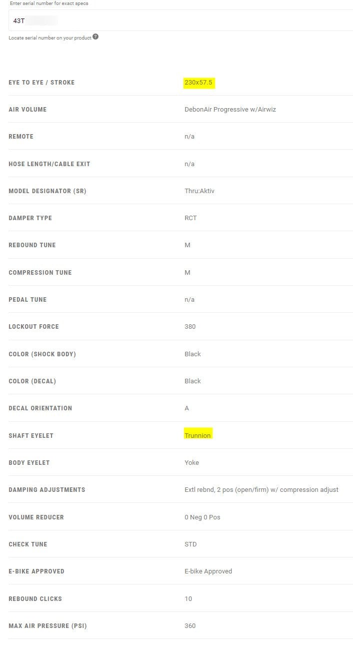

I'm 100% right. Factory is 230x57.5 (you can check the Trek page) I own a Rail but Its easy to estimate..
If a 230 x 57.5 gives 150mm rear wheel travel and a 230x65 gives 165mm travel then you would estimate a 230x60 will give around 155mm rear wheel travel.
I confirm that you're right :-); just inserted my shock serialnumber... but, for my curiosity, what does it mean Shaft Eyelet Trunnion?

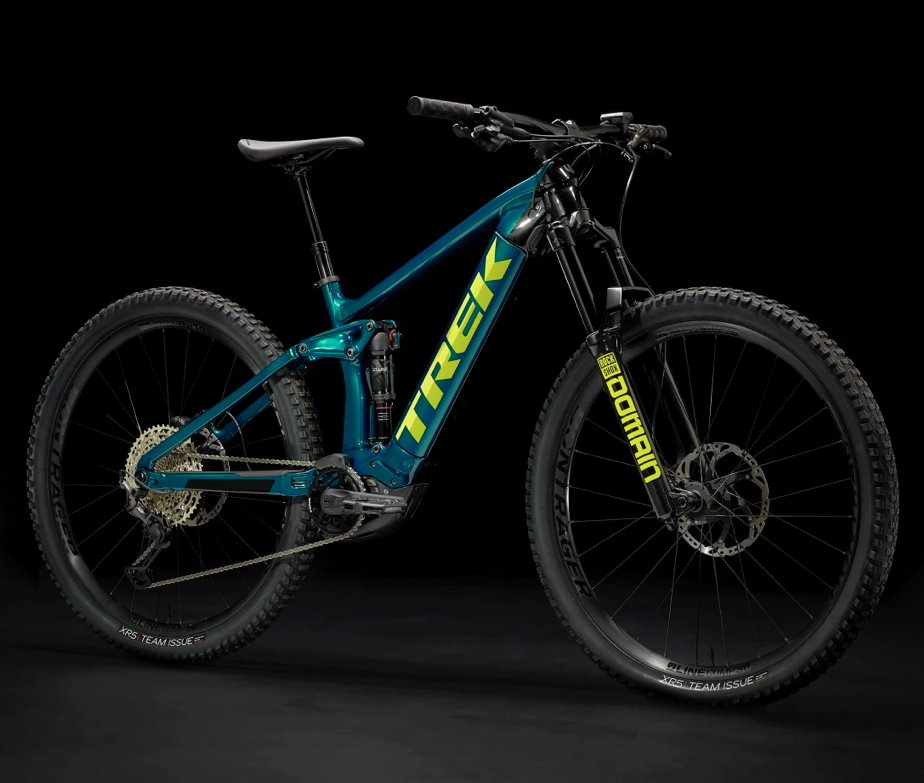

This picture on Trek USA site shows a Trunnion shock.
^^ it's not trunion
however it looks a bit more complicated, coz other models have ThruShaft
Rail9GXAXS_23_36992_A_Alt7
so the bottom eyelet is further from the shaft and then there is trunion mount at the top.
rockshox doesn't have 230mm (normal) shock with trunion mount (I think).

^^ it's not trunion

oh yes, it wasn't trunion on aforementioned pic.
please read more carefully, trunion is only on thrushaft shock which is Trek specific and probably difficult to get.
Can you get (does anyone makes) 230mm trunion shock from anyone else ? (or even from RS but without ThruShaft....)
