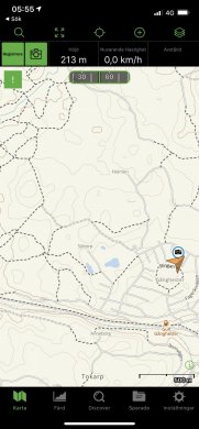

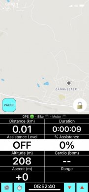

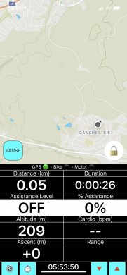

Ok, thanks for the answer. Here is the normal map of Blevo and the terrain map and Gaia as a compare:
781F75AF-3401-48A6-826F-E8AAFB592CB0.jpegB1184436-1354-4C9F-8374-FD7EB9BDF33D.jpegC6D5B2F9-9F9A-4A8C-87ED-9D13F68C70C6.jpeg
