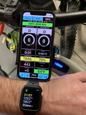

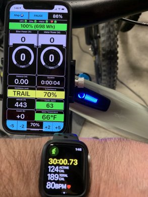

I'm having Apple Watch HR issues too...been trying many things for the last few months, but seems there is no fix.
I'm using a iPhone 12 pro with Apple Watch Series 5.
I've tried it using my wife's Apple watch Series 5 and her iPhone 8 Plus too and having the same issue.
Does anyone have BLEvo working consistently with Apple Watch HR?
if so, what version iPhone and Watch do you have?
Attached are photos of it connected but with the HR being off, and then it disconnects, even though the watch is still showing HR.
View attachment 52561View attachment 52562
I haven’t ridden recently but apple watch support is the main reason I purchaed the app so that’s dissapointing to hear.
