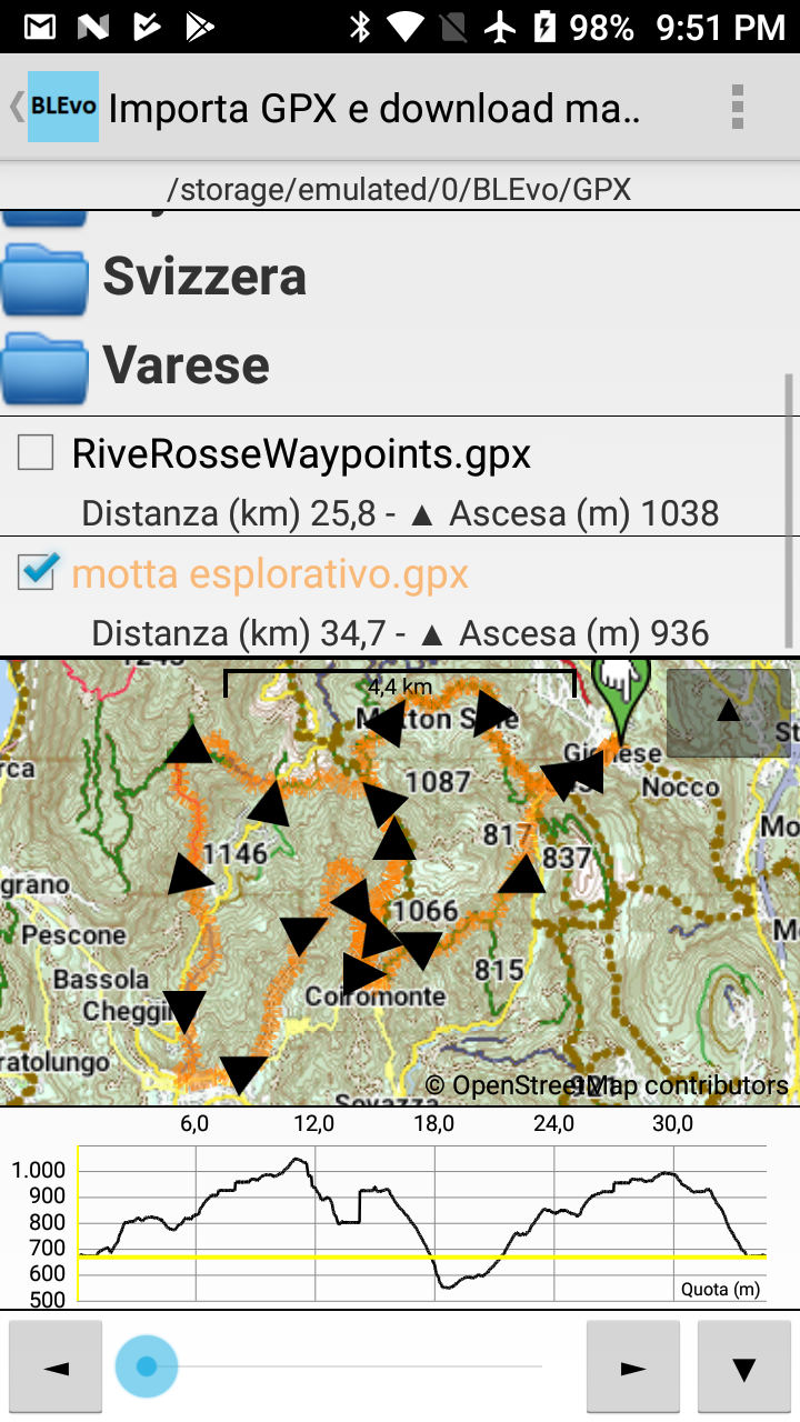

@PaoloBLEvo Another feature request....I'm really getting used to BLevo and want to do more with it..;-)
When adding GPX tracks to the maps, could it be possible to add all tracks from a folder, rather than having to add each one individually..? The use-case is when I select trail in a local forest/woods, there are often 10-15 different tracks that I need to download. If I could put them all in a subfolder eg "...maps\Cannock Chase..." then it would make it easier getting all route loaded into BLevo. I have no idea if this is difficult to achieve, so no problem if you cant do it.
Thanks again for such a brilliant app for the Levo, it really does make a great emtb amazing..;-)
Do you want something like this? ;)
Screenshot (17 set 2019 9:51:57 PM).png
Do I need to read the instructions better...?...??
...or is this a new feature you haven’t released yet...?
Either way it looks great...?
I think it’s a new BLEvo feature where Paolo is working on as it is not available in the official app yet.
It clearly shows how quick a small hobby driven company can react and develop to market requests without the need of having a lot of team meetings, budget discussions and reporting to senior management first.
Keep up the good work Paolo! ?

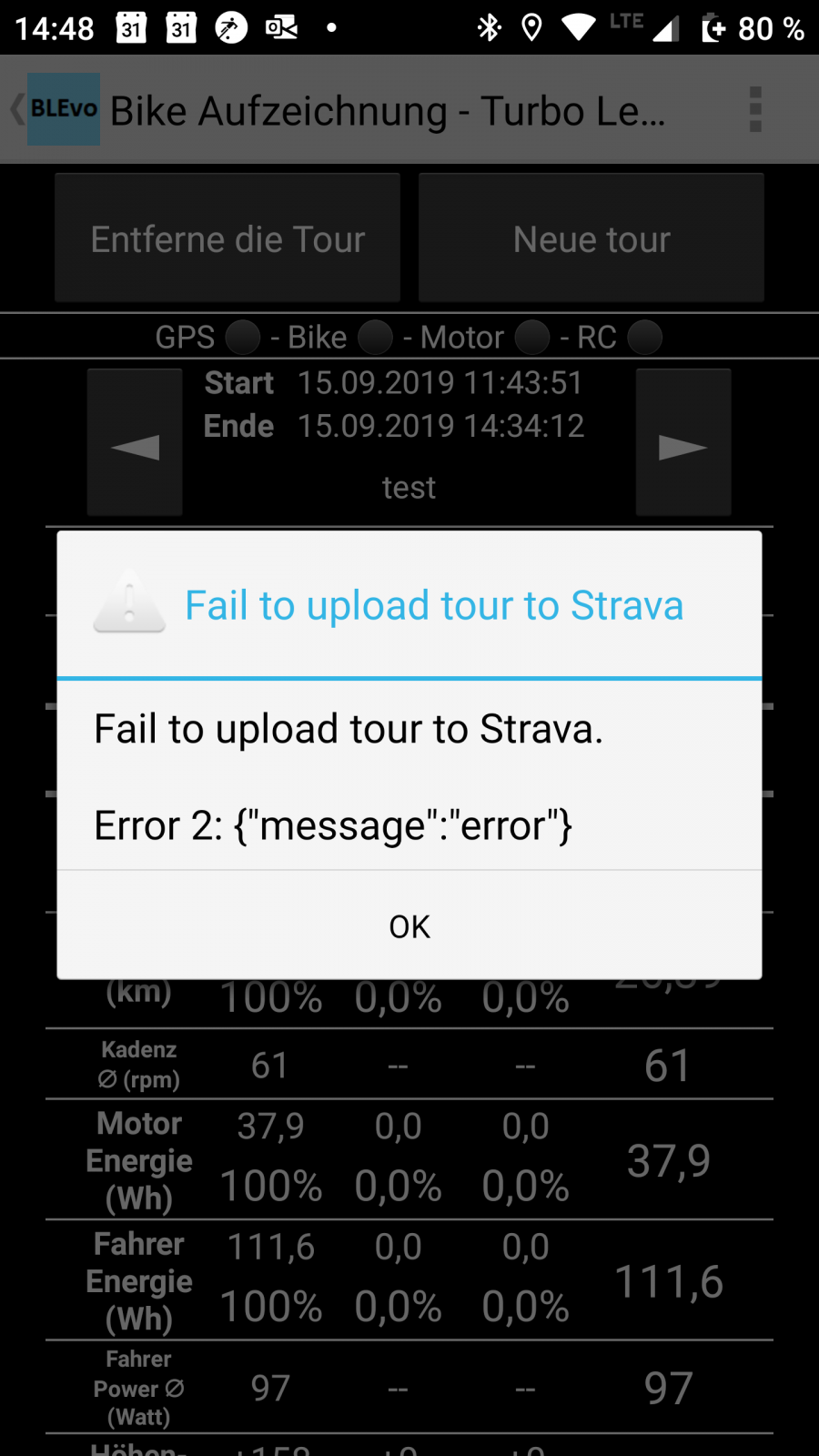

I have just released version 3.5.6 of BLEvo for Android which solves the problem of uploading the ride to Strava. I also added the folder management for GPX.
I did a little video tutorial explaining how to use it (sorry but it is only in Italian)
Here are all the news:
- Add folder management to GPX import
- Added help with the order of display customization fields
- Now the GPX are copied under the /BLEvo/GPX/MyRides folder (on request)
- Bugfix: Barometer calibration on start tour
- Bugfix: Upload Strava
Minor changes:
- Fixed initial autozoom on GPX opening
- Fixed import and WP name with tag <![CDATA[
- Enlarged assistance keys +5 +1 -1-5
- Store GPX ascent and distance information
- Converted to ? characters not accepted by Strava
- Now scrolling through the rides, the relative TXT is updated
- Removed the private field from the upload on Strava
- Added Battery Monitor button in Bike Setup
