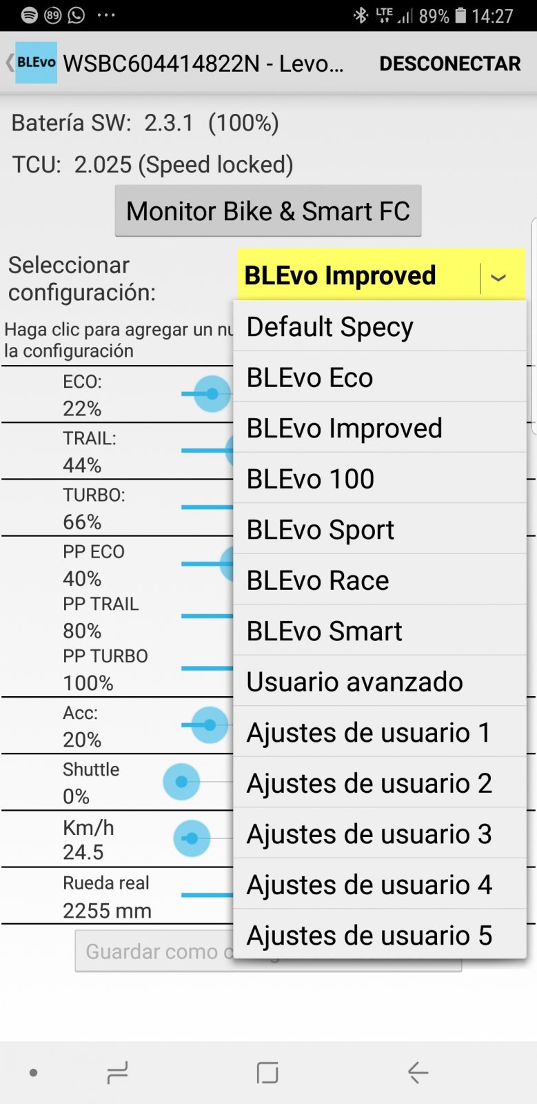

Sorry if this has been covered already, I just picked up my 19 Levo last week (I did install Blevo before I got my bike!) and can not find the smart tuning modes mentioned in the manual and on this thread, all the preset modes are just adjustments that you could make in Mission Control, My TCU also shows (Speed locked). Is the fnctionality limited on the 19 Levo?
No consumed KCalc in monitor of BLEvo for Android. It is in BLEvo for ios. Is it possibility @PaoloBLEvo to add this feature to android’s version of BLEvo?
Sorry but I don't understand your question. If the TCU is the version 2.025 the speed limit cannot be changed.
The Smart settings are able also in the Levo 2019. They are under Configuration->Smart Configuration.
Could you explain better your problem?

What I do not see are the other tuning options mentioned on the manual like Zeus and Z-works. This is a screen shot.
Thank you!
Thank you!
Sorry, but which manual? You have the new Levo 2019, the Zeus settings are old and available on old firmware x.22 (2 versions ago)
