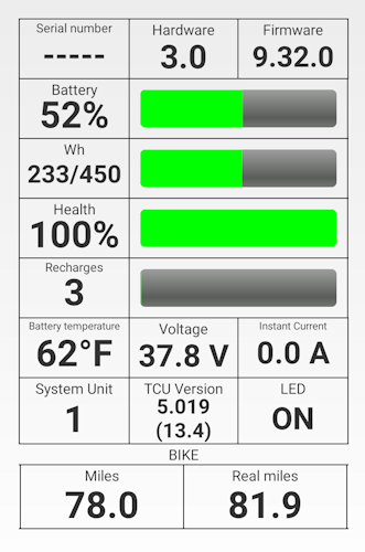

Looking for info from anyone to clear up my confusion over the version numbers for various parts of these bikes. For reference, my Battery Monitor screen is below. This is for a Vado so things might not match up with the Levo series. Mainly my questions are:
- What "Hardware" is this the version of?
- Also, which "Firmware" version is displayed?
- What about the two numbers in the "TCU Version" box?
- Any others that are not displayed here or are shown elsewhere?
Thanks!
Thanks!
All the version numbers come from the bike..
Firmware is the software versione of the battery.
Hardware is the hardware versione of the battery
TCU version is the software version of the display or TCU..
