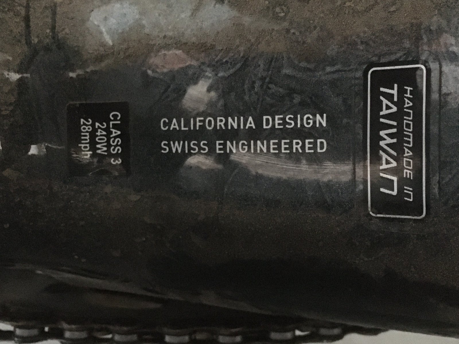

Hi Paolo.... Creo bike with 2184.4mm tires... BLEvo 3.5.9 IOS... I live in the USA with a 28mph speed limit... How can I change the speed? It reverts back to 15.7mph... How can I override this setting? I love your app!
Thanks, Dexter
Thanks, Dexter
Let me know if you figure this out. It used to work but one or two Blevo updates ago this has happened on every attempt to change the speed limit back to 28..
I end up just using Mission Control instead of Blevo with the Creo if I want to average over 16mph.
I'm hoping Paolo either has a fix or develops a new App for the Creo!!! He already has 99% done for the MT bikes... I do not know anything about programming but I think it would be easy! Change a few words like Trail to Sport and have the speed setting to 28mph for the US market... He will then have the whole Creo market to sell Apps too... I'll sent in my money tonight to be the first Beta tester!
That would be nice, however the current app worked perfectly on my Creo for months. I only lost the speed limit after the more recent updates.
Thanks, Dexter
Sorry but you cannot change the speed of Creo bike with BLEvo.
The value of 25km/h is fake for US market..
It is as US market wants..
Hi Paolo... I understand your first sentence but not the next two... Probably a translation thing! I understand this App was developed for the MT bike and the European market with there speed limit laws... As Jersey Skier mentioned, the BLEvo app worked in earlier versions... I know you are walking a fine line to satisfy Specialized and European Laws with speed limits... I guess I do not understand what you meant by "Fake for the US market" and "It is as US market wants".
Are you interested in making a New App called Creo for the US? Just copy everything in BLEvo and have the speed parameters able to set to 28mph! I'll be your first customer!!!! Dexter
