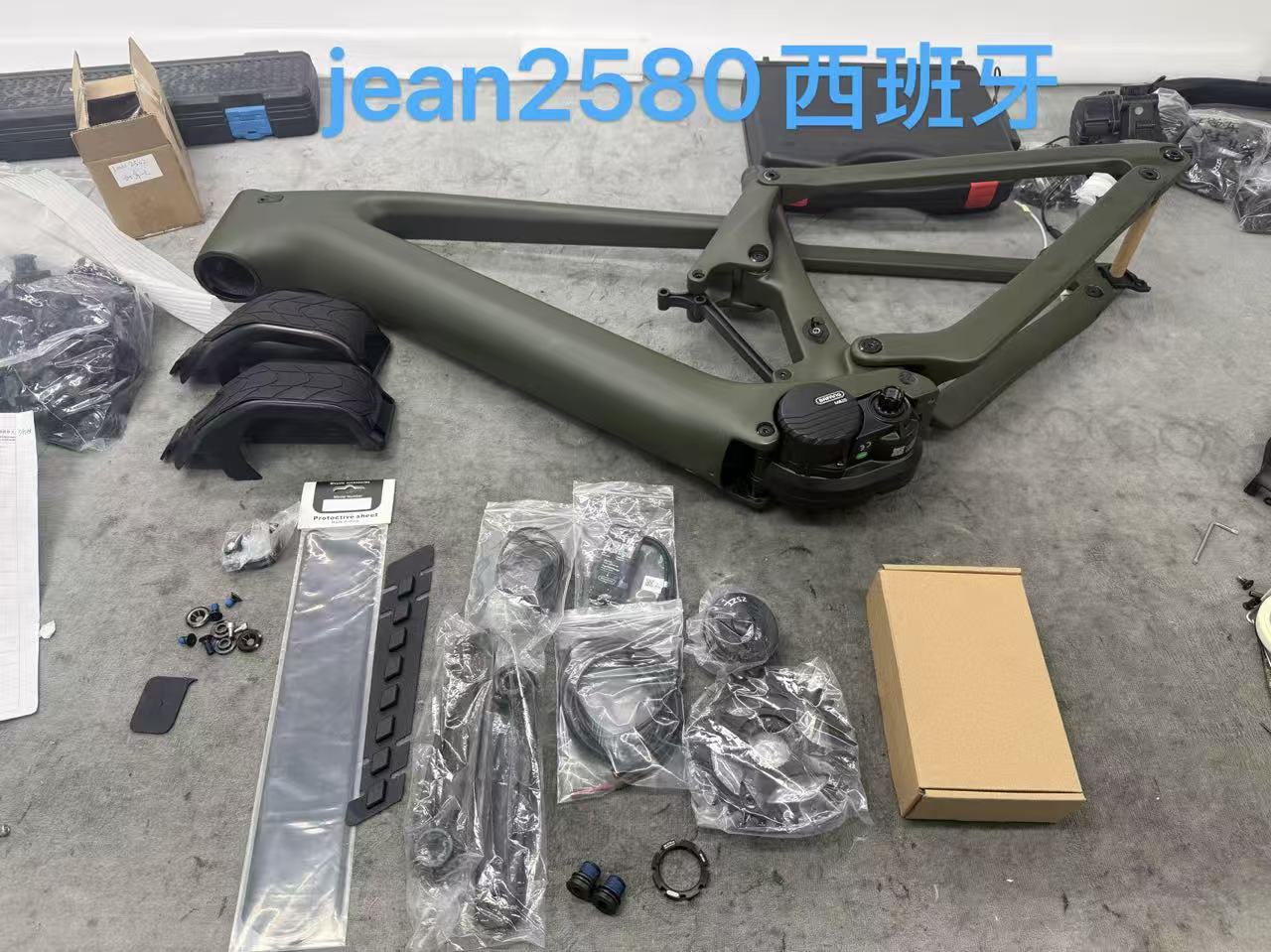

Hey, i'm back, after being one of the first owners of a CEF50 frame a couple years ago and selling it, I decided to buy one again, so probably you'll see me adding info and upgrades to the frame, this time its a CEF50-3 with the DPC030 display.
I'm waiting for the frame to arrive, Size L, Green matte color, 700wh carbon battery.
components waiting in my garage for the build:
- DIY wheelset, DT350, Sapim D-light and EX511, both 29 but I have a spare 27.5 also to try it mullet, Assegai / DHR2 DD both
- Funn ZS56/66 headset, no ICR, proper cable routing through the frame (part I hated the most from my old CEF50, ICR)
- Rockshox Lyrik Select+ 170mm fork
- Rockshox Super Deluxe Ultimate Air shock @ 210x52.5 (157.5mm travel)
- Funn 45mm stem
- Renthal fatbar carbon 770mm handlebar
- FSA carbon IS cranks
- Oneup seatpost 210mm
- SLX/XT mix M8120/M7120 brakes
- 203mm XT discs
- M8100 10/52 cassette + XT derailleur, shifter and chain
- Aliexpress carbon saddle
- M8120 pedals
Aiming to 20kg+-, lets see where it'll land.

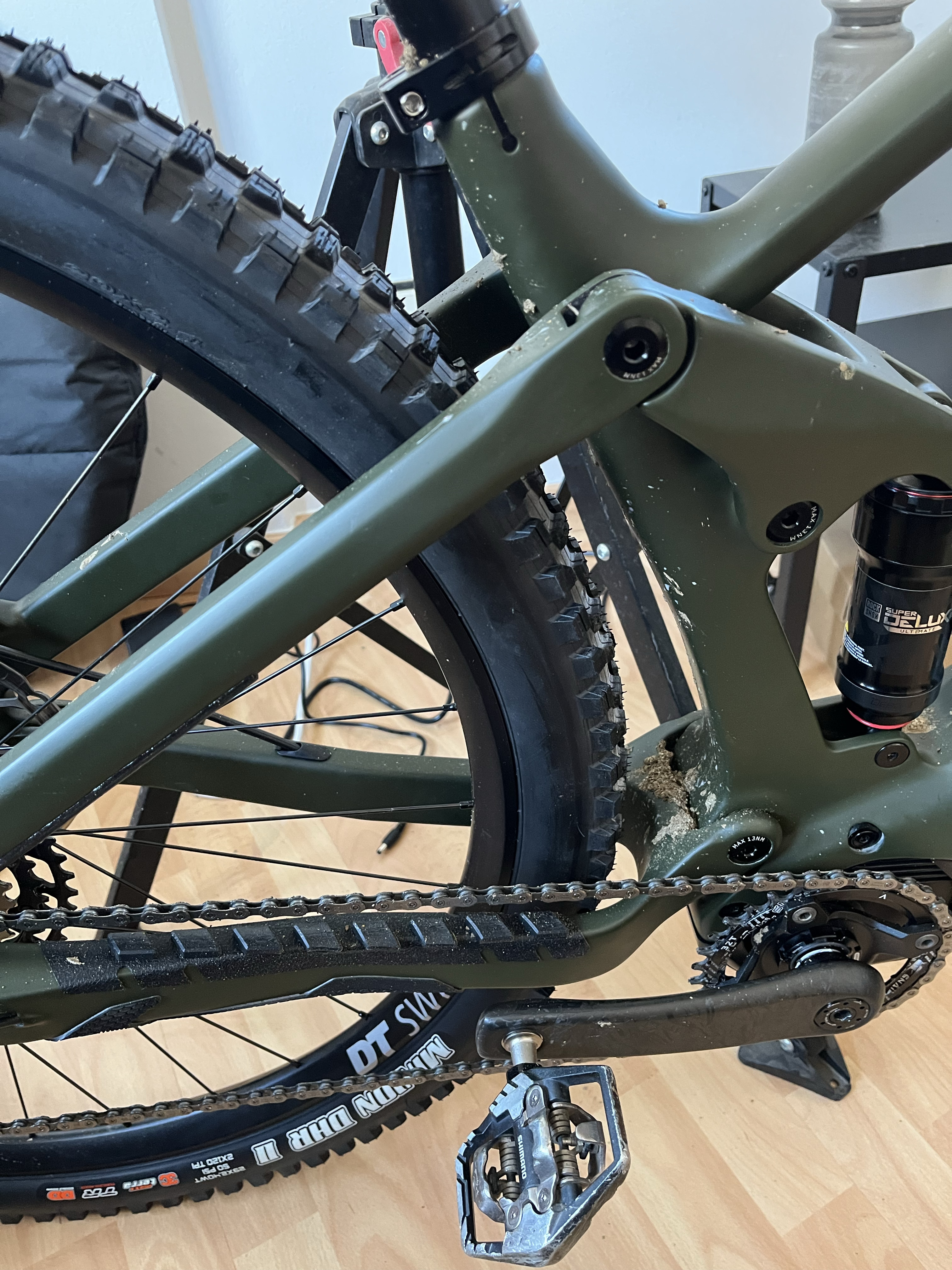

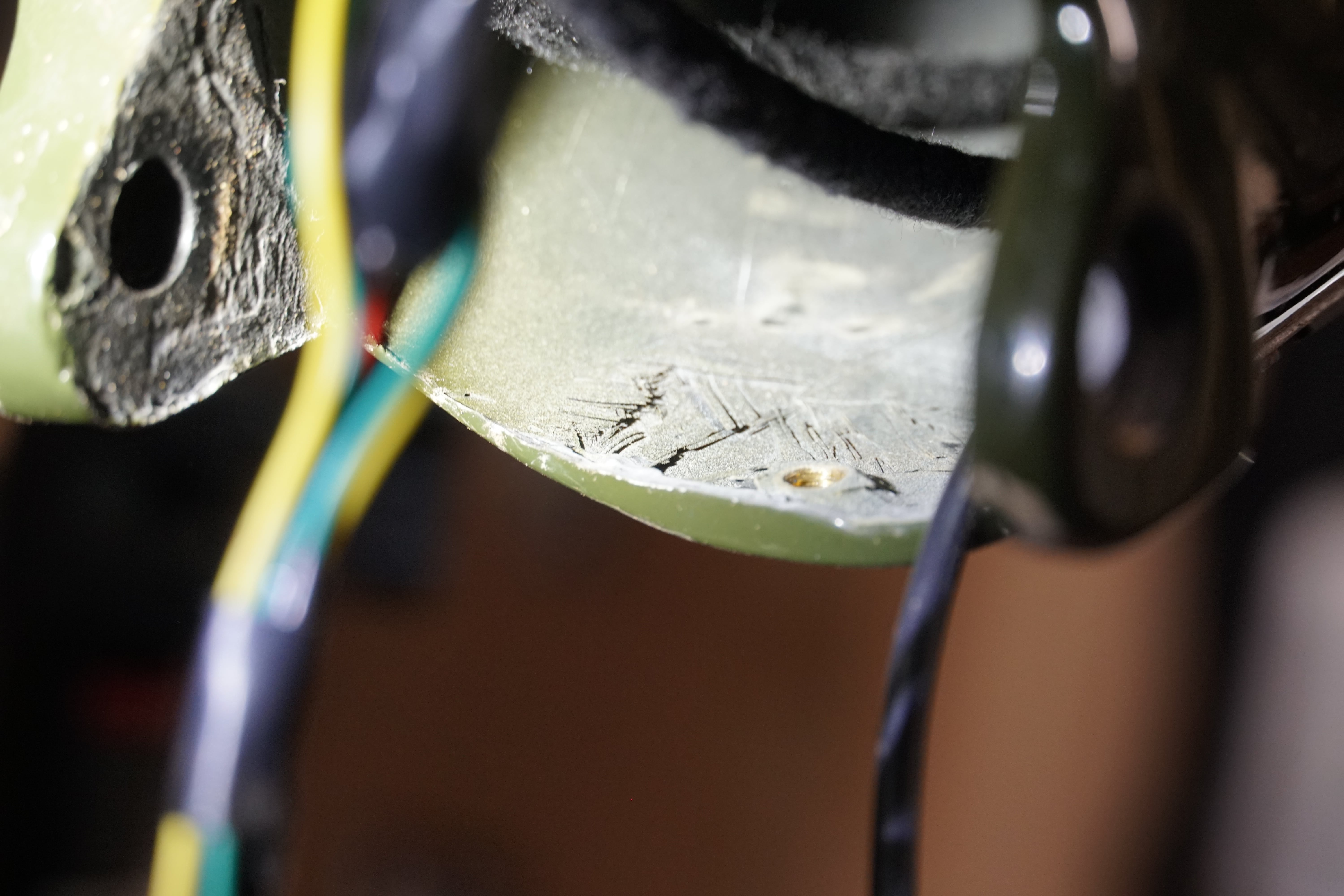

Did anybody has this delamination oh their frame. It's located under motor, where the battery slips in?
Link to Youtube video: - YouTube

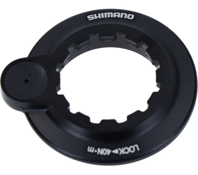

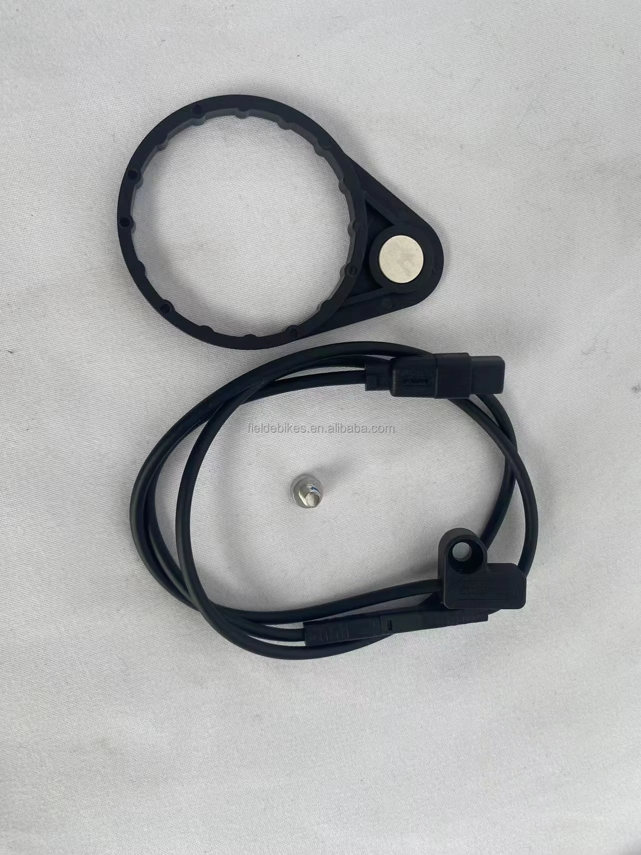

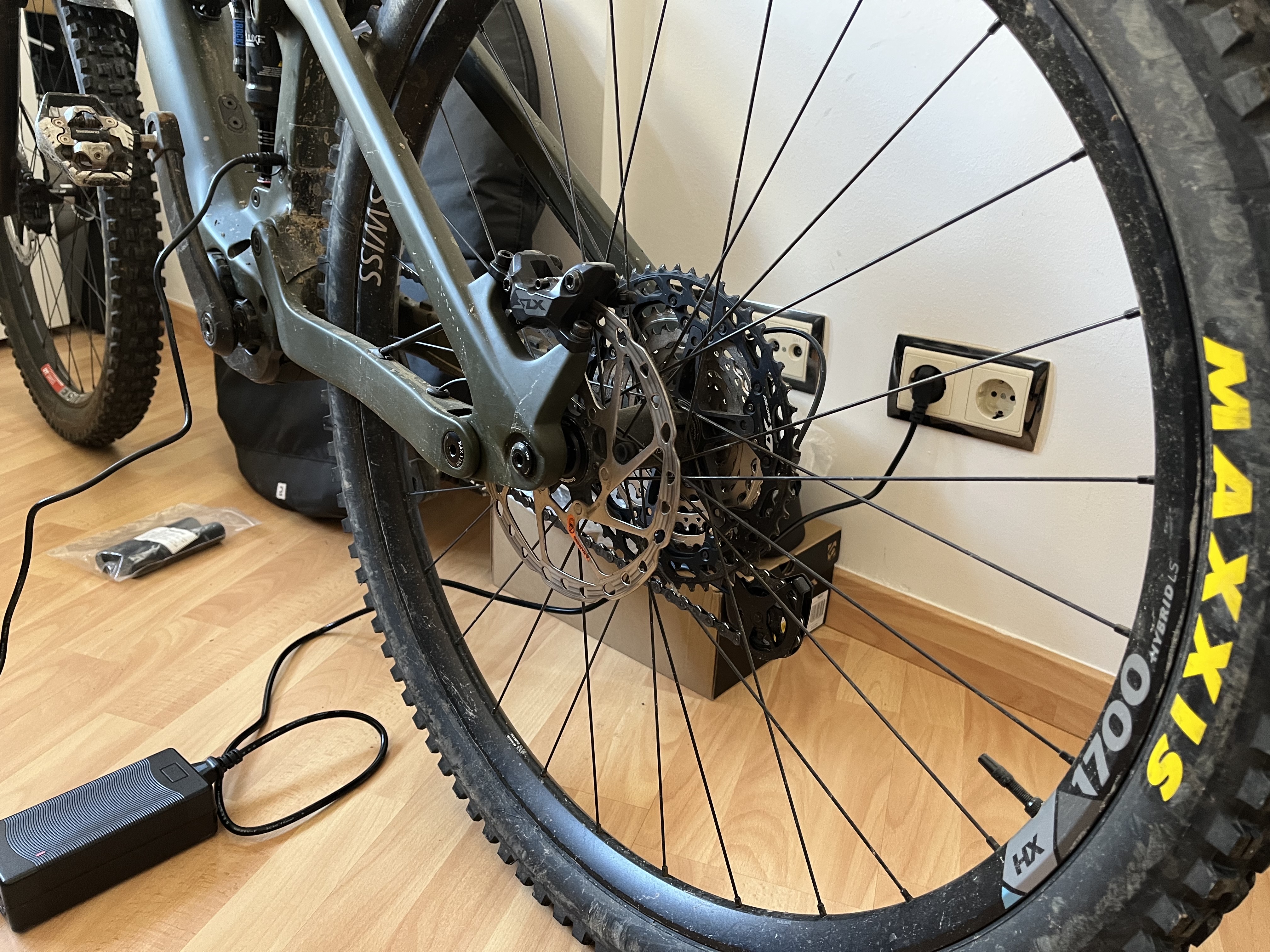

For my CEF50-1 first models I had to create a custom magnet for my centerlock disc so it worked fine, but I noticed that now the frame has 2 places to screw the sensor instead of 1 as before.
So my question is, can I now use the original shimano lockring magnet? Like this one
Its a bit closer to the axle than the bafang one:
So my question is, can I now use the original shimano lockring magnet? Like this oneView attachment 171312

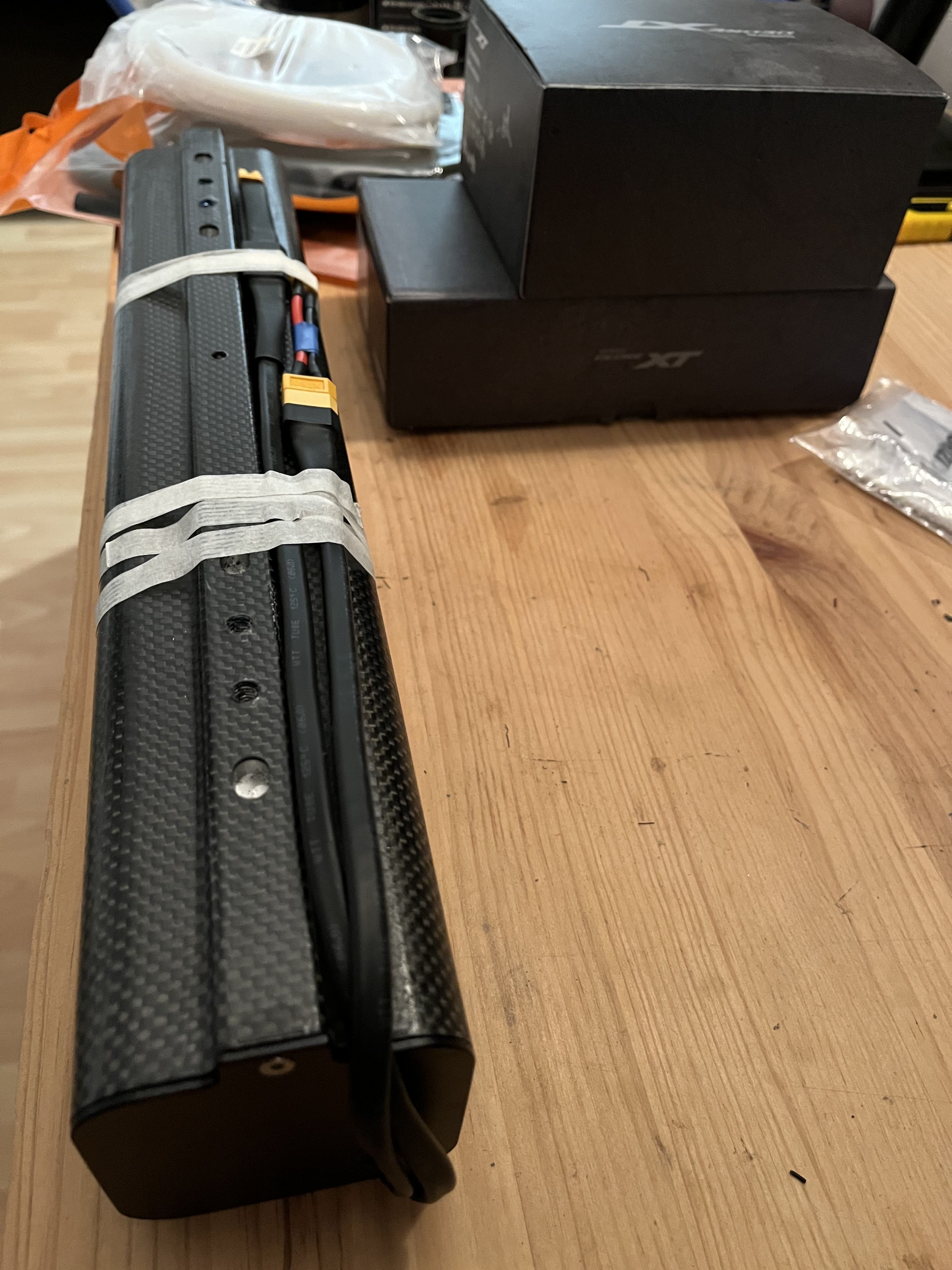

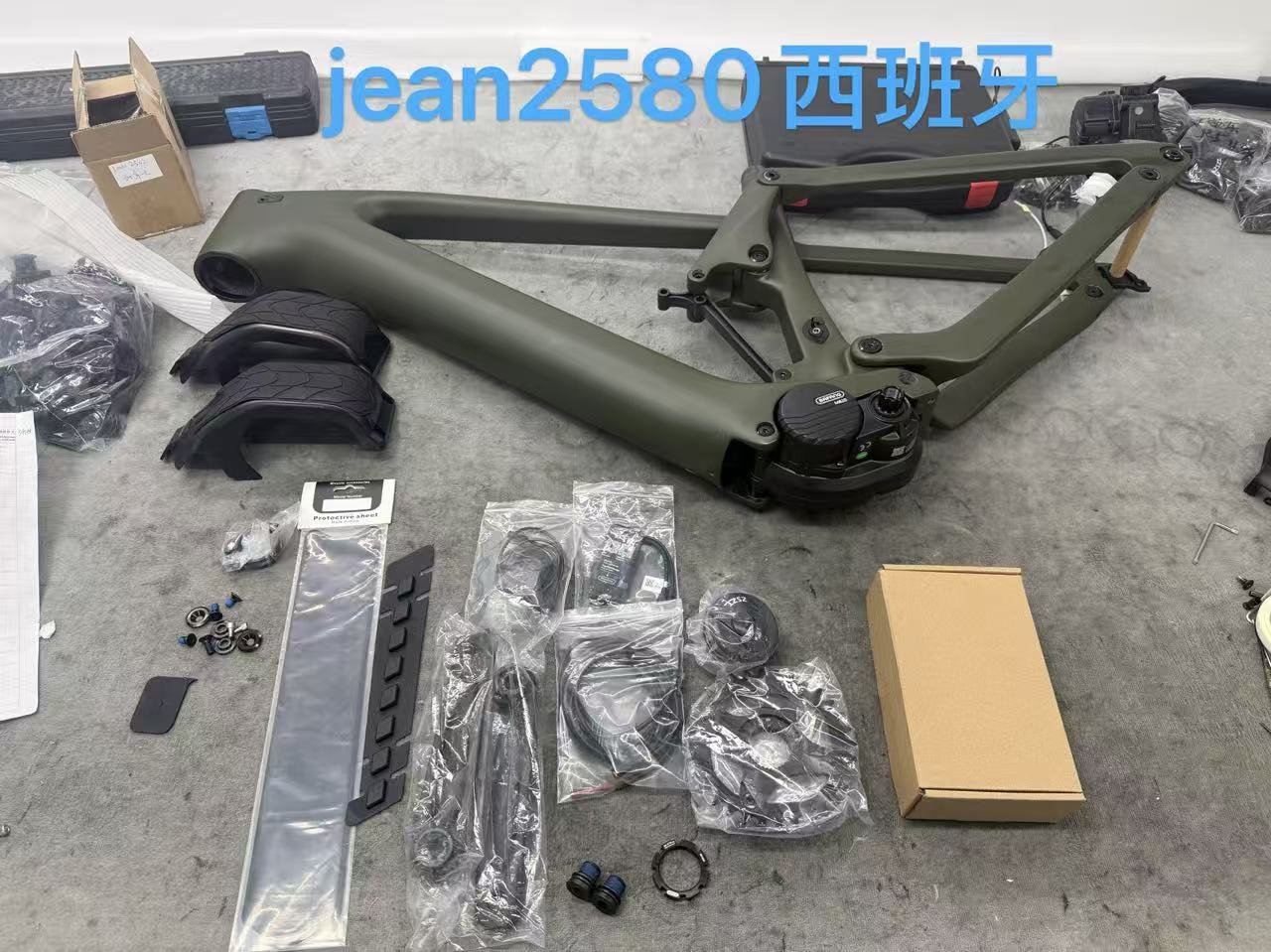

Shipping is by air so hopefully it should arrive here within 15-20 days. Love the color, although in the photo it isn't quite representative, there's a video with the same color on a cef55 that's with proper light ()
Battery arrived, now waiting for the frame. Eternal wait :'(
Also this week carbon cranks should arrive, last piece to have all the parts ready, I even finish building the wheelset

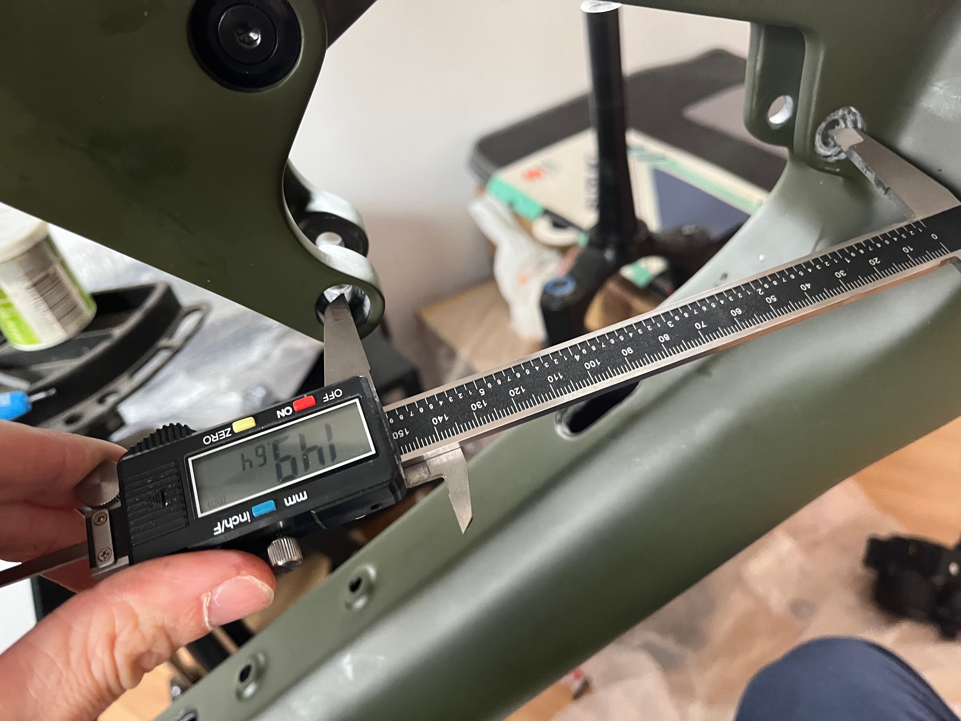

Max shock strone on CEF50 v3 size L is 59mm (210-149.64) Realistically 59-58 ideal since 60 would have interference on the link.
Im going 210x55 directly

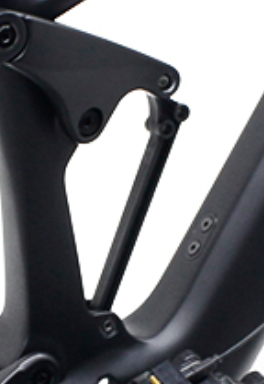

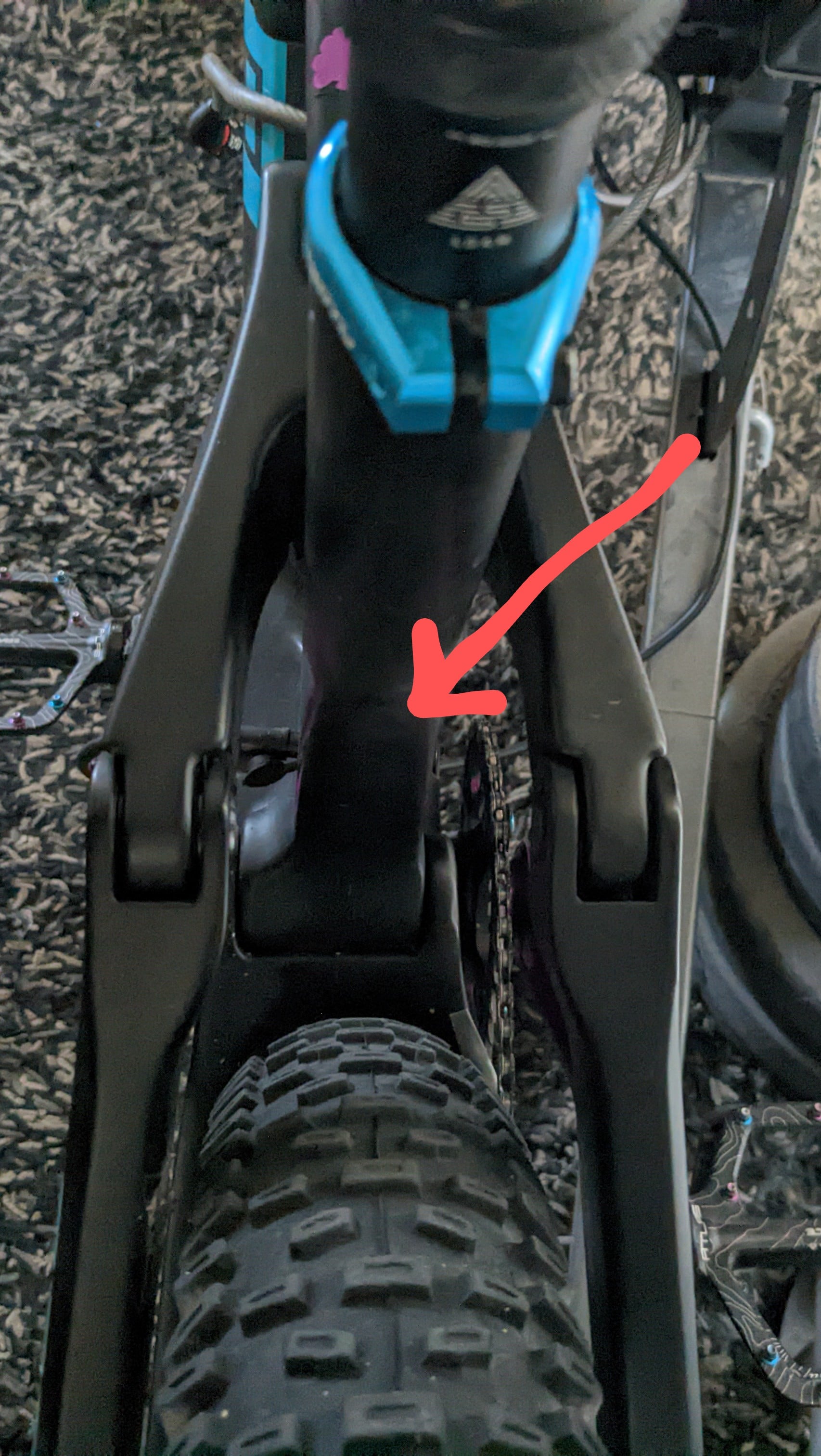

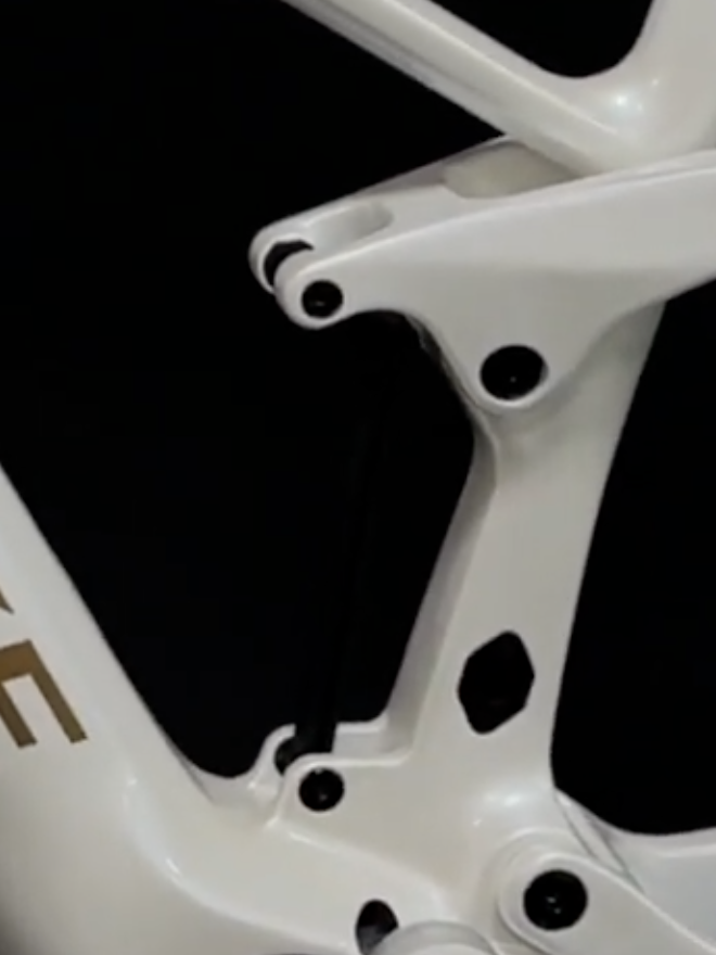

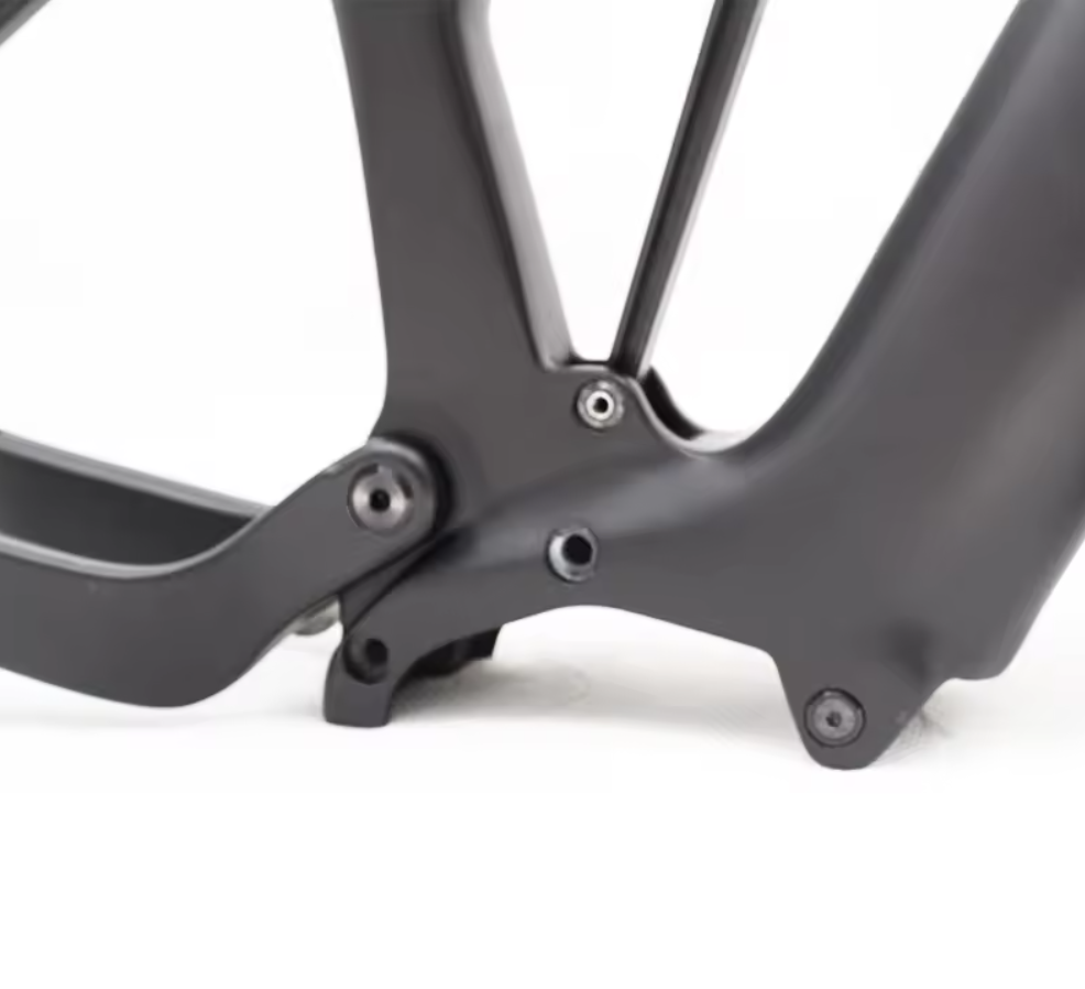

One of the frame design issues that I brought up in the past was the lack of seatstay crossbar. It does have a beefy all-carbon rocker arm. So, it seemed unusual, thinking that it's a weight savings strategy. Yet is it at the expense of lateral support? I don't know if this true, and I don't feel it in the frame performance...yet!😵‍💫😁
However, after seeing some of the same lighter, full-powered designs (both carbon and alloy) from recent Eurobike internet video, is having no crossbar sound from an engineering perspective?🤔
Any legit structural/mechanical engineers in this forum that might be able to explain at a SIMPLE level if this is indeed structurally superior to having a crossbar vs. not? Just curious as a layperson. 🍻
Was there a structural problem due to the lack of this connecting piece on the arm? I ride enduro, I hadn't noticed it was missing and I'm a little worried.

Y avait-il un problème structurel dû à l’absence de cette pièce de connexion sur le bras ? Je fais de l’enduro, je n’avais pas remarqué qu’il manquait et je suis un peu inquiet.
personnellement je pense pas. Les liaisons sont en chape et pour compenser les contraintes, ils ont mis 2 roulements cote à côte. aucun problème avec mon utilisation (papy 100 kg). Pas plus avec mon gamin (60kg) qui l’utilise maintenant, moins lourds mais beaucoup plus vite

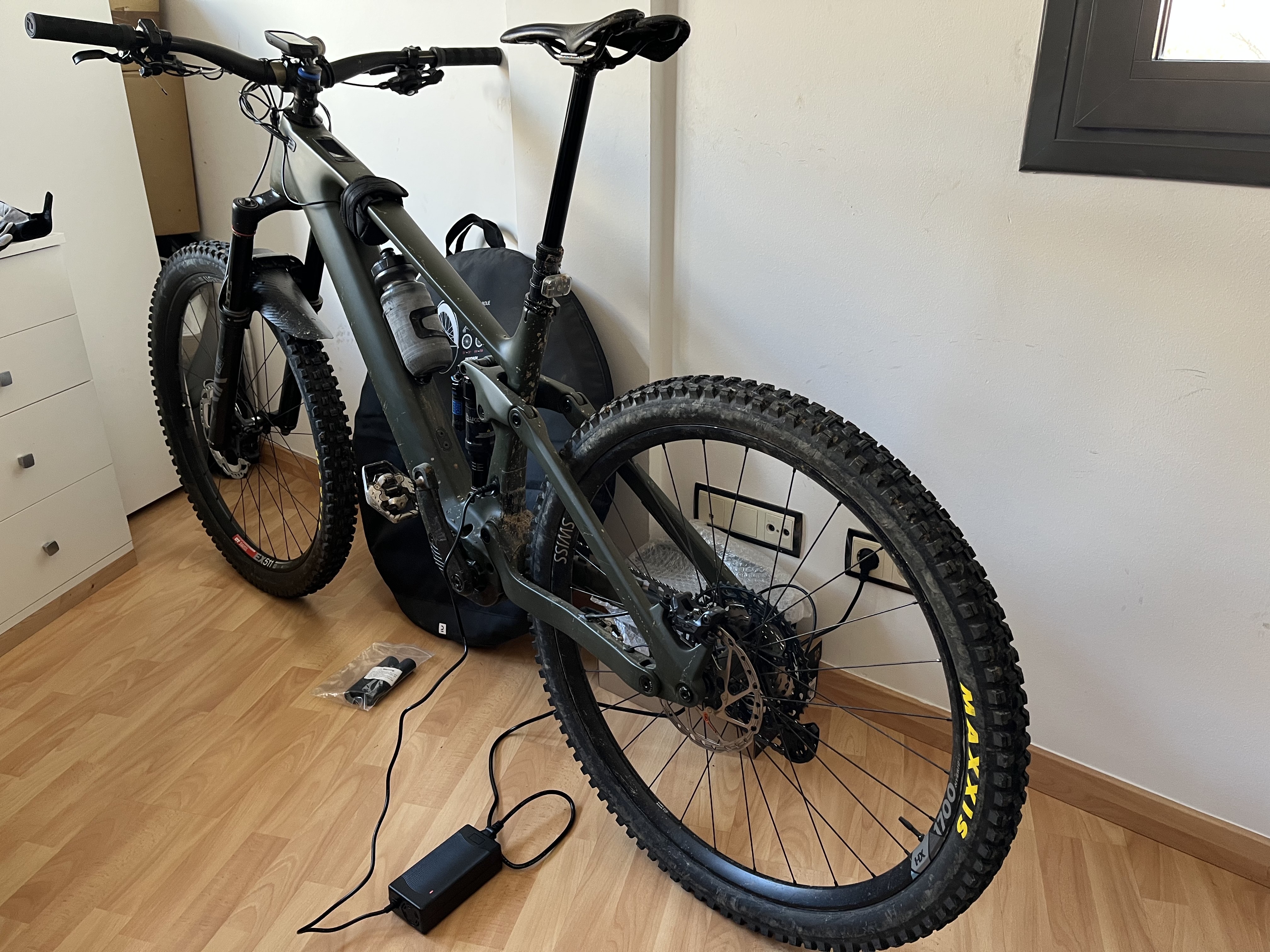

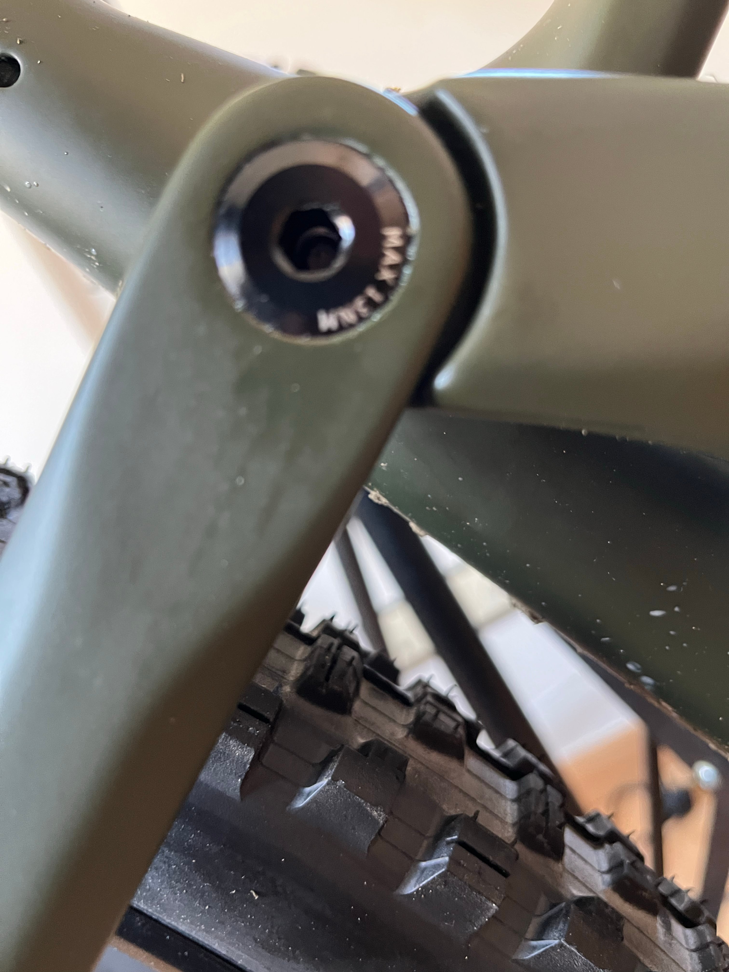

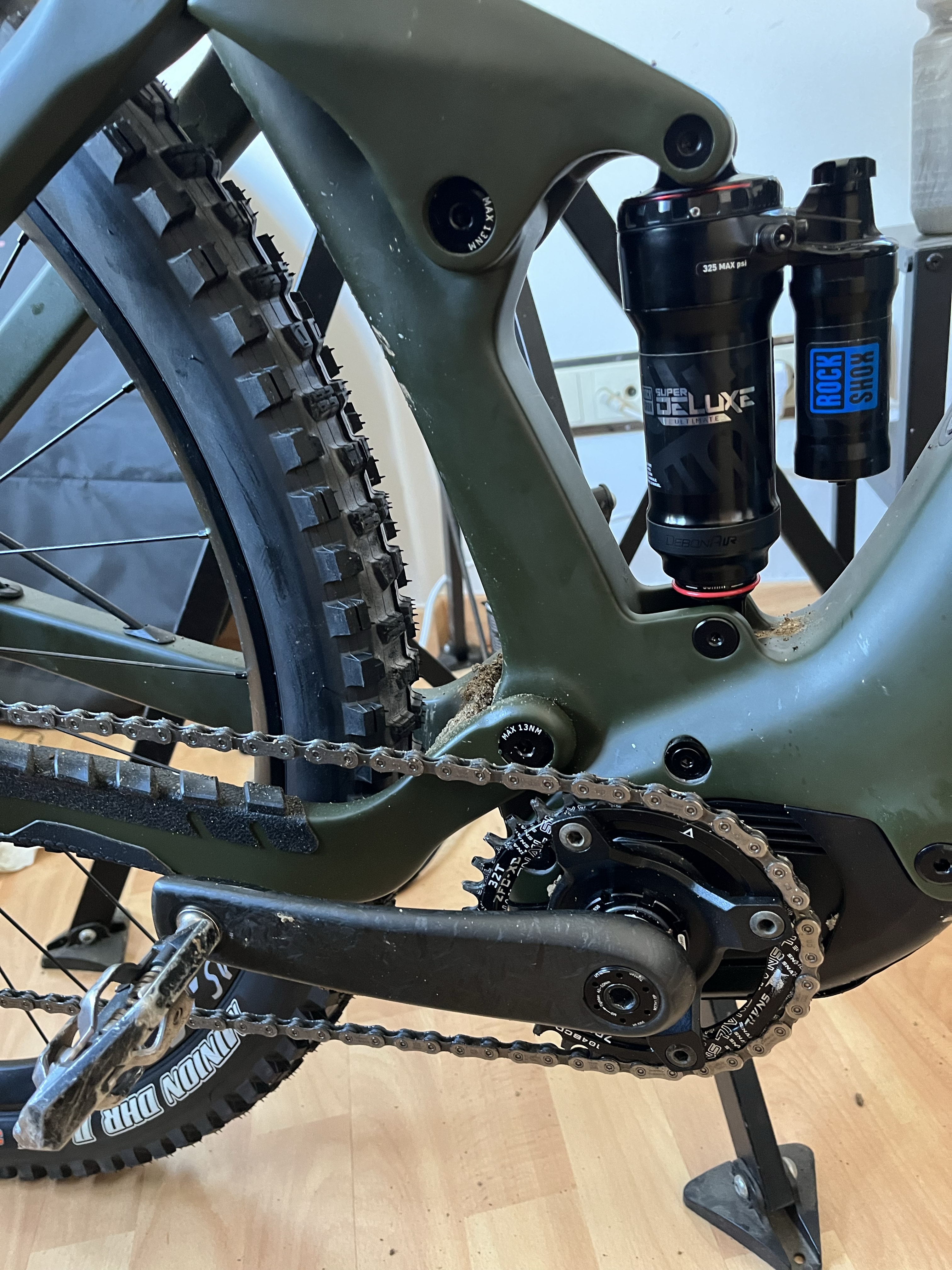

I'm really happy with the build, for some reason this CEF50 rides WAY better than my first one, I don't know if it's the subtle change in the shock position, the revised rear part or that i'm using it at 210x55 now with full 165mm of travel and 170 in front (before I was 150 rear 160 front).
I can descend as fast as on my non-electric enduro, handles everything really fine and the weight is the main thing that I had to get used to, but probably i'll be building a 400w battery so it gets on the 19k mark.
The only thing I don't love is the M820 rattle when going downhill, but you get used to
Hi, do you know what exactly is rattling in the motor? I have same motor on different frame, but I don't experience anything coming from the motor. I have serviced my motor a few times and from what I see there is nothing that should be able to move inside. I have had a lot of other things rattle though..
its the subtle movement with the cranks back and forth and I hear a small rattle. Every single cable and housing is cloth taped (rear triangle) or with proper insulative guides (front triangle). Not doing ICR so its even quiter, but there's that rattle when going downhill that comes 100% from the motor, like between engaging points between cranks/shaft
