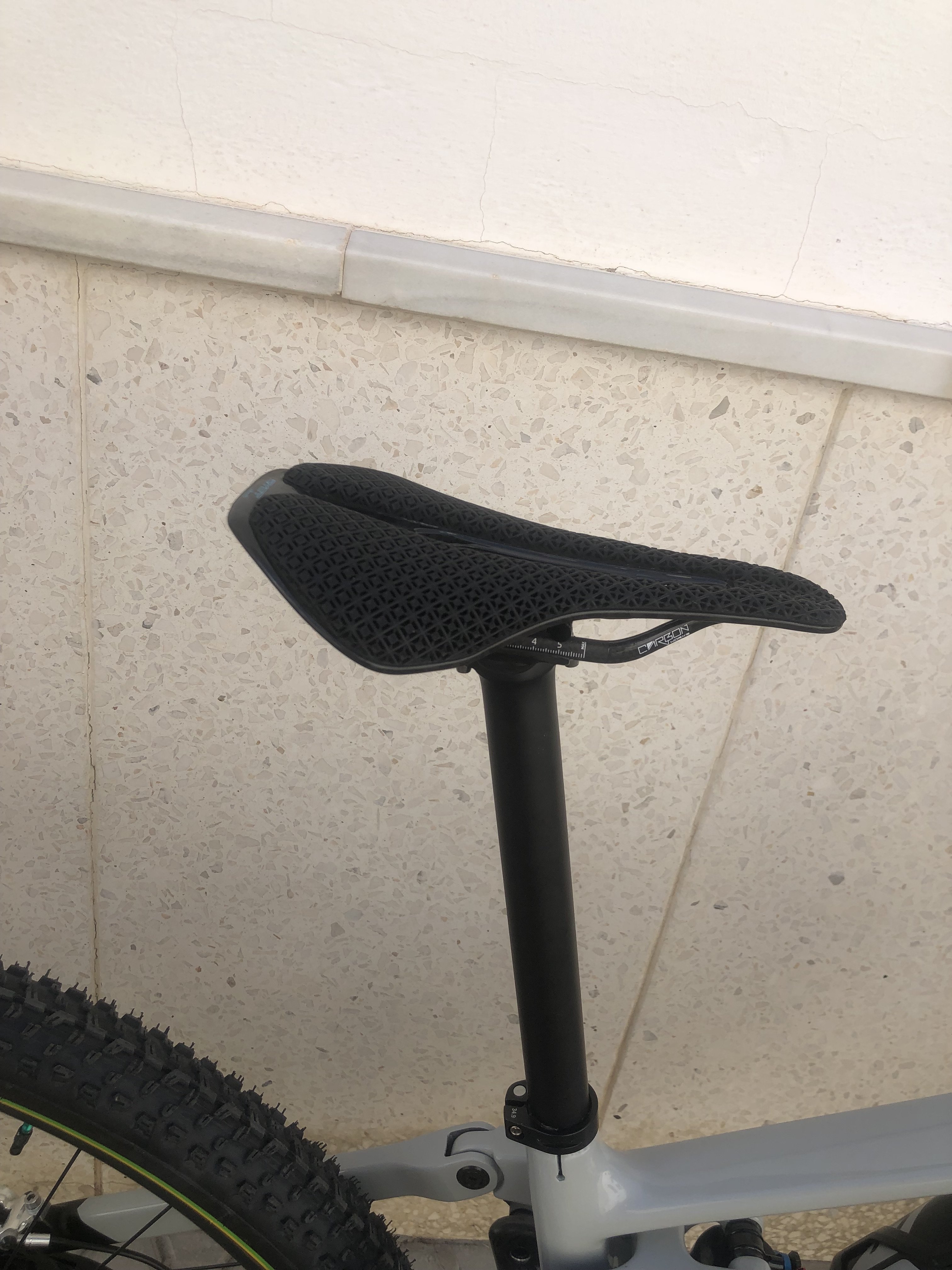

Saddle seat sometime make those noise. Try pedal up saddle. Then check your 3 motor bolt n last your linkage bolt. I think its mostly your 3 motor or saddle..
My saddle was making a strange noise but i already fixed that, thanks anyway!

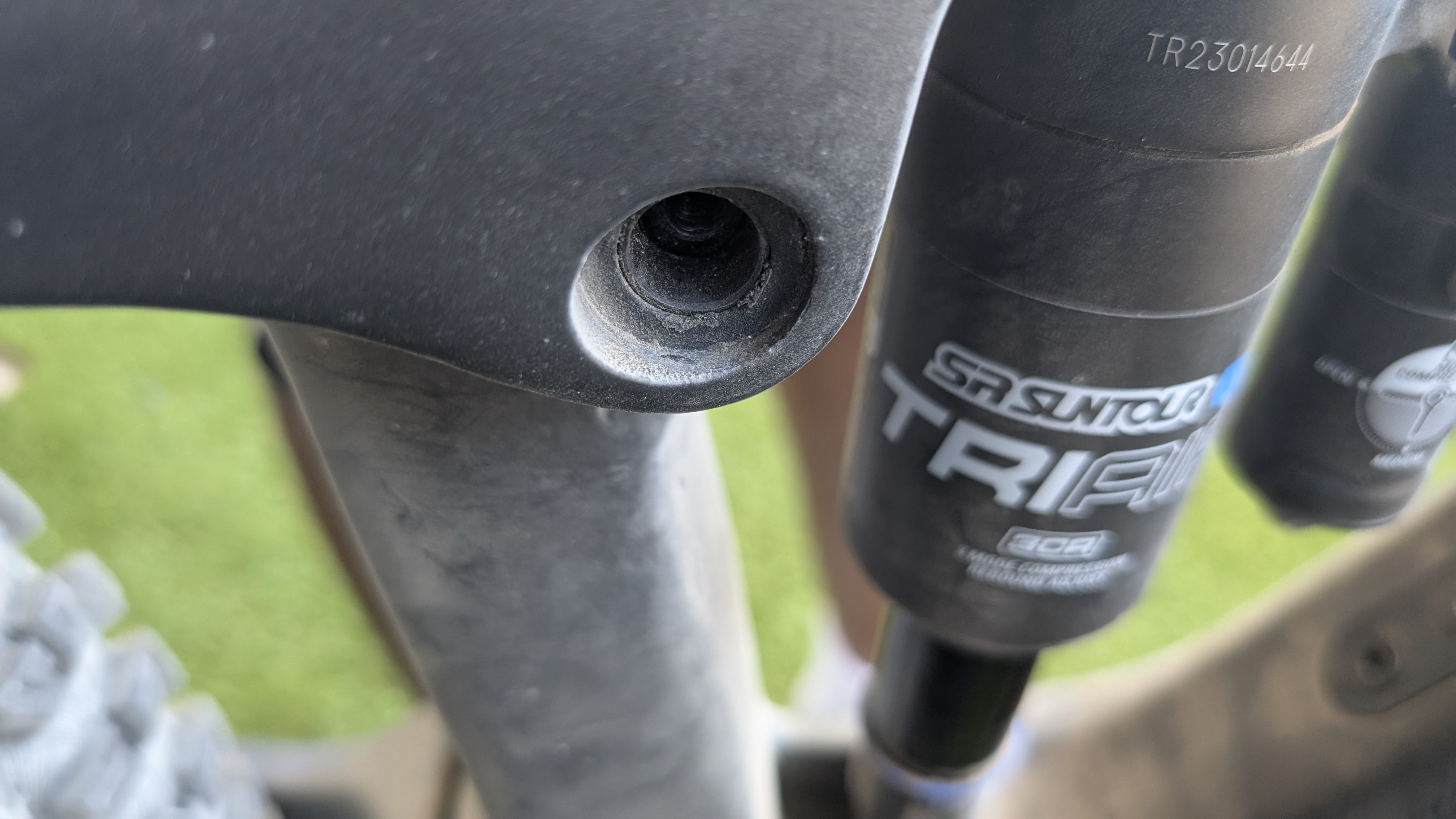

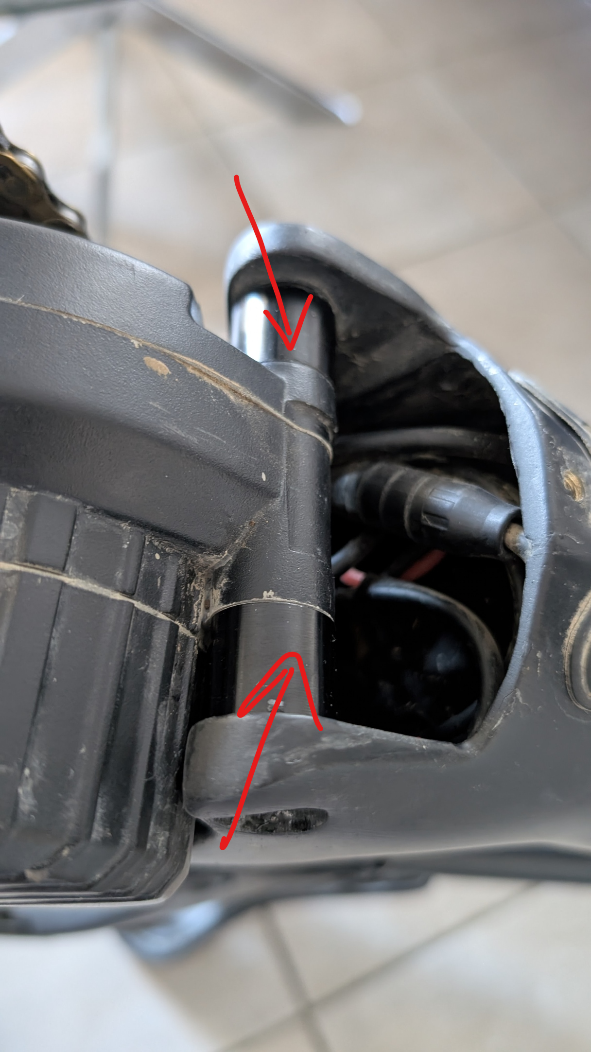

Do you have any tips on how to remove these bolts ? it used to sit flush, now i cant remove it at all, its like stuck in the frame :
Hello guys, another day, another issue :
Hi, there are three pins for the engine. First remove the 2 rear pins, then remove the one you mentioned. You will see that the whole assembly comes off in reverse.
Hello, i did, its still stuck. I removed the motor 7/8 times already for maintenance and painting, but now its totally stuck, even if i remove the other bolts
I noticed of the three motor bolts two seem to be made of aluminum and seem like standard bolts somewhat available on Aliexpress and do not have issues with the m820 housing as far as sticking or reactions. The third bolt (10x90mm) is not as easily found on AE and is made of, I think, steel and will chemically react with m820 housing causing the sticking issue.
Liberal use of antiseize seems to be the only solution. Also there may not be any reaction with the complete lack of water exposure, but good luck with that and MTBs :)

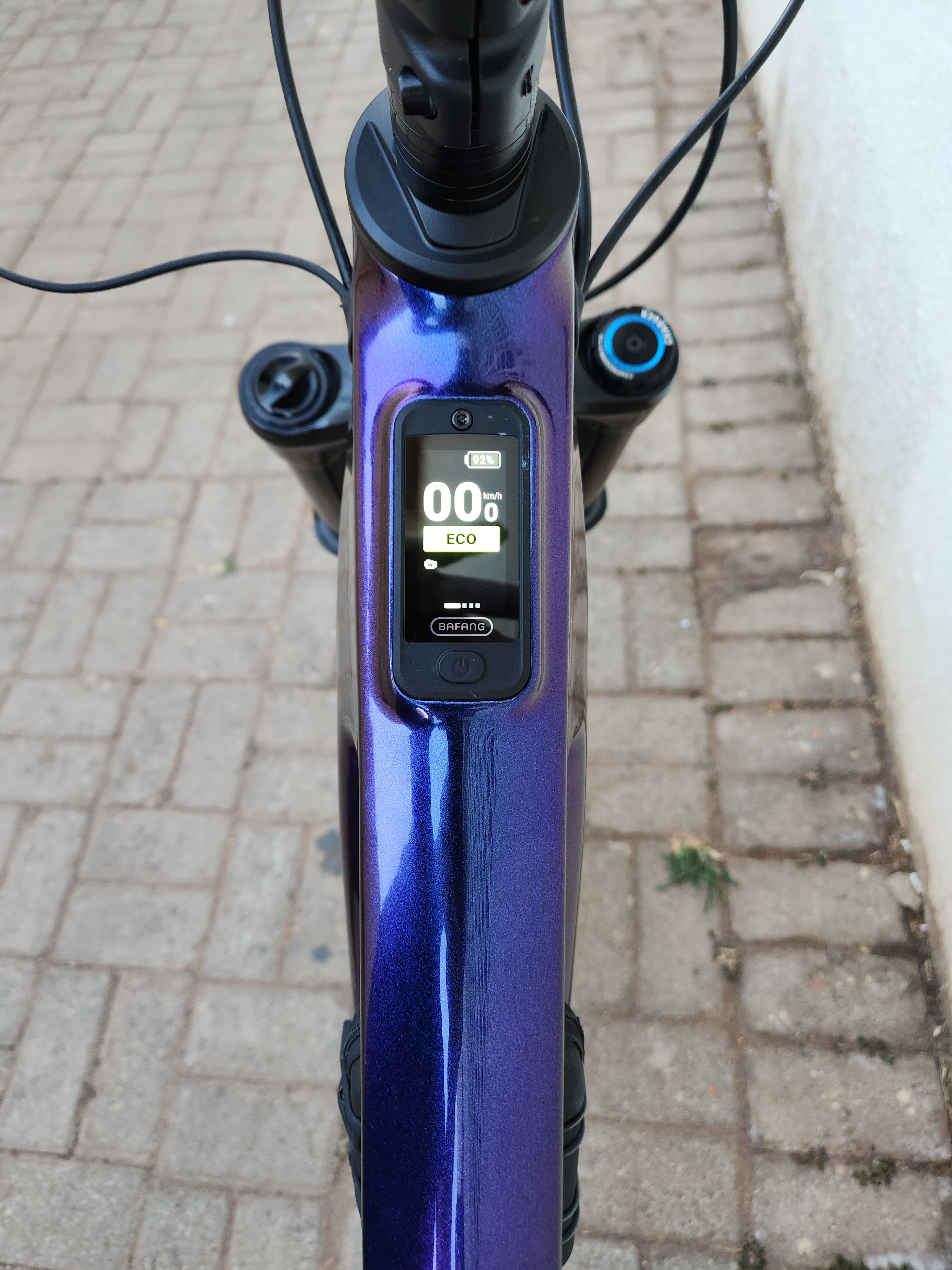

Hey, i'm back, after being one of the first owners of a CEF50 frame a couple years ago and selling it, I decided to buy one again, so probably you'll see me adding info and upgrades to the frame, this time its a CEF50-3 with the DPC030 display.
I'm waiting for the frame to arrive, Size L, Green matte color, 700wh carbon battery.
