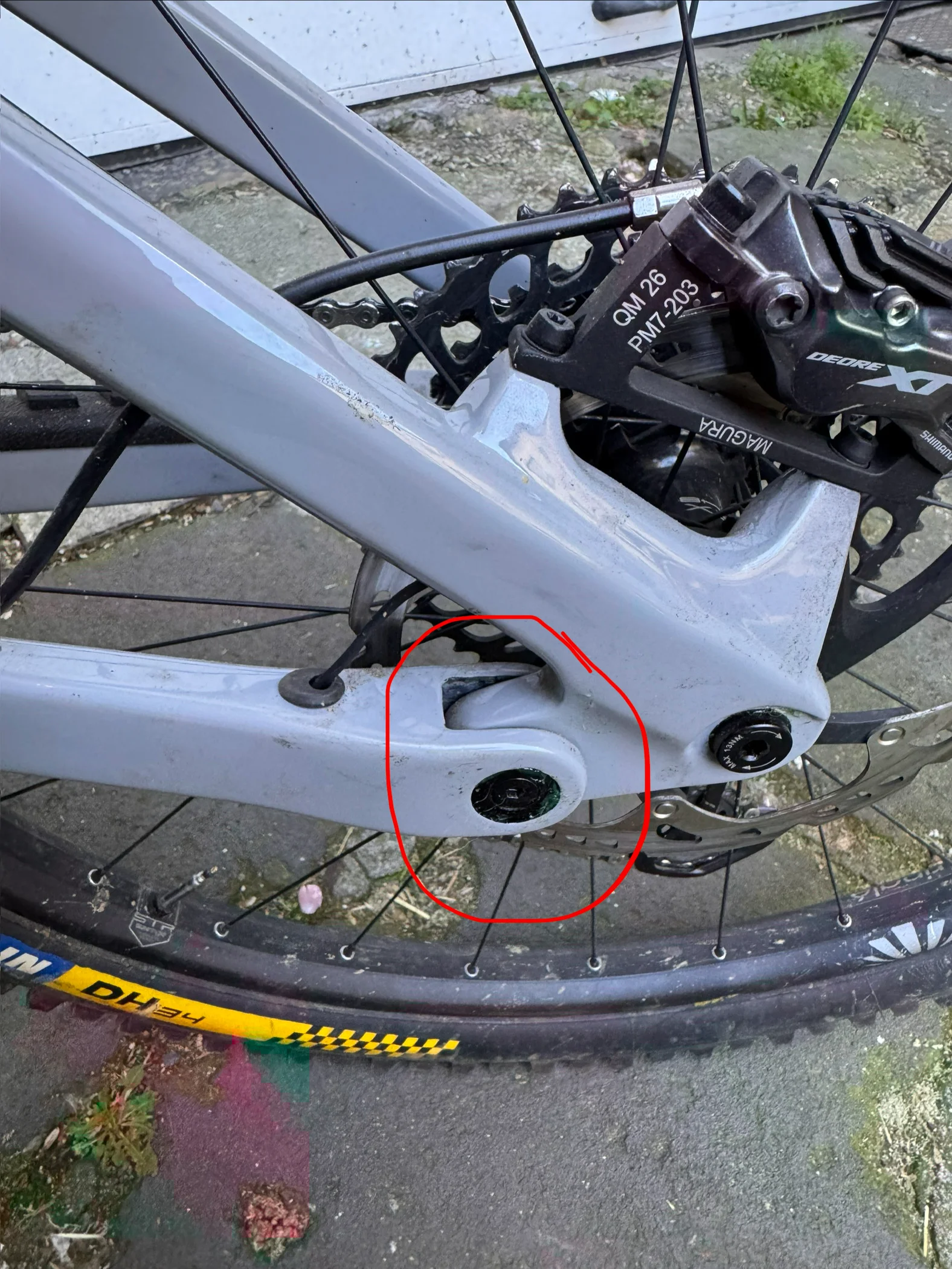

Has anyone ever experienced play in this area?
On both sides of this axle, there's a slight lateral play, as if the bolt is too long and isn't properly clamping the axle (once tightened, the bolt spins fairly freely in its housing). Just to clarify: the internal spacers are in place, the axles are greased, and the frame only has 50km on it...
Thanks in advance for your help!
could be worned out bearings ? dont know szzs but dengfu put some horrible bearings from factory

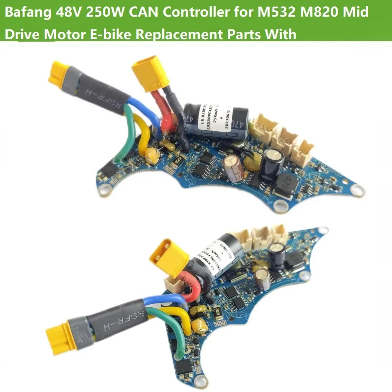

Just wanted to document for others that one of our m820's failed. Clunk, then display went dark and would not start again. Battery is good and display ok. About 2000 miles on motor. Probably the motor controller but could NOT buy spare part from any source including Bafang a motor controller for repair. Had to buy new motor. Not happy about that.
Yeah it’s the same motor, only the battery is different.
People have ran all software on all said motors and all ok.
No difference in motor hardware
Not according to Bafang. Don't really care what "people" have run.
I never done on the M820 (i use only 48V), but on M500, M600, M510, etc... Since the begining (like the BBS before) it's exactely the same harware and only the software make differency following battery power supply. Fortunately, i heard experincy of bafang customers to maintain my motors. You are high level VIP if you can have direct bafang support :eek :

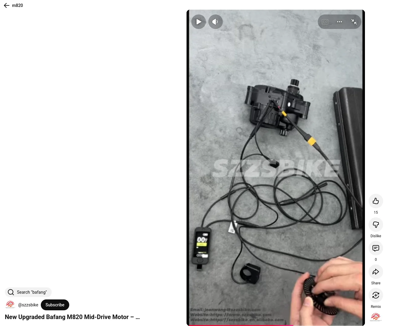

I just wrote Bafang looking for the part and they said it was not available. I had my retail sources also check and they confirmed that Bafang does not have any and that the 48v is not the same. It does not make sense that the motors would be the same. You can apply any voltage you want but each motor has a characteristic Kv the rpm per volt. So trying to run a motor at a voltage that it is not designed for is not going to be efficient.

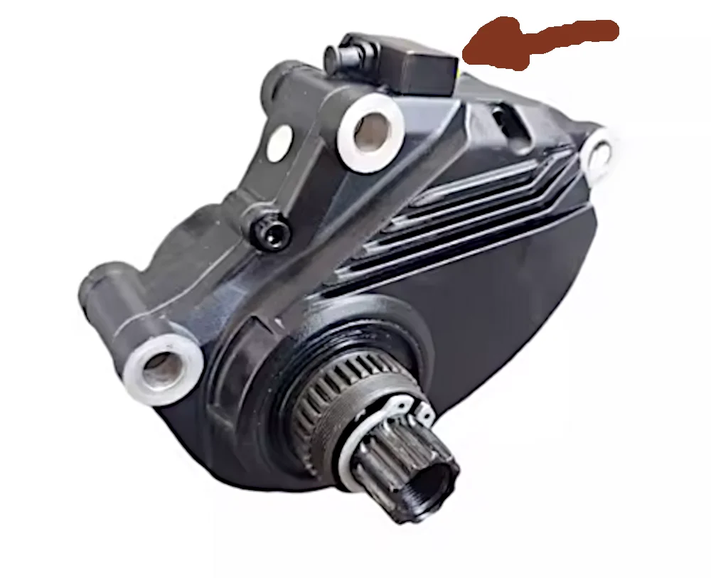

Also there is an old M820 and a new M820, The new M820 has different connectors.

"This controller is suitable for M820 G532 motor. It has 36V 43V 48V specifications, please choose according to your motor model when purchasing."
"M820 motor has new and old models, currently on sale is a new controller, please pay attention to whether the controller plug is the same as the controller interface of your motor."
You can't see it from the outside.
Actually from these photos from SZZS if looks like the new version has the cables coming out in the top of the motor vertically when the old motor they came out of a little box and went sideways.

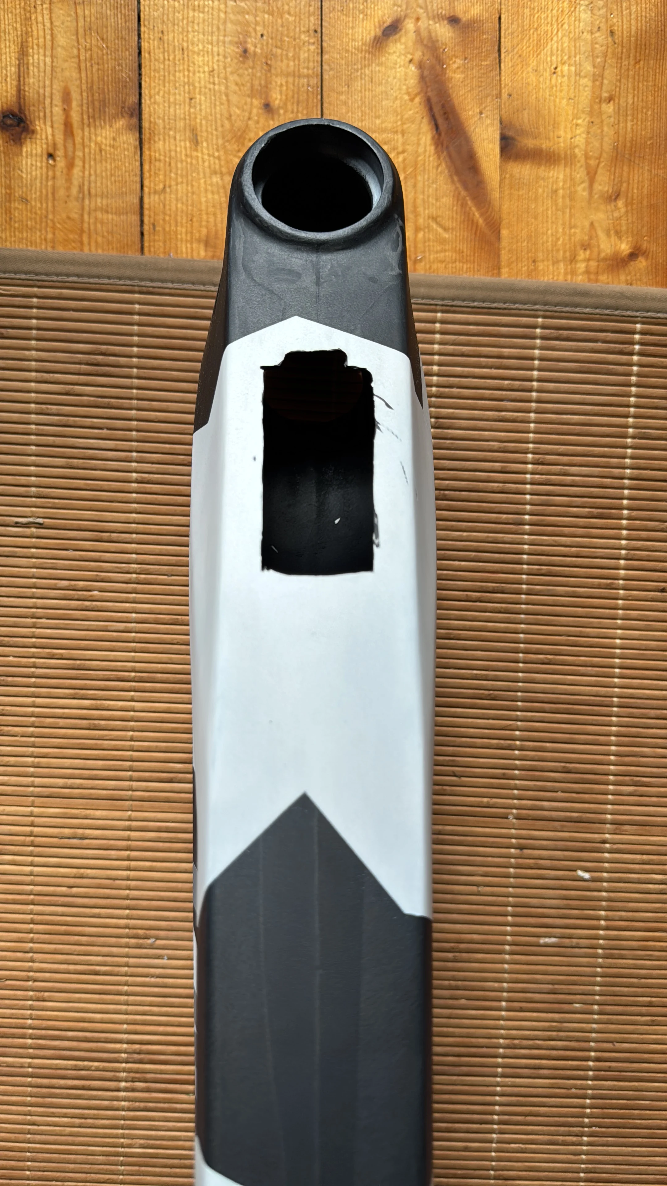

Would be curious to see how to retrofit this in for the clever peeps out there?

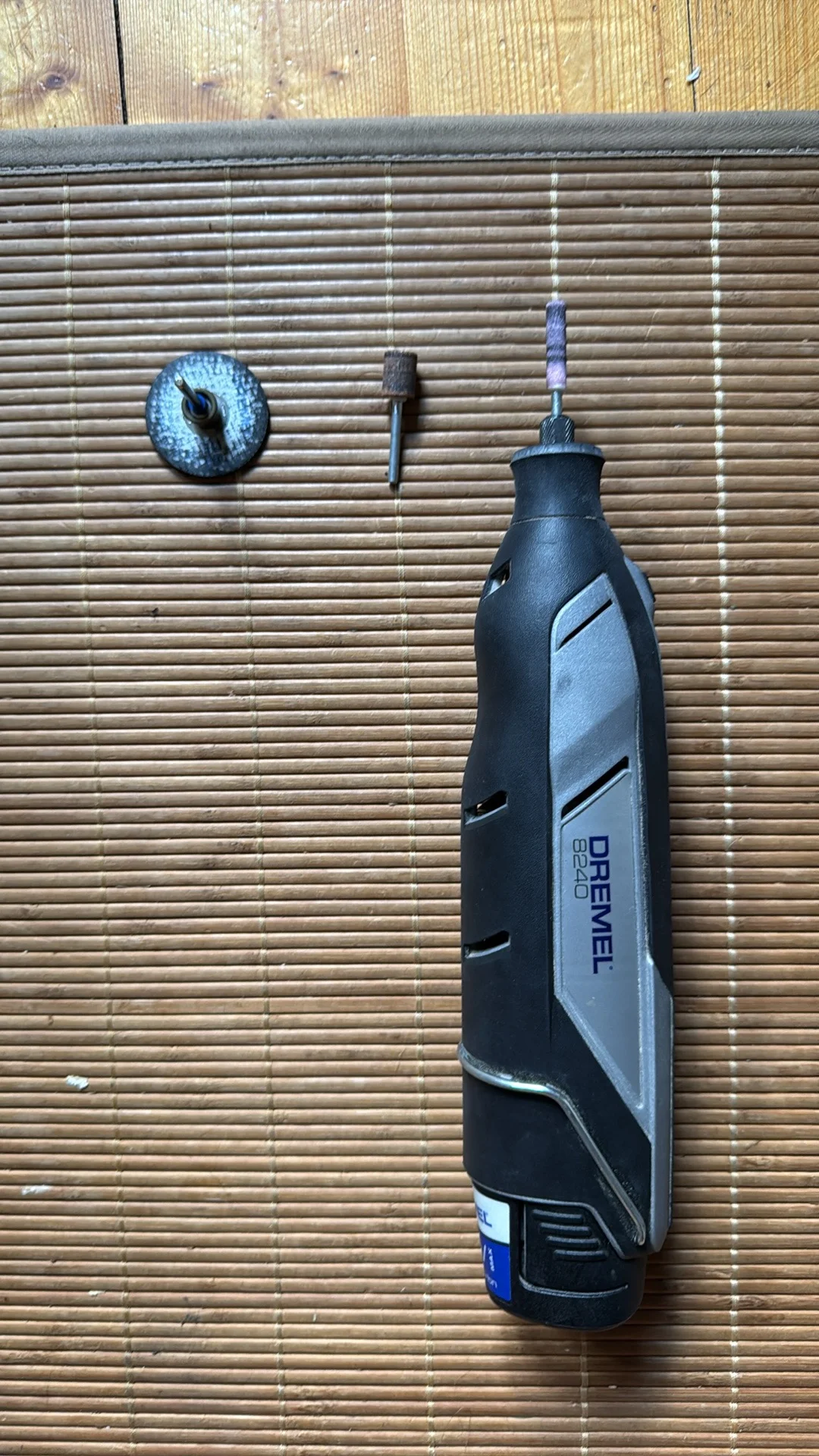

This is how you can retrofit a DPC.030 on any frame. This is a Dengfu E10 fatbike. Just drill a hole 1-2 mm smaller than the outside edge. Then a drop of glue in around the top notch. I’ve done now 2000 km’s and no issues. Frame works perfectly and the screen hasn’t budged.
View attachment 186116View attachment 186114View attachment 186115
personally i prefer doing only 2 little holes to install nut inserts and build an 3D support. less aesthetically pleasing, But less risk of frame fail where i ride
I understand your point. I dared to make the cut because that’s pretty much the area where the frame gets the least of torsional forces. The upper tube is just getting pushed from both ends unlike the down tube.
