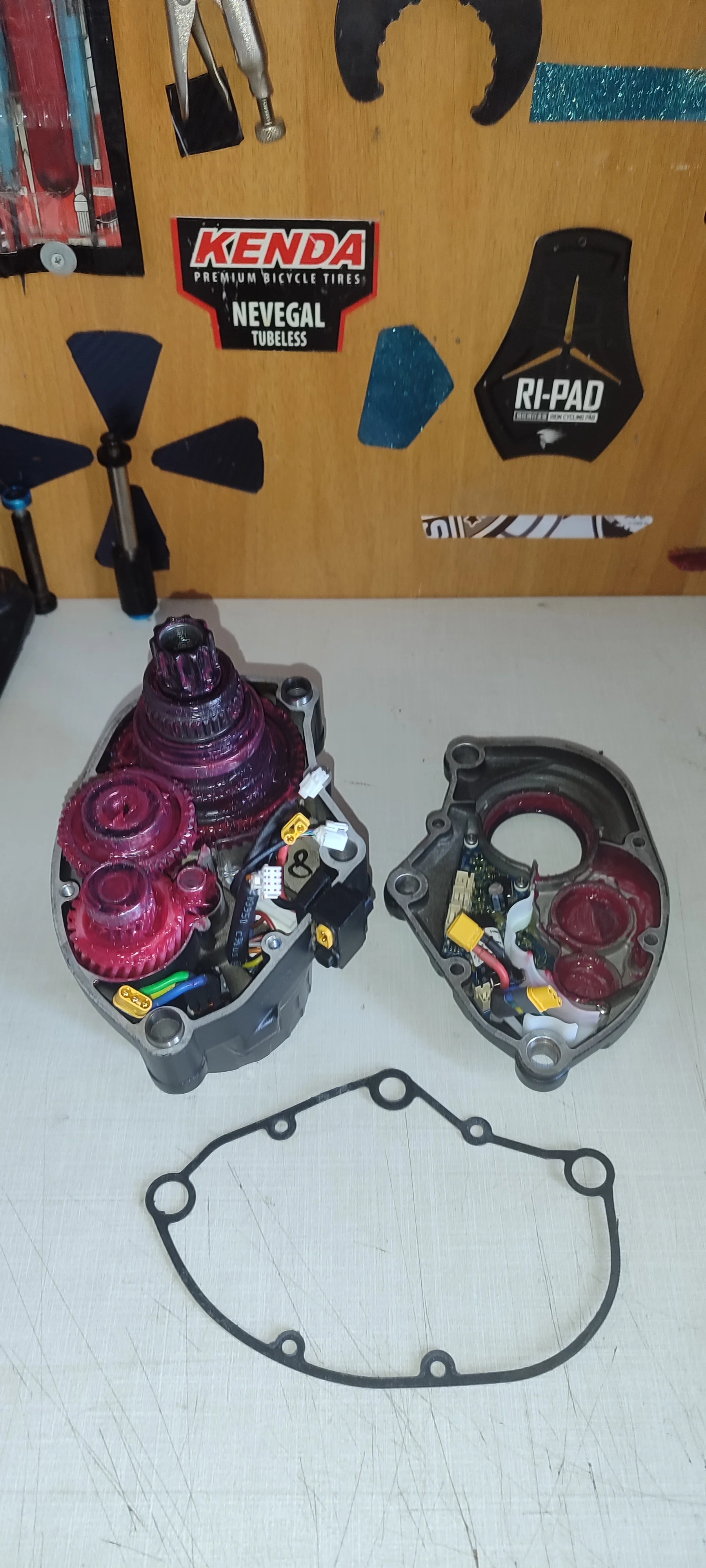

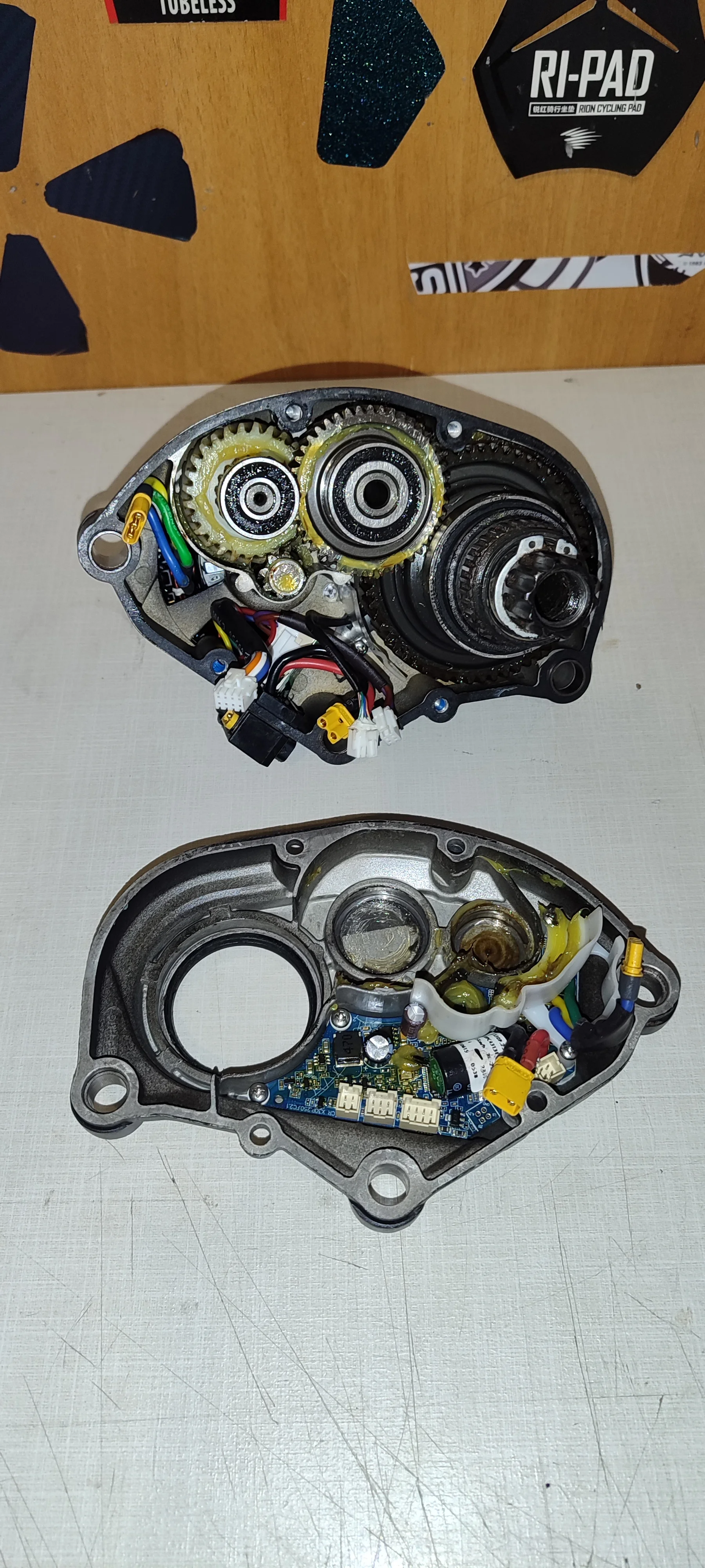

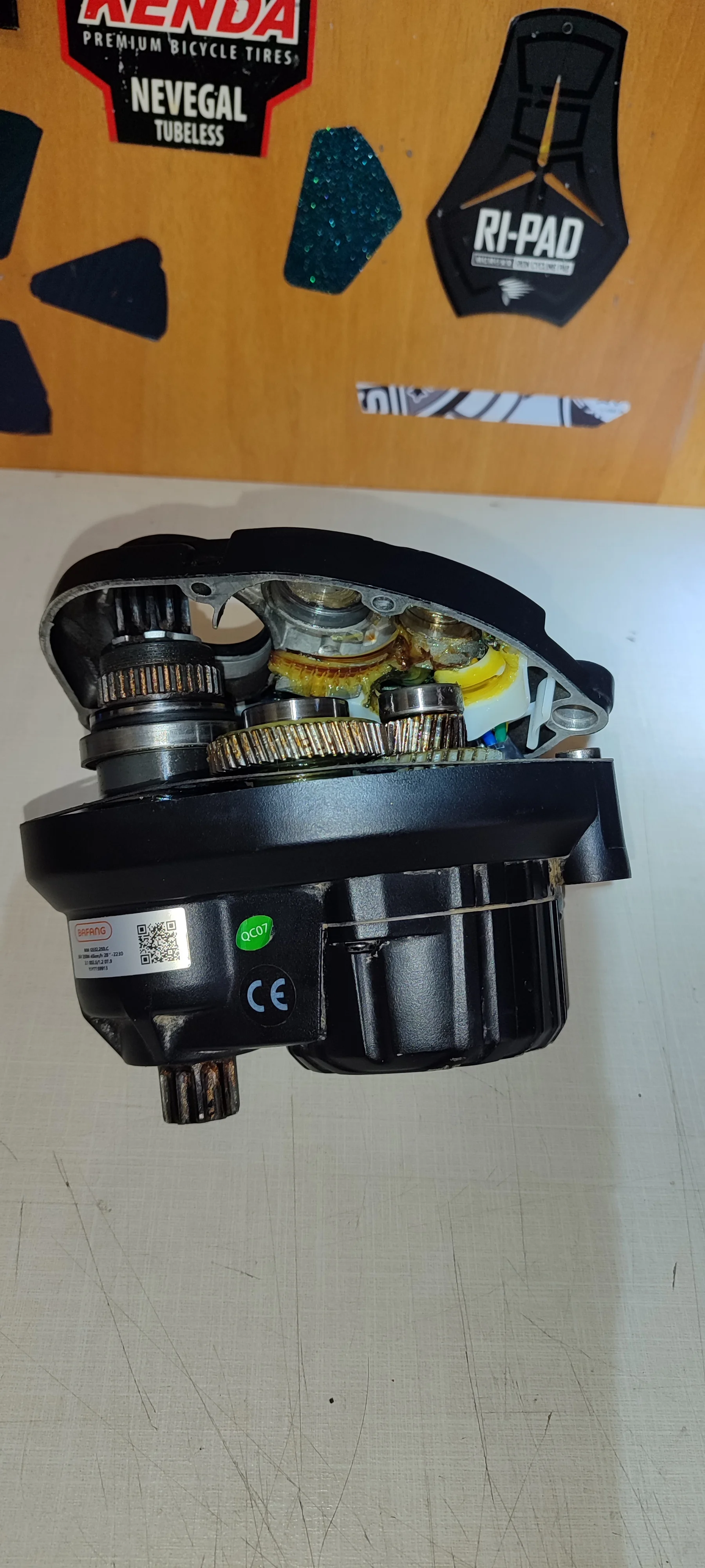

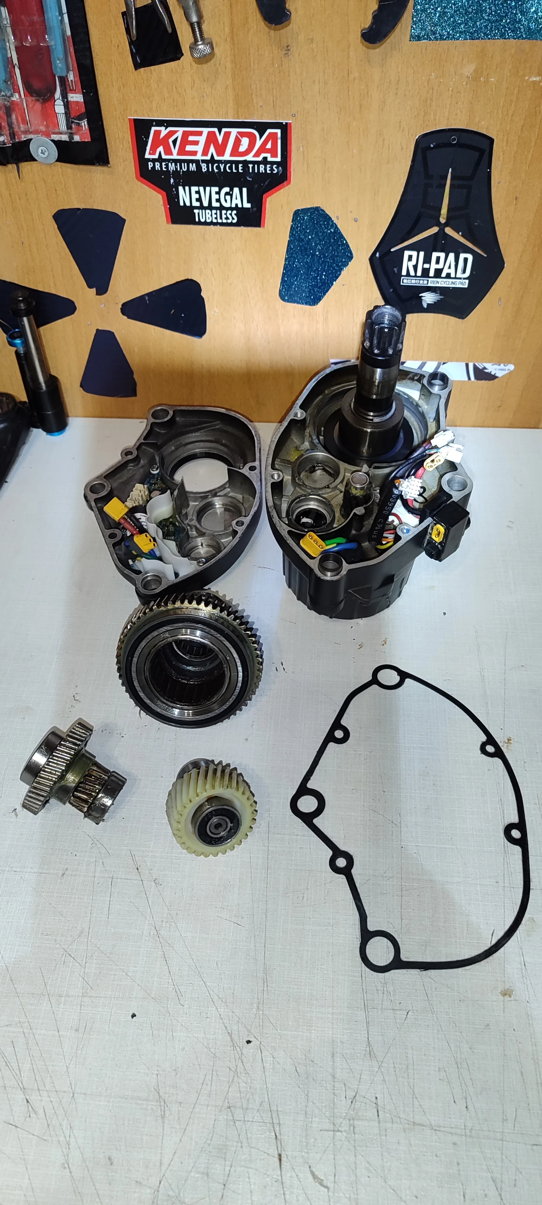

Hi guys, I disassembled and greased the Bafang M820 motor. I reassembled the motor and it gives me error 21. Before disassembling it, everything was fine. I have a doubt. Since I disconnected the controller wires, I was wondering if I need to calibrate it.
Has anyone already done this job and encountered this problem?
Error 21 means engine is not receiving speed sensor signal. Check speed sensor cable connection, verify you connected the cable from sensor port to engine mainboard securely.
Or that you might have tugged on the speed sensor cable and rotated it so it now does not align with the magnet.
I solved it, it was a bent pin, I assembled everything and tried it, now it works without any errors, here are some photos of the engine before and after the work.
the engine had 5,800 km done in 13 months I noticed the maintenance light on the display and I proceeded with the inspection the plastic gears were perfect as well as the metal ones do it yourself always pays off at any time you disassemble and repair this thanks to the online community that posted how to do it.🤟

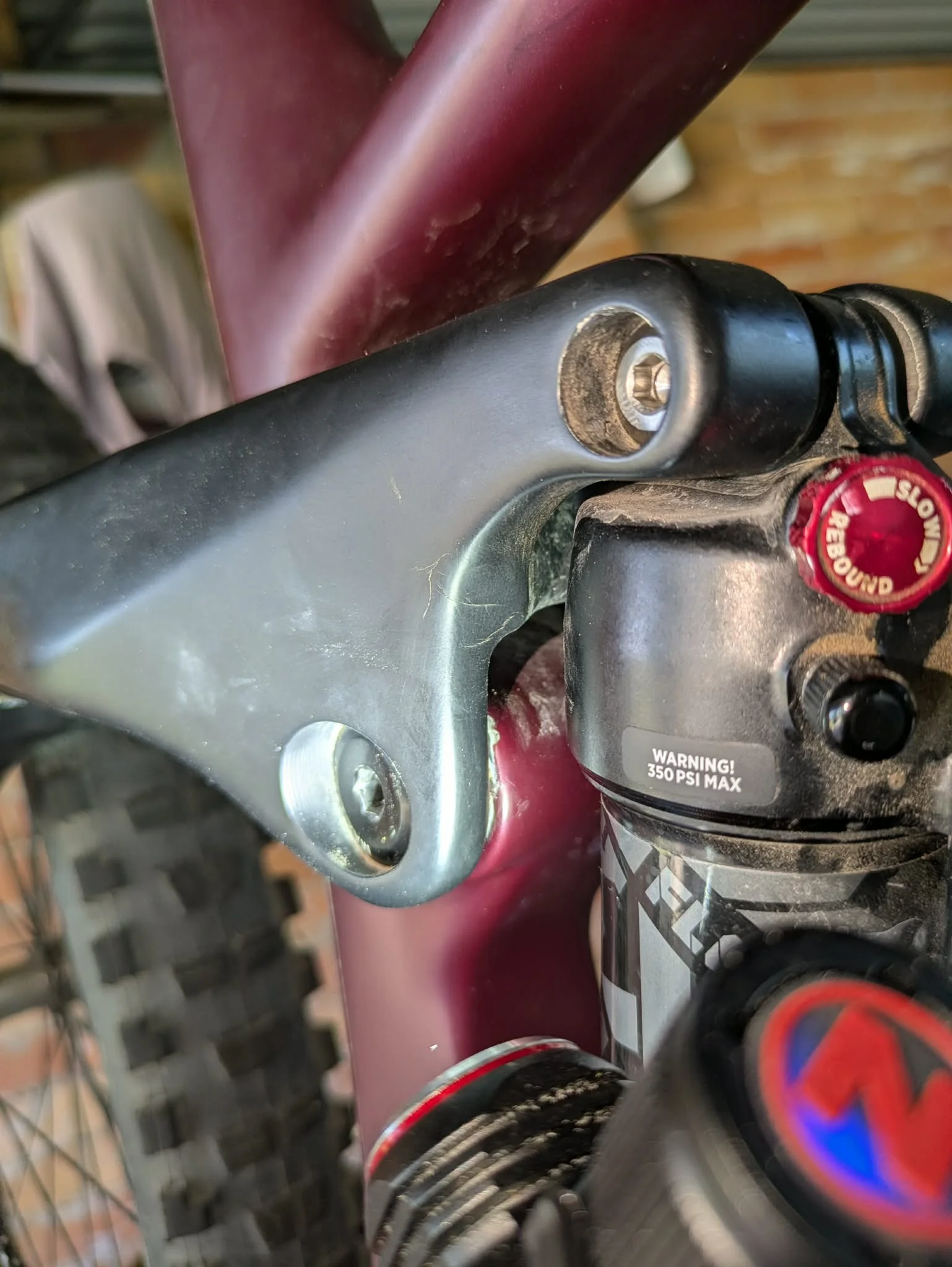

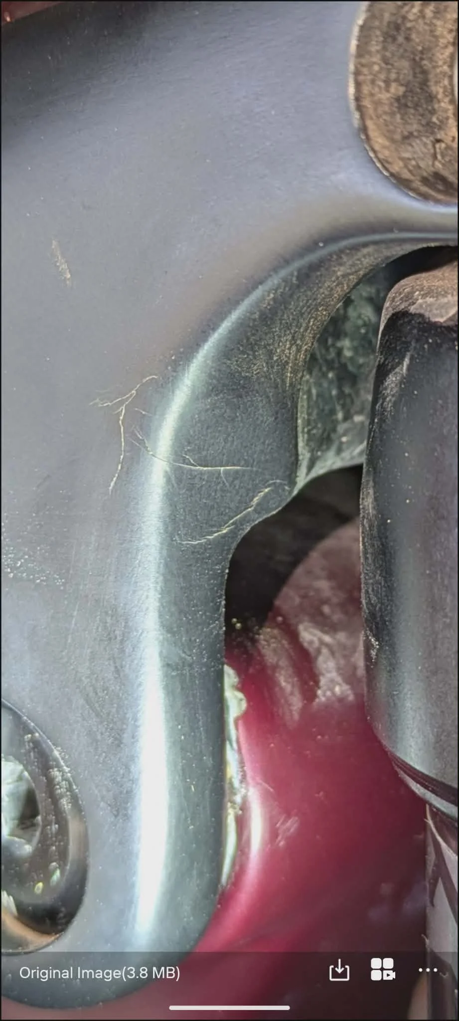

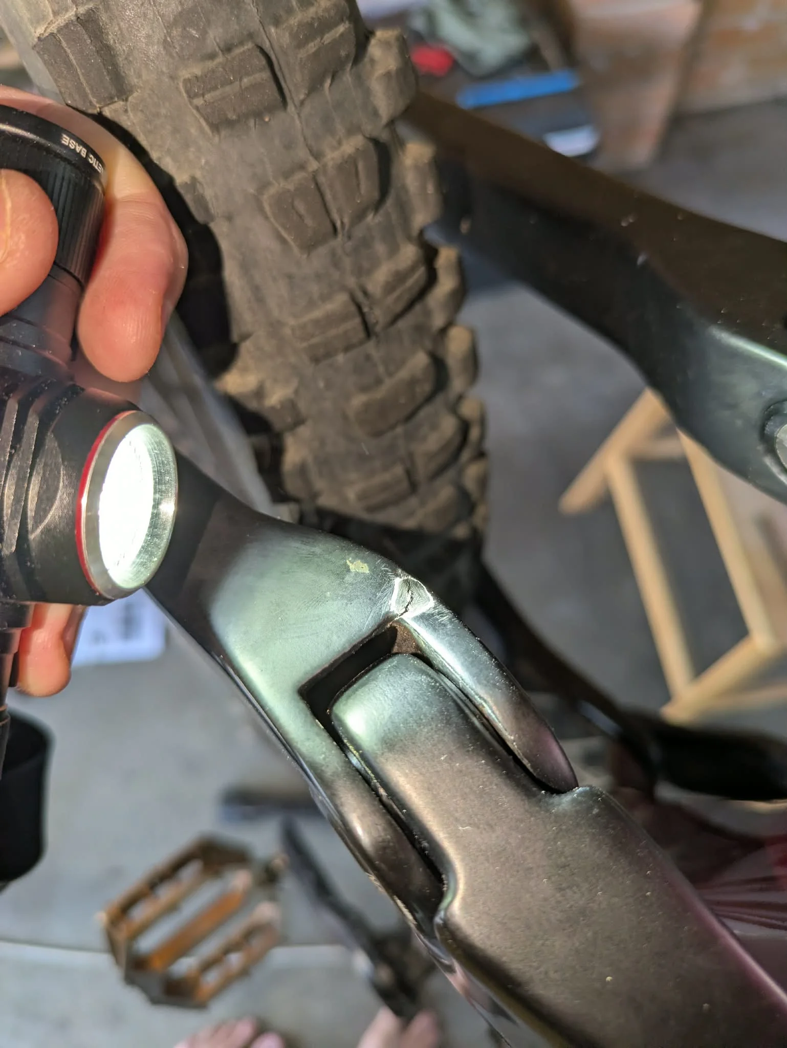

Sad day for me and my CEF50, noticed some cracks in the rear triangle and linkage. I thought it may have just been a crack in the paint, so I lightly sanded it to get a better look. Hope no one else has the same issue. I believe my frame is still under warranty, so hopefully SZZS can work out a solution.
