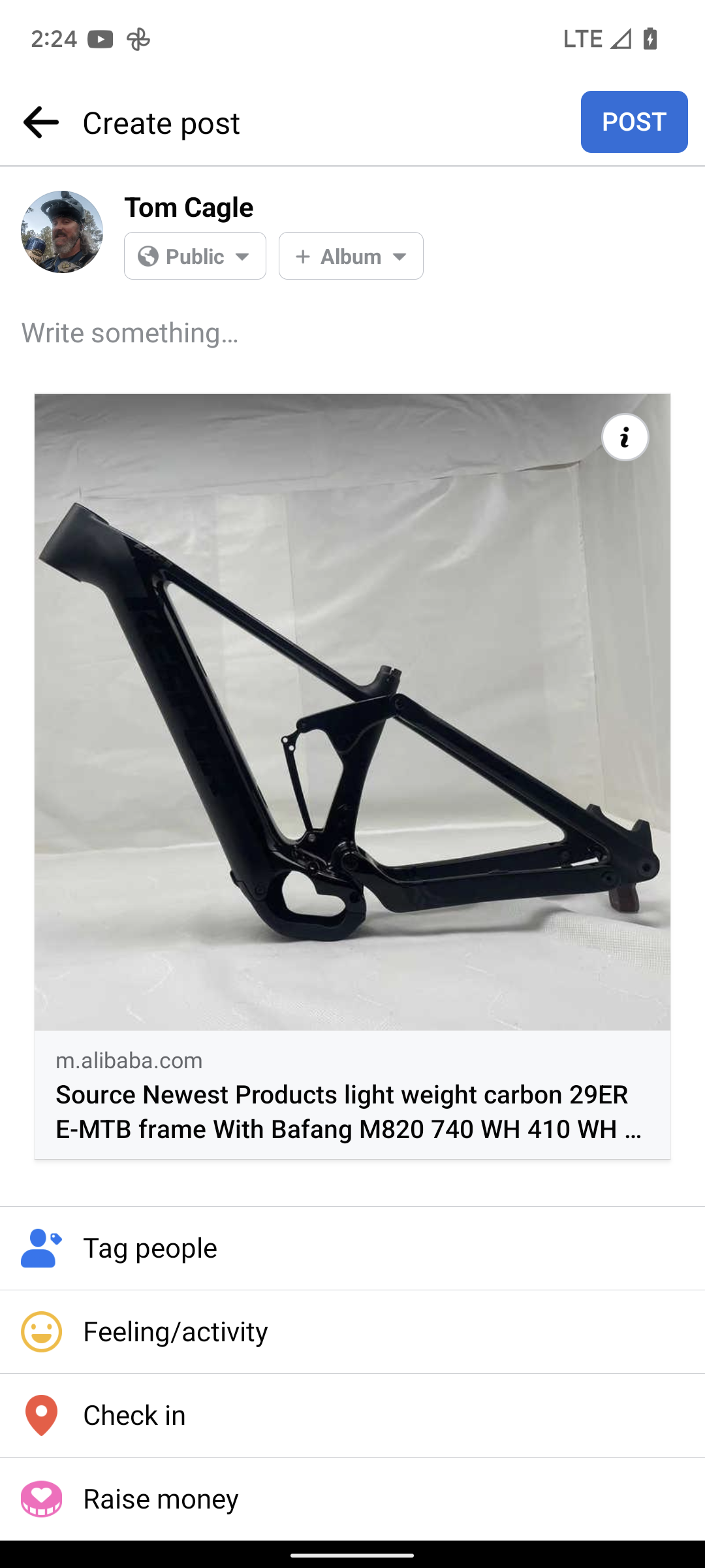

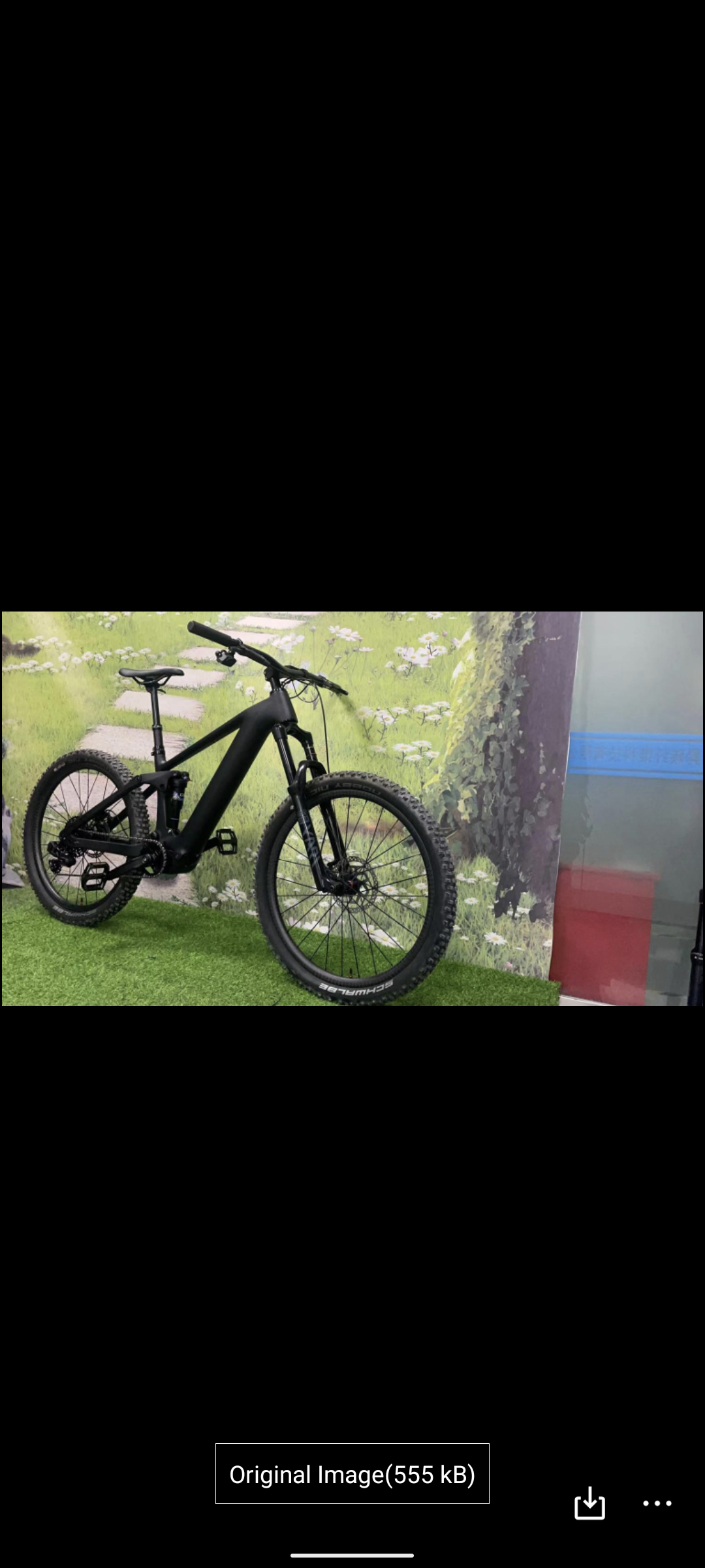

See the M820 motor discussion for preliminary details...just making a specific CEF50 frame owners topic.
Total cost with shipping for me was $1750 US. Production starts this February. So, I put down a $500 deposit for a L-size hoping I don't get burned. 💸😁🍻

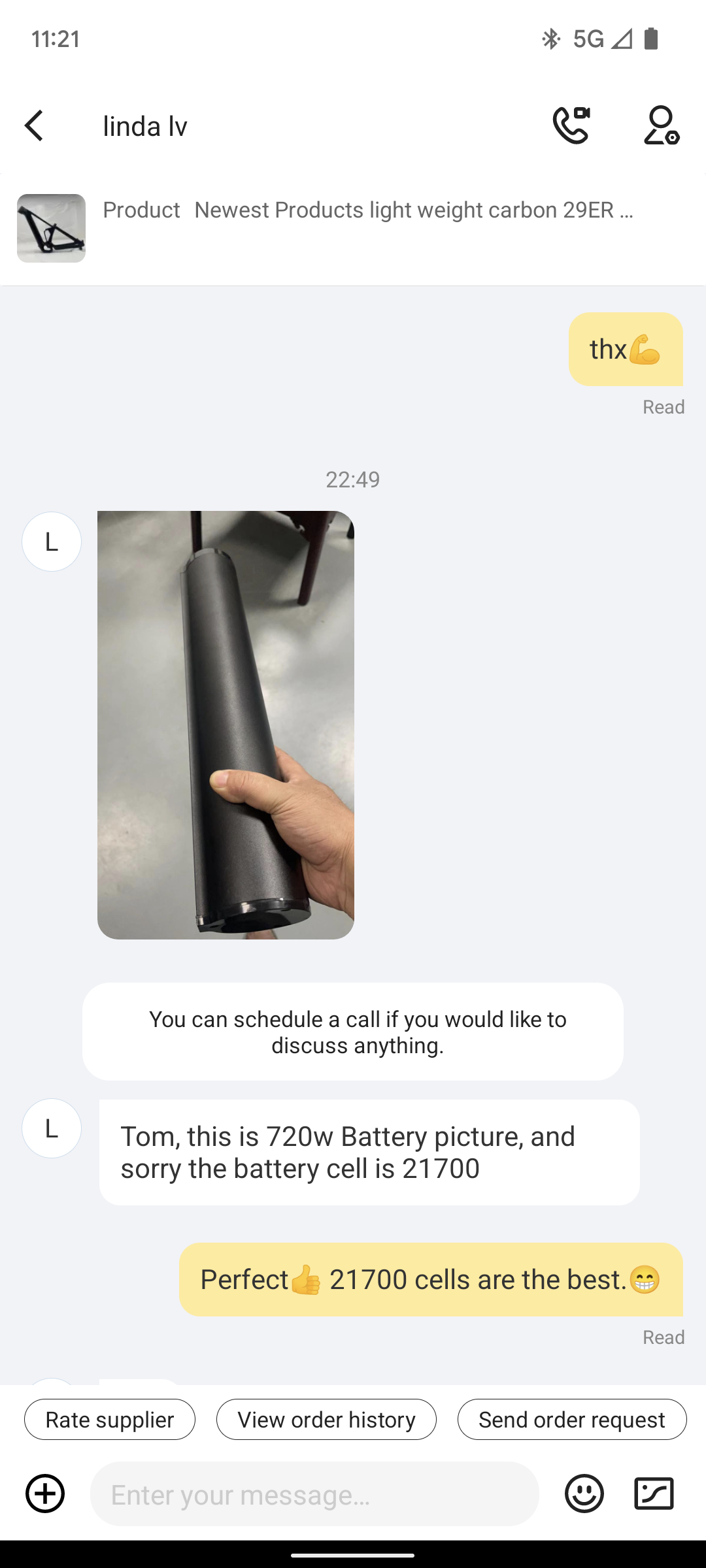

Here's the 720Wh in-house, bigger battery option. The smaller is the 410 Wh Bafang battery. Both are integrated (motor dismount required) in order to save weight on the frame cutout, cradle hardware, and key latch system. Purportedly, this strategy can save 2-3 lbs off the total build. We'll see! 💪🤞
No range extender is planned. So, I opted for the bigger one knowing the 75Nm/95Nm peak motor power will inherently consume more battery range. Plus, I'm a heavy Clyde-rider.

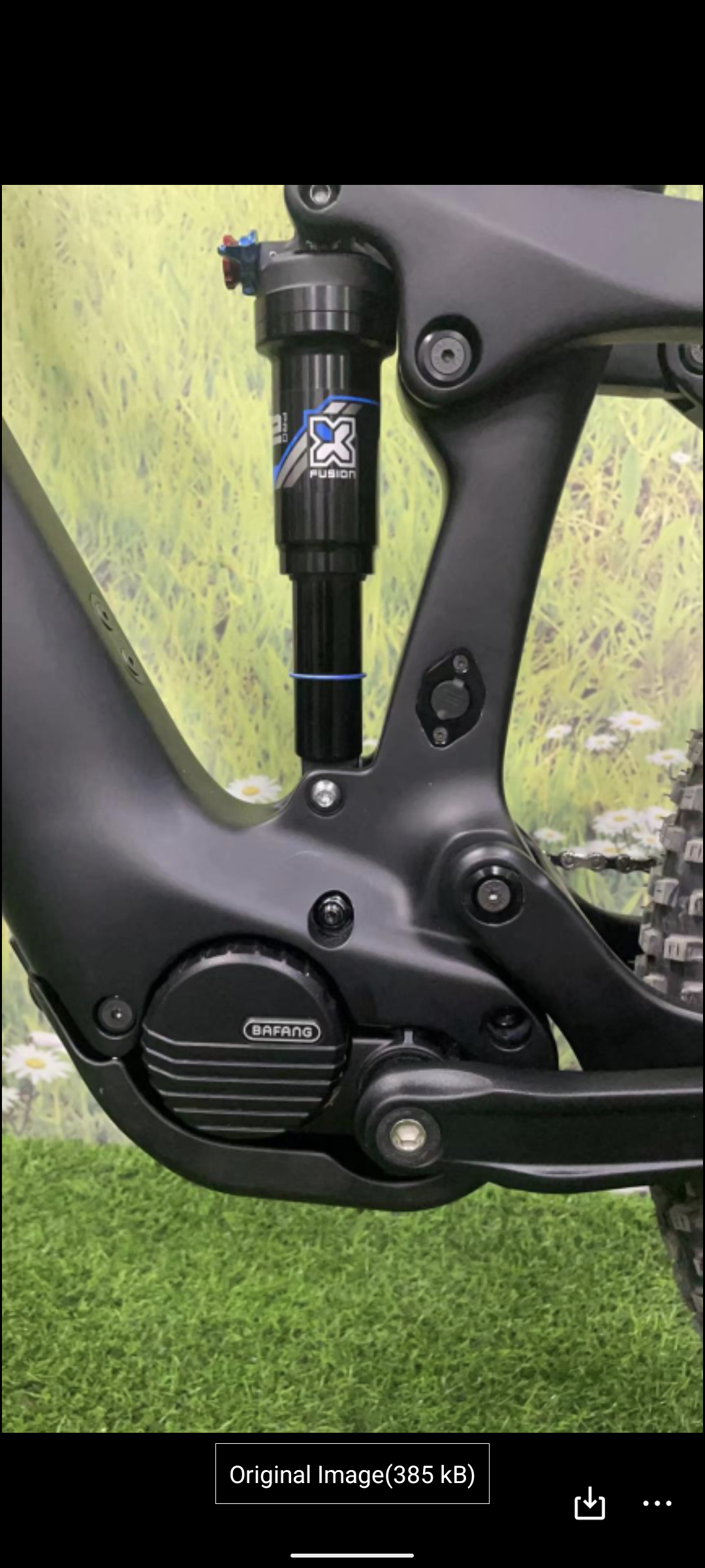

Great plan, and I think You will not be disappointed. May be You can overstroke (210x55 / 216 x 63 shock?) the frame a litte to get more travel and better matching Your 180mm ZEB.

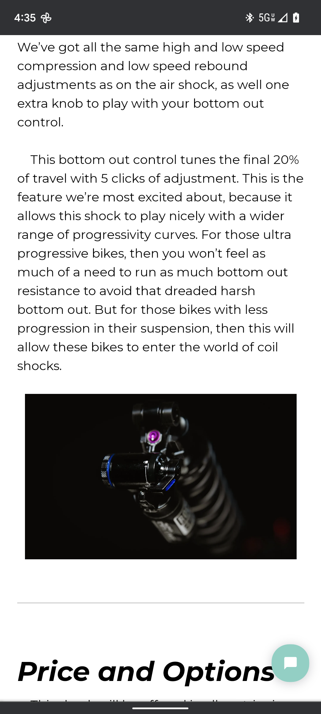

Yeah, I thought about the 216x63.5 RS coil, but I went with 210x55 to "overstroke" the rear within the manufacturer's eye-to-eye spec...I was afraid to truly size up for fear of the full carbon swingarm and my heavier weight. The kinematics may get me closer to 160mm. It should be more than 155 mm and much more than the 150 mm spec.🤞
Plus, the RS 210 x 55 coil was on sale for $300 USD....$200 off my limited, overall suspension budget for the '22 model...so bonus savings!😄💸
I also wanted the newer RS coil upgrades, especially the purple button bottom-out adjustor. But I'm playing it safe. However, if others go for the bigger coil successfully, I'd definitely spend the extra money on those upgrades and bigger stroke later on!🤙

Be careful, the additional 5mm stroke will give You 10-15 mm more travel depending on end of stroke ratio / progression. Good that there is no bridge between the seatstays, but worst case the tire may hit the seattube. Did You consider a mullet setup with 27.5 rear wheel to be on the safe side?

Exactly, I was hoping the leverage curve might be similar to my LCES04, I think 2:1 ratio. So, I guesstimate 7-10 mm increase, 10-15 would be nicer! 🤞
It looks like this linkage will allow the back tire clear the seat tube with room to spare. Also, the other issue were seat stays becoming more vulnerable to breaking if I attempted to overstroke out of eye-to-eye spec at 210 mm to 216 mm due to creating a higher pivot point, especially carbon, with heavier riders.🤞
But, I'll ask the salesperson soon to see if their engineers will produce a chart for public consumption to better predict travel and see how progressive the frame kinematics can be.
On mixed wheelsize: I myself prefer the mullet with a longer chainstay.(450 mm). But I decided to keep with my 27.5er+ carbon wheelset to save on the cost on the front 29er. So cost limitations.
Also, I bought the 180mm (v. 170mm spec) 27.5er fork because I knew it would give a higher BB height to compensate for the slight lower 27.5 plus tire height at 28.75". Rake was still 44.4 deg offset for longer travel. Bonus, was the new 3.0 charger damper and buttercup rebound adjustments found in the Zeb Ultimate going forward. And the cost reduction was nice at $700 USD instead of $1150 for '22 model.
Together the Zeb '22 with RS ultimate coil '22, I was able to spend $1000 USD! 💸💪 So, finances guided my travel and wheelsizing.😁💰

Sounds like a plan mate! I missed the info that You plan to run both wheels 27.5 somehow, but I think with the frame designed for 29 rear wheel there will be no issues with 27.5 and increased 55 stroke.
💯 Esp. the taller 27.5 plus are 28.74", so close to standard 29" wheels on bigger 180 mm fork should yield similar angle to the front end to the spec 29/170 mm fork. Get a little more plushness on the front end with 10 mm.😁

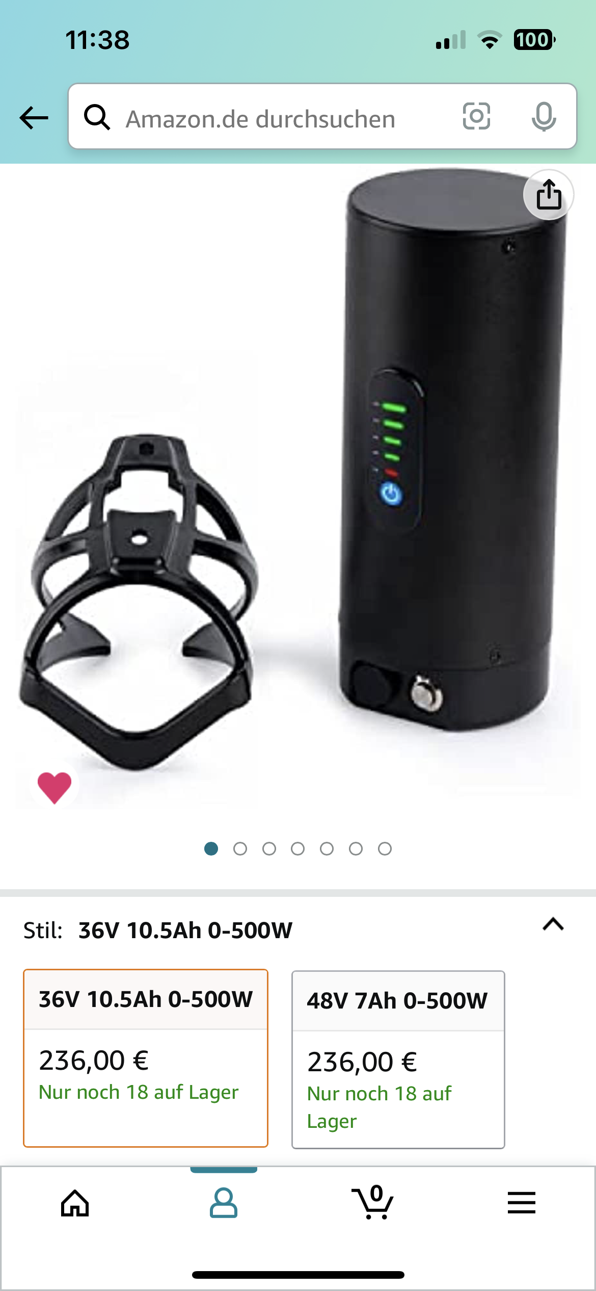

It's a bad idea to make a non-removable battery. Then you will add a range Extender that weighs another 2000 g. It is better to install a removable battery bottle and you will have two spare batteries. Aliexpress has a very large selection of battery bottles.

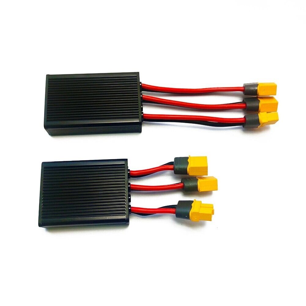

Would be very interesting to know if the battery supports CAN communication with the motor controller and display. If not, it would be easy to add a DIY battery pack as range extender by using a split / parallel connector. Cant wait to see first pictures!
💯 So, can likely splice this Amazon 380Wh extender in fairly easily?👍
thaeber
Jan 26, 2021
888
769
Bruchsal, Germany
Yes, but You need to be careful. You need an Y-split cable in parallel configuration. You need to install / connect the extender battery when both (frame and extender) battery are fully charged. Otherwise there will be a high current flowing from the higher voltage battery to the lower one, that may destroy something.
Ok cool.💪
I'll plan on pursuing this option after I get the build setup in a few months.🤞
