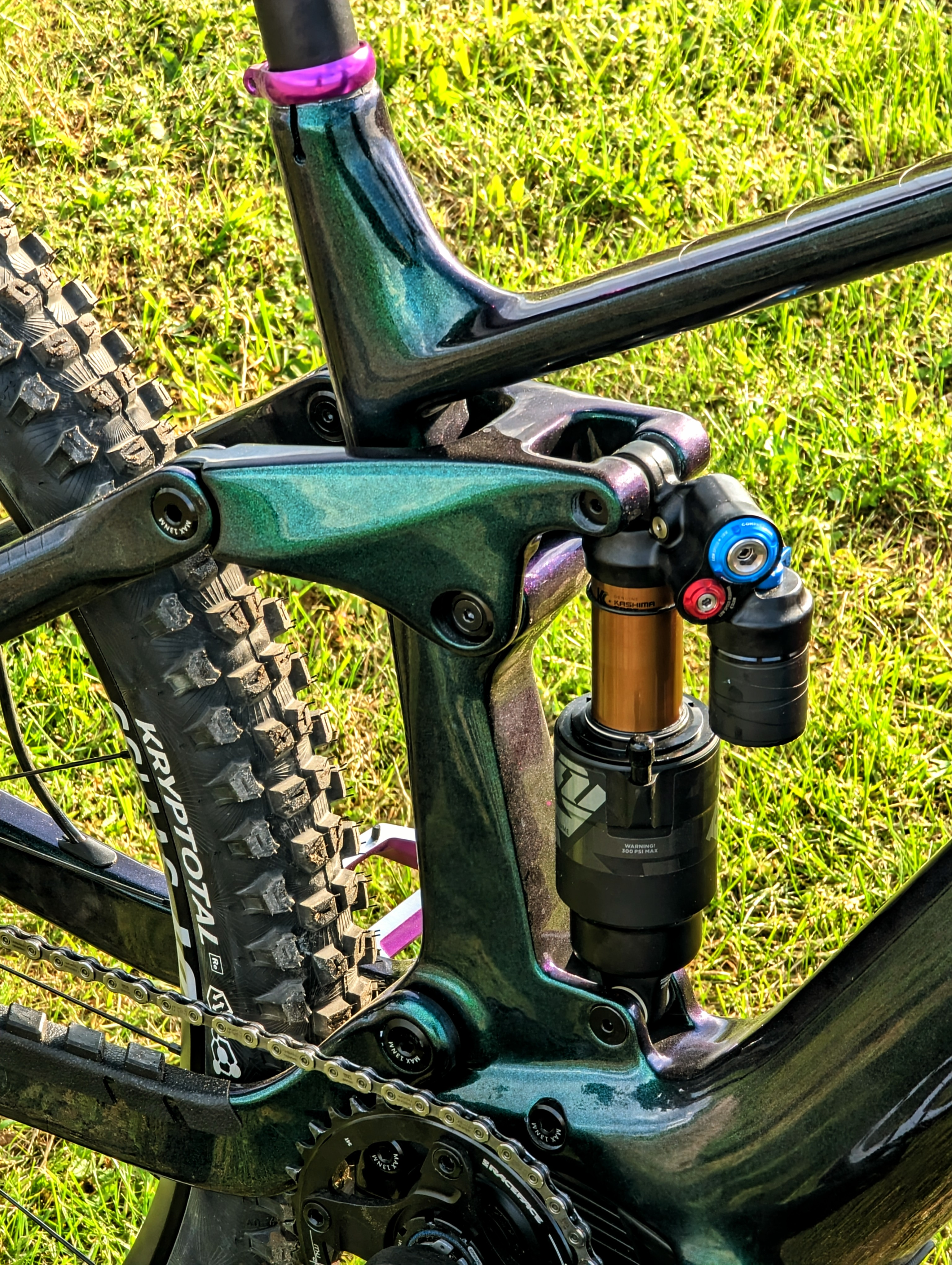

Regarding the Fox X2-Shock: Fits in perfectly...

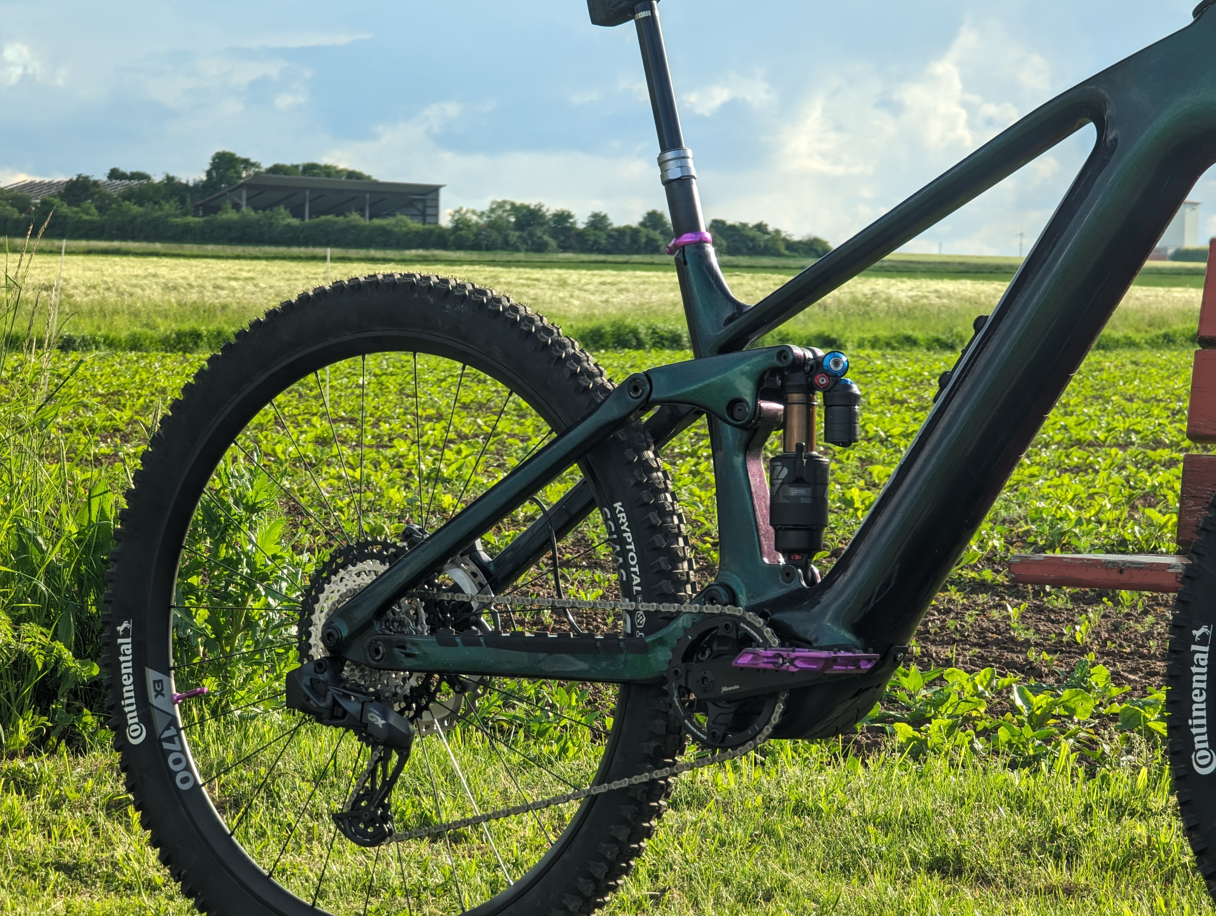

As you can see in the next picture, I am also running a Shimano XT 12x Cassette with a SRAM GX AXS derailleur.
I do have some very minor issues in the middle-gears, but this does not bother me at all.
Good thing about the Shimano-Cassettes: you can change the smaller sprockets seperately, which are the most used ones - saves a ton of money... :)
"you can change the smaller sprockets seperately, which are the most used ones - saves a ton of money... :)"
depend where you ride, for me it's the bigger sprockets who are used more :giggle:
Yeah, you're absolutely right...
To be honest - due to spare-time-issues - i mostly use my bike for commuting etc.
Not really the intended use at the moment. :(

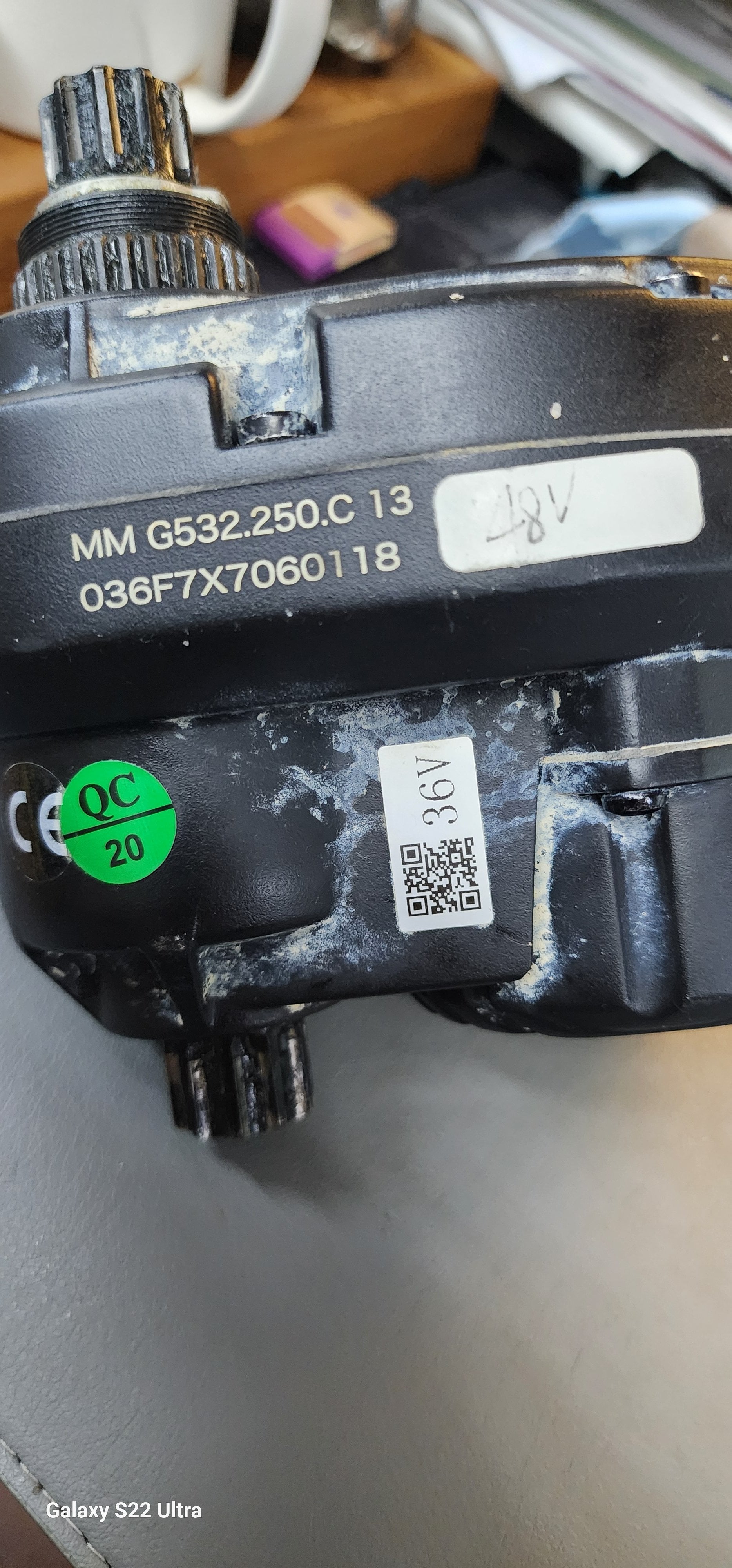

Yes u can but u have ro be VERY careful , my Go+ automatically update to 36V but my battery is 48V. Once u get the wrong update , u will get an error msg and then u need Besst to fix it.
When u click on update on Go+ , it will show the new update file, look at the file name carefully CRX30PC4812E102006.1_230216.bin this is 48v ...PC48...if u see PC36 or PC42 , it's 36 or 42v.
Y
But do you have a 36V Motor?
Looks good!👍 So, is your X2 on the Vi frame (air) or V2 frame (coil +)?
