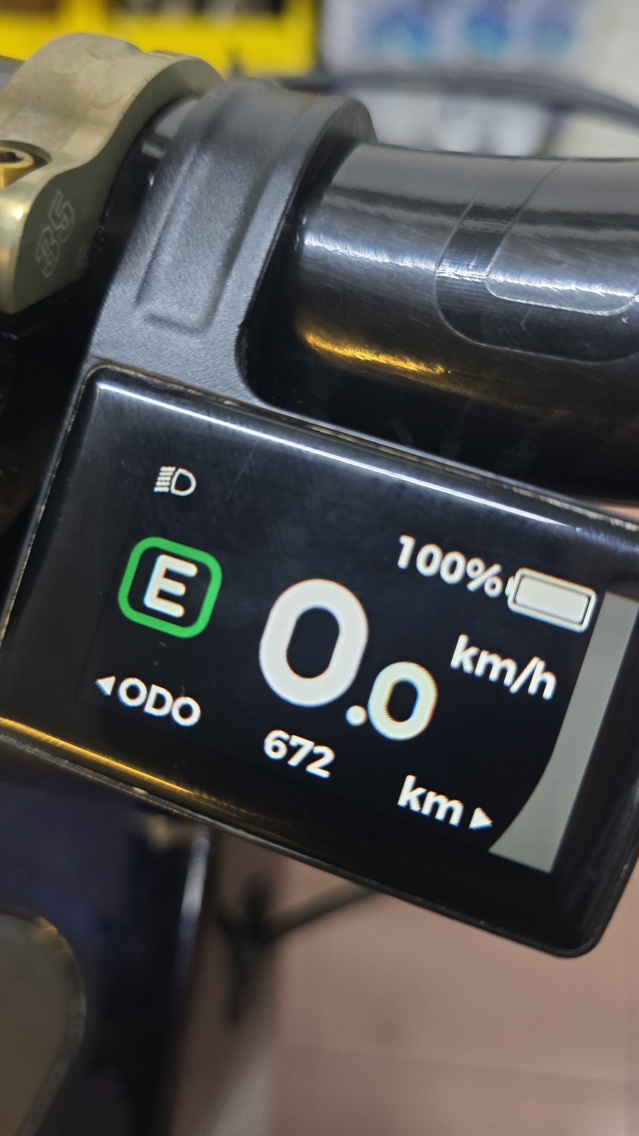

My new GX reach 0.5 and it's almost break at 670km , will try xx1 next.

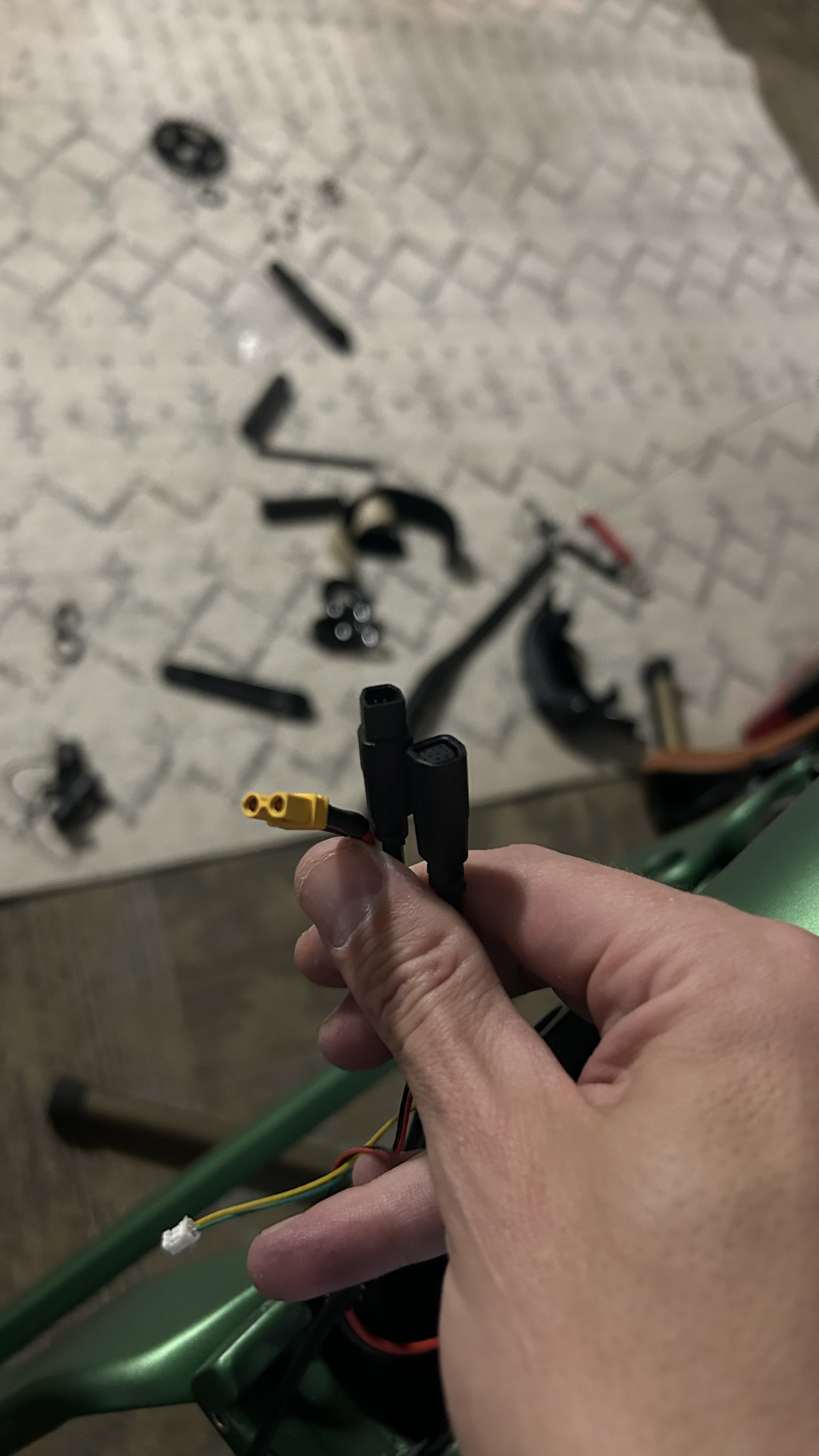

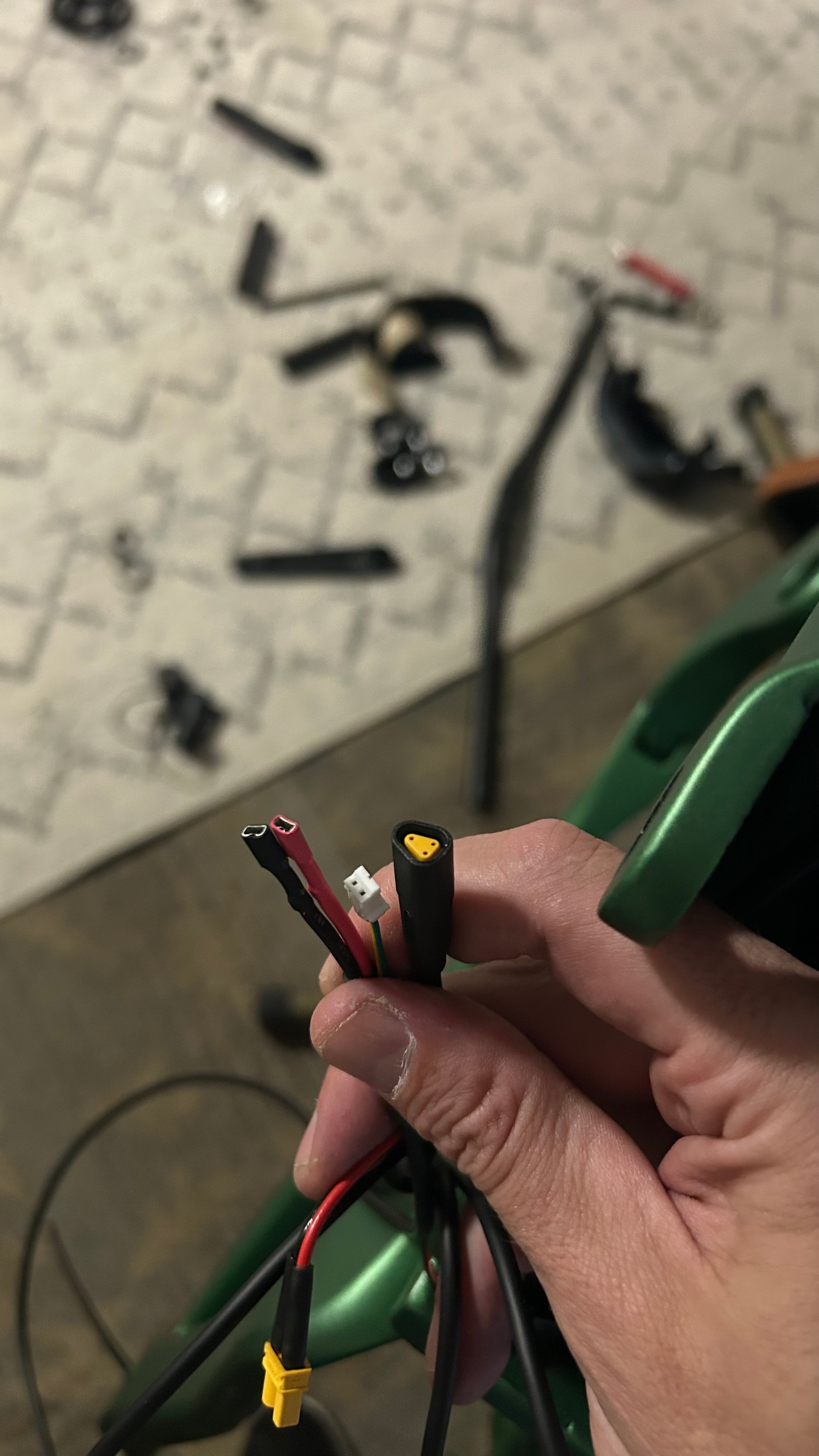

Am I dumb? I removed the motor to make cable routing easier but now can't figure out how everything goes back together. I can see where the 3 cables in the first picture all connect to the motor (one is from the speed sensor, one is from the battery, and one is from the control deck), but I have no idea where the 3 plugs in the second picture go? Any assistance?
the top three are all I used, I know the small red and black female terminals are for a light, the yellow triangle I think is for an optional shift sensor or brake cut off? the small white one, not sure. My cef50 didn't come with that one.
for my build I just shrink wrapped the yellow one, and the red and black pair. and tucked them up under the battery.
Awesome - thanks for the intel Rusty! Much appreciated.

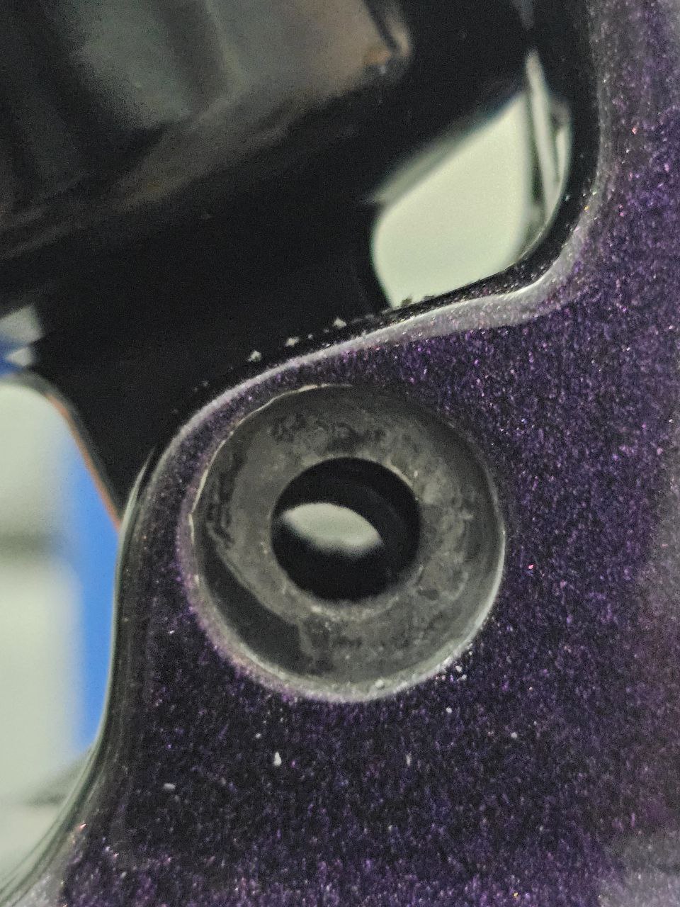

Hello guys, i have an hard time with internal frame rooting (brakes and derailleur) do you guys have any tips ?
No tip but I remember it was complicated when you enter the rear triangle
Try to come from the back maybe and then pull ?
Start at the back, take the shock off so you can manipulate the rear triangle and create a gap where it goes from chainstay to BB area. Also try getting something smaller through first like a cable and using that to guide the housing.
One tip—
send in a shift cable through, but leave the little barrel out back. Butt the housing to the barrel and heat shrink them together. As you pull the cable it will guide the housing without getting caught up.

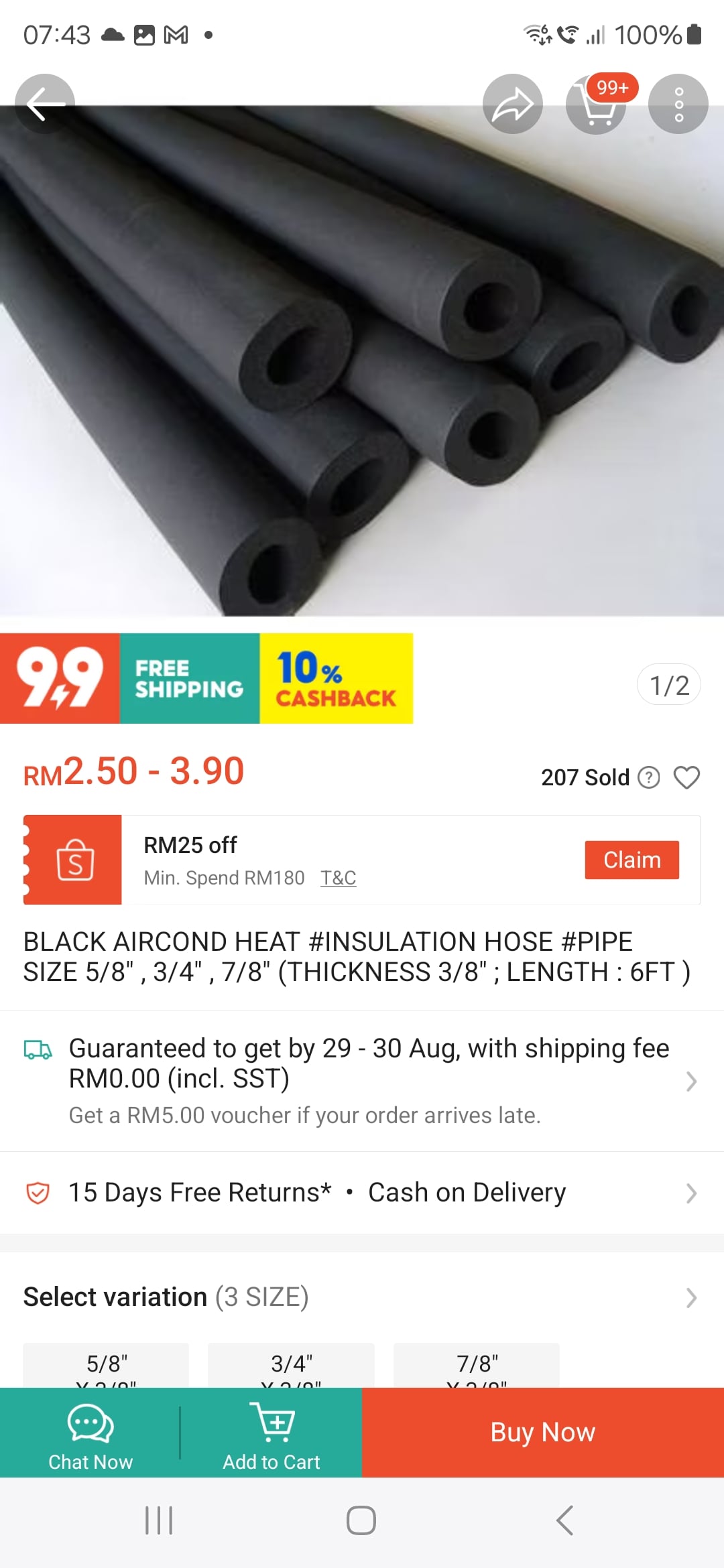

I have try many way to eliminate cable , you can think of if I basically try before. Anyway use the AC insulation hose it's the best n easiest method. Now my bike has no cable sound problem.

Anyone have any trouble with their electronics not working? I finally got all my cables routed and reinstalled the motor. Made sure all 3 plugs that go into the motor are nice and snug. Power button on frame will light up but motor and display will not power on. Wondering if I got a dud or if I am doing something wrong?
U
Unplug all the cable and plug in back again . It's normal where LCD panel does not power up. I usually unplug the LCD section first if can't only remove the motor . Please check your speed sensor has enough room when your shock it's fully compress. I broke my cable before..
