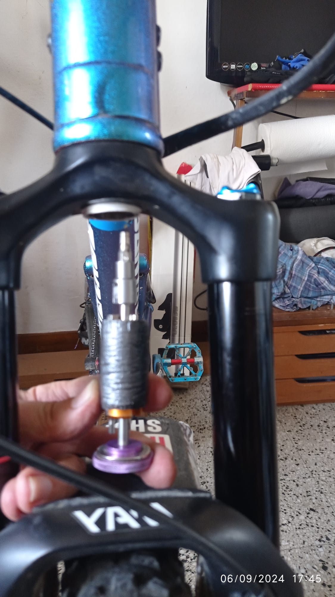

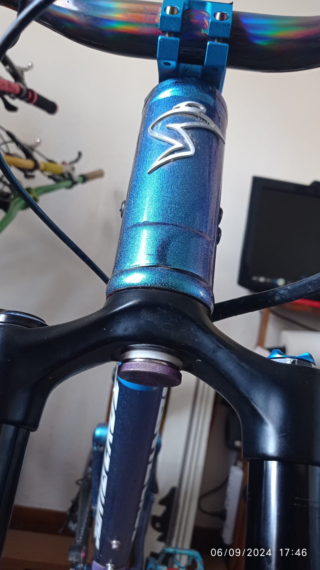

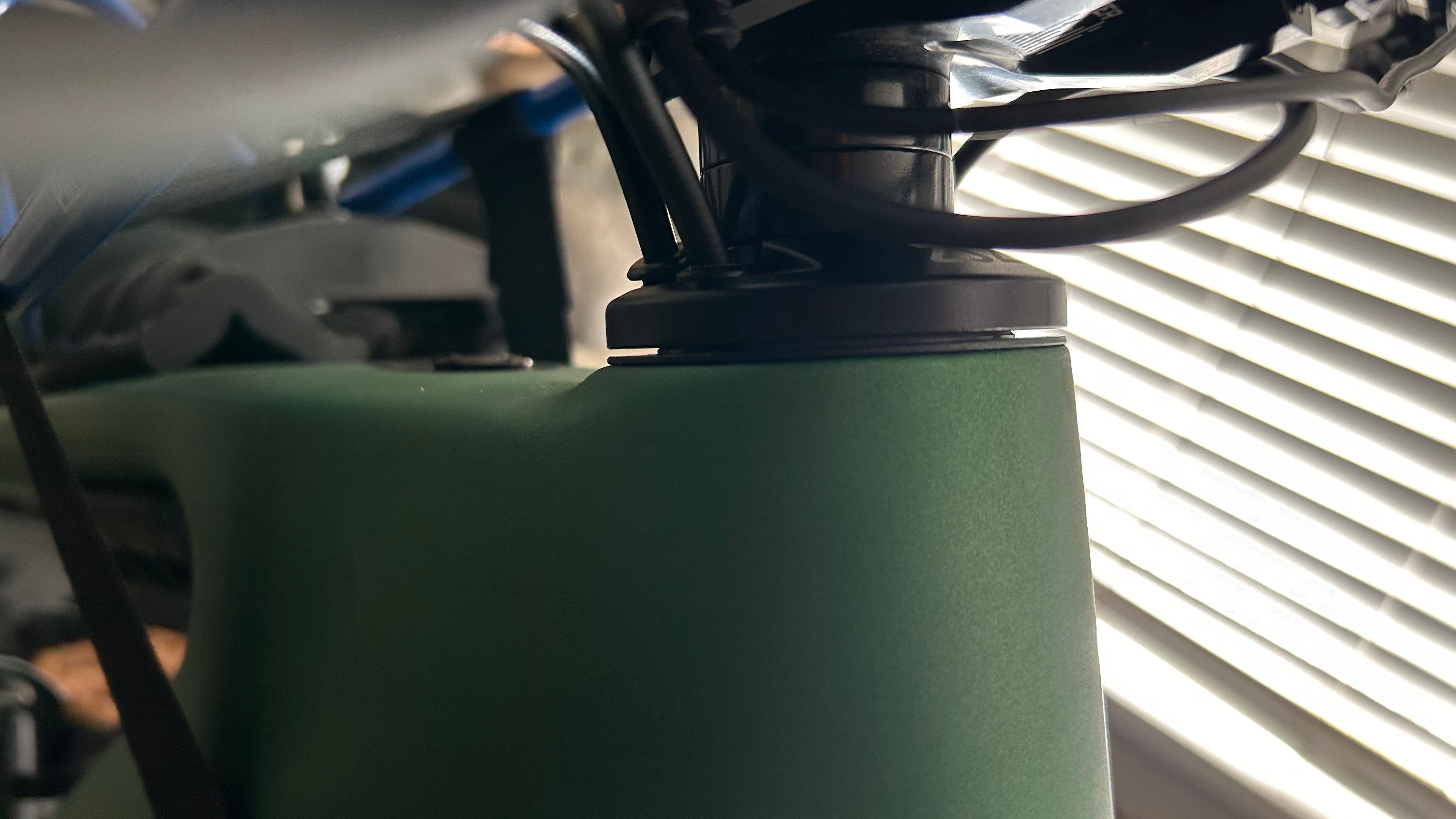

Did I install the headset correctly? On the top stack, starting from the bottom, I went: bearing into the frame > nylon compresson ring > dust cap > spacers > stem > top cap. On the bottom I went: bearing into the frame > crown race > fork. I ask because my headset included an additional slotted race but I can't see that it's used for anything. I'm assuming it's just for a fork with different sized steerer tube?
And how much clearance are you guys getting with your dust cap? I used a bearing press tool to push the bearings into the cups and was worried about damaging them if I sucked them down any harder, and I have pre-loaded my top cap so hard that I'm afraid I'm going to pull my star nut out of my steerer if I go much harder, but I'm still getting a gap and a decent amount of play in the whole assembly. Wondering if there's something I can improve or if it's just kind of a cheap headset that I should look at replacing.
had the exact same issue.
Gap is normal but if there is a play, its because you either have put the compression ring upside down, or you did not put enough spacer on your fork (below or above the stem).
You may also have put the bearing upside down (angled outside edge should be toward the other bearing)
The last spacer should be 2-3 mm above the fork, otherwise compression ring has no compression
That is correct. It's probably for 1.8" steerer
compression issue follow instructions post from @souftosouf
You shouldn't put extreme torque on the top cap! You definitely shouldn't need a bearing press "to push the bearing into the cup"! That sounds scary :lol
If you still have problems, pull it apart and show us photos of your assembly

Hmm. Pretty positive I didn't install anything upside down - double checked orientation on everything before installing. I'm using the correct spacer height to ensure that my top cap has at least 2mm to pull on for compression - and I've got that bolt cranked down hard - the system is definitely as tight as I can get it - but for whatever reason my fork still has a slight bit of play that I'm hoping to remove.
I did notice that I have the compression cap and dust cap installed pointing the opposite direction from I believe is intended - but I don't think that would make a difference, yea? I'm not looking forward to fixing that - I've already attached and bled my brake hose :(
Regardless, I'll take the whole assembly apart tomorrow and doublecheck everything and see if I can figure out where the play is.
correct
you should not need using bearing press to insert bearings into zero stack headset cups, usually they fit without any resistance
preloading the cap that hard may lead to pulling star nut indeed. using this much force should not be necessary and it won't solve this issue. this is a well-known problem with this headset and the only working solution is replacement of the headset with a good quality one, see Non-ICR headset, internal frame cable guide conversion for the SZZS-specific CEF50

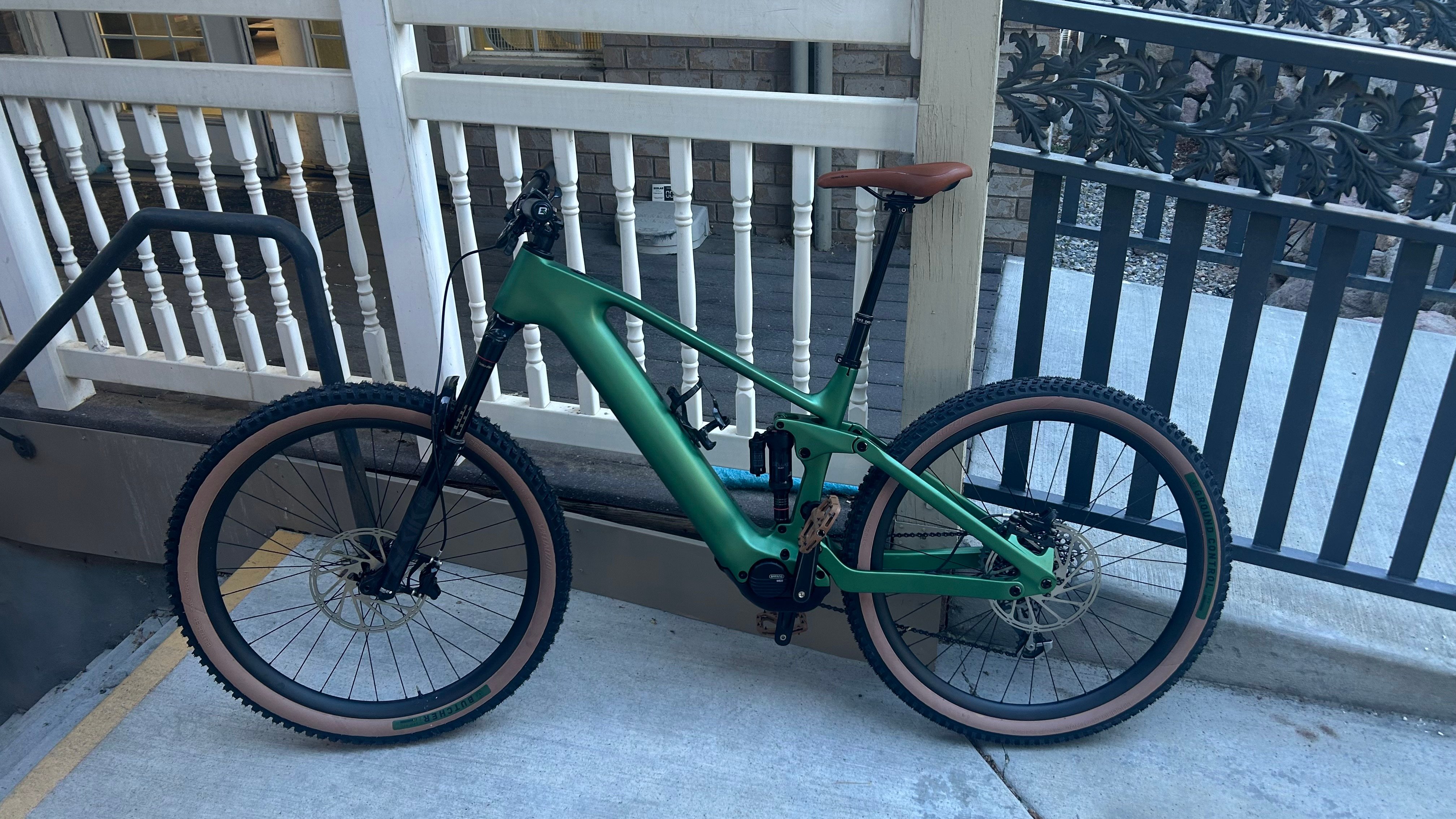

Good grief. FINALLY got everything put together after days of trial and error and frustration. Finally took it our for a spin and am immediately getting ERROR 21. The magnet is installed correctly but it doesn't look like it comes anywhere near close enough for the sensor to pick it up - why did they put the sensor in the wrong location for the magnet they've supplied?? Should I look into getting a new magnet or relocating the sensor?
Also - how on earth are people getting these under 40lbs? Mine weighs 44 pounds even though I've used carbon wheels, a carbon handlebar, X01 drivetrain, etc. I don't think I could shave 4 more pounds even with an unlimited budget and flimsy XC parts.
Also - how on earth are people getting these under 40lbs? Mine weighs 44 pounds even though I've used carbon wheels, a carbon handlebar, X01 drivetrain, etc. I don't think I could shave 4 more pounds even with an unlimited budget and flimsy XC parts.View attachment 146263
Weight wise, I think the tires are also a good explanation, if you want something that won’t’ fail on the first trail, it’s heavy!
Also, what battery do you have ?
For your error 21 its a very conmen problem, just pull the speed sensor cable out from MOTOR and extention JOIN. I believe your sensor cable has another short cable that act as extension. Just pull both cable out and push it back in. PLEASE take NOTE you speed on the magnet side, there should be enough room for movement when your shock its fully compress else your cable will be pull into 2 piece just like mine.
The bike is beautiful. Regarding weight, it has 700 batteries weighing 4 kg and 410 batteries weighing 2.6 kg. Its tires are 2.6 and easily 0.5 kg more than a 2.35. The most important thing is that it is configured for your needs.
Thank you! I'm very happy with how it turned out. Love the color. And that makes sense - I went with the 700 battery, 29 inch wheels, etc. My old Specialized Levo Turbo from 2018 weighs about 56 pounds so this should still feel much better on the trails.
Beautiful build mate, well done!

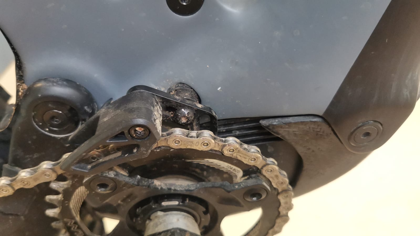

Took mine out for it's first ride last night. Everything seems to be working smoothly. The Bafang motor is noisy as hell compared to Brose motor in my 2019 Levo Turbo. Almost to the point of being annoying - but I knew this was going to be the case when I bought it. The upsides are worth it - with this setup I gain 50% battery and lose 12 pounds compared to the Levo. Plus this bike cost about 1/2 what a new Levo does. I am getting an annoying clicking noise when descending that kind of sounds like maybe cables/plastic parts bouncing around and hitting the carbon - I wish the frame had cable guides and that the connector cords didn't have so many plastic bits. I'm not quite sure I have the energy to diagnose exactly what's causing the noise this month... maybe next month.
-Has anyone found a suitable front chain-guide for this frame? Doesn't appear to have any standardized mounting points for one. Having a chain come off on an ebike in high power mode while you're still pedaling can be disastrous...
-Has anyone found a good user manual for the motor/display? I found one for how to physically install the motor but nothing for how to use the system. I would like to know how to switch from Km to Miles, how to turn off the ambient light sensor, etc.
-Is it possible to modify any of the motor settings with the 820 like overrun, acceleration, etc.? And how should I got about upgrading the firmware if I got the 36V motor? I've seen people mention both the BafangGo app and an app called Ssense?
Thanks for everyone's help getting this thing put together. Only my second time tinkering with a modern MTB so lots of trial and error but am satisfied with the end result.
For chain drop issue, My cef50 i have try several chain.
1. Shimano XTR chain with deckas chainring no chain drop after multi ride but my chain was too short so i have to replace it.
2. SRAM GX with deckas chainring, NOT a single drop but reach 0.6 at 650KM so need to be replace.
3. YBN ebike chain with worn Deckas chainring, keep drop until i lost count. My friend has this same chain with new original Bafang also has similar chain drop.
4. SRAM XX1 chain with NEW Deckas chainring so far no chain drop as i just install recently.
My personal recommendation its just use Deckas Chainring and replace your chainring every time you replace your chain since that chainring its dirt cheap on Aliexpress n use only Shimano or SRAM chain to prevent chain from dropping.

I drilled and threaded the motor mounting bolt.
