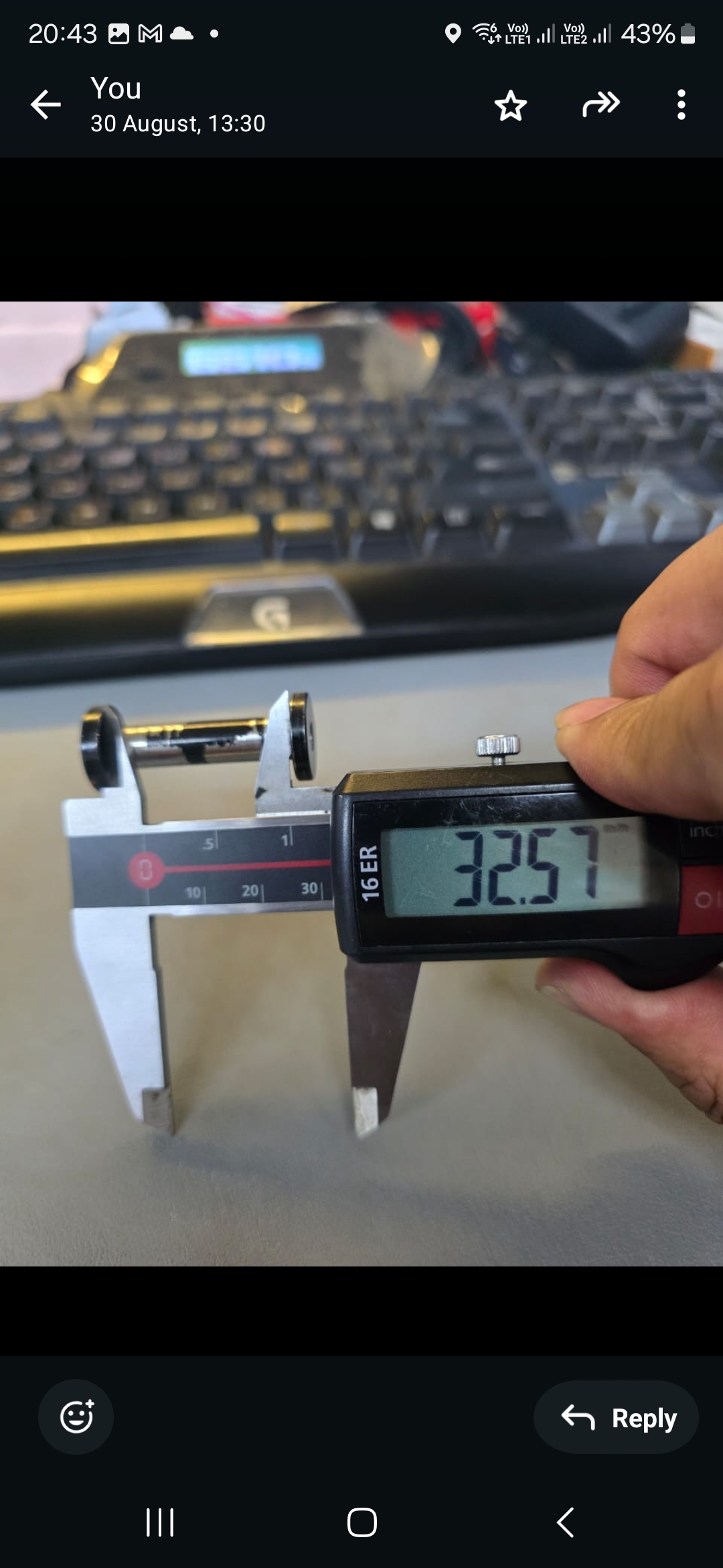

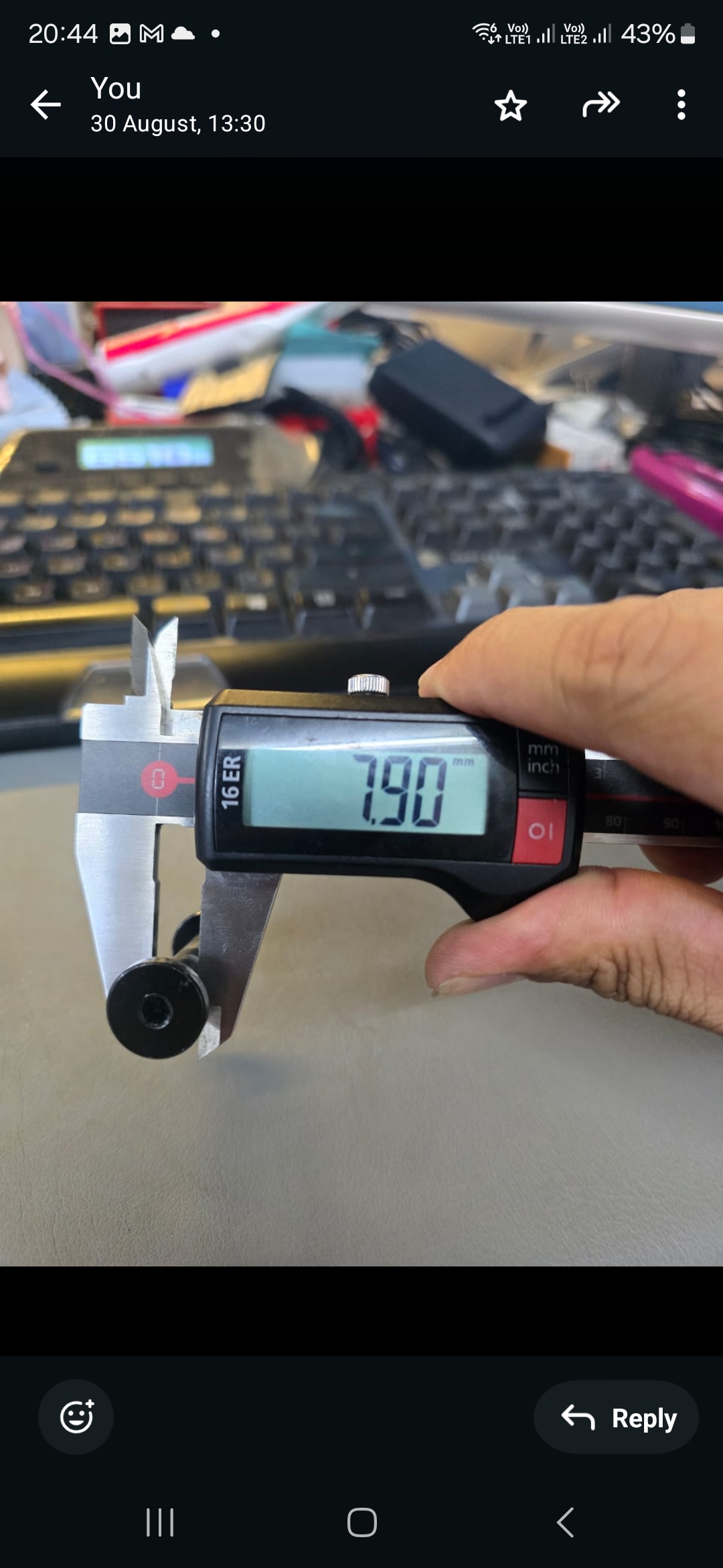

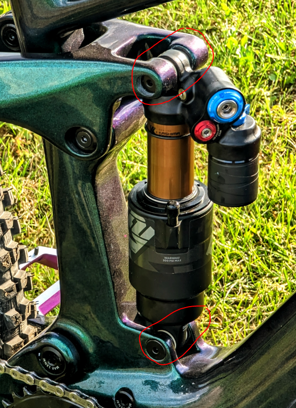

My m820 has a funny problem, just wonder if any encounter this before.
un..inc
Jun 13, 2023
127
112
I secured every bolt with threadlocker during buildup, and this is relatively secure...
The problem is: i destroyed the mounting-bolts for the shop...
Does someone have the exact measurements of those bolts?
Thanks!

Which bolts are you referring? Pic will be great
un..inc
Jun 13, 2023
127
112

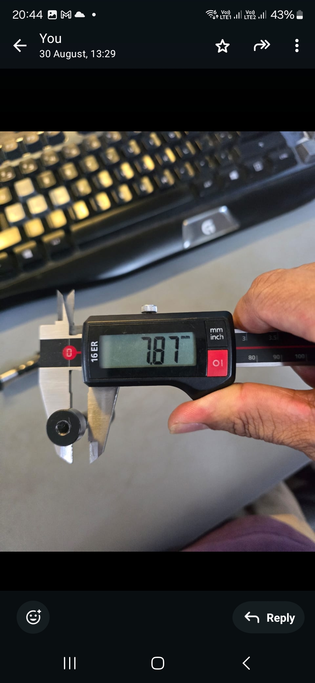

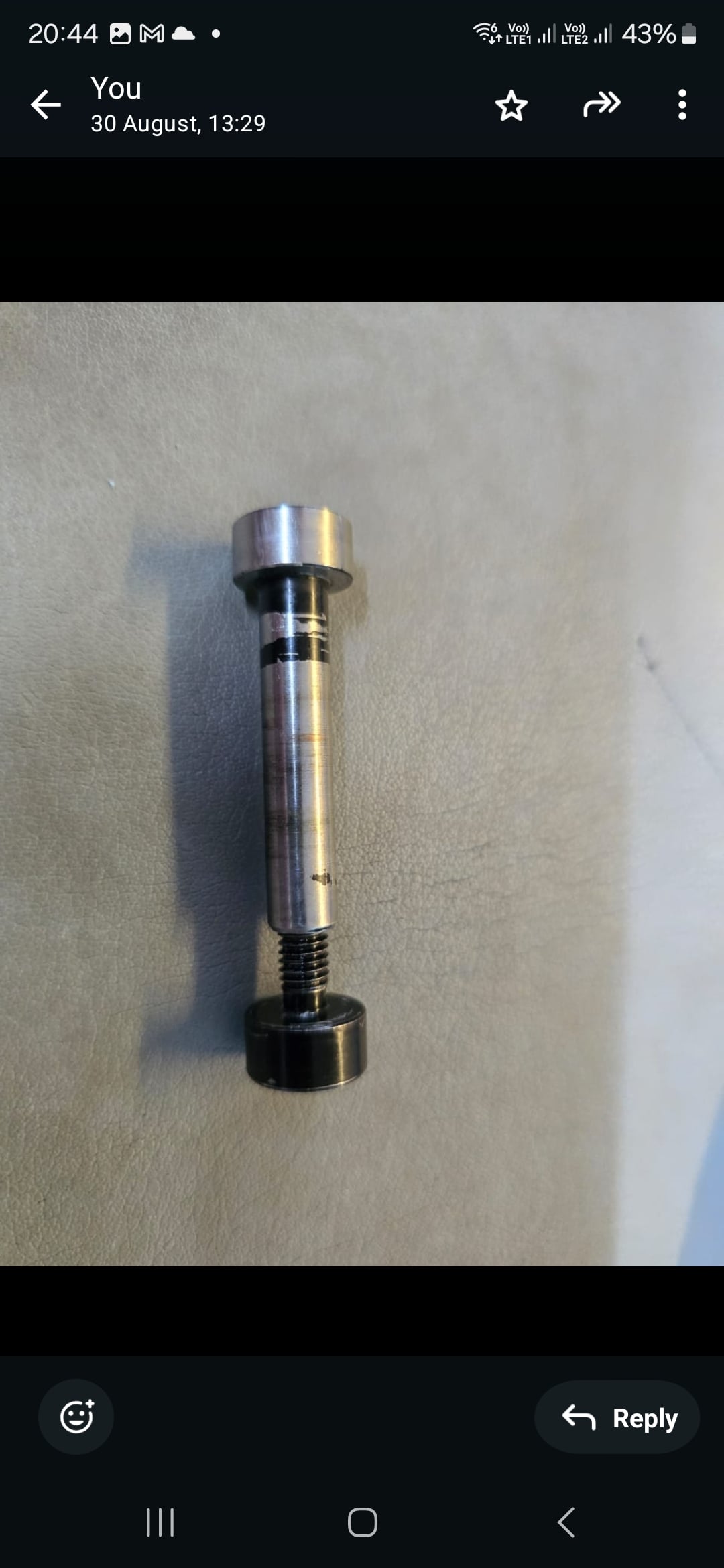

Sure:
And in the meantime, I can see, why it was not obvious... I meant the bolts for the SHOCK - which should be clear - but I wrote the bolts for the SHOP... :D
Sorry for that... ;)
Thank you all!

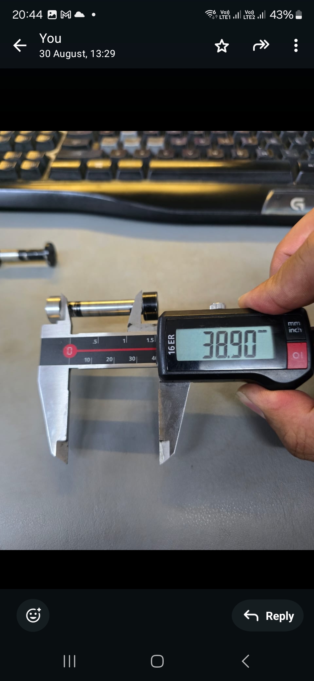

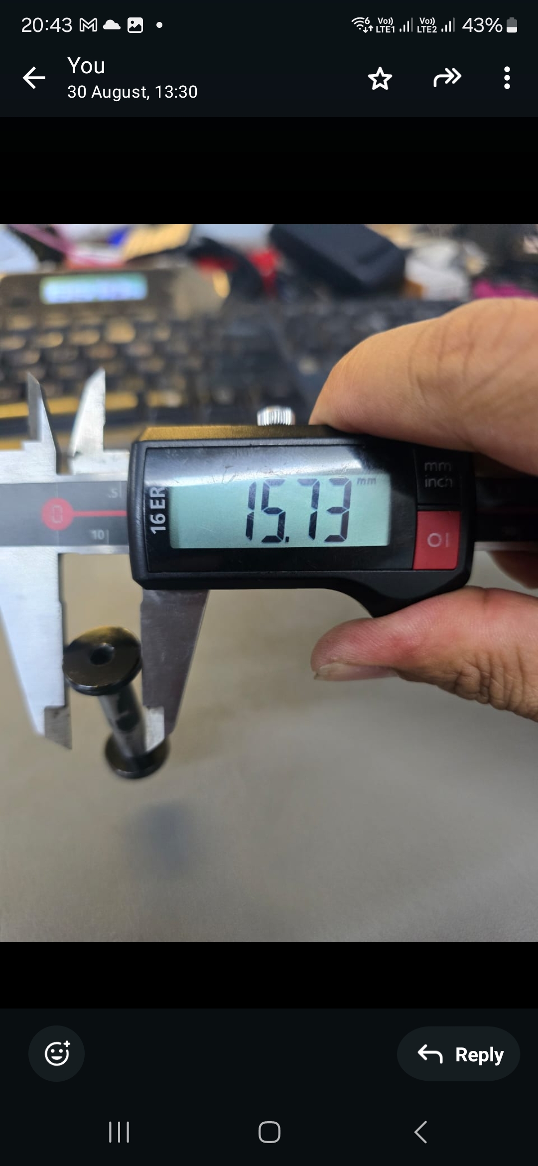

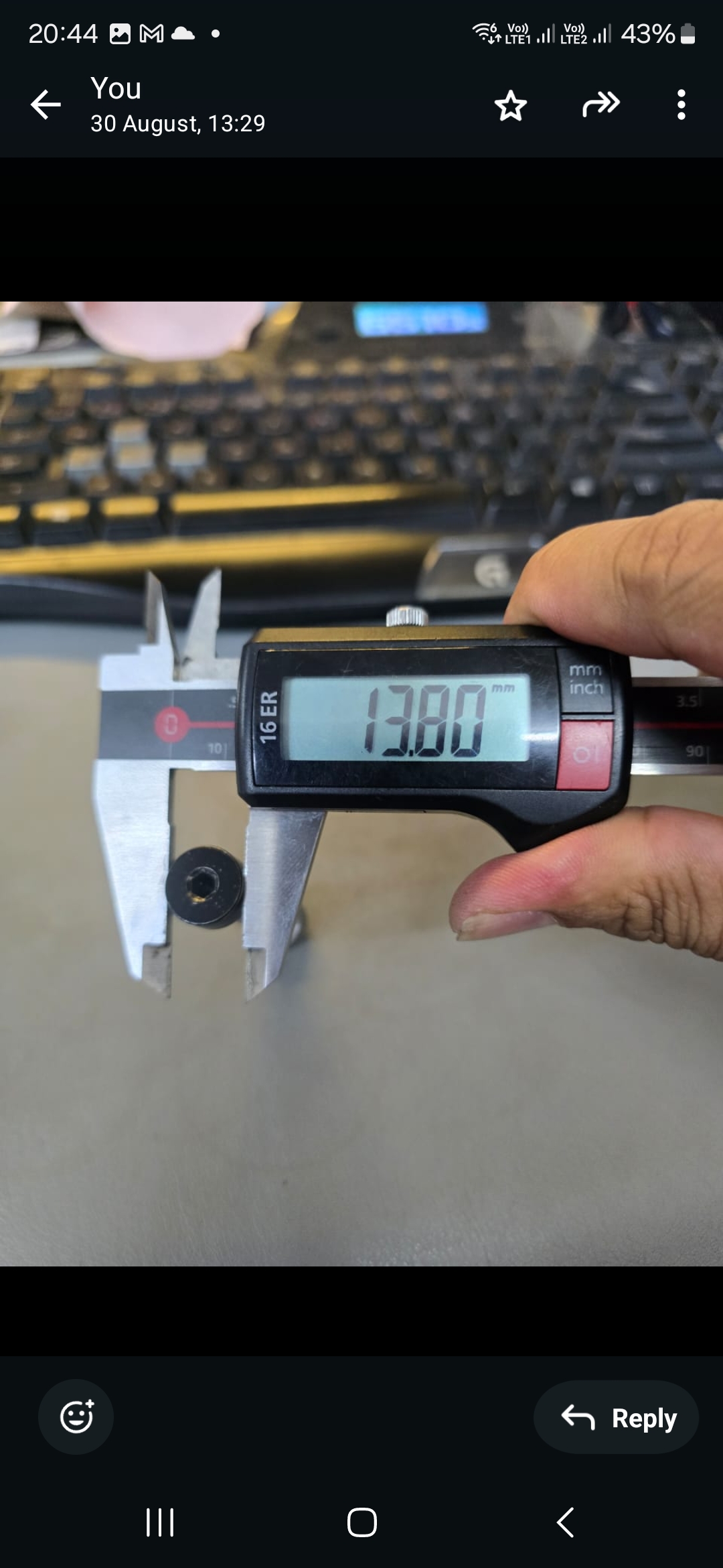

Contact Jean, she will sell you those shock bolts, if u lost the male bolts , just use your water bottle bolts, i lost my in trail and use water bottle until Jean send me a new bolt, it around 10usd. It's custom size , i try Google it but no luck.
Screenshot_20241001_204416_WhatsApp.jpg Screenshot_20241001_204412_WhatsApp.jpg Screenshot_20241001_204409_WhatsApp.jpg Screenshot_20241001_204405_WhatsApp.jpg

Thanks, I will contact her, but I fear, that the next bolts will be soft aluminium as well.
I would like to get bolts in titanium or steel...

BTW: I did not lose a part - I broke the Hex inside the bolt head...
So I will have to break it, to get it out...

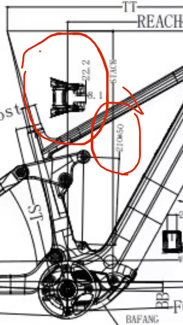

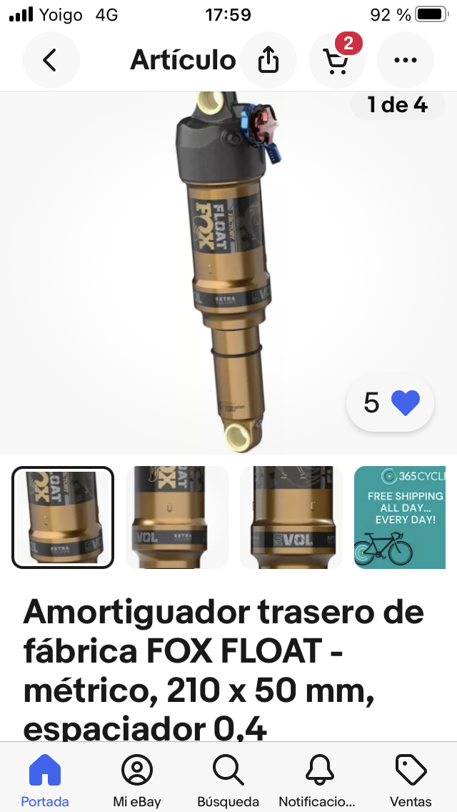

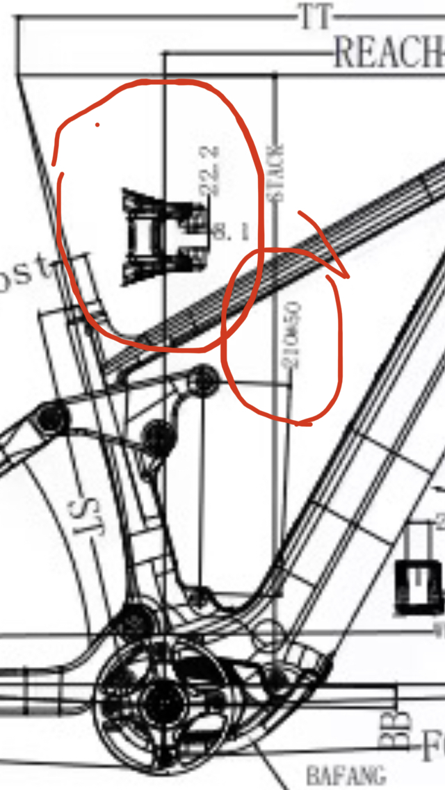

Hello, I have ordered a battery motor and a CEF 50 frame. I would like to know if this shock absorber is suitable for me. It says it is 210-50. The other measurement that is indicated on the geometry of the frame is 8* - 22.2. I also don't know if that measurement is the one that the shock absorber has.

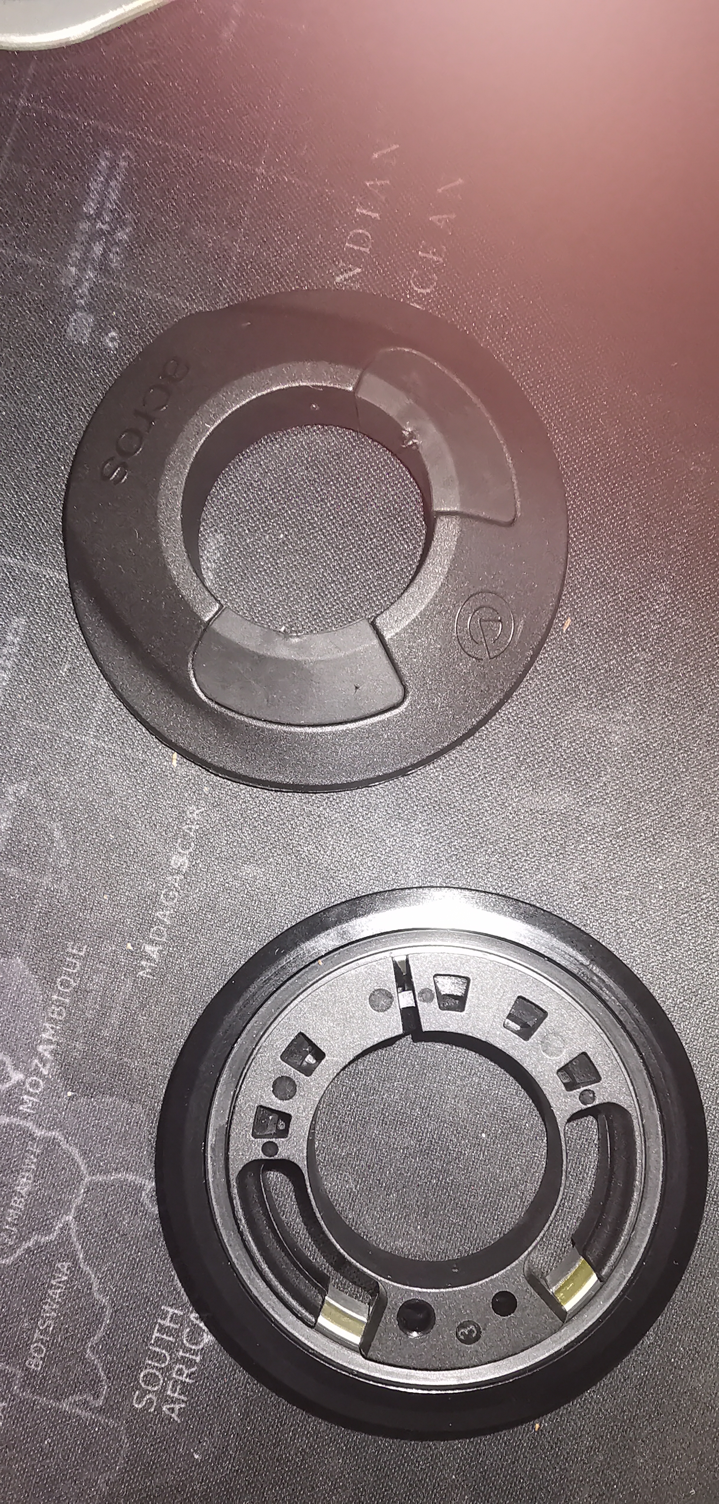

my headset creaks so bad, cant really get it tight always has slop. Is it the bearings, or do I need a different headset as the one with the bike is not great. THoughts?
