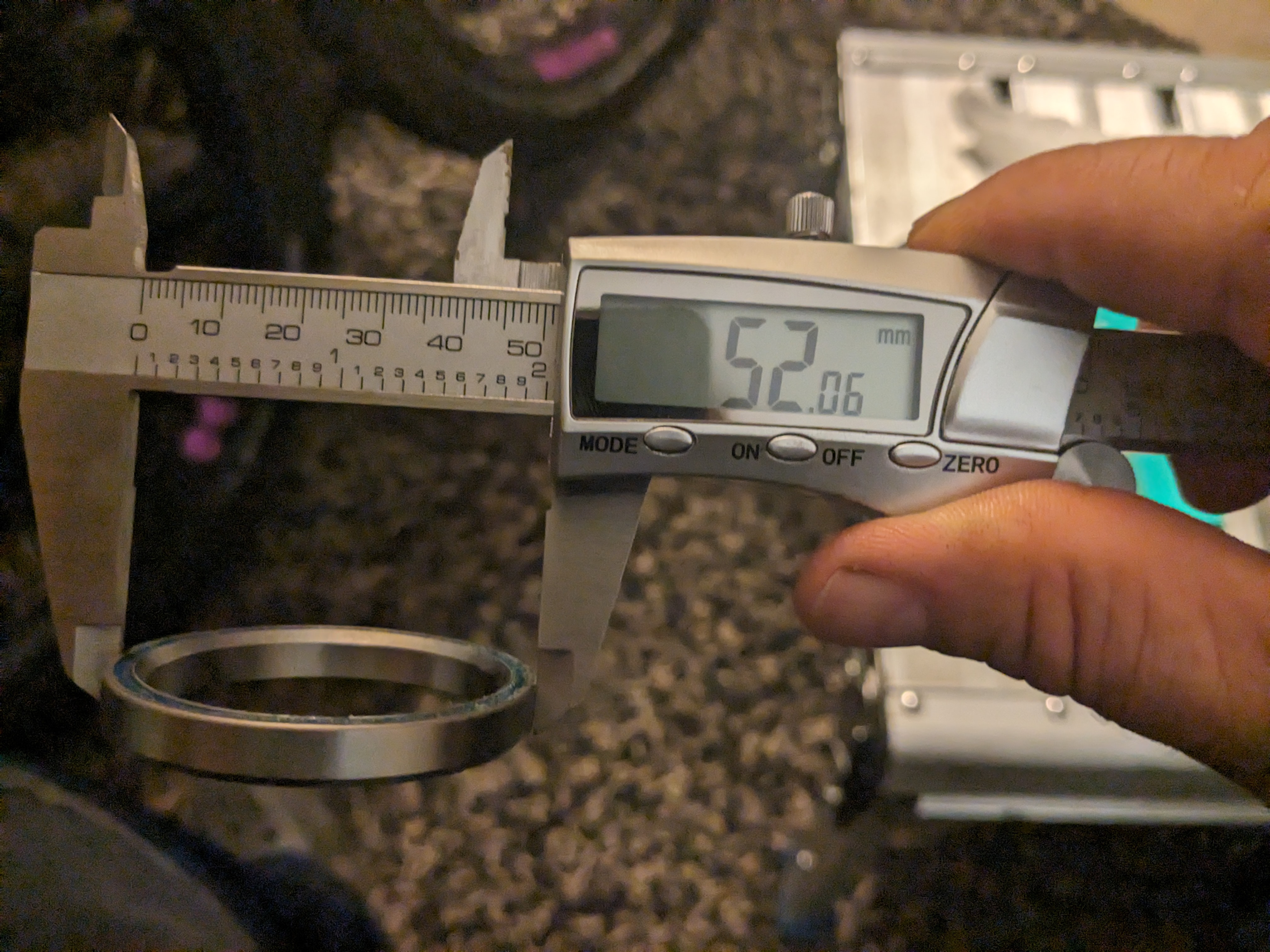

You can just measure the bearing, easier.

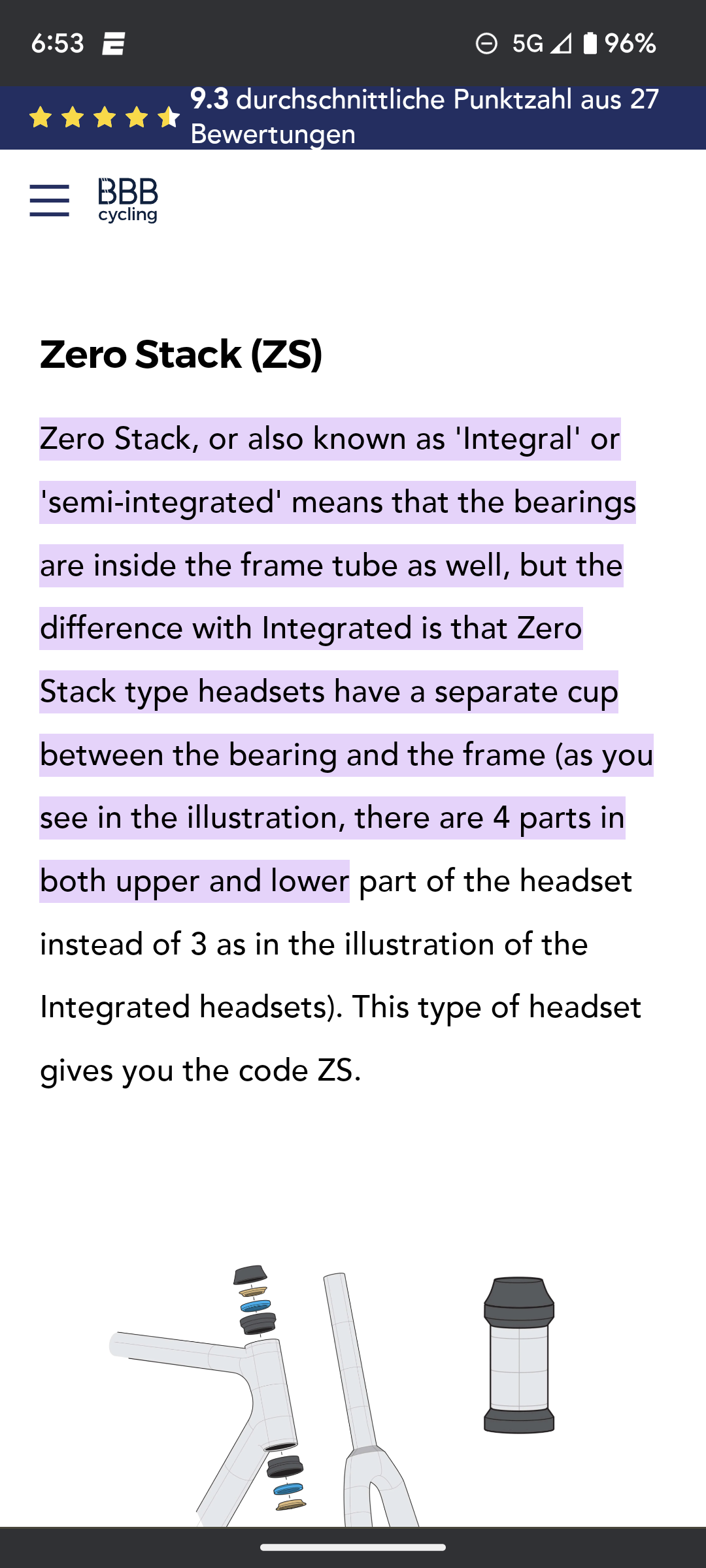

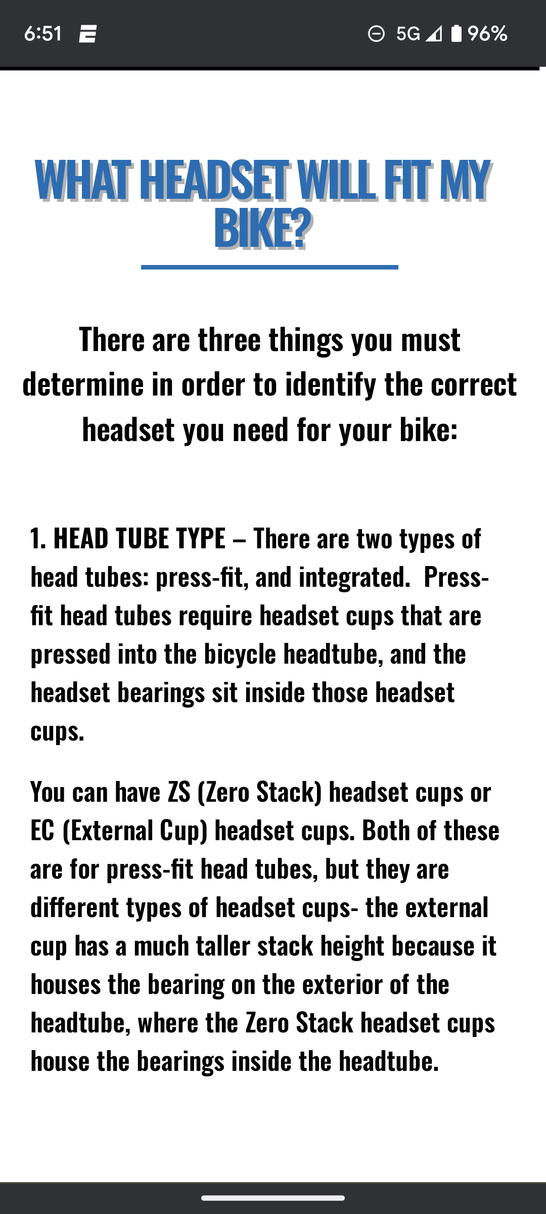

As others have probably stayed to clarify confusing systems: internal v. external. Both SZZS CEF50 and LCE930 are ZS.
✅ ZS is just the bearing/w cup internal to the headtube of the frame.
✅ It's also called "semi-integrated" as an older term.
✅ Fully integrated means the frame manufacturer has the bearing "cup" made into the frame. So, no separate cup but has the internal bearing.
Need proof? See references 👇.

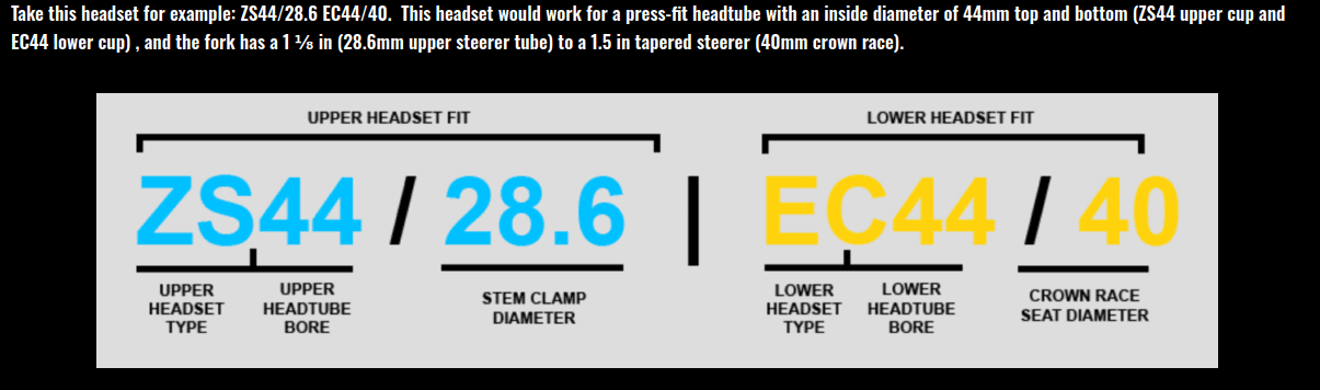

That is the confusion. Headset specs quote the internal bore of the headtube not the bearing size. So a ZS56 is a zero stack pressfit bearing cup for a 56mm bore headtube top.

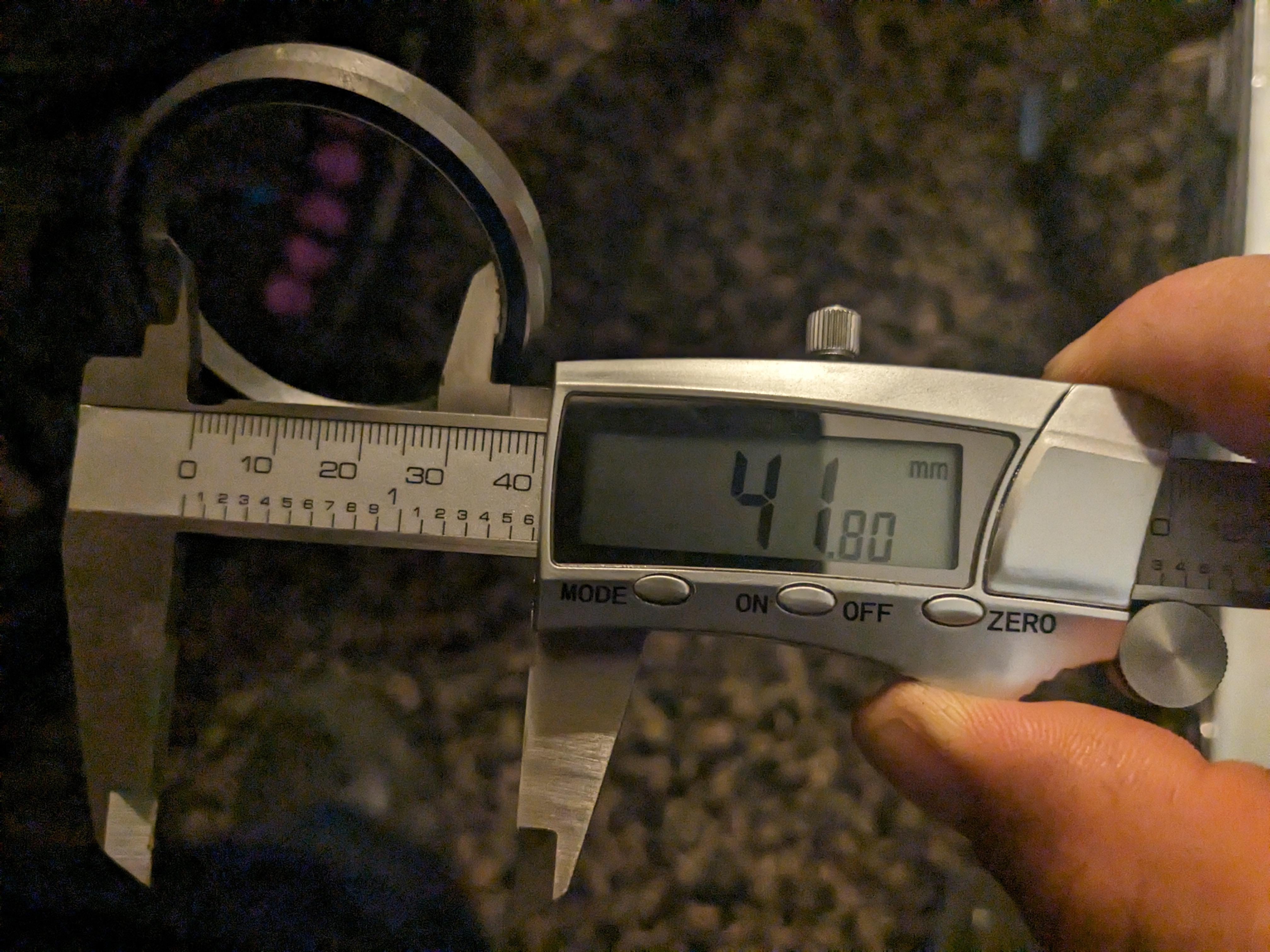

Yup Mike confusing. I offered only bearing sizes for the new and old SZZS ICR. And that it's ZS.
But some headset companies like Chris King and Cane Creek have compatibility recommendations for 52 mm headset bearings that work for ZS and IS for various headset sizes ZS56/ZS44/ZS42 common in Mtbs AND newer E-mtbs. So, one doesn't always have to guess. Plus, they would rather sell the complete headset, so I guess manufacturers figure that's the least confusing for the consumer? Until, the bearings sizes are needed to replace or just be upgraded in my case...then the hunt begins!

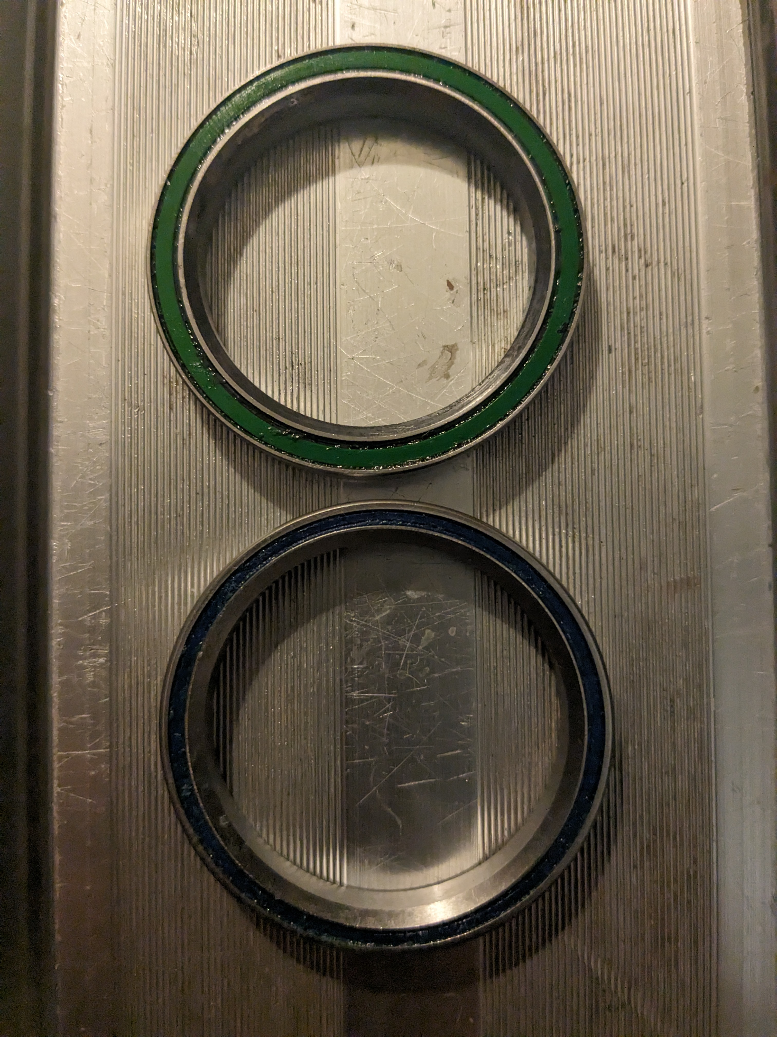

My experience is that stock headset bearings are FSA generics-low to mid quality. So, I planned on upgrading at the outset. I also found the lower ZS cup on my other DIY E-mtb builds from Dengfu and Light Carbon to be out of spec and junk. Just like the SZZS one was when installed to see how bad the slack it created. I had my Acros 66 bearing set up for the upgrade install and works well as planned. Good upgrade! IMHO.

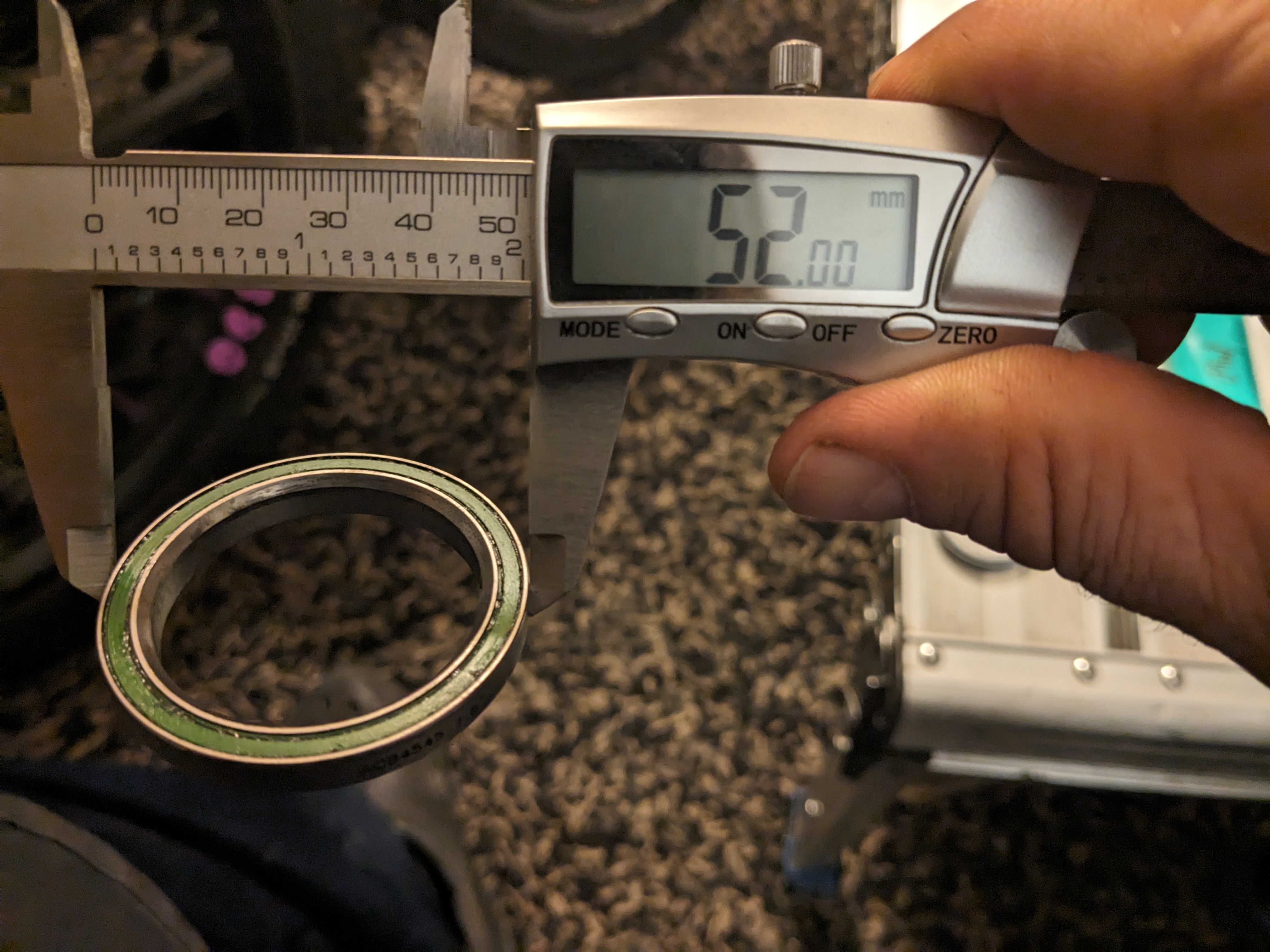

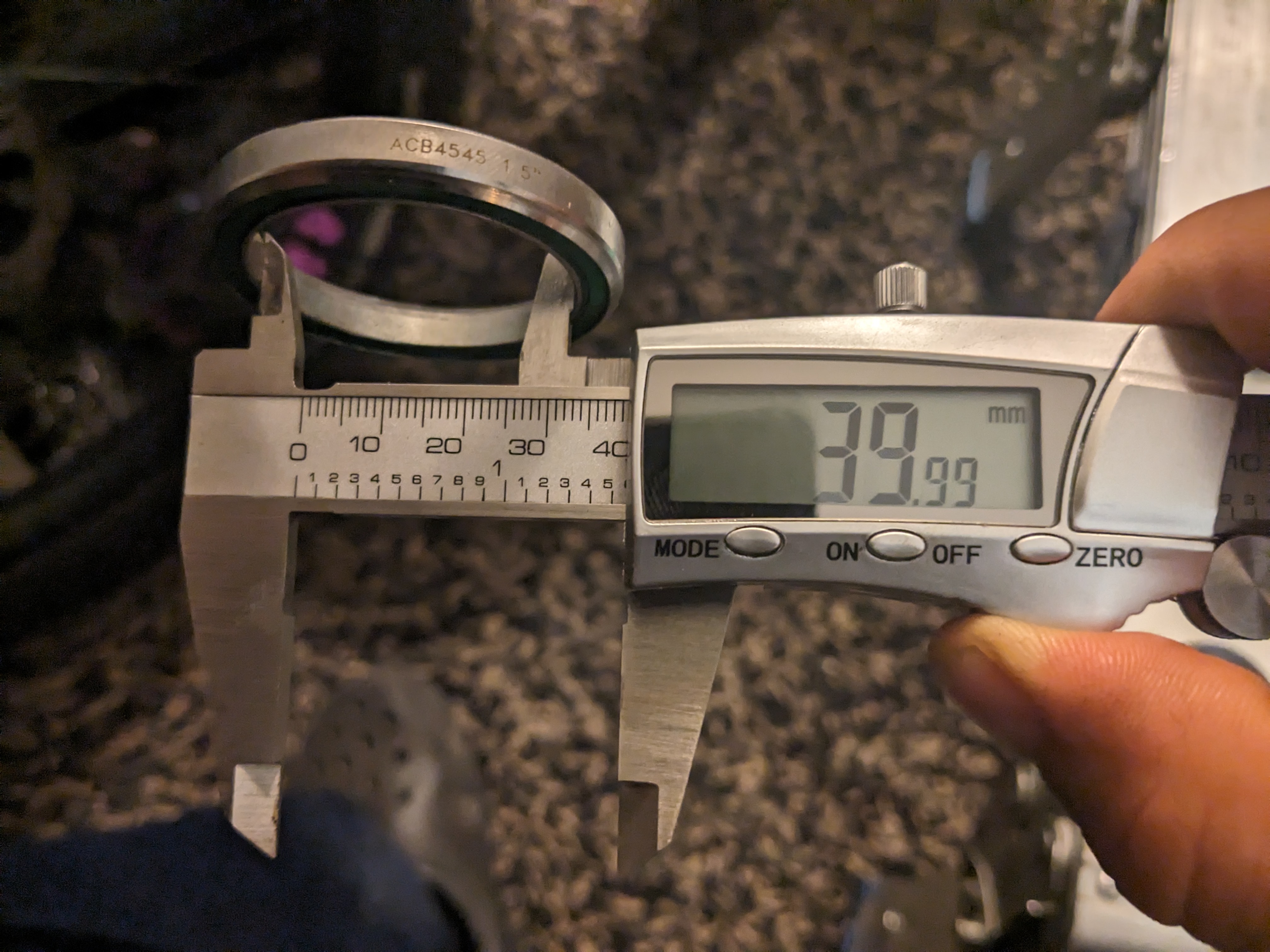

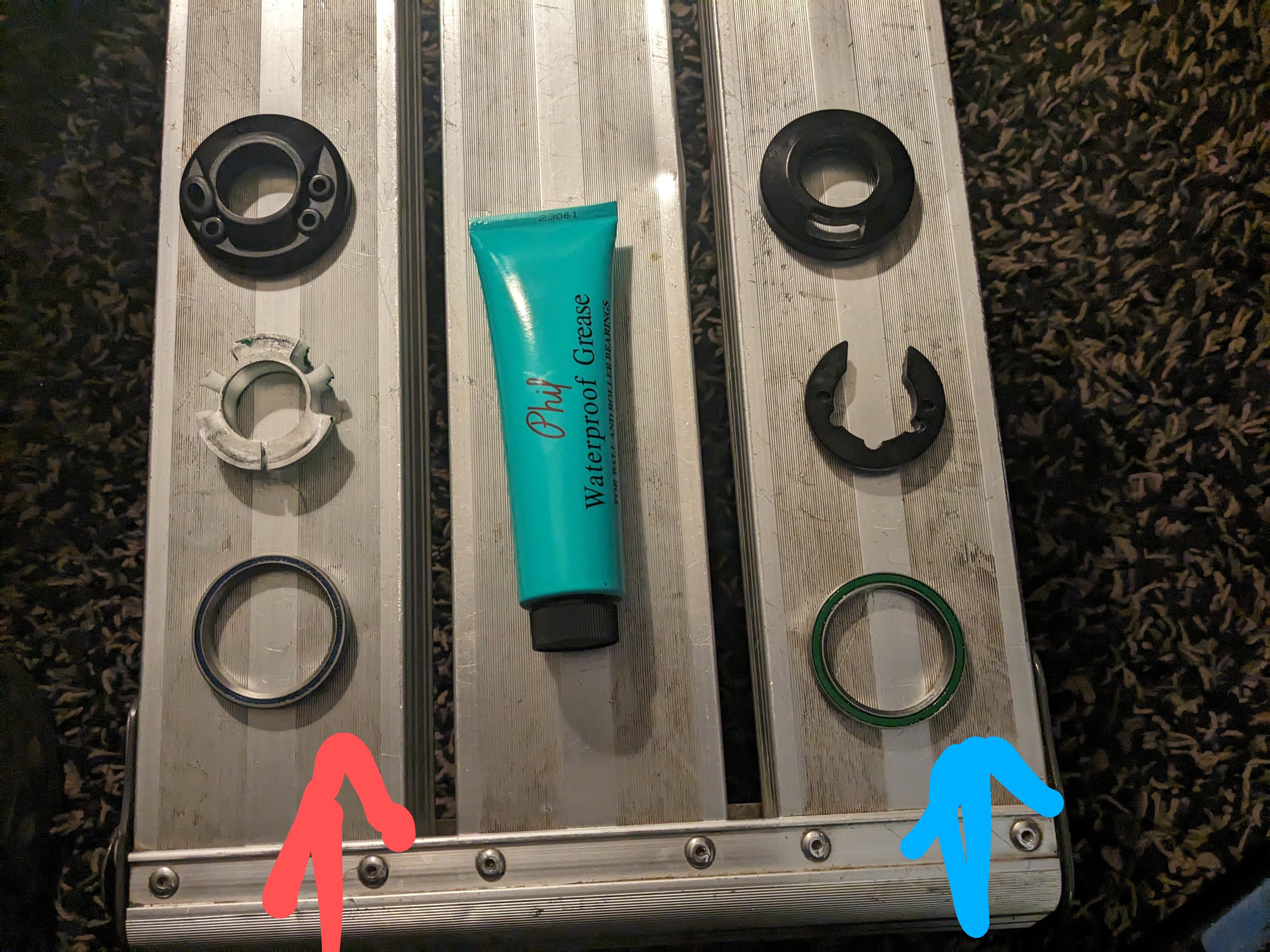

Both Old SZZS top cap worked with my 52/40 Enduro bearing upgrade. And for the New SZZS top cap, my new Hellbender 52/42 upgrade works.

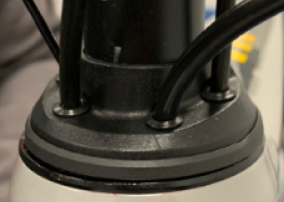

Side note: I did get creaking after hard driven rain on the Old SZZS top cap that had a gap. I just re-greased with Park grease that seemed to help. Now using Phil Wood waterproof grease for extra protection. However, the New SZZS top cap has a taller bearing cup that looks to cover the gap to prevent water ingress. I'll know if I ride in the rain, which is rare here in the desert.🍻

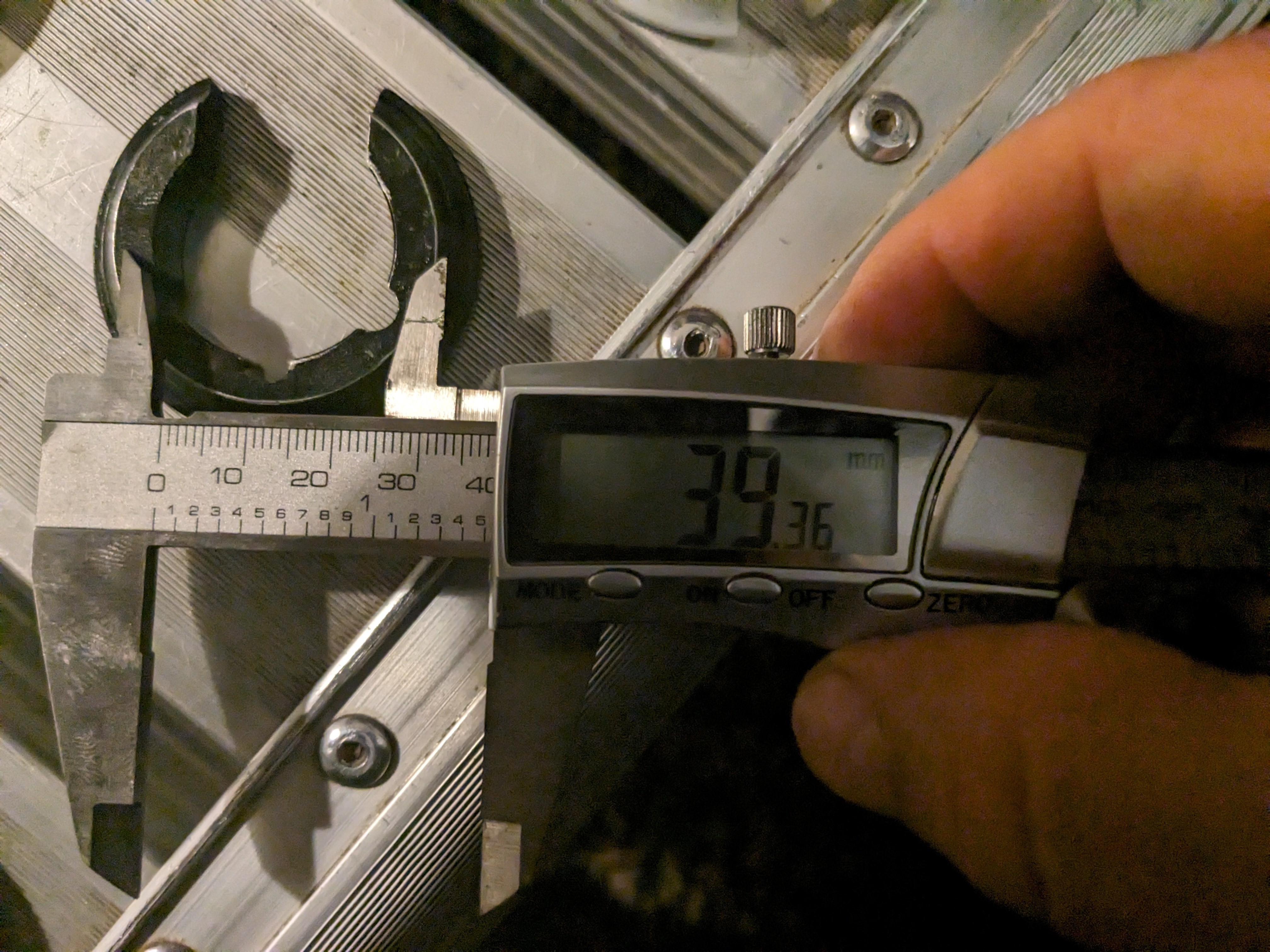

Both are snug when mounted...no play. New left (white plastic IRC insert/reducer) old right (black metal insert/reducer).👇

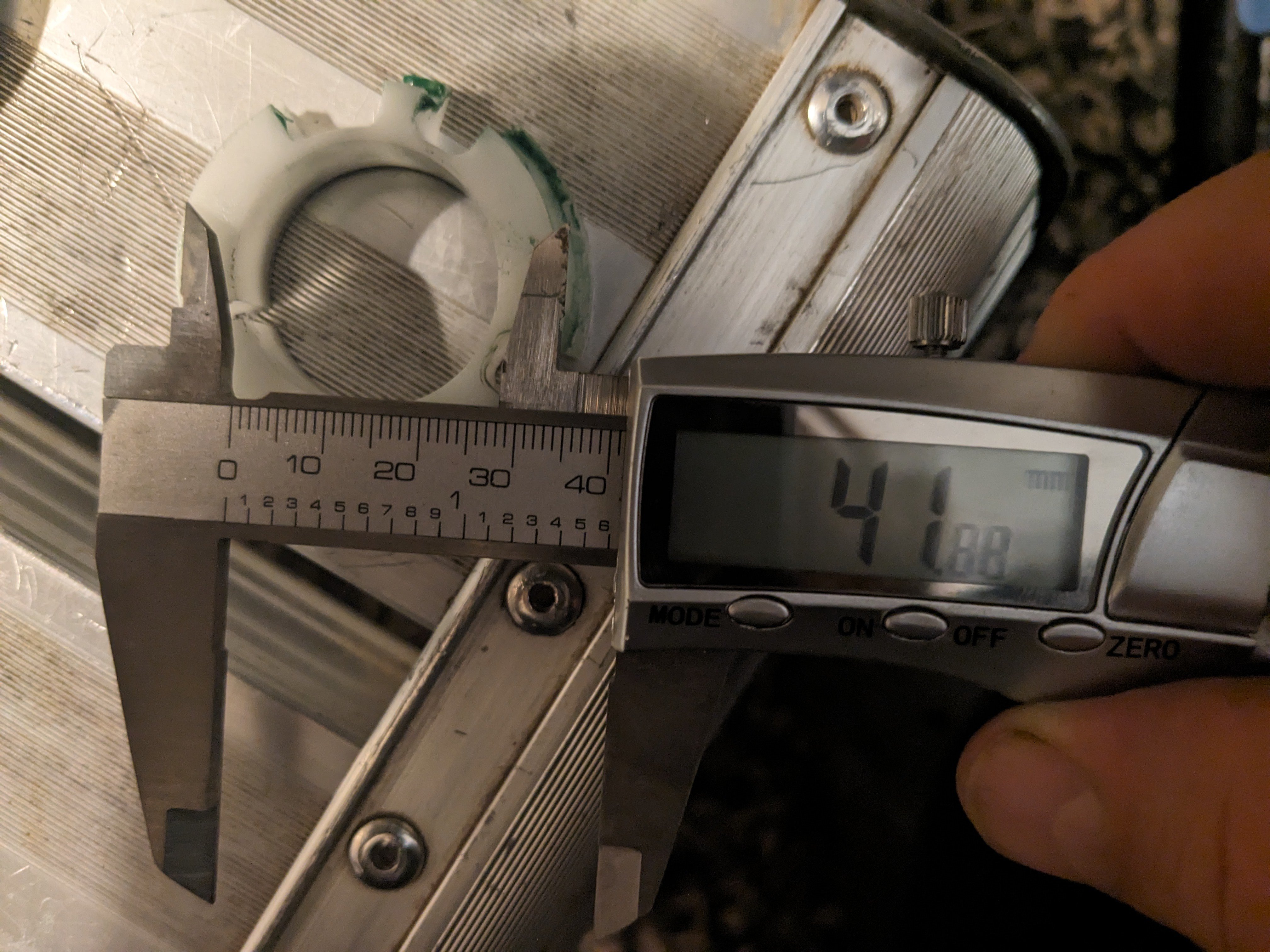

It is confusing because the industry also likes to round up. The 41.8mm size is half the time referred to as 42mm.
💯! And ICR is still new to the mtb/E-mtb industry, so mainly proprietary with frame manufacturers. I'm glad a premium brand like Acros was responding to the E-mtb demands with oversized headsets for some ICR universal compatibility.
