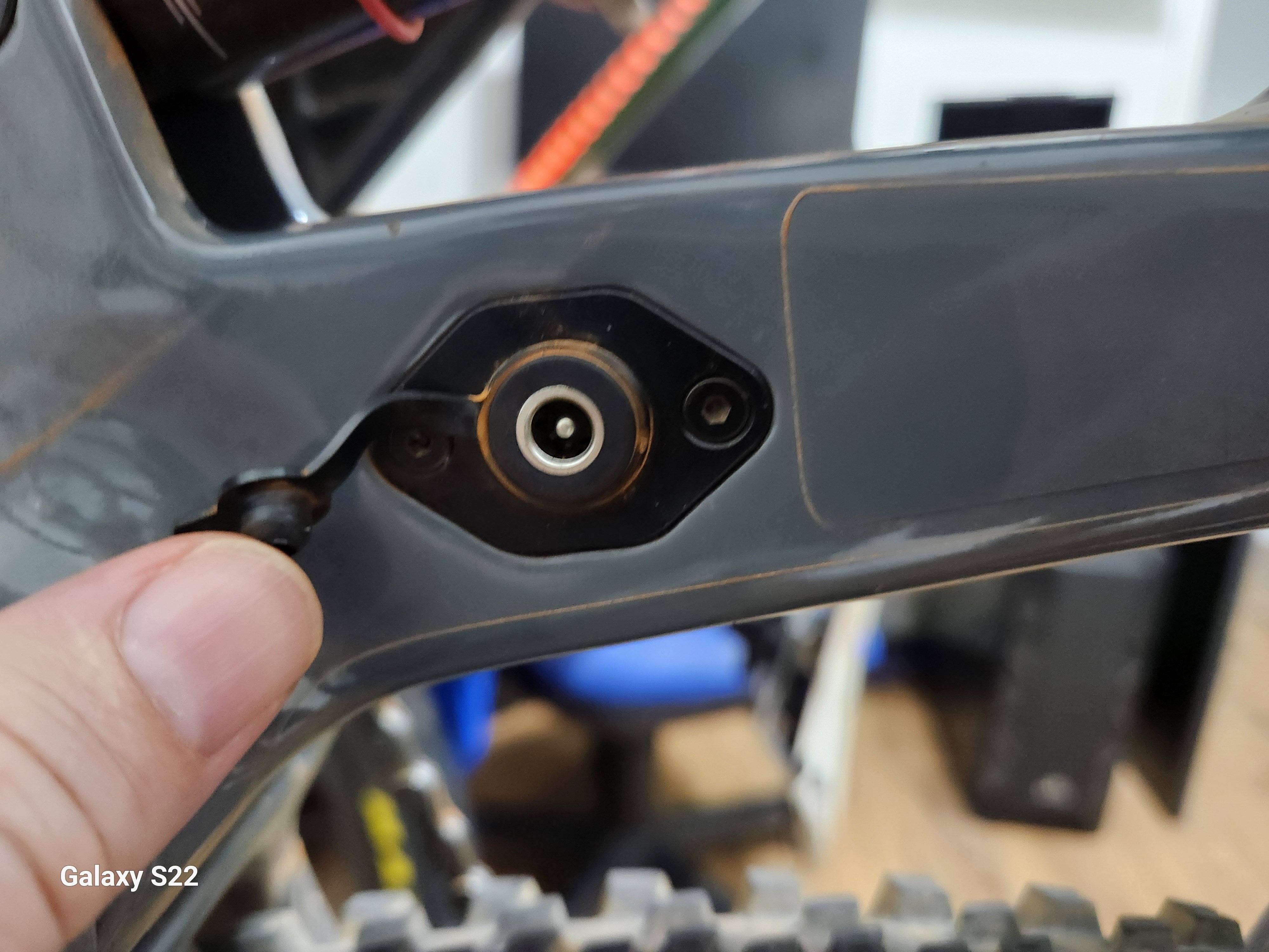

Looking at the extend battery connector it is 4 pins, my cef50 is a simple 2 way female connector.

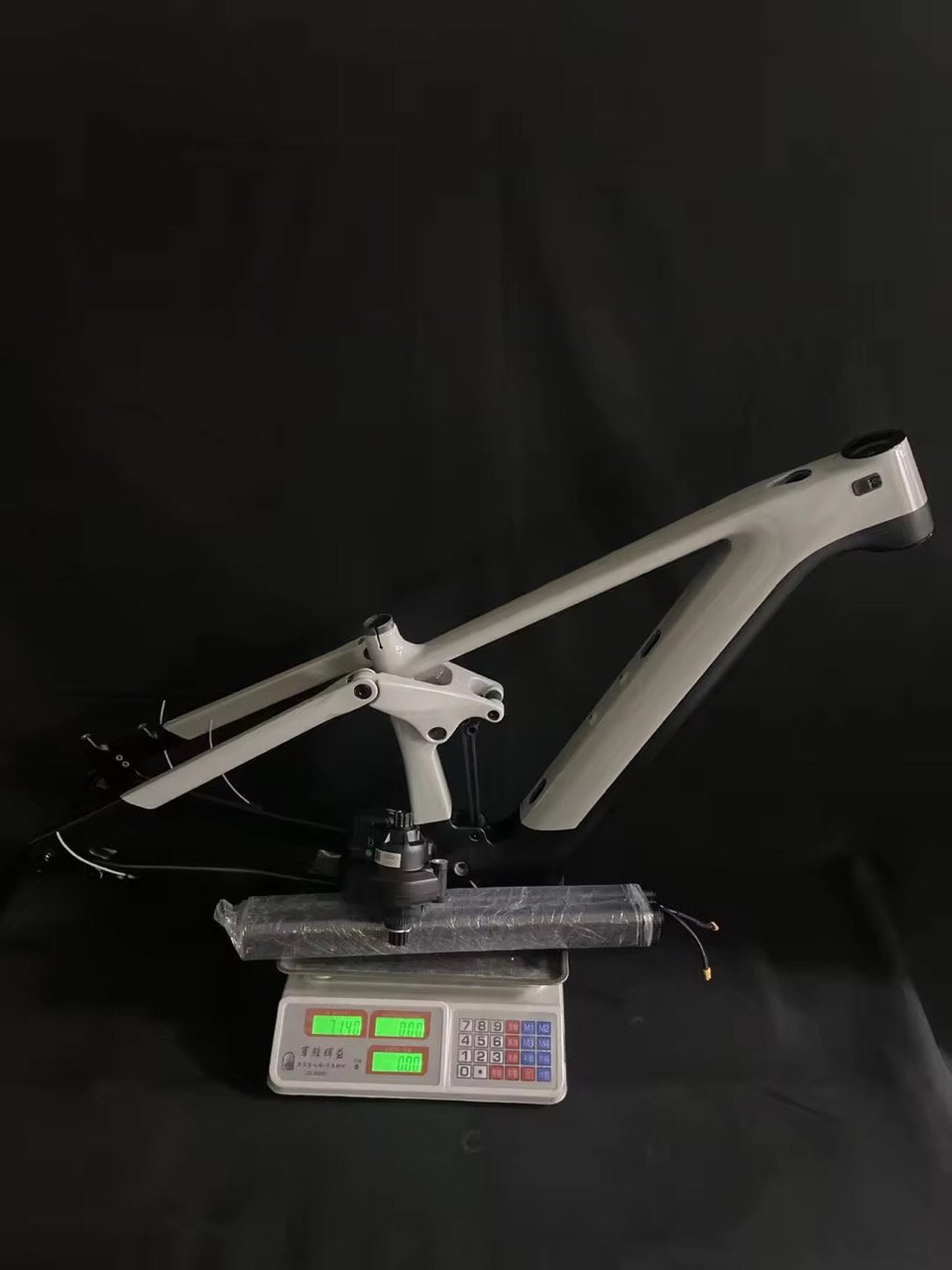

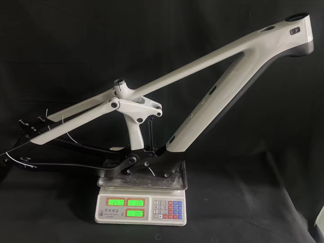

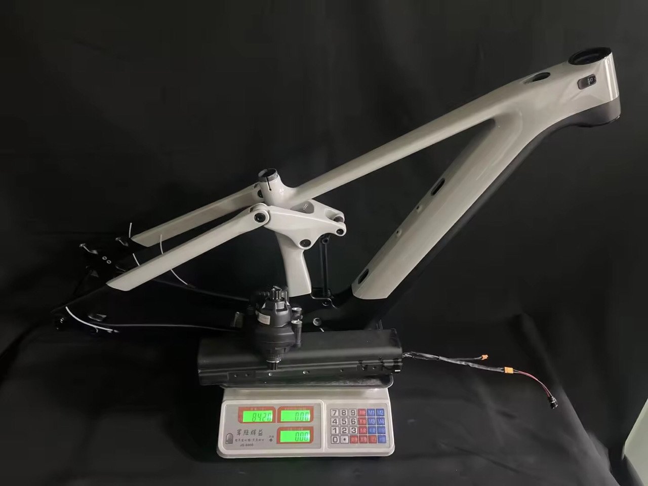

Weight of the size 15 frame and weight of the frame with a 700Wh and 480Wh battery. I'm currently unsure which battery to order. There's a difference of 1280 grams.
Those of you who have the 480Wh 48V battery, what range are you getting? I have to make a decision.

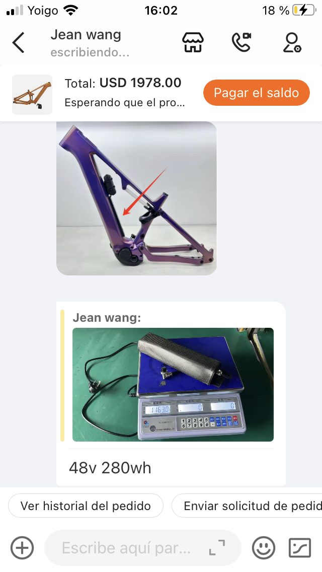

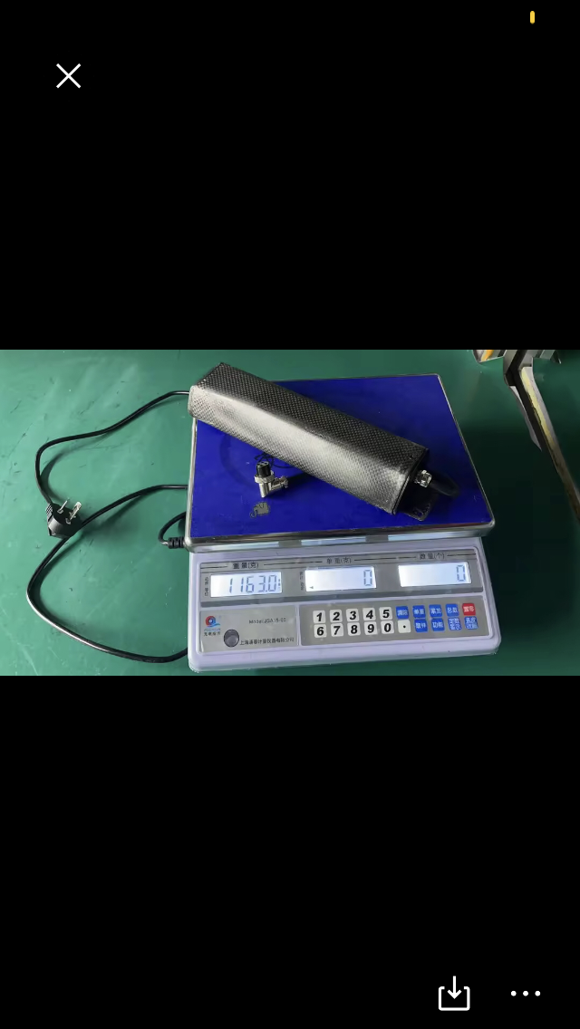

Yeah, a 280Wh battery extender would be great!,👍

(not from SZZS) Third party batteries still need a new connector to handle both the charging of the internal battery and the power-in from the external battery. The charge port on the stock CEF50 is only designed for charging at 2 amps. Not enough to supply power to the motor.

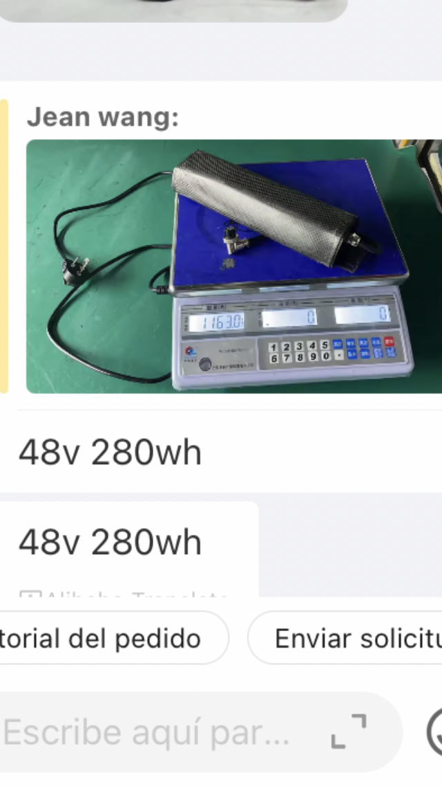

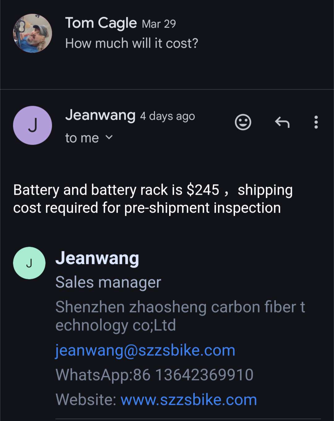

Anybody in the know have more information on the SZZS specific battery extenders.
I'm wondering about cost, availability, and integration for both 36V and 48V systems.
Also, what is Jean Wang's email address again....it's been a long time since I contacted them. 😁
Thx🍻
34% tariffs put on Chinese goods in the US at midnight tonight.
Damn! SZZS was putting out their 36 V extender battery(280? Wh) next month.
Was $245 USD. X .34 = $83.3 more for $333.3 total 😜.
Are you sure its only 2A? How it's possible, if they selling CEF50 with 4A chargers ?
My CEF50 came with a 2amp charger. Even 4 amps would not be enough to run the bike. 500w/48v=10amps
