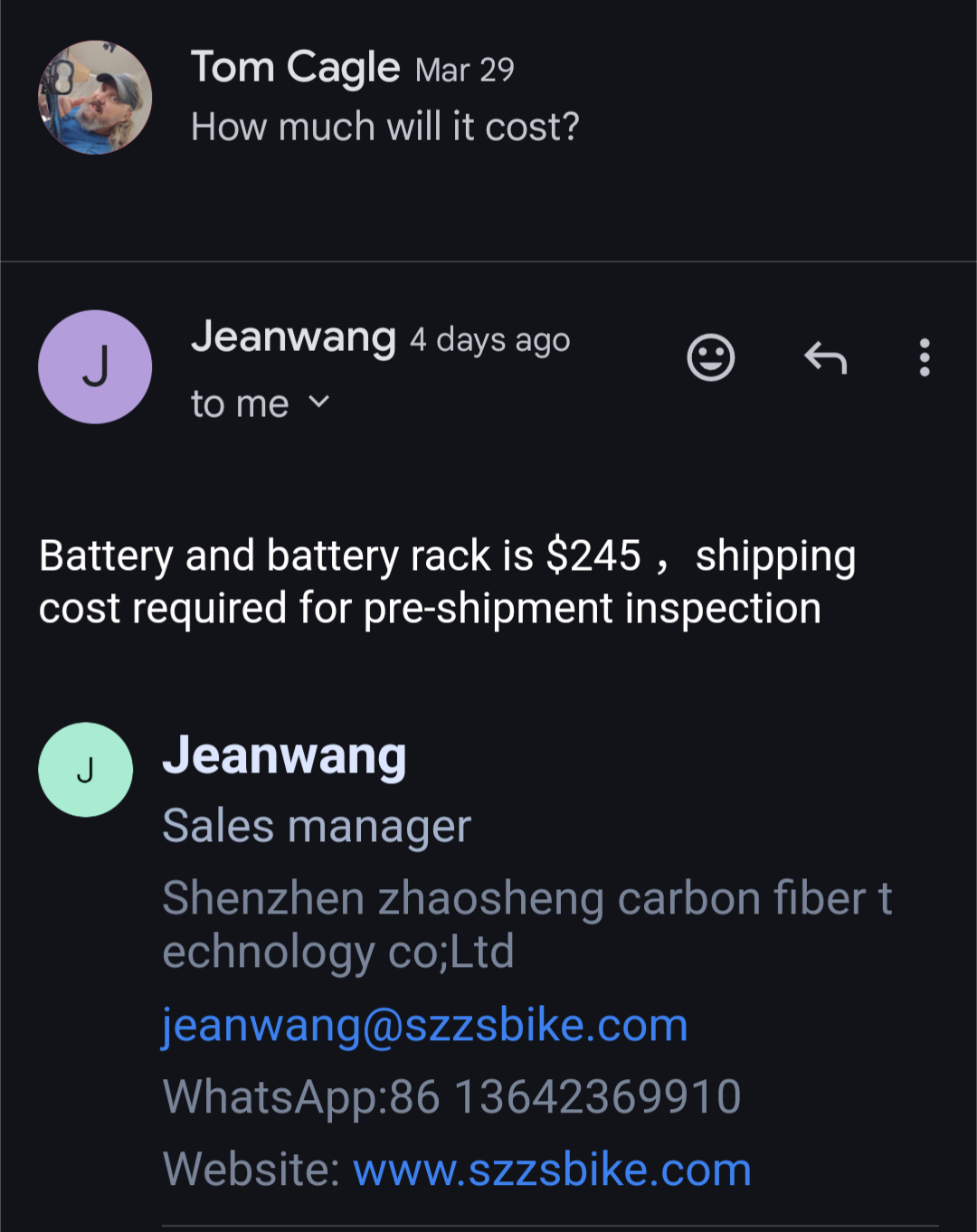

Damn! SZZS was putting out their 36 V extender battery(280? Wh) next month.
Was $245 USD. X .34 = $83.3 more for $333.3 total 😜.
Granted still cheaper than the big boys like Specialized and Trek etc...but still💸💸💸!
Thanks very stable genius!💩
Well, now there's a ludicrous 104% US tariff on most Chinese goods. So, currently a whopping $245 x 2 + .04 = $509.6 USD! 🤡💩🤯

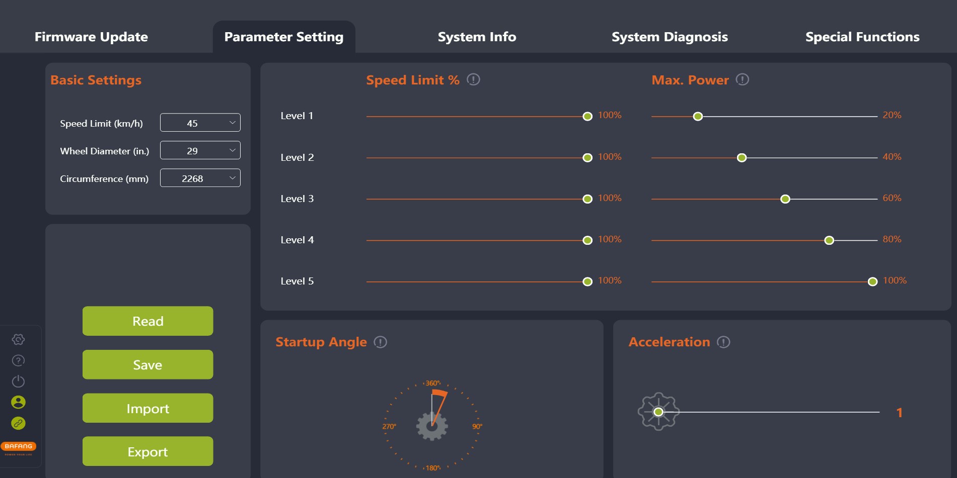

Hey y'all,
I've only logged a little under 100 miles on my CEF50 since I built it up. And while I've been MTBing for decades, e-bikes are entirely new to me. I have a couple questions and am hoping y'all can help...
1. I thought our Bafang systems were torque sensing, i.e. if you apply more torque through the cranks, the motor will provide more torque. However, that doesn't appear to be the case. It seems that when the motor kicks in, it just provides a fixed level of power (based on my setting). It seems like it's all or nothing. Is this system torque sensing or not?
2. I have the BESST Pro tool, but have some questions. The parameters are pretty straightforward and I've altered them to my preferences. However, I have a question about the "acceleration" feature and what it changes. Is this essentially the steepness of the curve from zero to full power (full power being defined by the bar-mounted controller)? For example, at acceleration level "1", maybe it takes 2 seconds of pedaling to reach full power and at level "8", it only takes 0.5 seconds. Is that accurate? I've tried both ends of the range, but didn't notice a difference on the trail. Despite the image, I have it back up to "8" and will try it again today.
3. At lower RPM/cadence, the motor seems very unresponsive. Once up to speed it feels as expected. But if my cadence drops a bit going up a climb, it gets disproportionately difficult to pedal....like the motor isn't helping much. I've changed my riding style to downshift more than usual. I've also experimented going from my 155mm cranks back to 165mm to get more leverage, but I don't think it really made a difference. It seems like there is a minimum cadence for the motor to kick in and that minimum may be higher than my typical cadence. This would be odd because my cadence is usually pretty high.
Anyway, sorry for the novel, but any help would be much appreciated!
Tommy
Well in general, the M820 motor is definitely a higher cadence motor as compared to my M600-120Nm. I'd say climbing in turbo takes 85-95 RPMs with the smaller M820. I'd guess 74-85 RPMs with my M600. RPMs are based off my stationary spin bike I ride 3x a week where I can see them in real time, so it's my comparative perspective and best guess.
