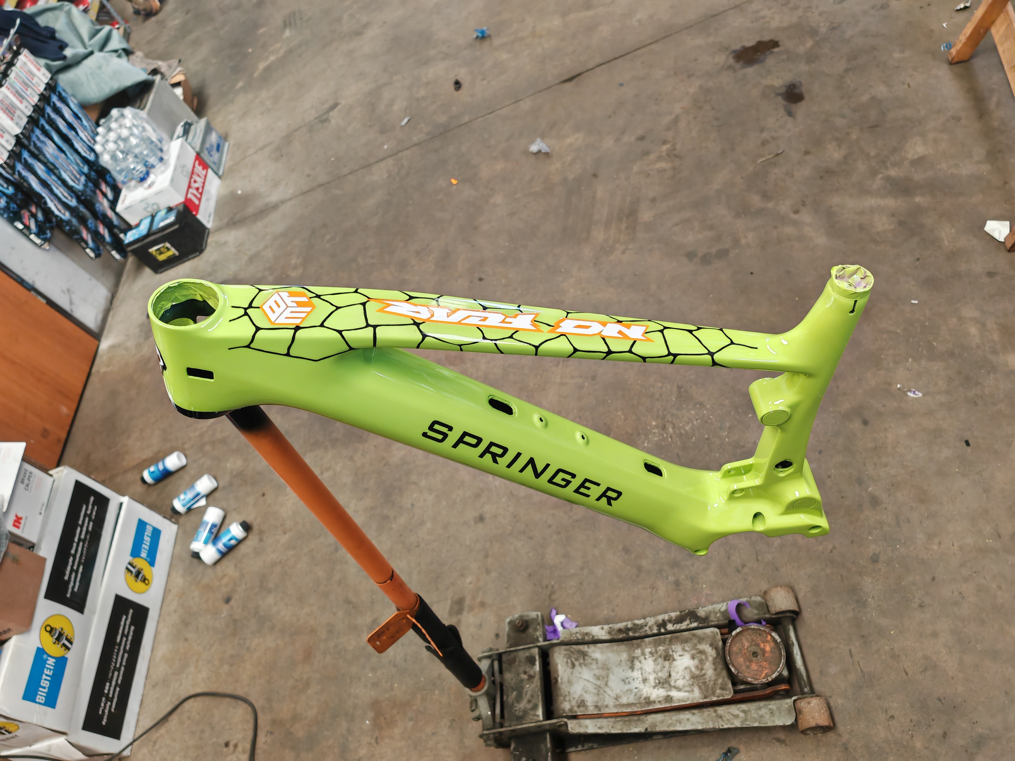

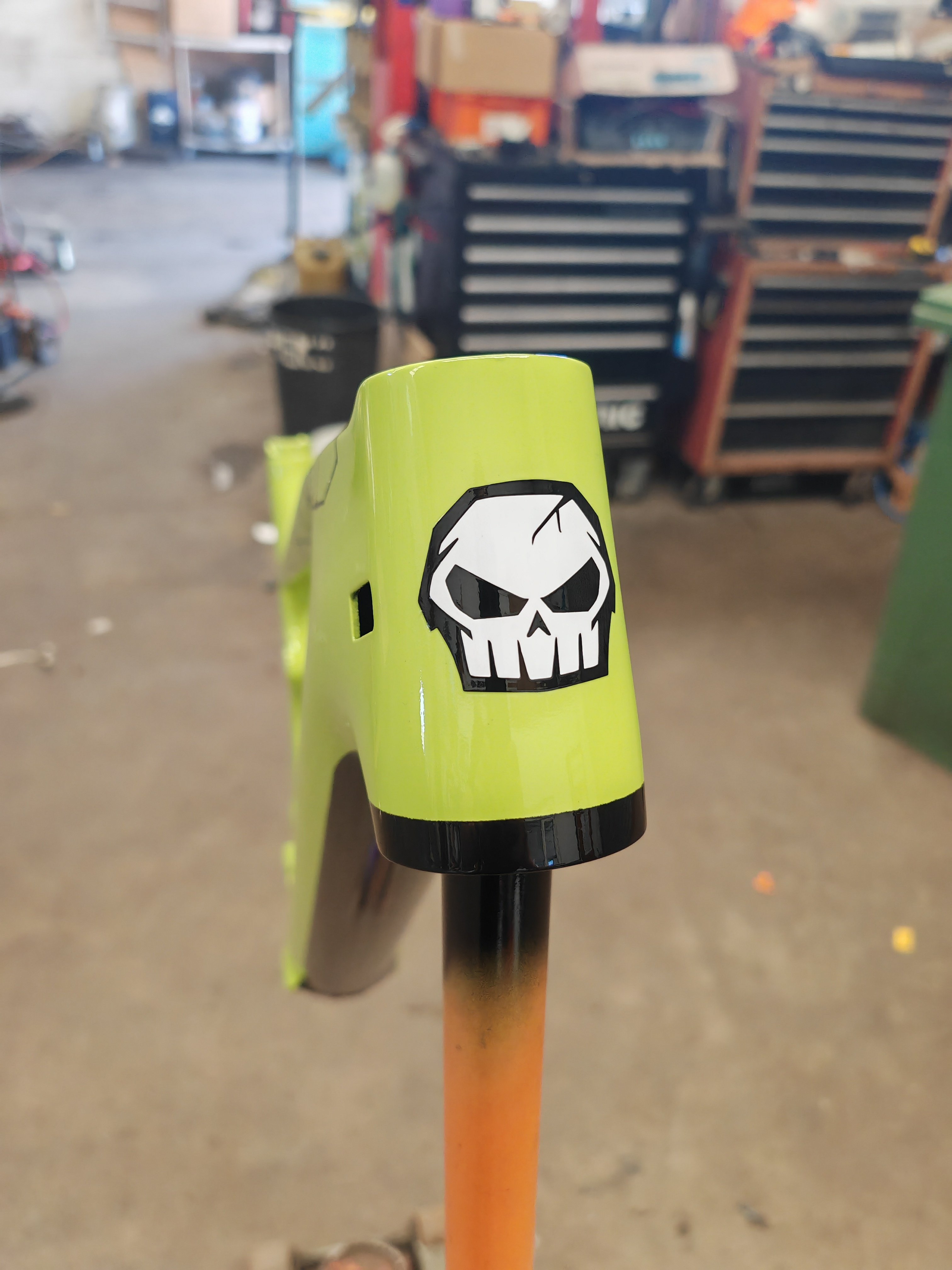

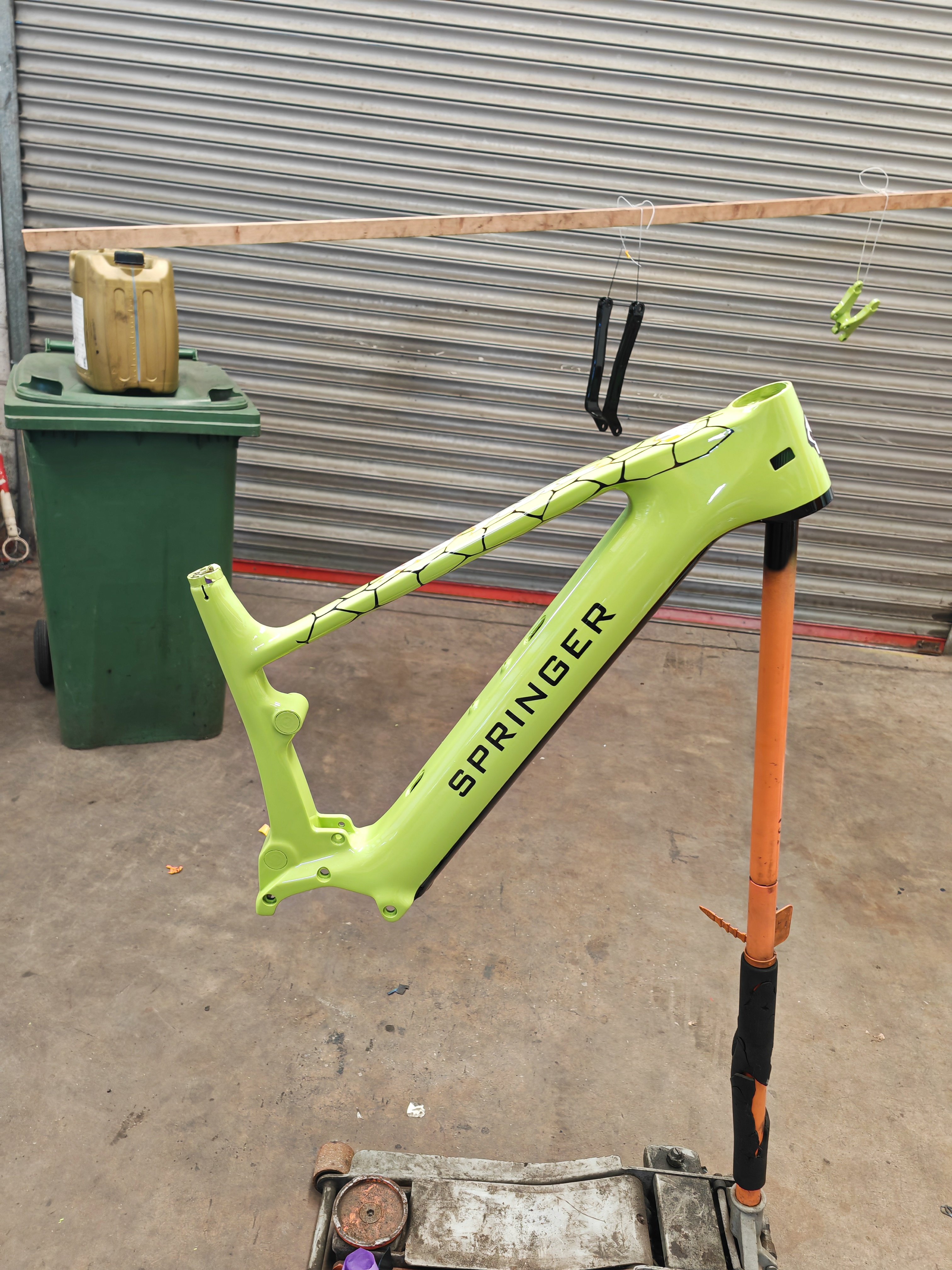

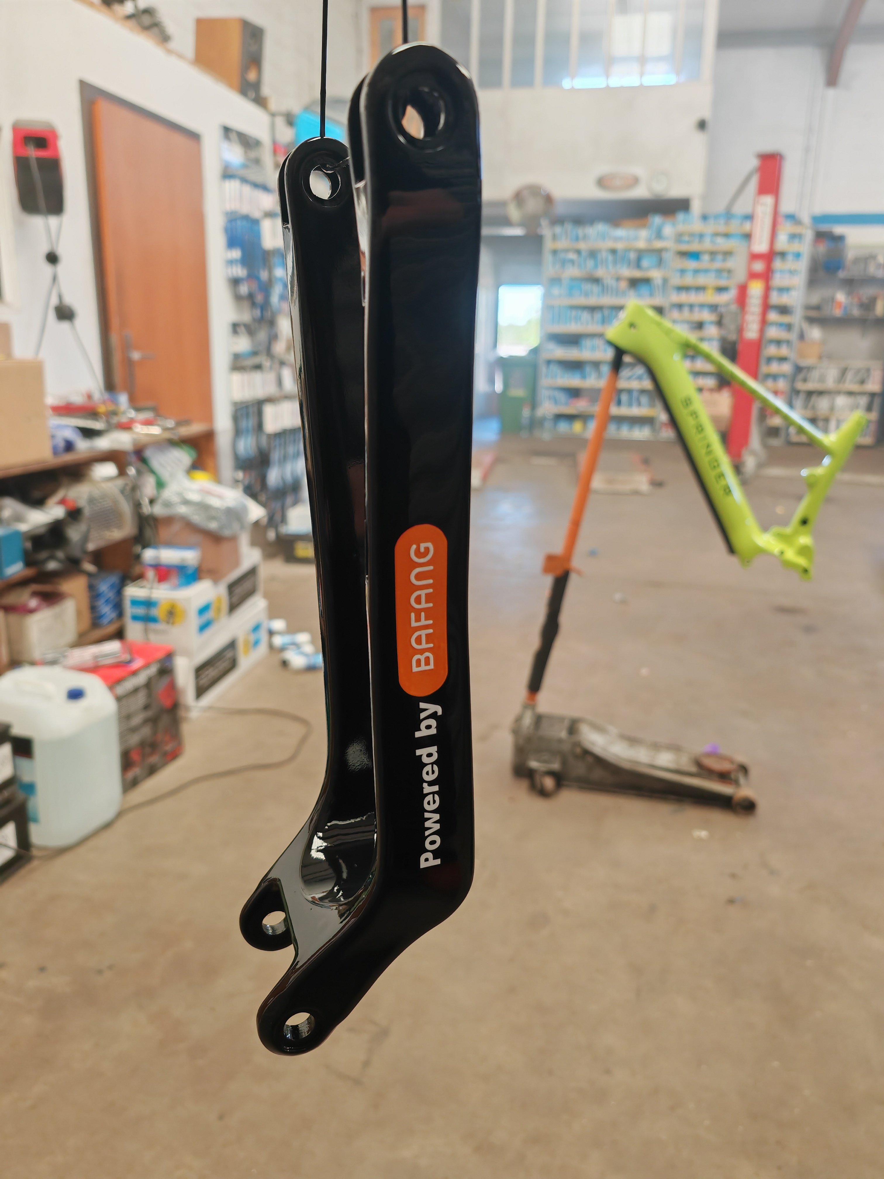

Hi. I am going to assemble frame this week, just wondering about linkage bolts, use supplied ones or put steel bolts instead and forget about further problems. Bought steel bolts just in case anyway.
Thanks
IMG_20250517_115450.jpg IMG_20250517_115503.jpg IMG_20250517_115512.jpg IMG_20250517_115529_edit_428482143452639.jpg
I don't think anyone has broken a bolt. They can loosen up and fall out if you don't check them, Use lock tight.
I mainly upgraded to Ti custom bolts for the bling factor and I just was unsure in the beginning. I had the main pivot bolt snap but it was 10 mm too short when they sent me one of the early frames.👑

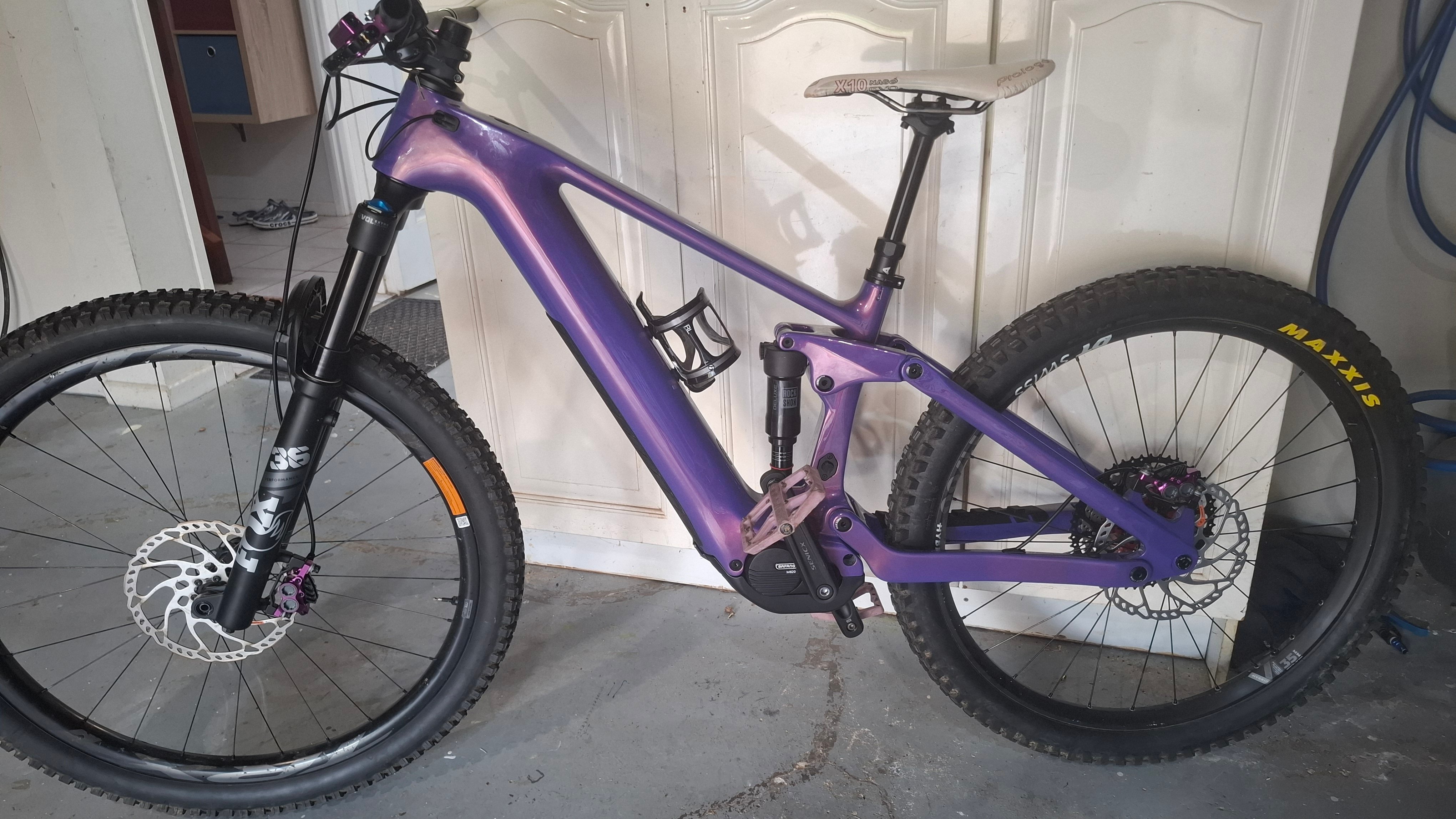

Hi everyone,
Just finished building my cef50 small frame with 27.5 wheel.
Bike looks great and handles very nice.
The Bafang not so good.
I know it's a low powered motor but this motor is really slow even in boost. I think I can climb faster on a pedal bike.
I've ridden lots of ebikes and small motor ebikes but all had more power than this.
I've downloaded the Bafang go app
And tried to adjust the modes but it says can't connect.
Any ideas would be appreciated
Thanks

Try to calibrate torque sensor. It may help. My also had also very bad support. But as I was reading on internet I was thinking that is ok, as everybody said that don't has a lot of support. Turns out my motor was faulty. They replaced with new one and now fells like a new bike. Also motor is really powerful.
You can calibrate the torque sensor on M820 motor ?

Show us your parameters. what you expect ? which motors references you have ? and with which do you compare it ?
Off course M820 is less powerfull than other "full" motors (bosch CX, shimano, M510, etc..), But on paper more (never compared) than other "light" motors (TQ, fazua, +-= bosch SX ?). For my case (100kg), i can do the same tracks than full motor, for +- 1/2 less consumption (10Ah onwith M820, 17Ah with M510). Just less quicker and with walk mode on long climb upper 15%.
With both motors I have 2 options:
-Position sensor calibration
- Torque calibration
Yes, but at this time torque sensor calibration don't work for M510. but i haven't plugged it since long time, i will seen later 🤔

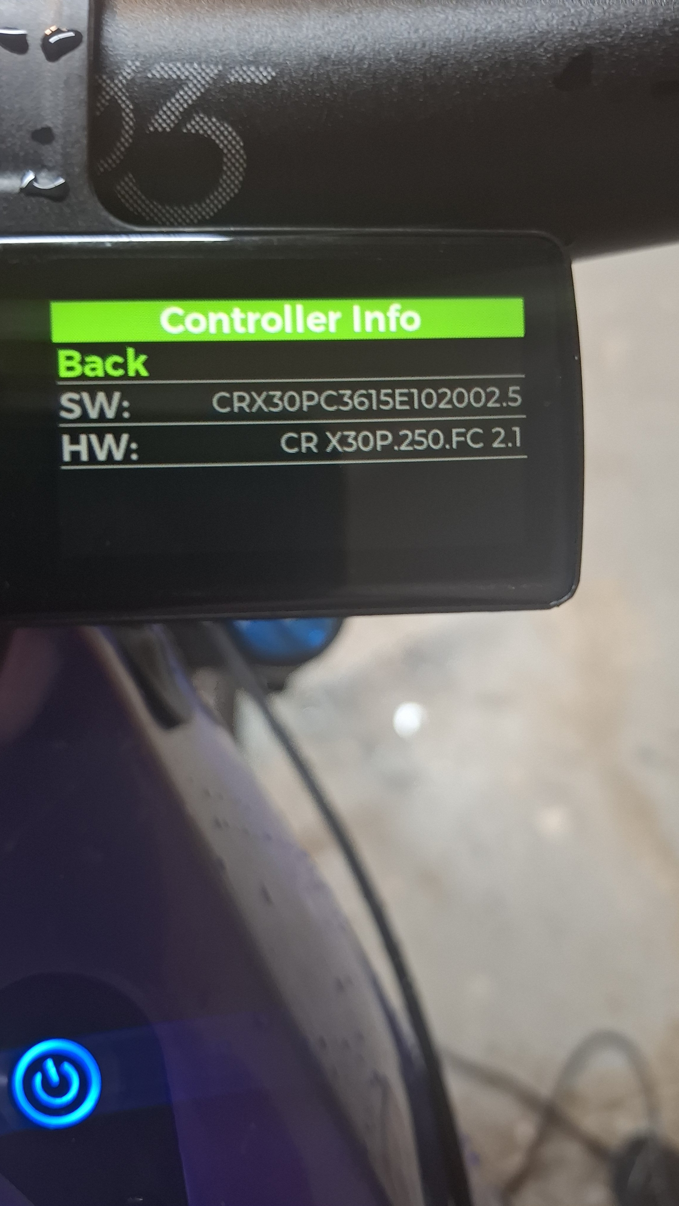

Hi I also had the same problem as you, little assistance you have to change the Firmware, this is for E-road, you have to put an E-Mtb Firmware, you will see a lot of changes, it will give you a lot of assistance, go to the Firmware for M830 forum, you will find the right one
Which version do yo use?
Thanks everyone.
This is really over my head my I.T skills are very basc, but I'll do some reading over the next few weeks.
I emailed Jean today and she is getting Bafang to contact me.
Sound like I'll need to buy the besst tool or fined a local ebike repairer with one.
I'm using CRX30PC3615E102002.5
if you have beest tools install what I posted you will see that it goes much better also with App bafang go+ vers.2.2.0 you can change the parameters as you like plus you can store 4 settings for your engine
Where I can find this app bafang go+ vers.2.2.0
