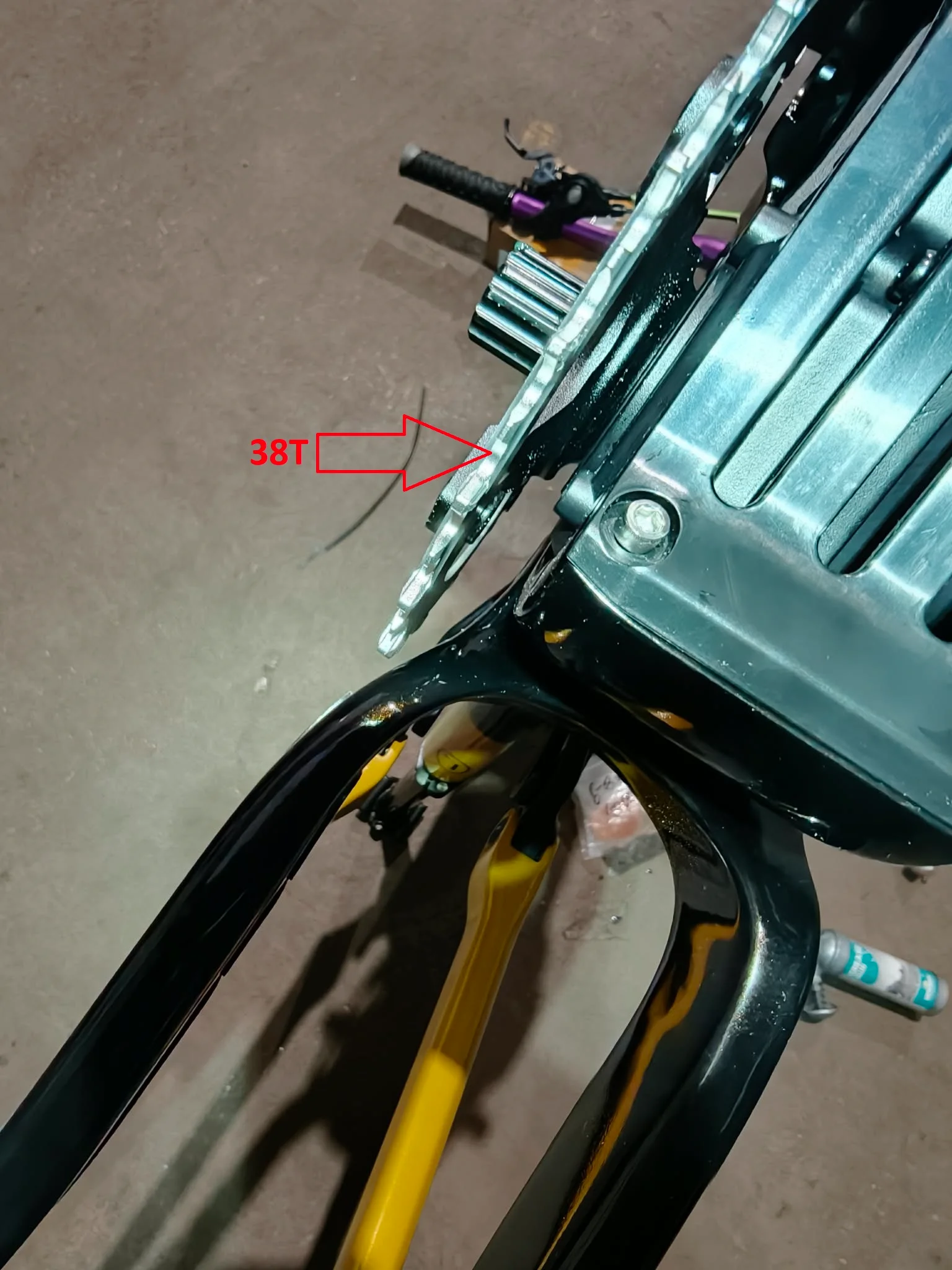

In a very similar CEF55 frame I am runnig 38T front sprocket.
Due to excessive play in lower/rear motor mounting bolt, had to put 0,7mm thick distance at non drive side - so motor moved about 0,7mm to the right. Also I have chamfered sprocket a bit on inside so now have about 2mm of the clearance to the back arm.

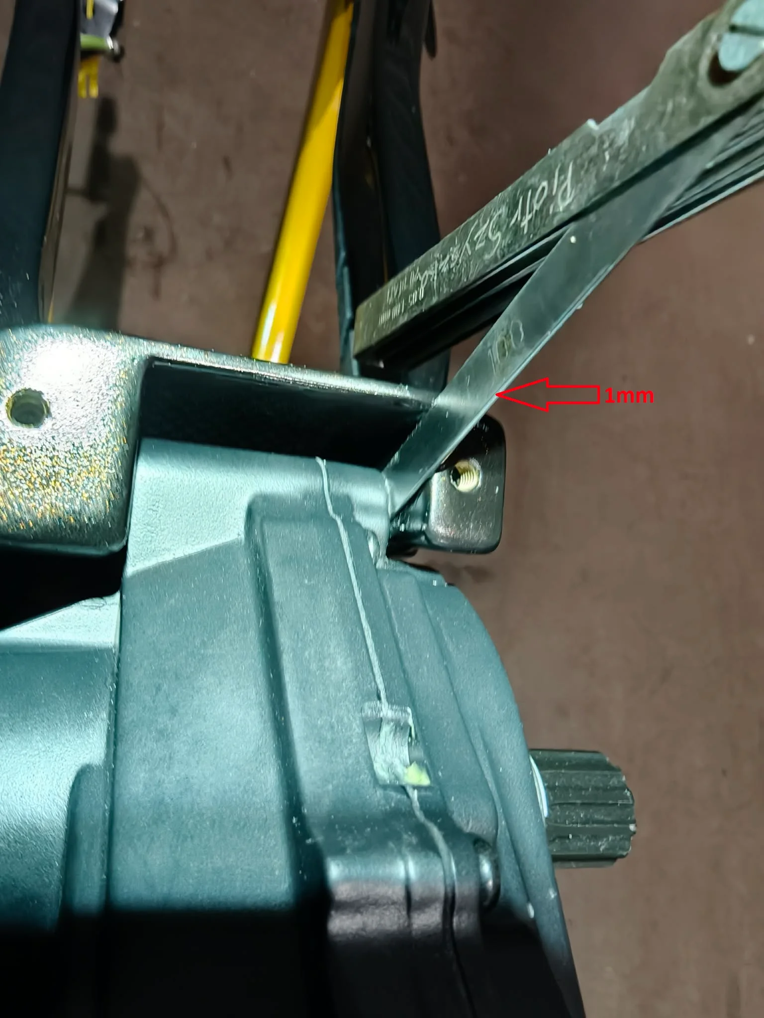

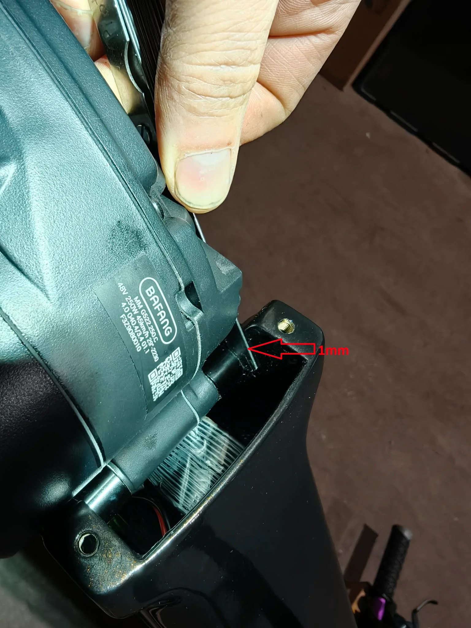

Small update, 38T chain ring fits OK but there is one thing that can not be overlooked.
I am surprised that so many frames are assembled and nobody reported excessive play in the frame motor mounting.
There is about 1mm of the gap so there are distance washers needed to putt in place (same as cef55 frame).
My advice is to place them on non drive side so the motor shifts slightly to the right - that will increase clearance in between the lower arm and 38T sprocket. If you do not need 38T just place distance washers whenever You like.
Regards

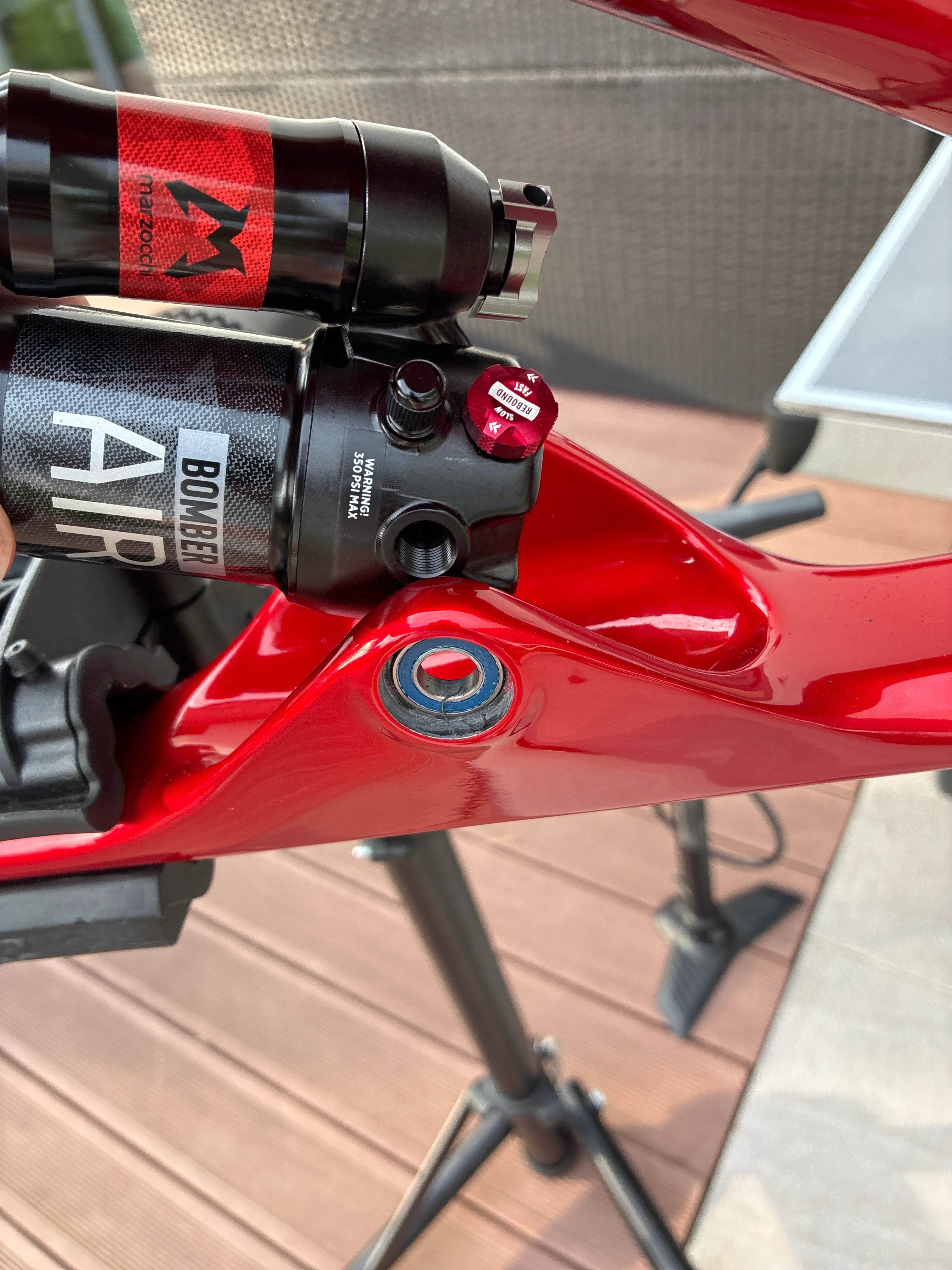

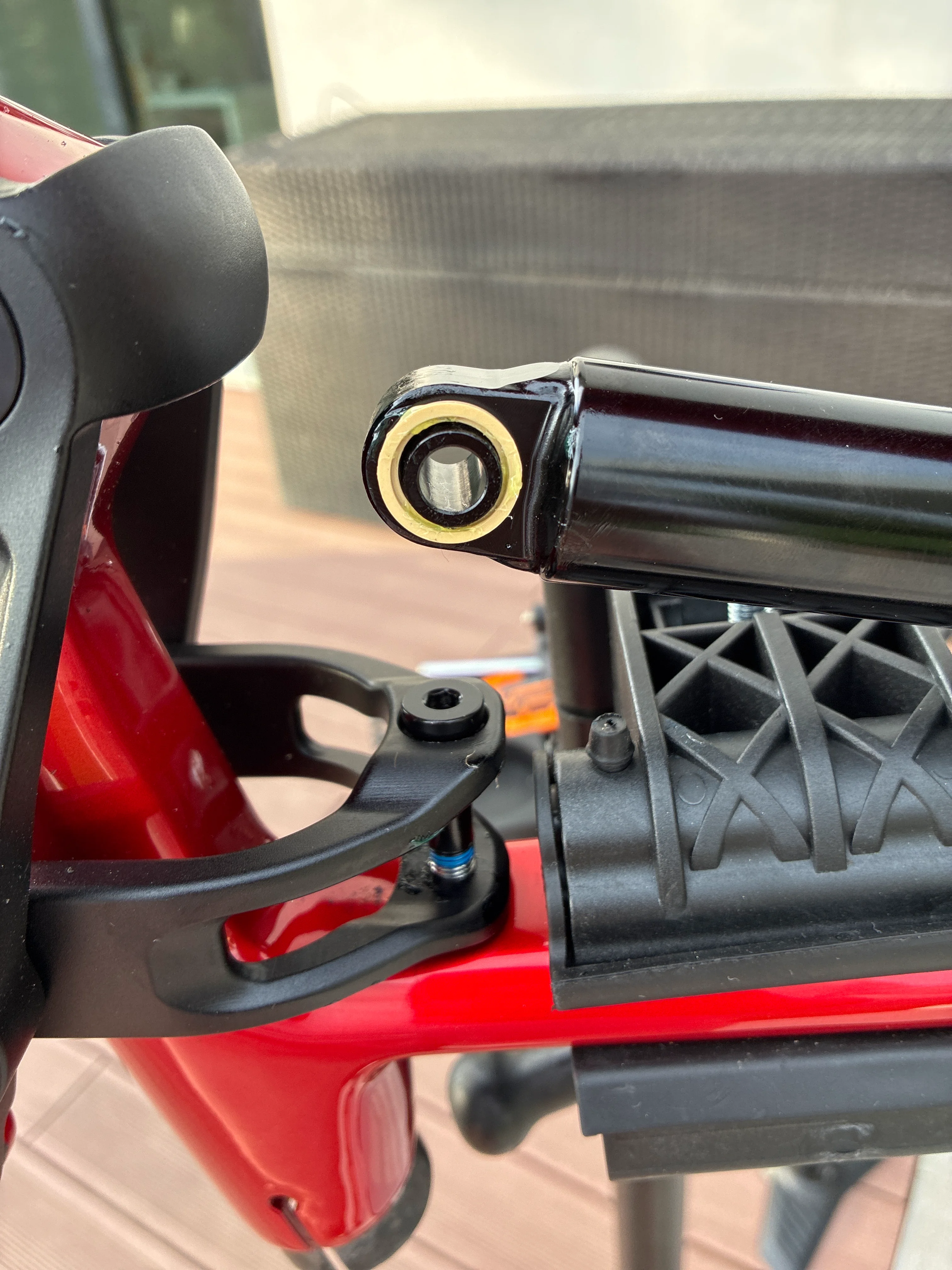

Hi mate…. so what bottom of your rear shock you got as mine is not turned horizontal like that its vertical like all rear trunion shokcs?
Mate should be able to rotate the shock to fit twist it. Most people have to do this.
