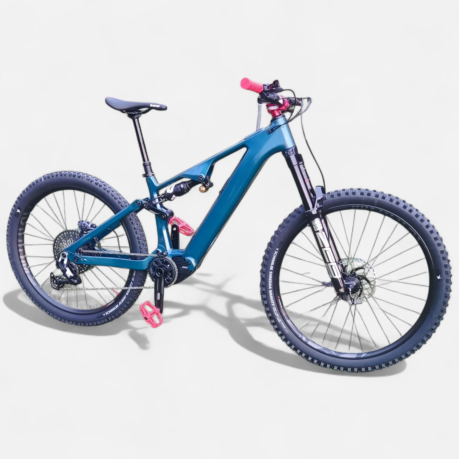

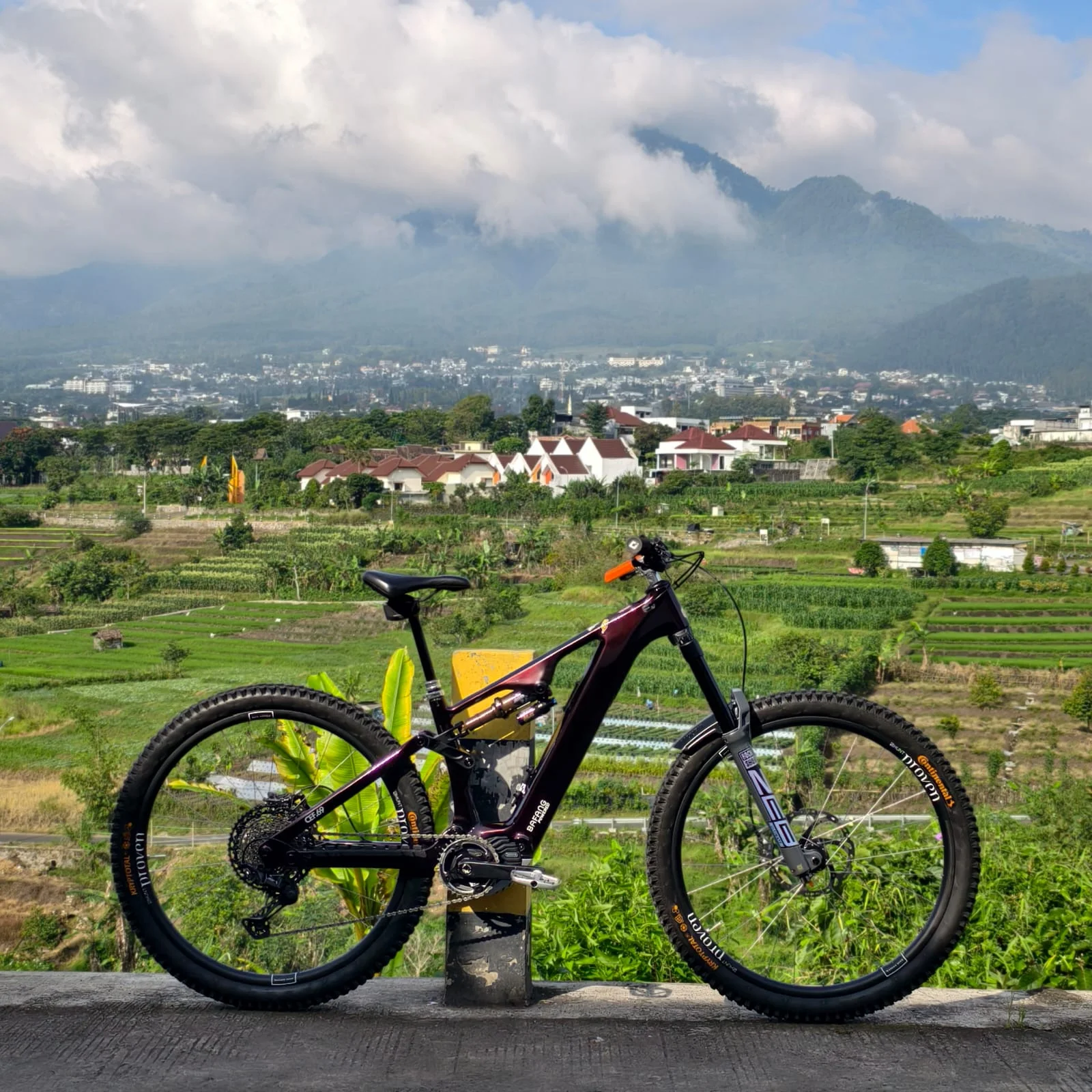

Hi guys, I'd like to introduce you to my new ebike with a CEF69 frame and M510RS motor, which I just finished assembling. Happy riding, everyone!

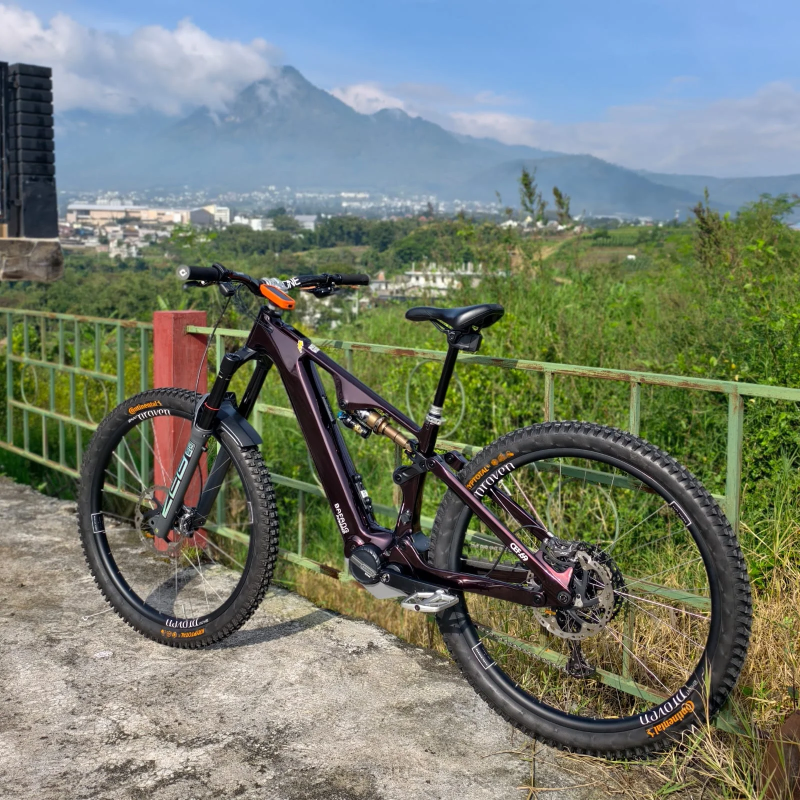

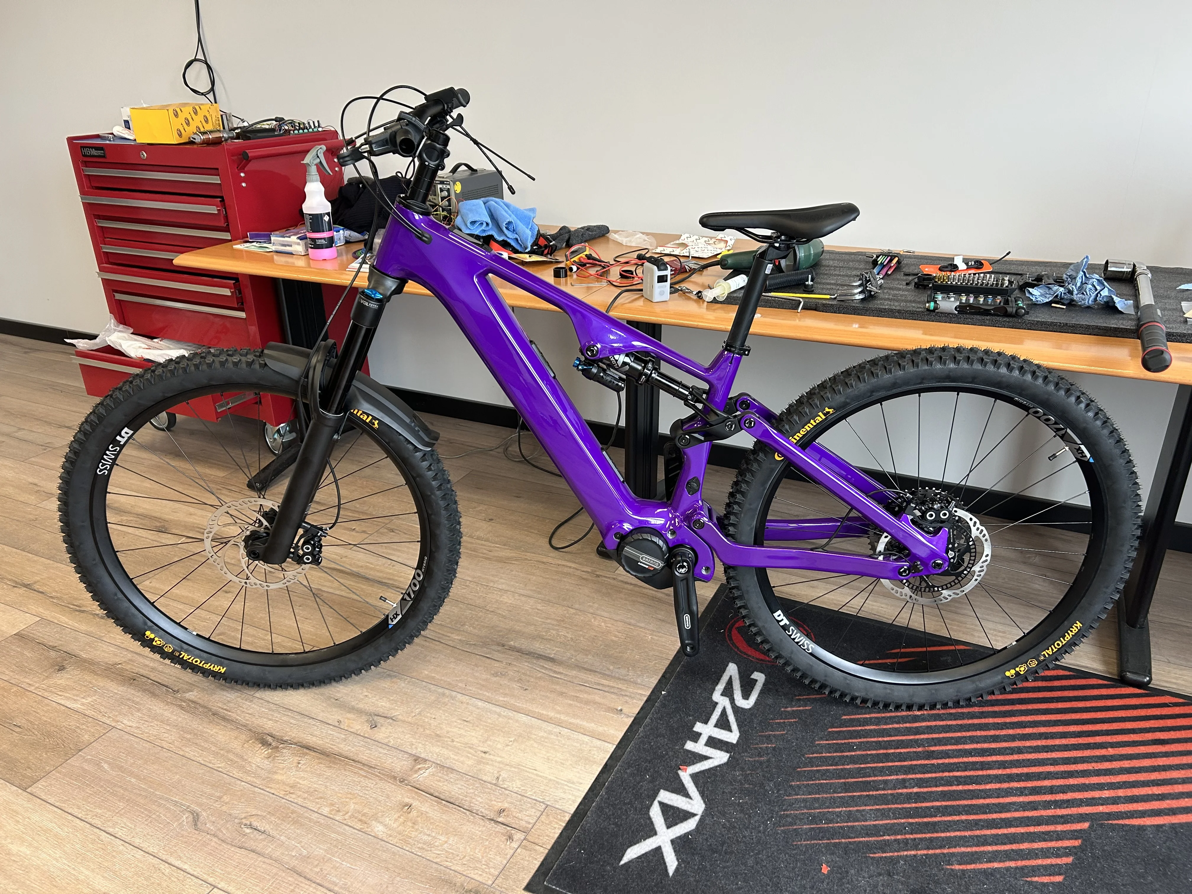

The total weight, as shown in the photo, is 23.3kg, of which 6.2kg is just for the wheels (aluminum rims, tires, liquid sealant and cassette).
The electric compartment includes the M510RS motor, an 835Wh battery with carbon case, the DPC030 display integrated into the top tube and remote control on the handlebars.
It's built quite hard, including Maven brakes, so you can easily trim the weight by adding other components, depending on your intended use.

that is a nice Lightweight weight for a m510 bike with big battery..
my latest e82 coil build is almost 27kg
carbon rims, tire inserts and front/rear coil suspension

With my carbon mullet light enduro wheelset weighing 4.5kg I'd be down to 21.6kg like for like, pretty awesome for a 110nm machine.

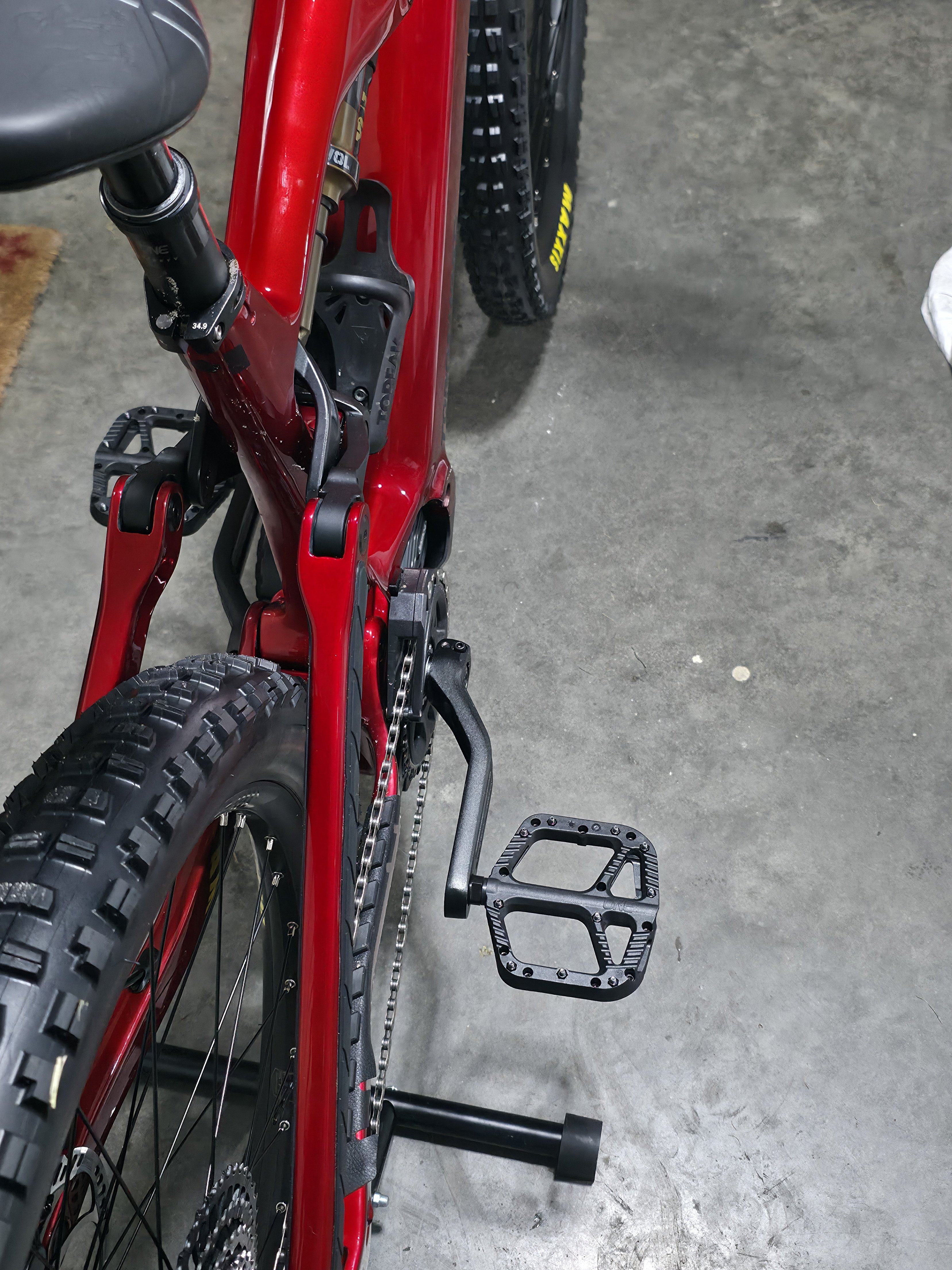

So, I got my parcel a couple of weeks back. It all looks good. They did make new rivnuts for the RS wheel speed sensor. Not to fond of it. Also, I am going to try to use the Bosch ABS sensor, so I am not going to use them.
The paint is really soft. I don’t think it got a clear coat. I consider to strip the bike again and have a clear coat applied.
Overall quite happy with what I got.

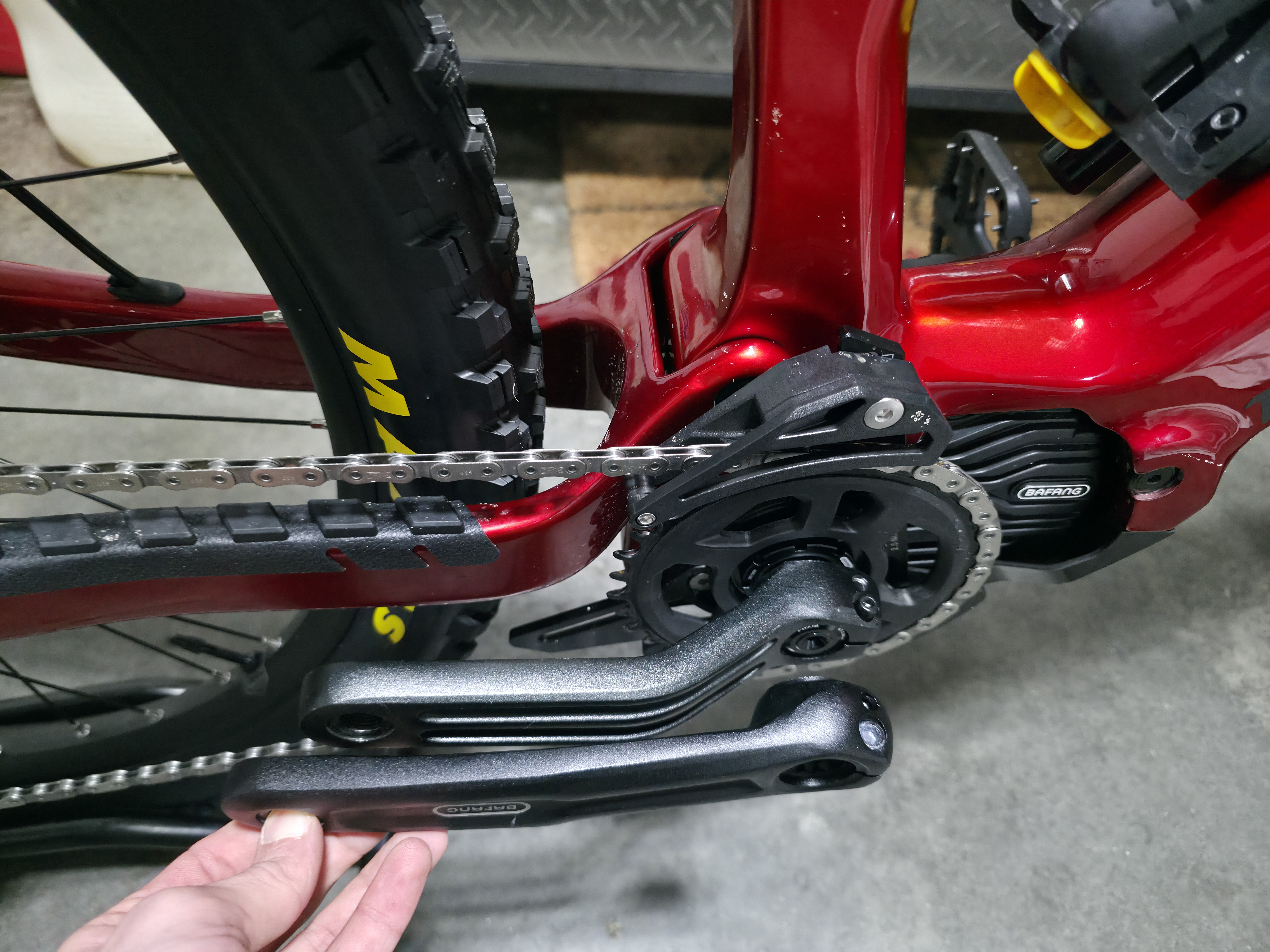

Has anyone had success running bigger than a 36T up front on this bike?
In a very similar CEF55 frame I am runnig 38T front sprocket.

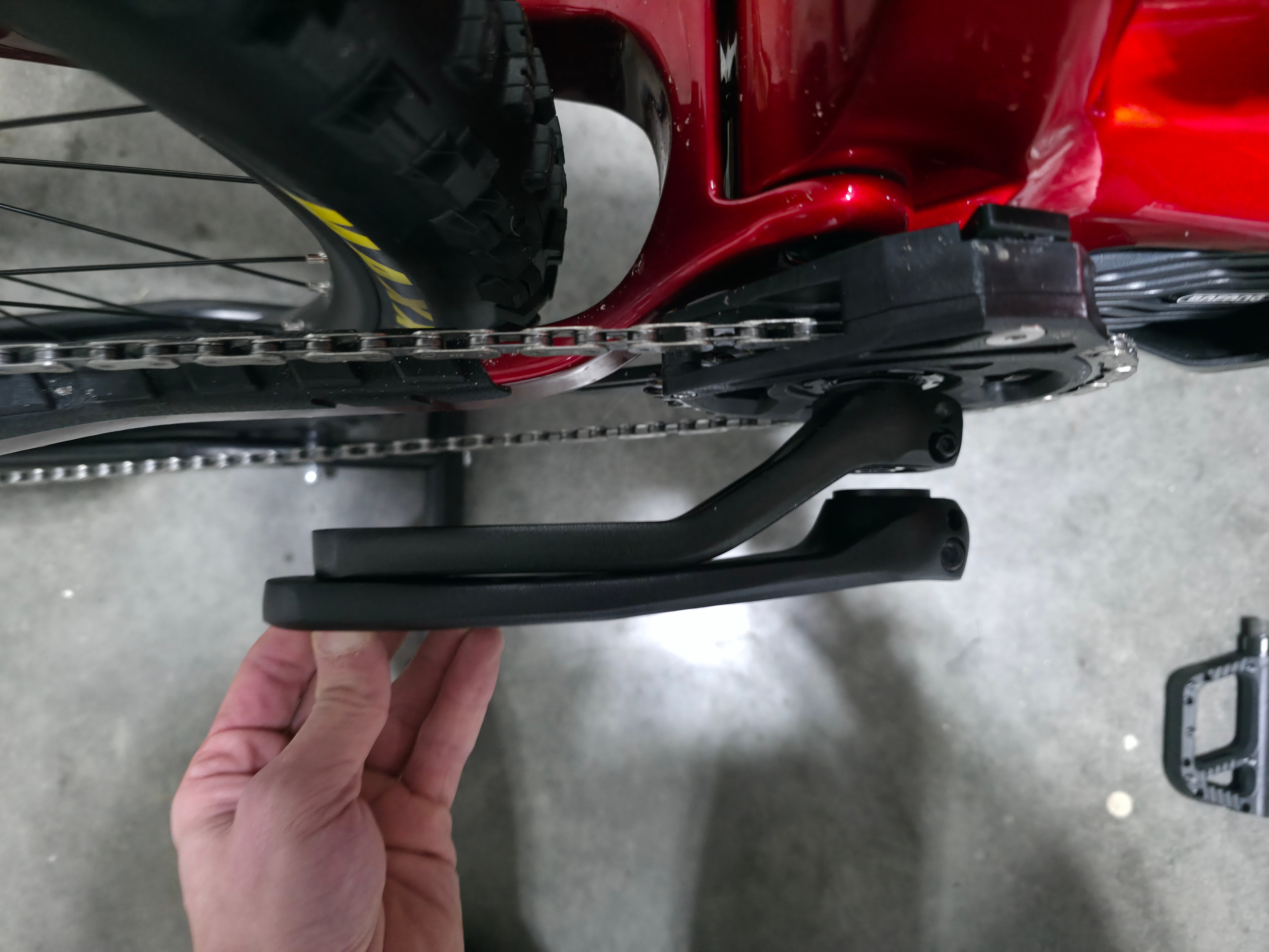

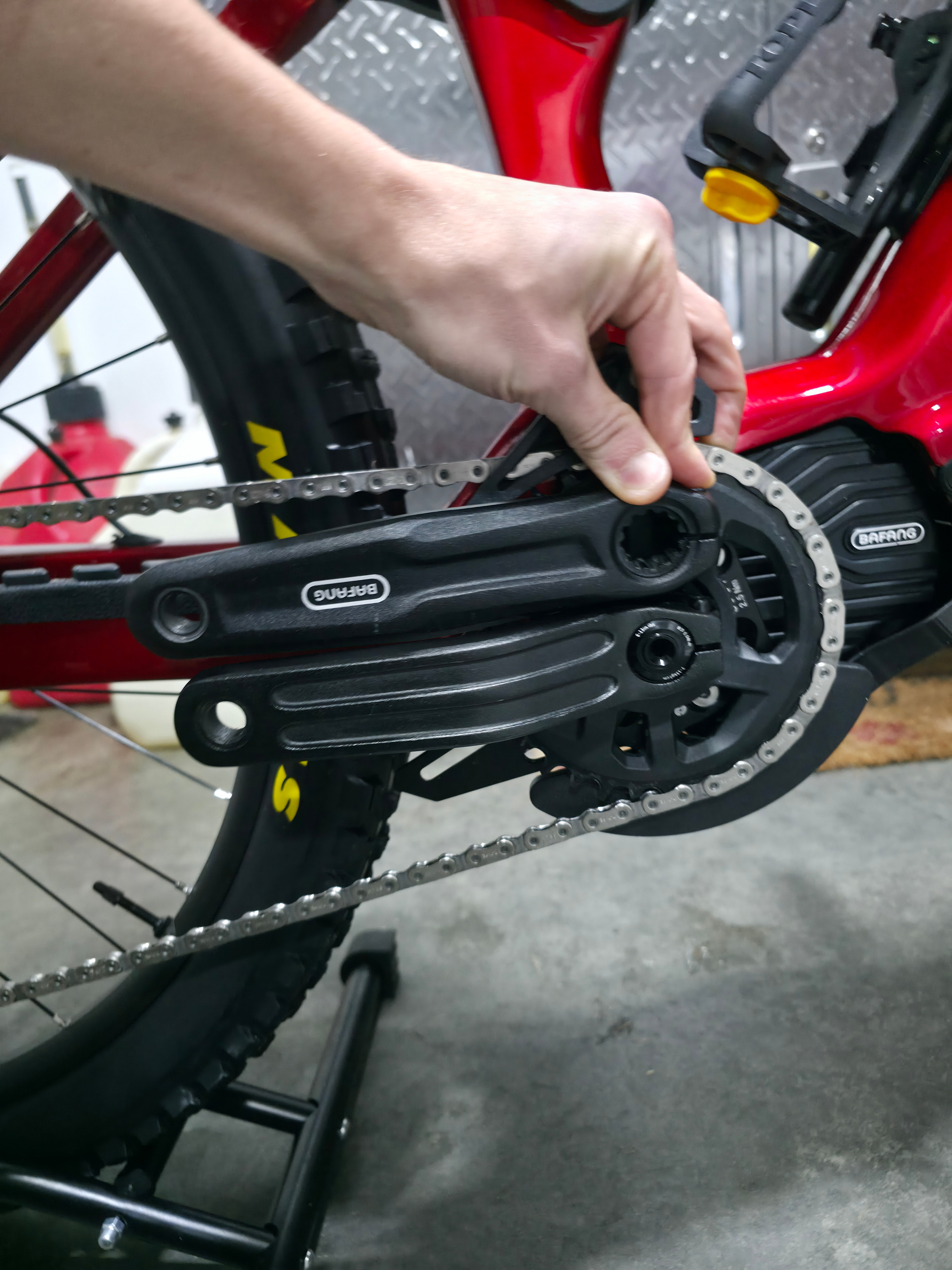

Due to excessive play in lower/rear motor mounting bolt, had to put 0,7mm thick distance at non drive side - so motor moved about 0,7mm to the right. Also I have chamfered sprocket a bit on inside so now have about 2mm of the clearance to the back arm.
