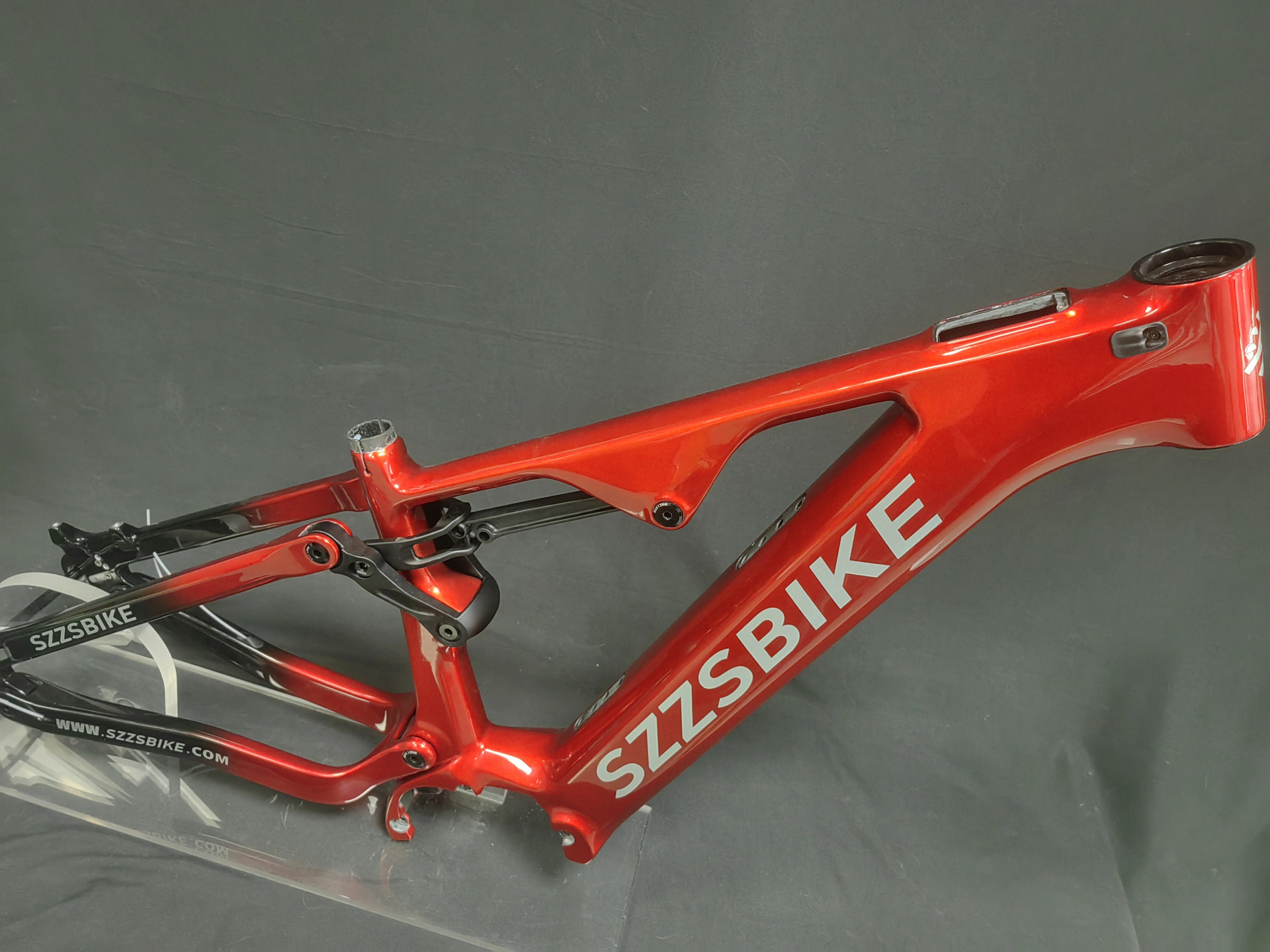

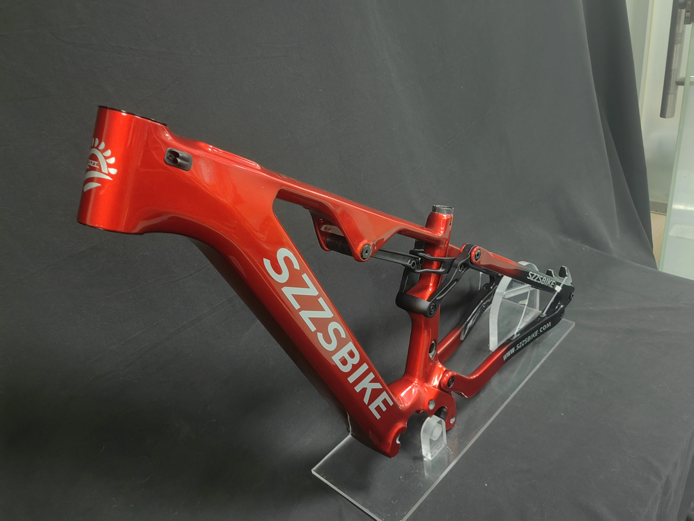

SZZS CEF69 Build with New Bafang M510 3.0 version

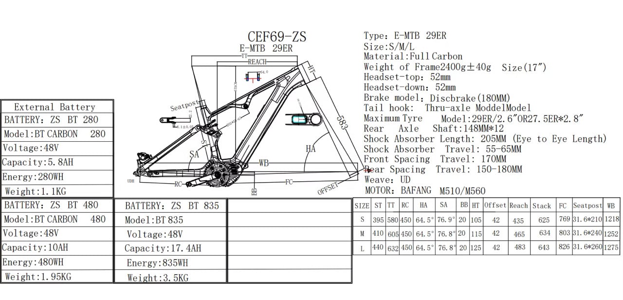

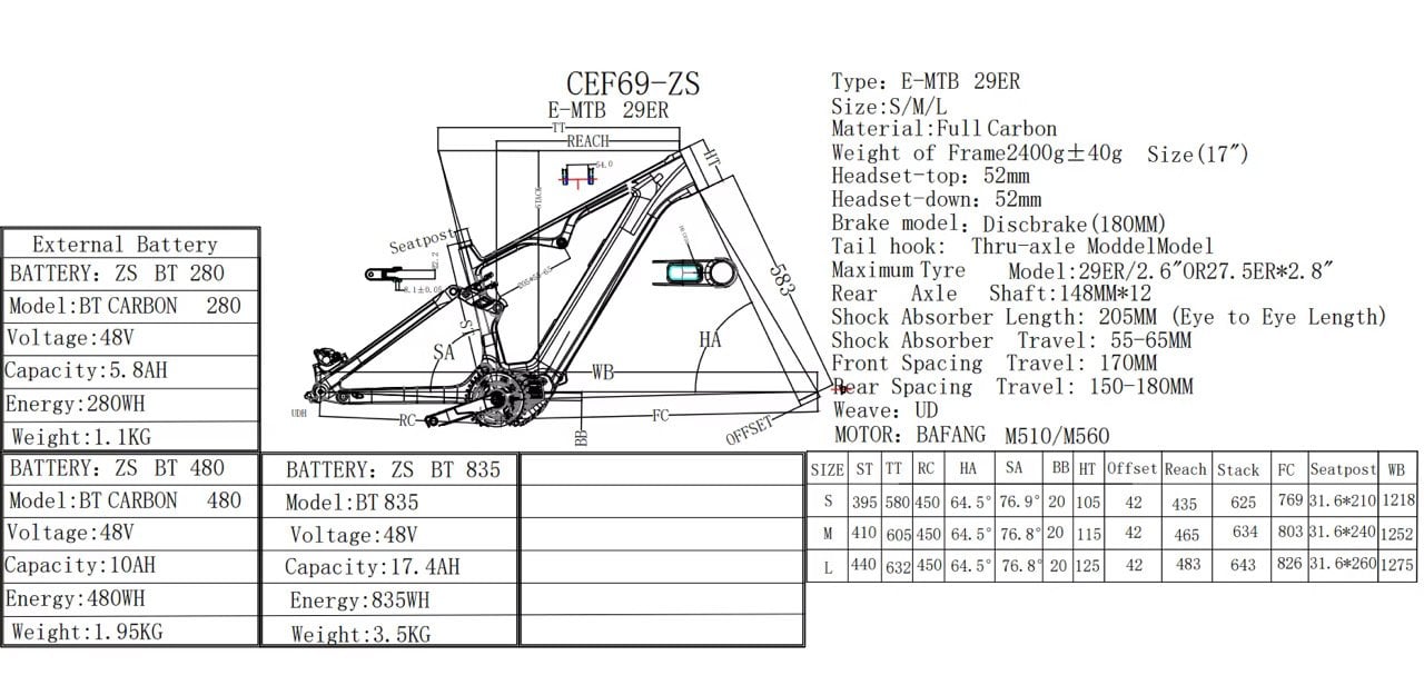

Hi! Can you tell me what size headset the CEF69-ZS is? As far as I understand, it's 52ZS/52ZS?
Geometría

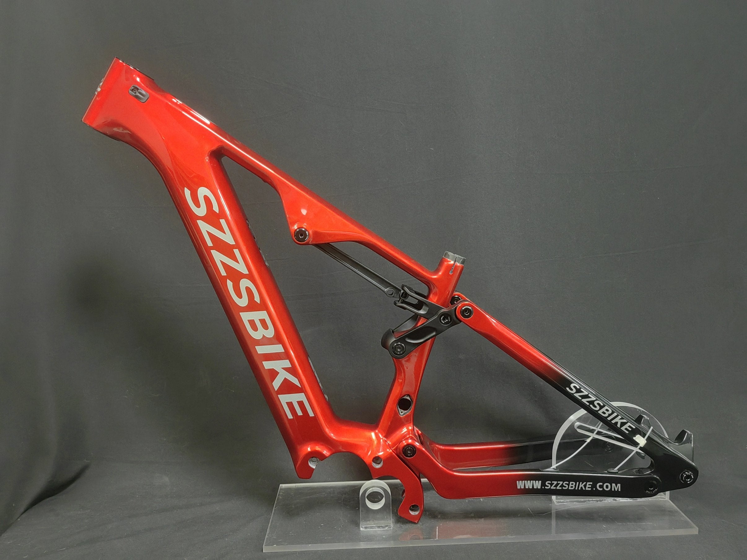

We will have it in Spain Seville for those who want to try it will carry the new m510rs

Hi guys does anyone know the spacing for the bottom shock mount? I'm going too run a rockshox deluxe and would like to know which bushing kit to order

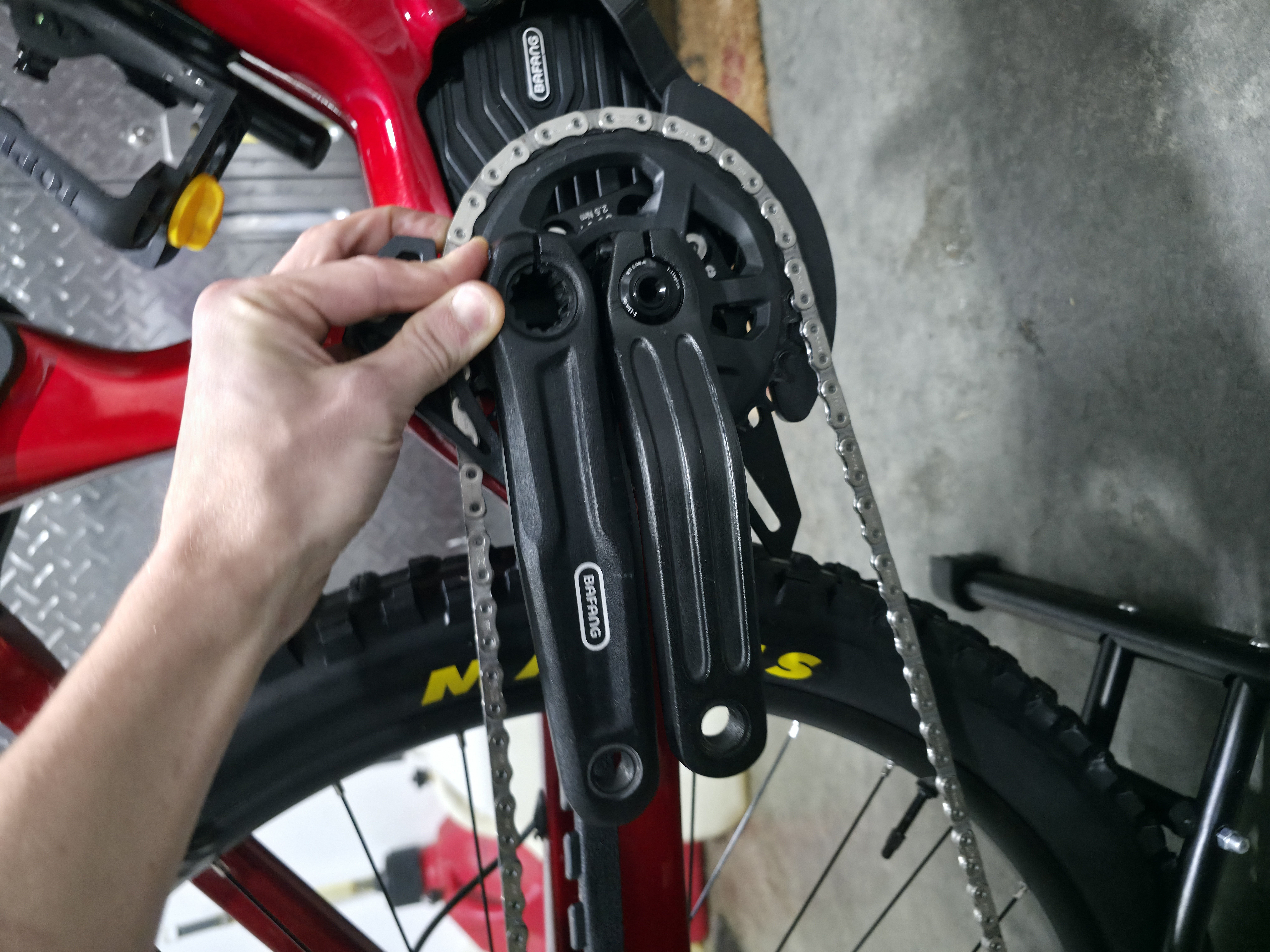

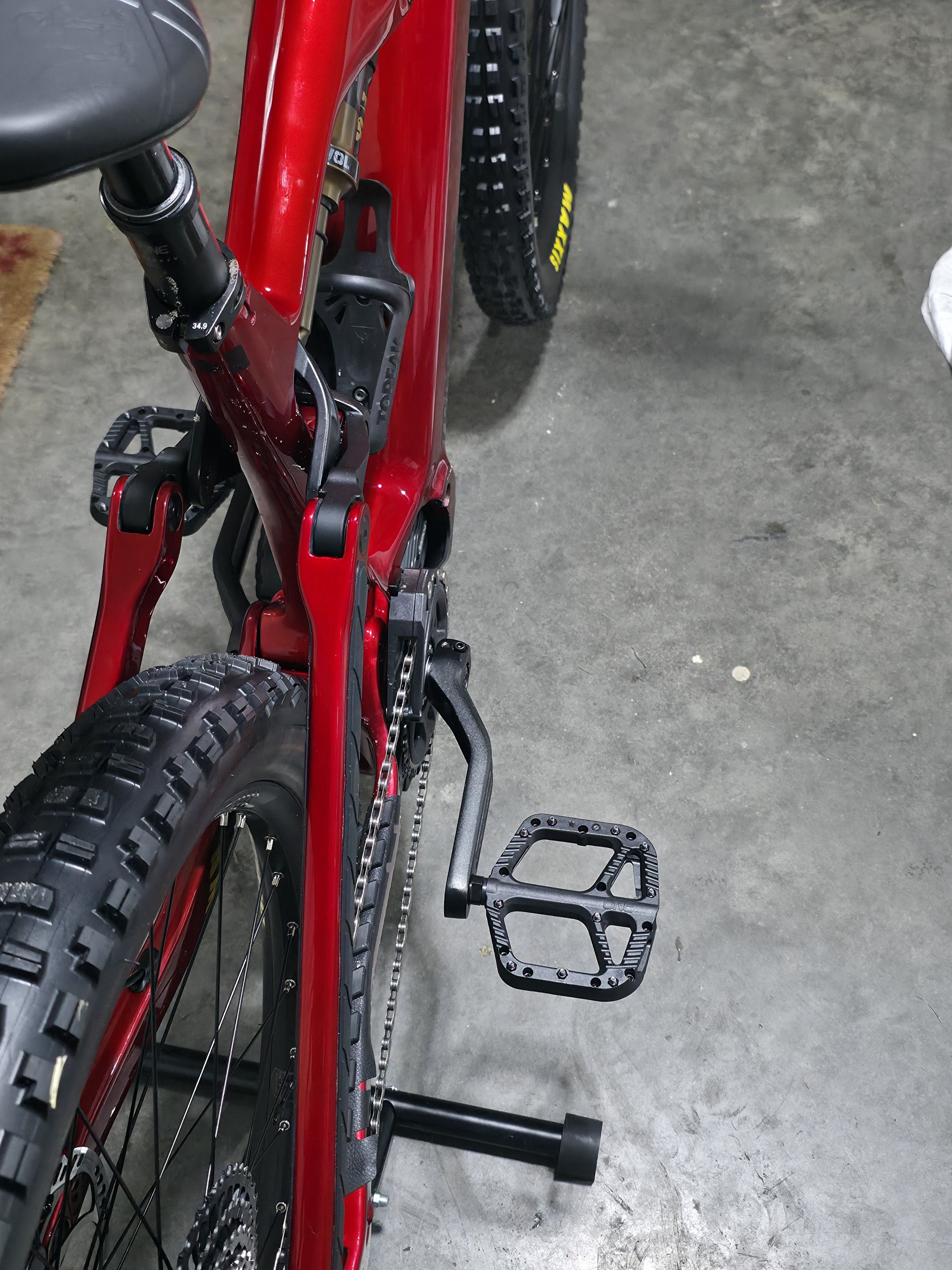

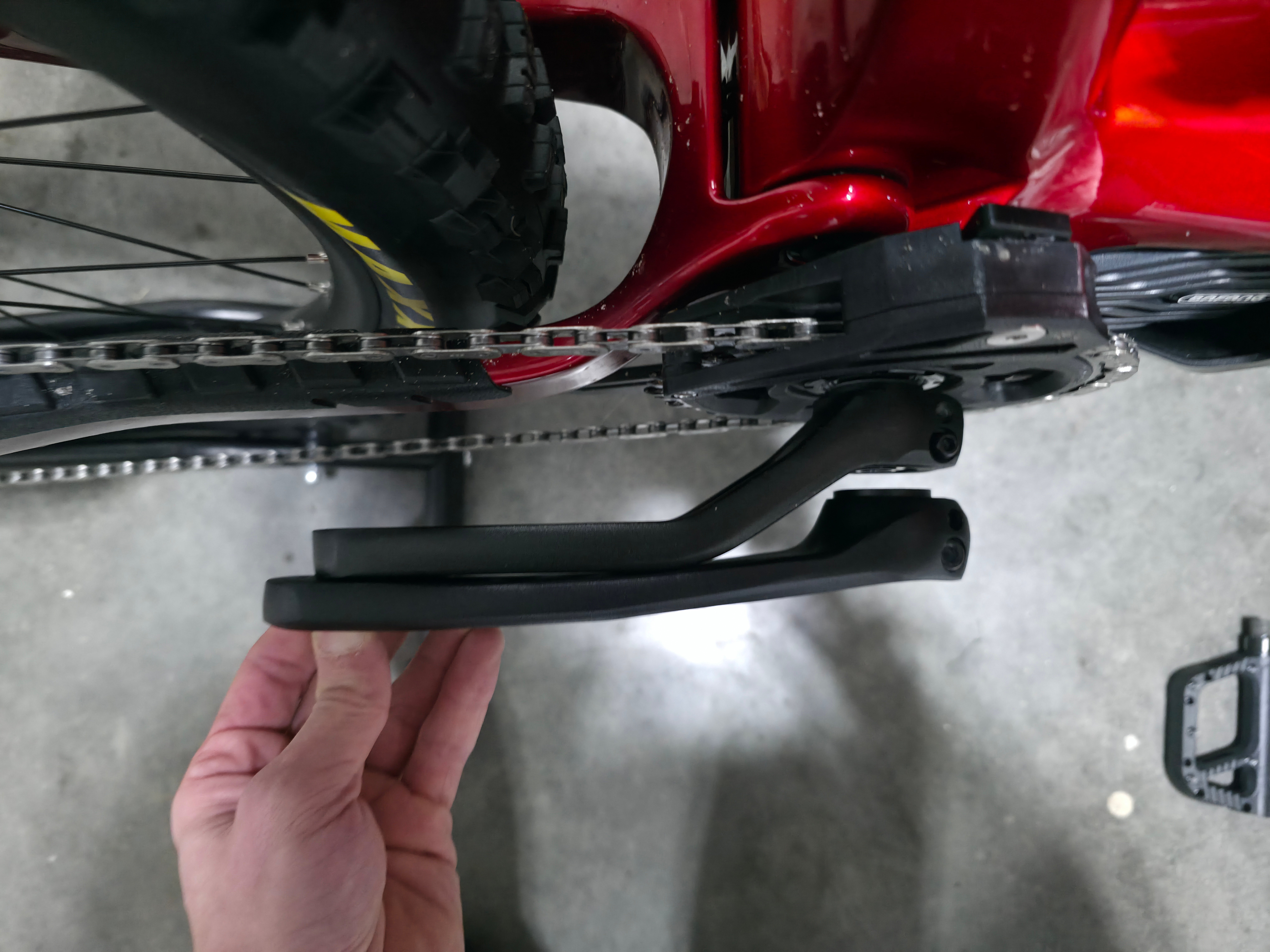

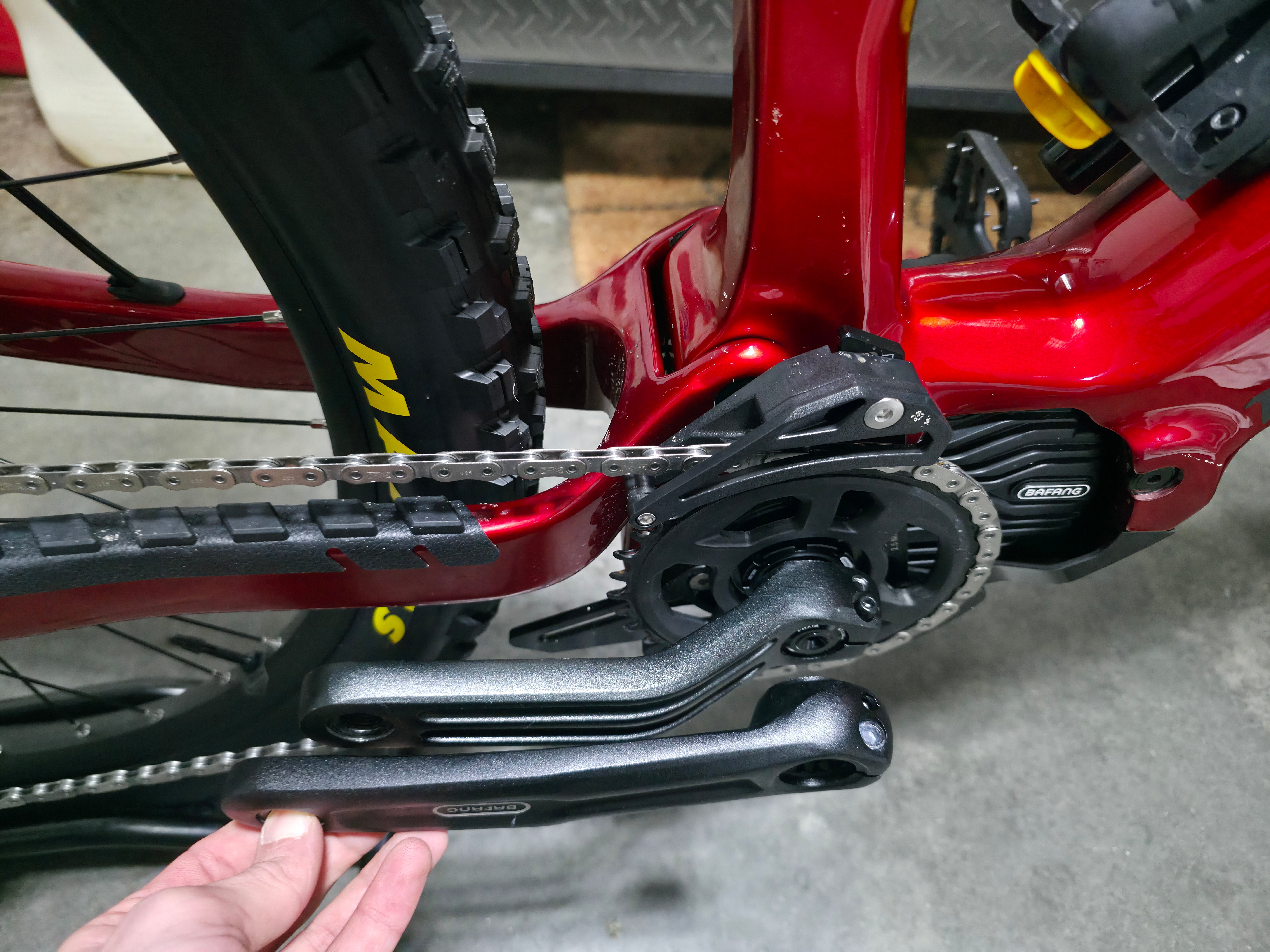

Here are my 152mm pedals installed. I really enjoy the extra width and shortened length. They are steel.
View attachment 173758View attachment 173759View attachment 173760View attachment 173761
Nice i was going to order the miranda cranks but they are almost 3x the cost and aluminum, i think ill order those aswell thanks :)
too many Q factor ( 😭 kneees), i suppose that this crank arms are dedicated to fat bike ?
Feels much better than straight ones, plus you gain even more clearance bringing the arm out even more instead of being straight down. Very Happy with these, plus a weight savings.

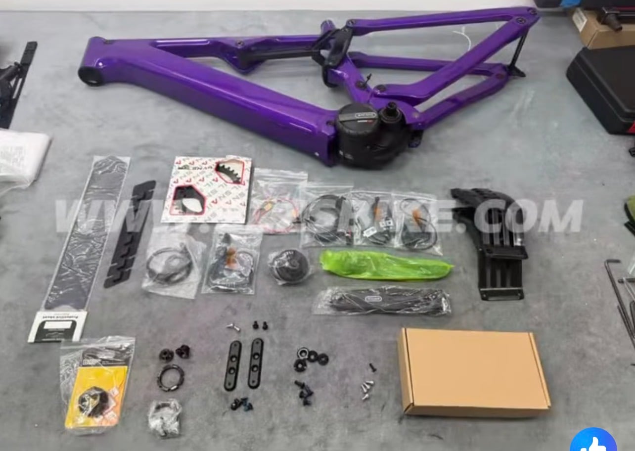

Hello guys,
I've just received my frame, motor kit and battery. The frame arrived with the motor installed. I'm wondering how to install the battery. I guess I should remove the motor first. If someone could share any related pictures or assembly manual I would highly appreciate.

Ask Jean if U buy from her, she can provide video installation.
To install the battery, you have to remove the motor. Insert the battery and screw it to the frame with the four screws. The battery comes with two connectors: one goes to the bike's charging port and the other to the motor. Once installed, reattach the motor.

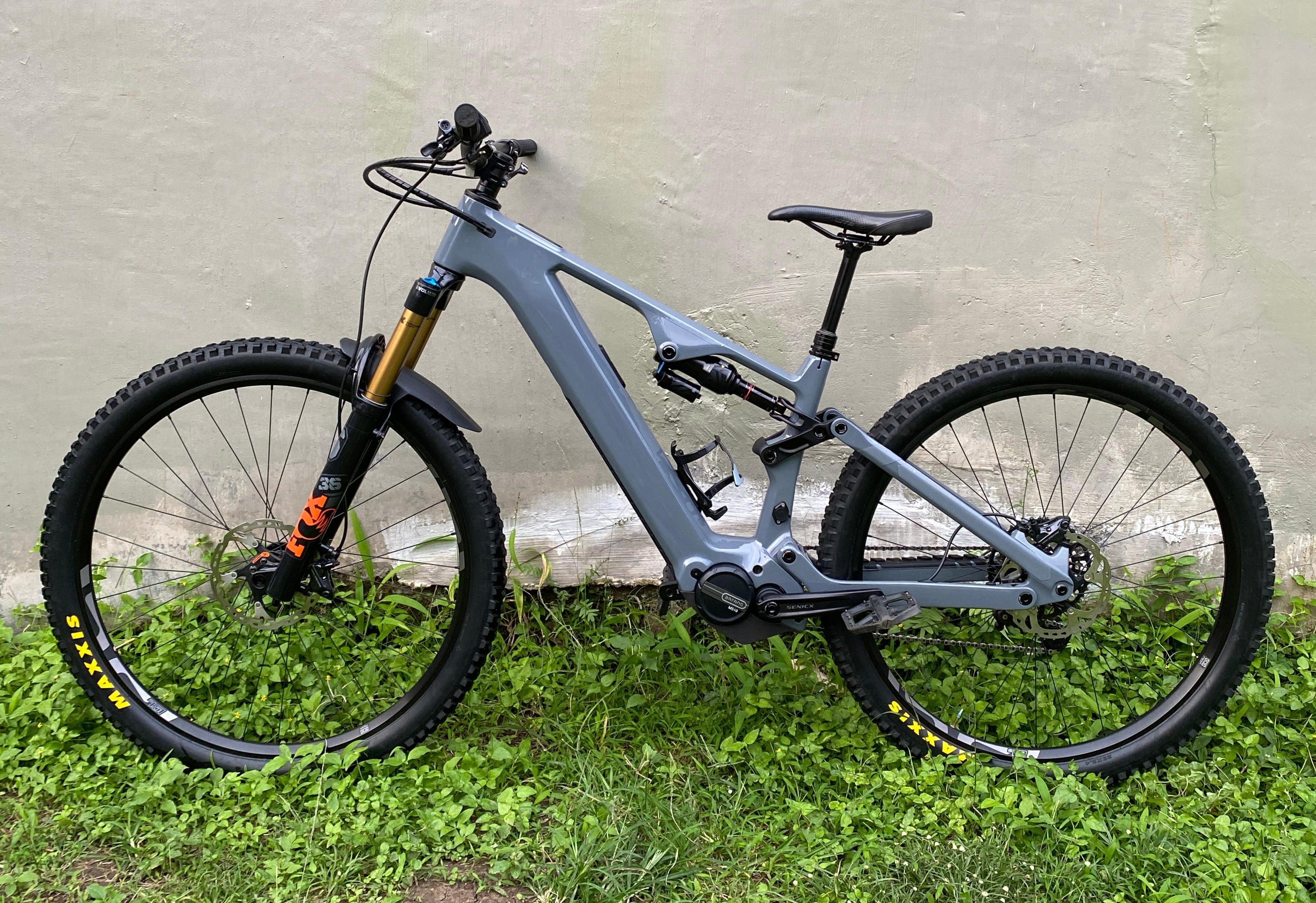

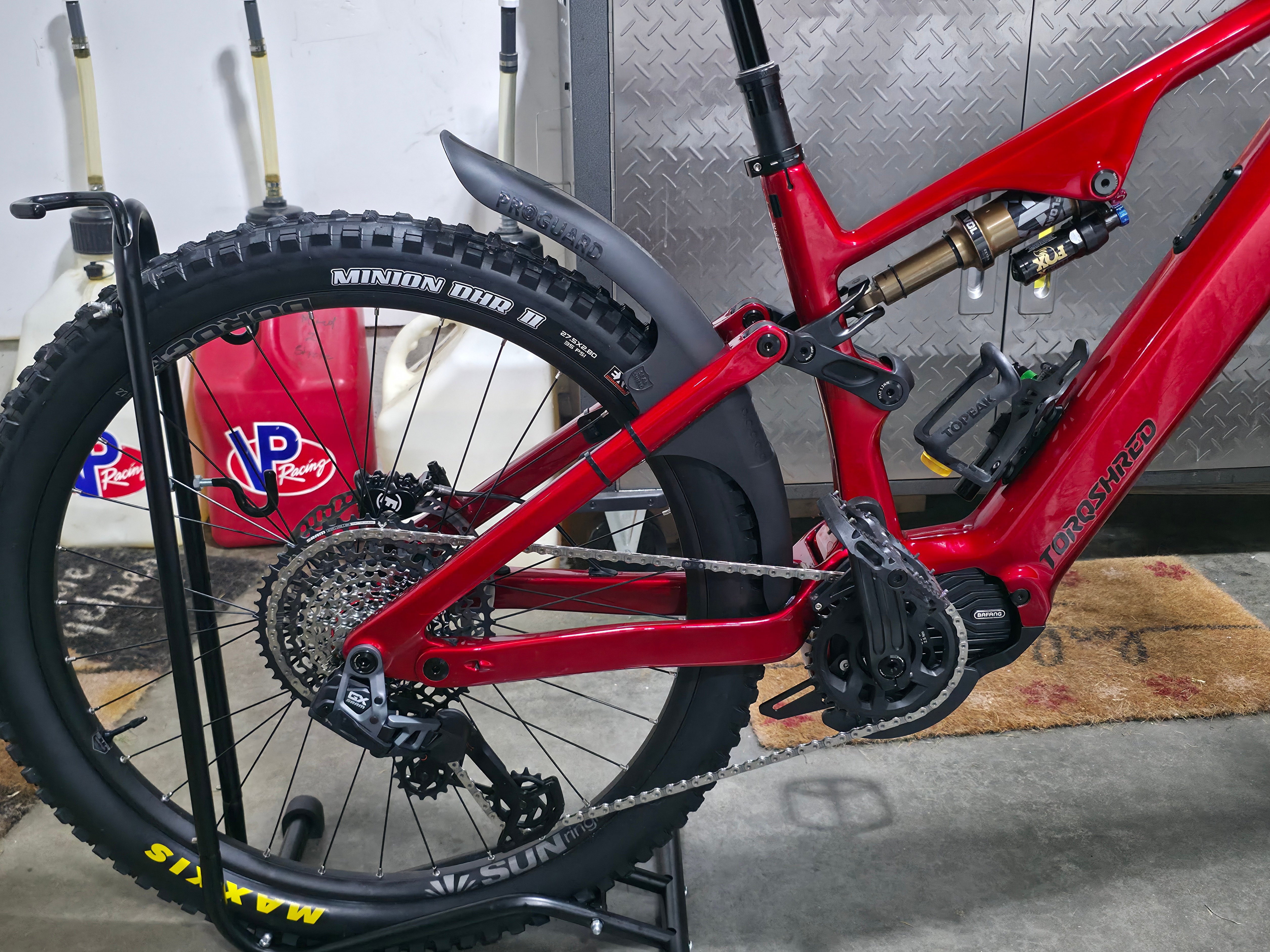

Hola a todos los amantes de las construcciones caseras de Bafang. Aquí les presento mi nueva construcción casera con cuadro SZZS CEF69 y la nueva versión Bafang M510 3.0. Batería de 48 V y 700 Wh. Jean me comentó que la nueva versión es de 48 V y 835 Wh con carcasa de carbono. Tengo el extensor de batería externo de 280 Wh, pero aún no lo he instalado en la bicicleta.
Con esta construcción pesa aproximadamente 21,5 kg.
