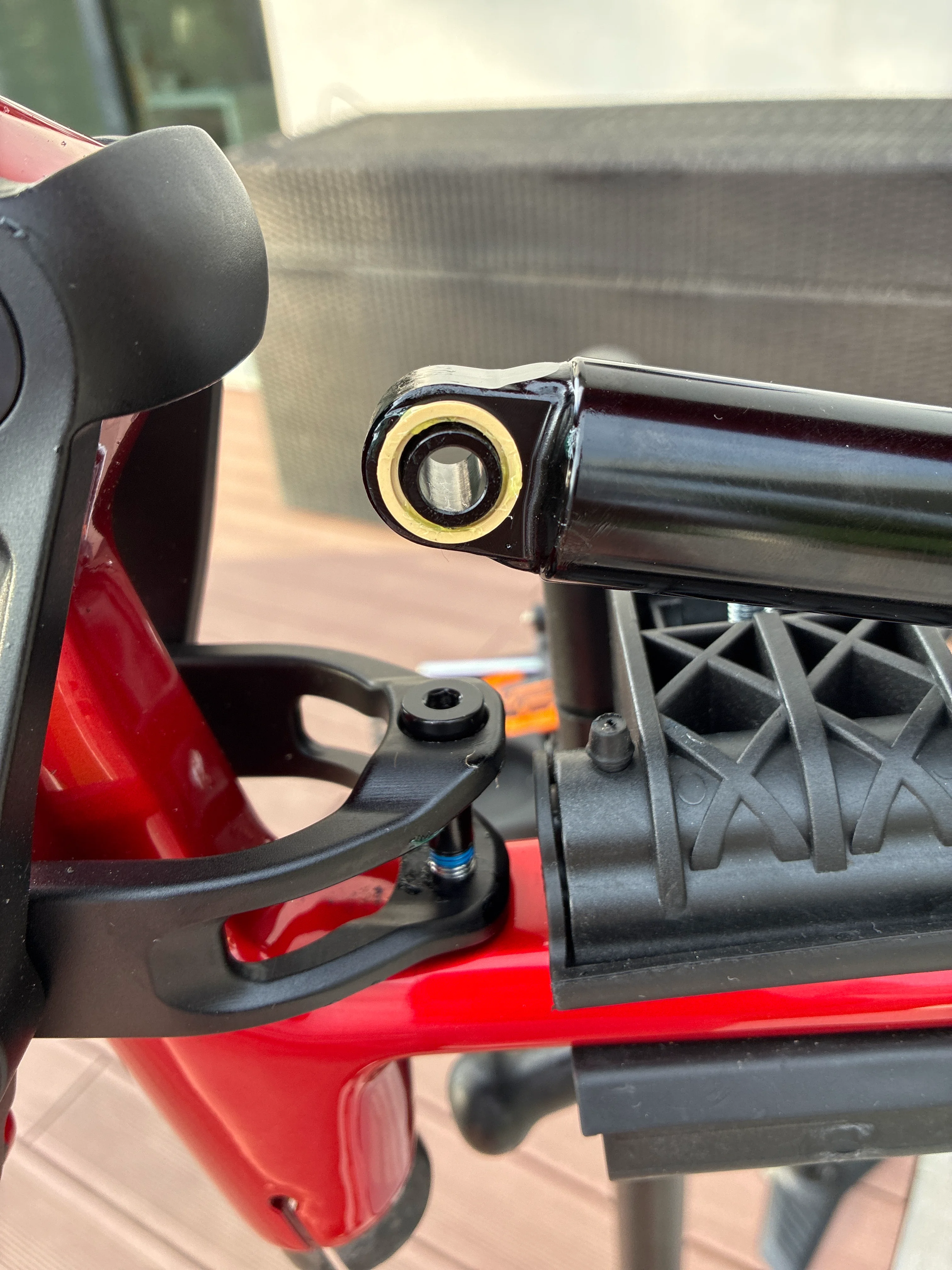

i run offset bushing over 4 year on my e10 and they dont turn tho even when lubed.
i agree a flipchip would be better giving more adjusfability.

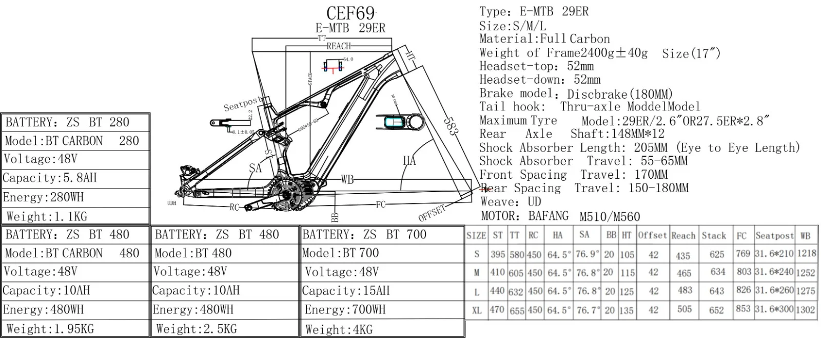

Hi. What is the height of BB?
I measured the lowest point on skid plate.
CEF69 - Full 29 - 270mm
Trek Rail Gen 3 - Mullet - 265mm
Both are in 170mm fork.
Make the cef69 into a mullet would put it below 250mm.

Merci. Mais pour une meilleure compréhension et comparaison, la mesure conventionnelle de la hauteur de la pédalier est entre l’essieu des bras de vilebrequin et la masse. Pouvez-vous la mesurer ?
Just add 30-35mm.
Ok, thanks. That would mean 305 mm. Does otherbody can confirm that ? These value is to lower for my use (350 mm mini needed). Shortened crank arms will been mandatory and seem impossible to make mulet for me with these value.

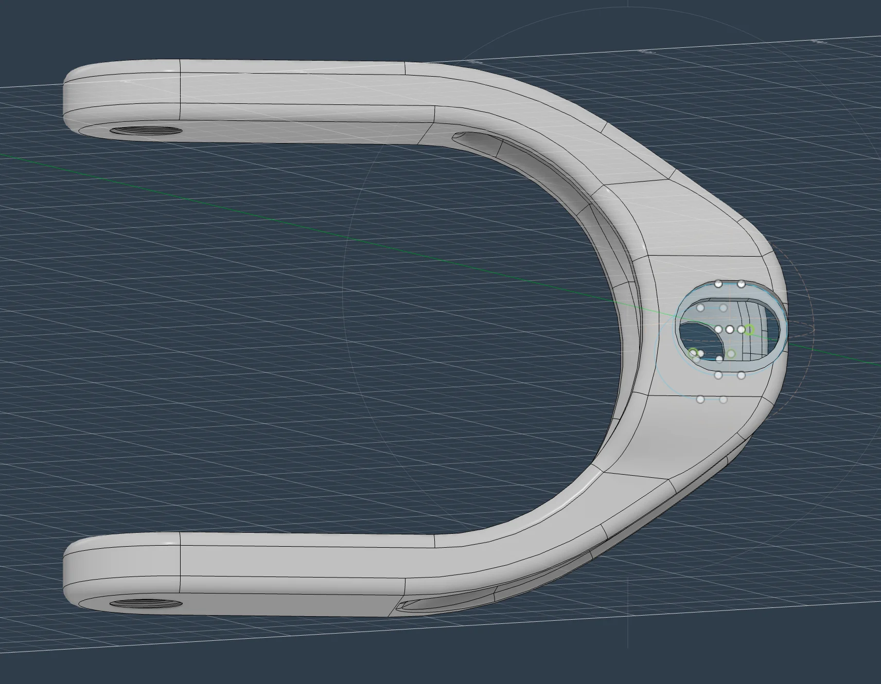

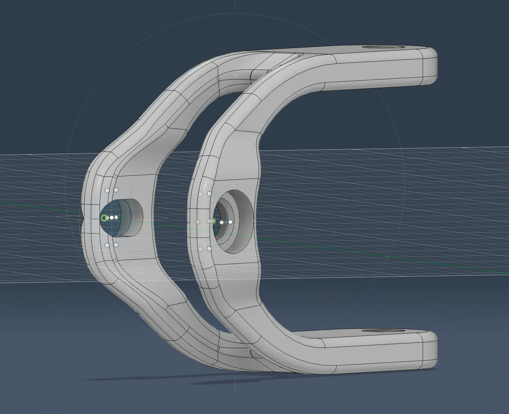

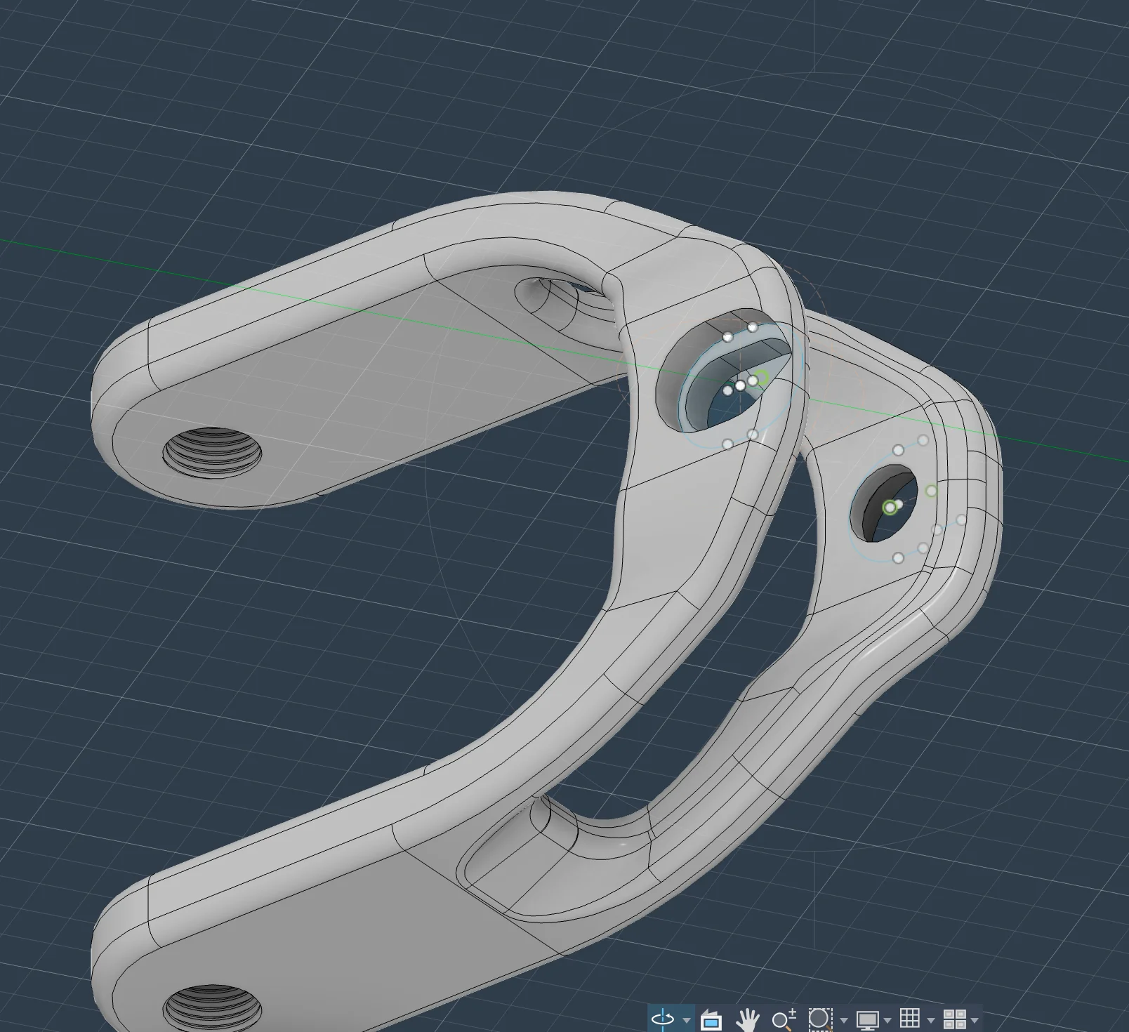

If anyone has fusion360 abilities and can help me adding a flipchip to the CEF69 yoke , that'd be amazing. Kind of stuck here (everything's calculated to once flipped keep the same bb height on 27.5)
Should add more material just where the outer part of the flip chip sits and replicate the same on the other face

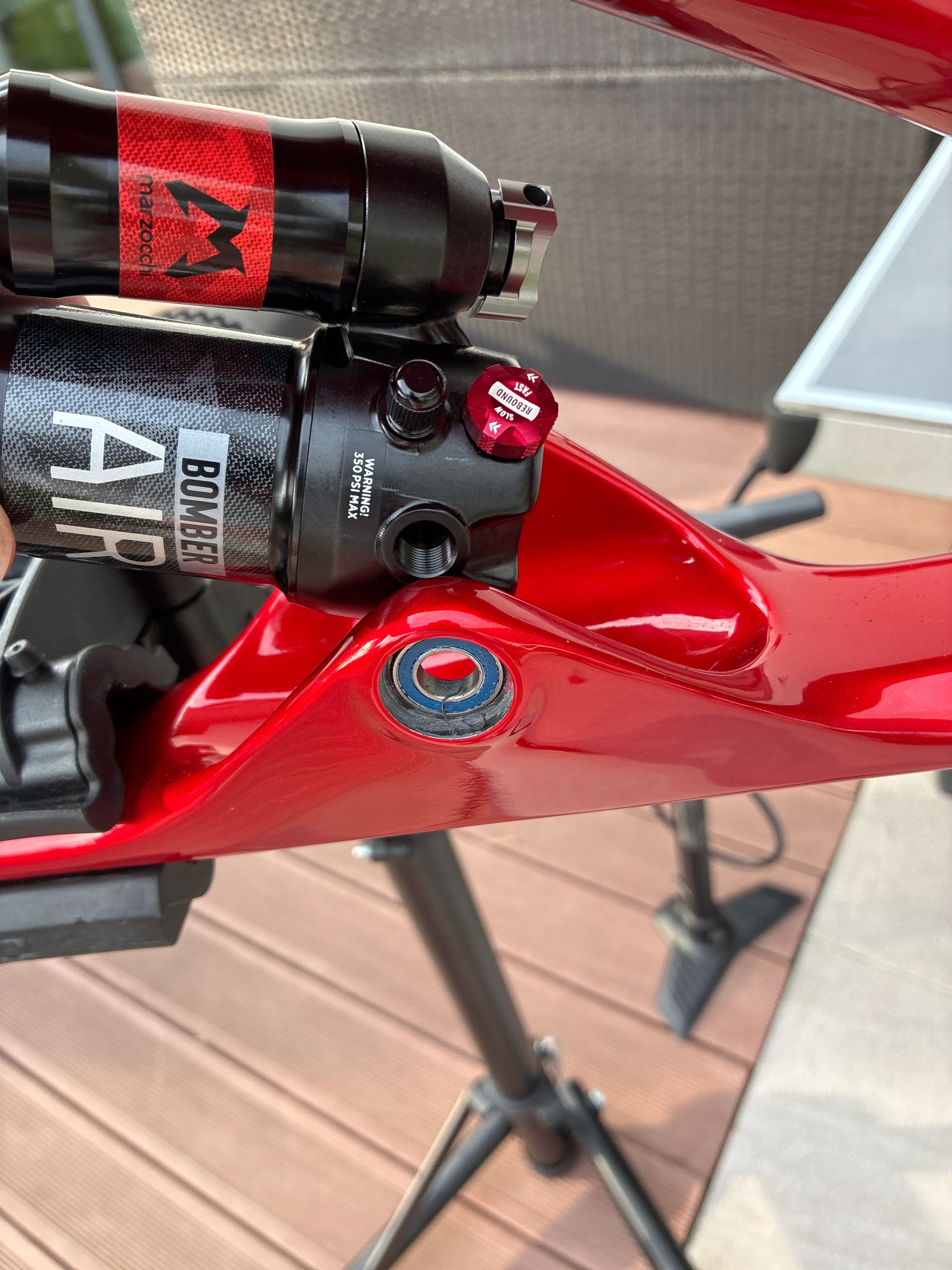

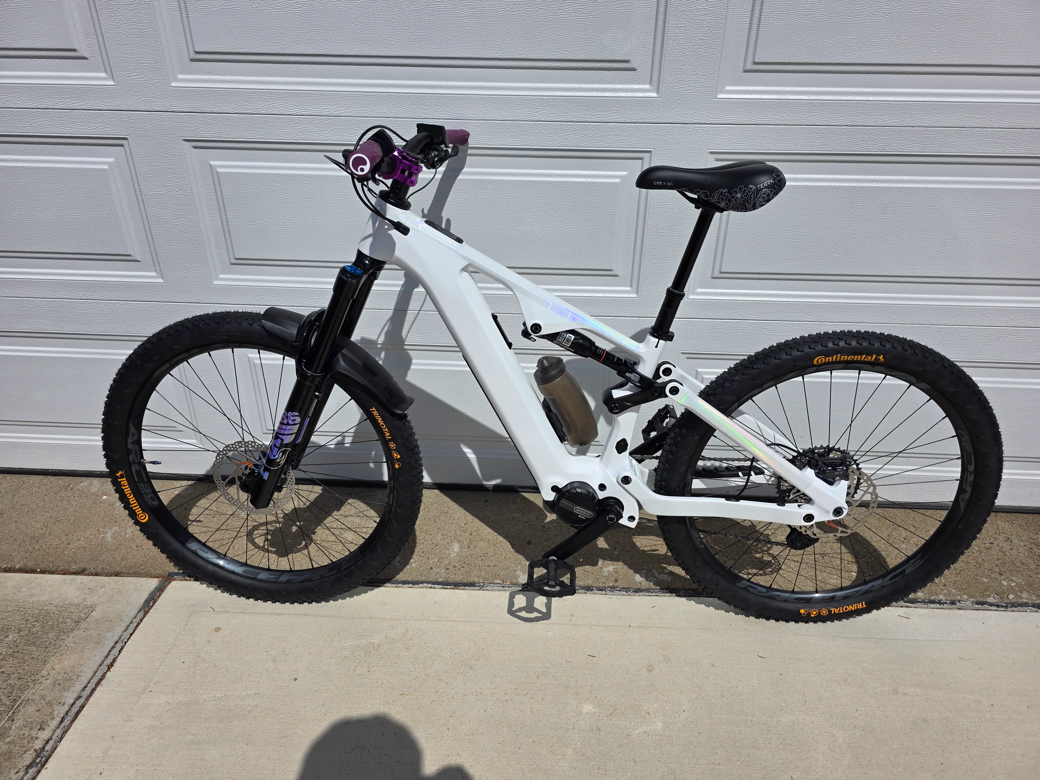

Just built up my wifes size small.
Gonna run it 27.5 all around. Only using a 205x50mm shock, so ground clearance should be safe. The rear chainstay routing was an absolute shitshow. Worst experience I've ever had to manage. Otherwise, bike looks good and was delivered in pretty decent QC. Installing the shock was deeply unpleasant as well. Not for lack of clearance, but because the rotating members need to be moved in a very specific order.
I'd rather have soft rubber grommets for the exit ports instead of the hard plastic because once you add a hardwired light and a throttle, you have a stupid number of things coming out.
Picture doesnt have front brake because I'm still working on shortening it.
Now I need to open up the M560 firmware and make this thing less stupidly tuned. In particular, the throttle changing behavior by mode is driving me nuts.
