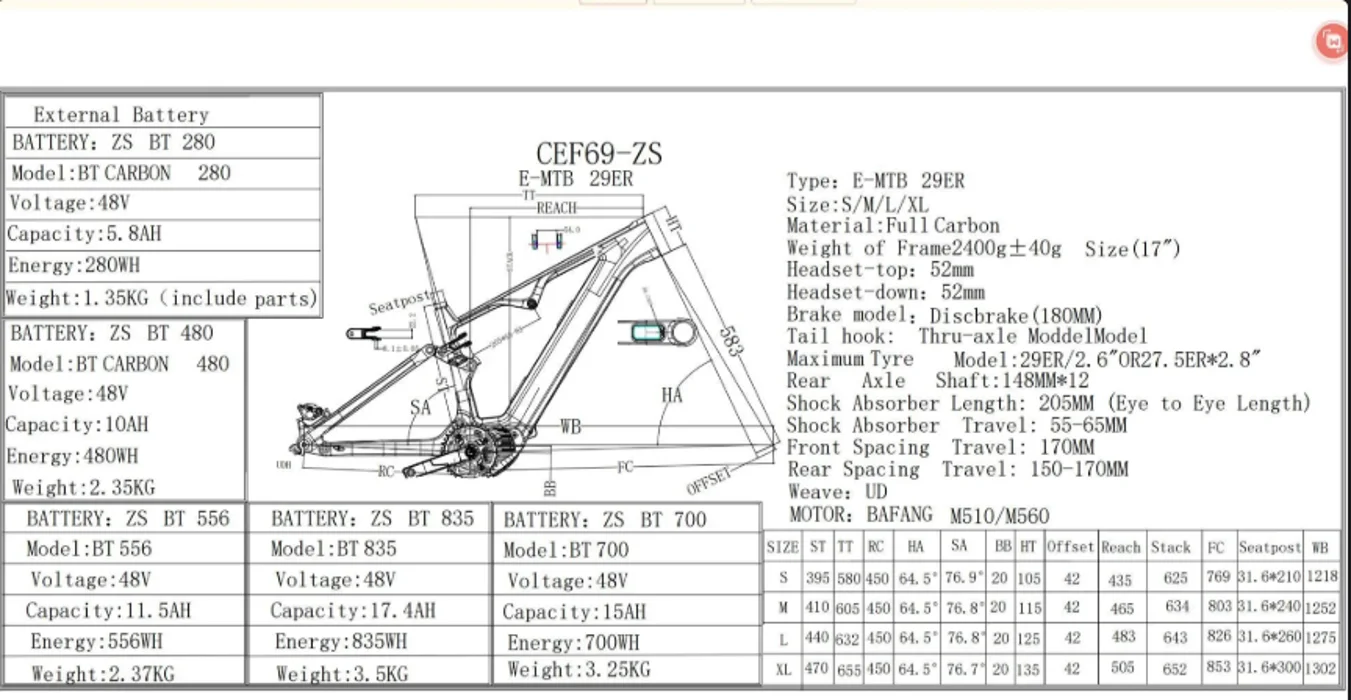

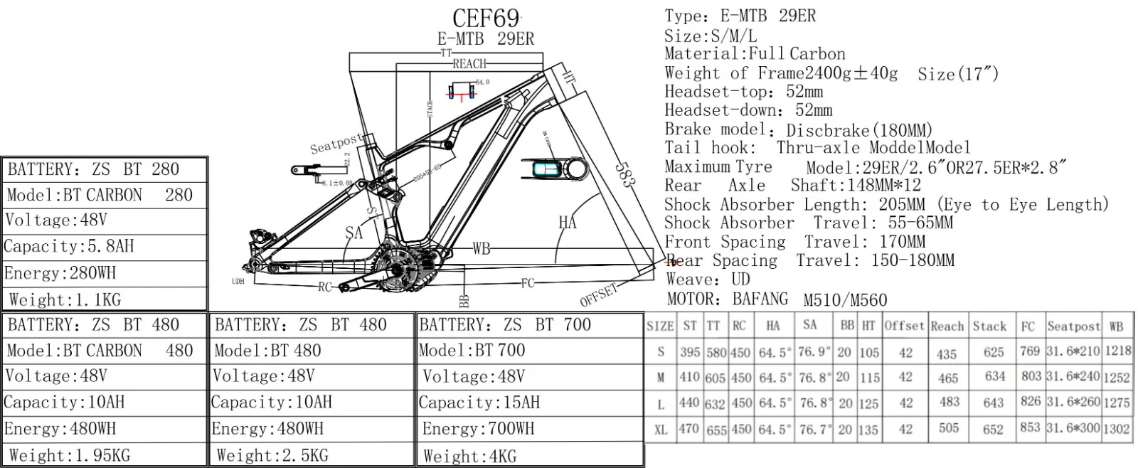

battery dimensions in mm, not weight!
and I put the geometry for xl size, I didn't see a table with xl!
charly have share it several months ago. raison why i have ordered one
They do provide the 835Wh carbon battery by default. I dont have dimensions because its in the bike now, but I'm 100% sure some thread on this forum already has it.

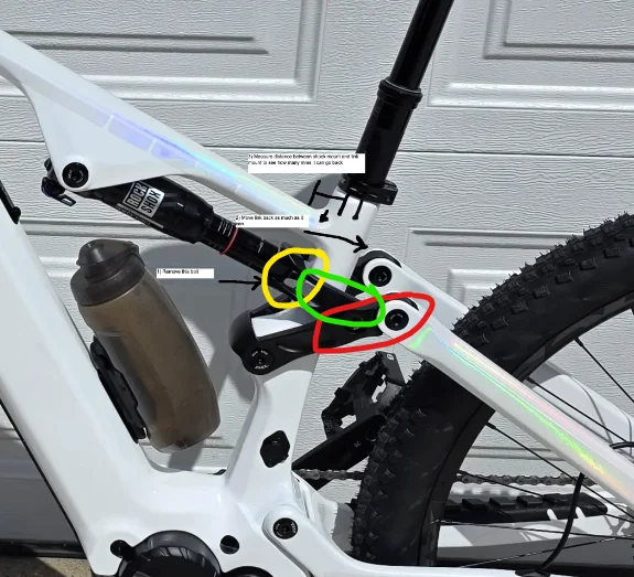

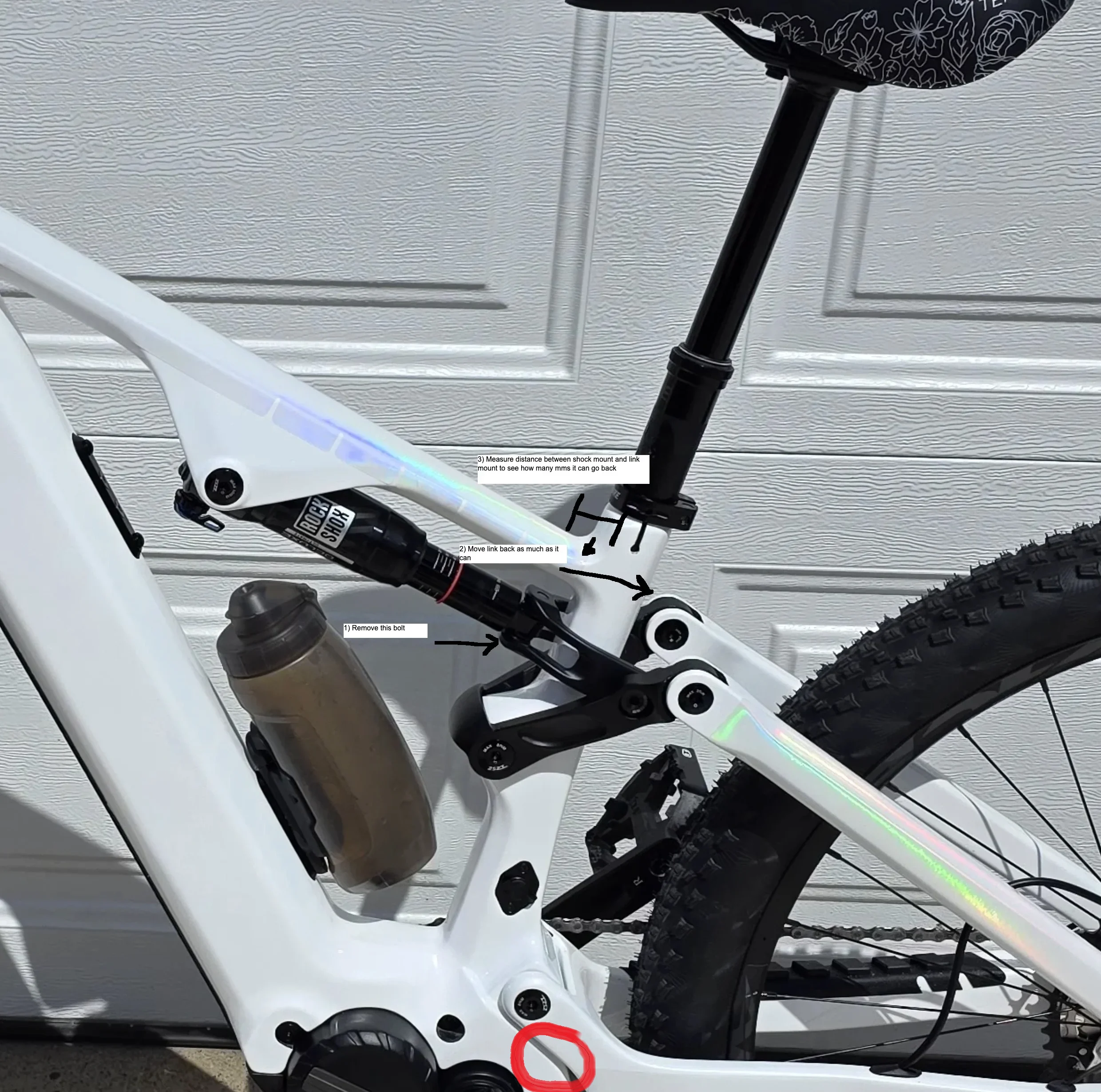

If someone can remove 1 bolt from the shock and try to move the link as back as possible till the seatpost contact with the frame can you measure me how many mm's could go back between the shock and the link?
It is to ensure how much the link could work for 27.5 without interference
Will try to explain with pictures:
Is it that gap that you're trying to measure?
Yes, like how much the link can go back and how much "Larger" I can make the connecting link so it works with 27.5 with the same or almost the same bb height.
It can be measured even by puting some painters tape in the shock where it touches the link and moving it back, the difference is how much
Not much. The one I highlighted (yellow) and measuring the two closest part between the link and framce, which is the top part, it's just around 5-6mm gap.
I think it's the red one that needs to be repositioned to push it down.
Or make the green one longer. But I'm no engineer. lol

The limit of extension is mostly here, not the linkage (easily modifiable)
Green is the one that i'm designing it to be longer/flip chip. But for that to know how longer can be is what patdam say below, need to know what's the limit before the seatstay makes contact with the frame

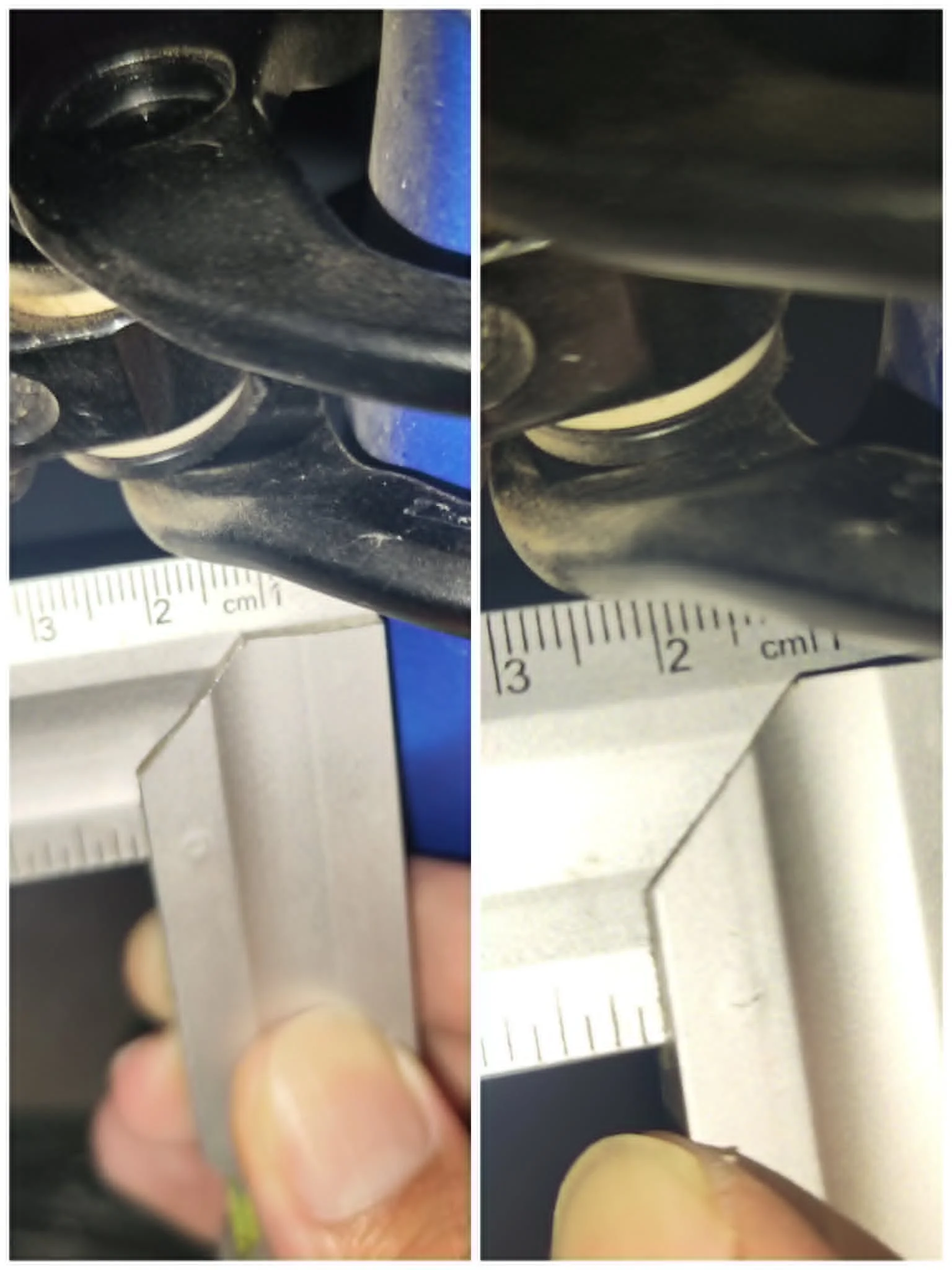

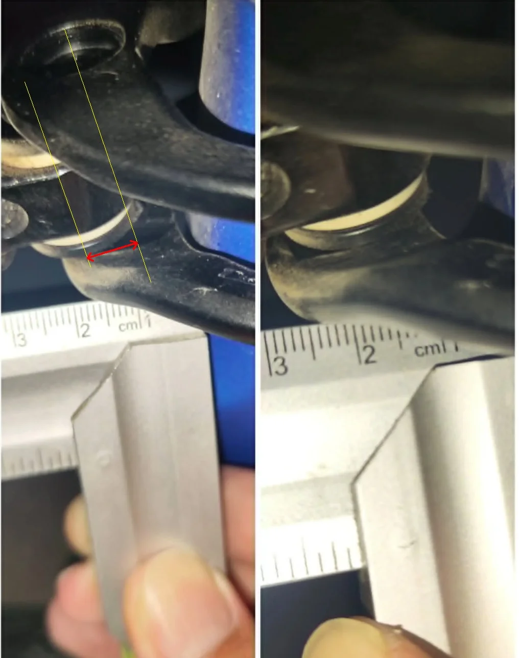

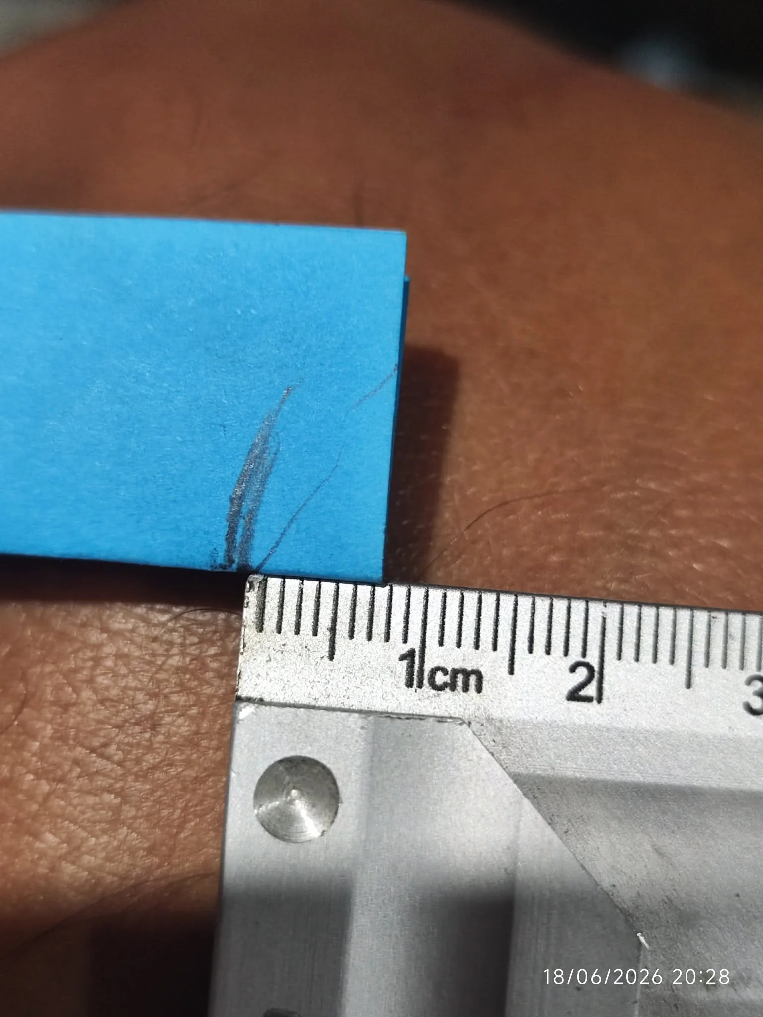

Now I understand better. Don't really have the proper tools but this is the best i could provide.
But the path is angled, so I don't think a simple difference is right number.
Exact, but I don't know how much can that go down. Design looks almost the same as my CEF50 down there, even I believe seatstays are all the same for CEF50, CEF69 and CEF55
It's possible,
That's really useful, thanks!
Tbh for what I see it can move at least 5mm that'd mean that BB height would be almost the same as with 29". (is the distance between the yellow lines, both hole centers displacement)

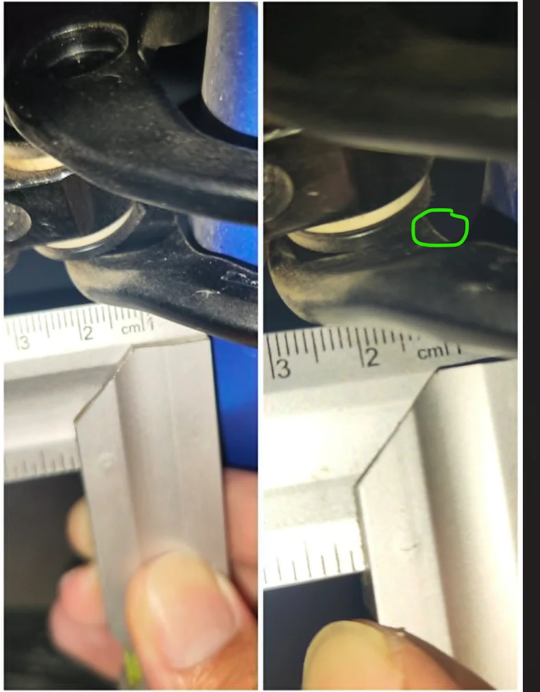

This is the most accurate. I marked the frame to where the link touches or the maximum it could extend.
Positioned it back with the bolt on and marked.
Marked it on this note. This is the tip of the link near the bolt hole.
The green highlight is where i marked it against the frame.

UPDATE: That is the chainstay fully extended or dropped. The link did not touch the frame but very very close.
PS: Sorry for the continuous post edits.
