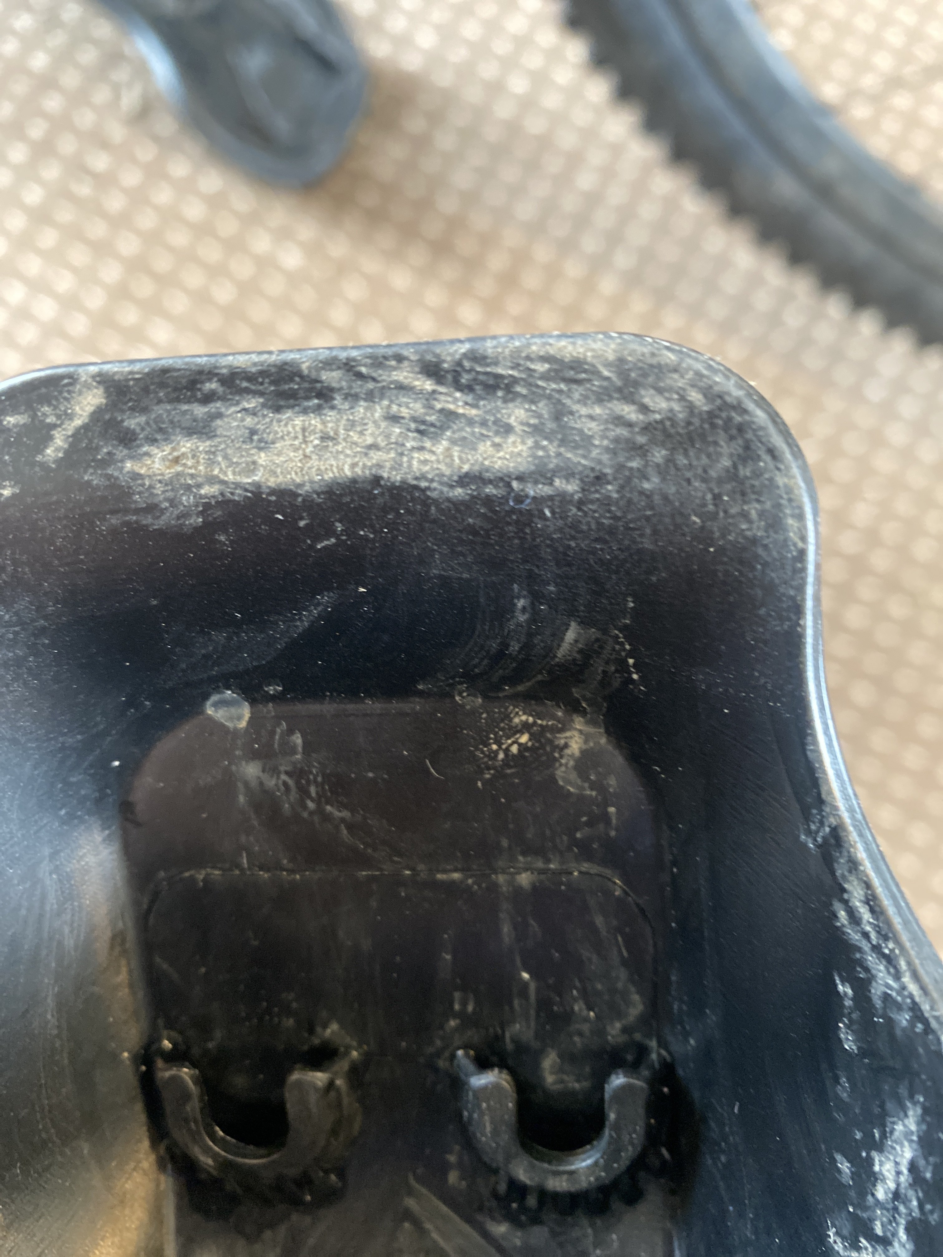

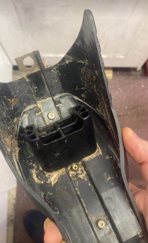

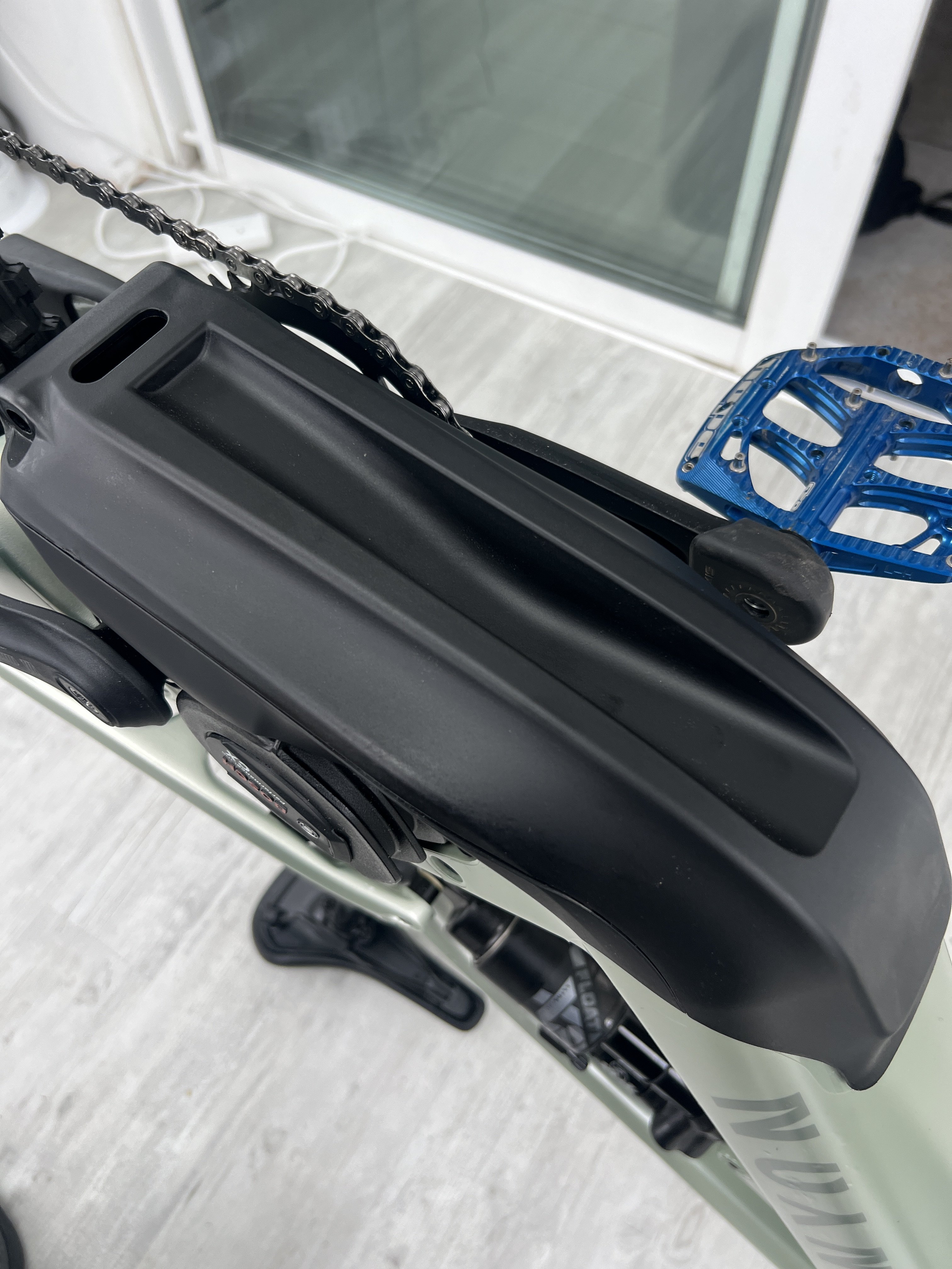

This is Whyte’s fix for their very similar issue. A rubber block inside the bashguard.
I still beleive the root cause is the fact that the battery is not puched up far enough into the connector.
Your damage could be explained by side to side movement of the battery at the top. but normally such a connection needs to be 'floating' left/right.

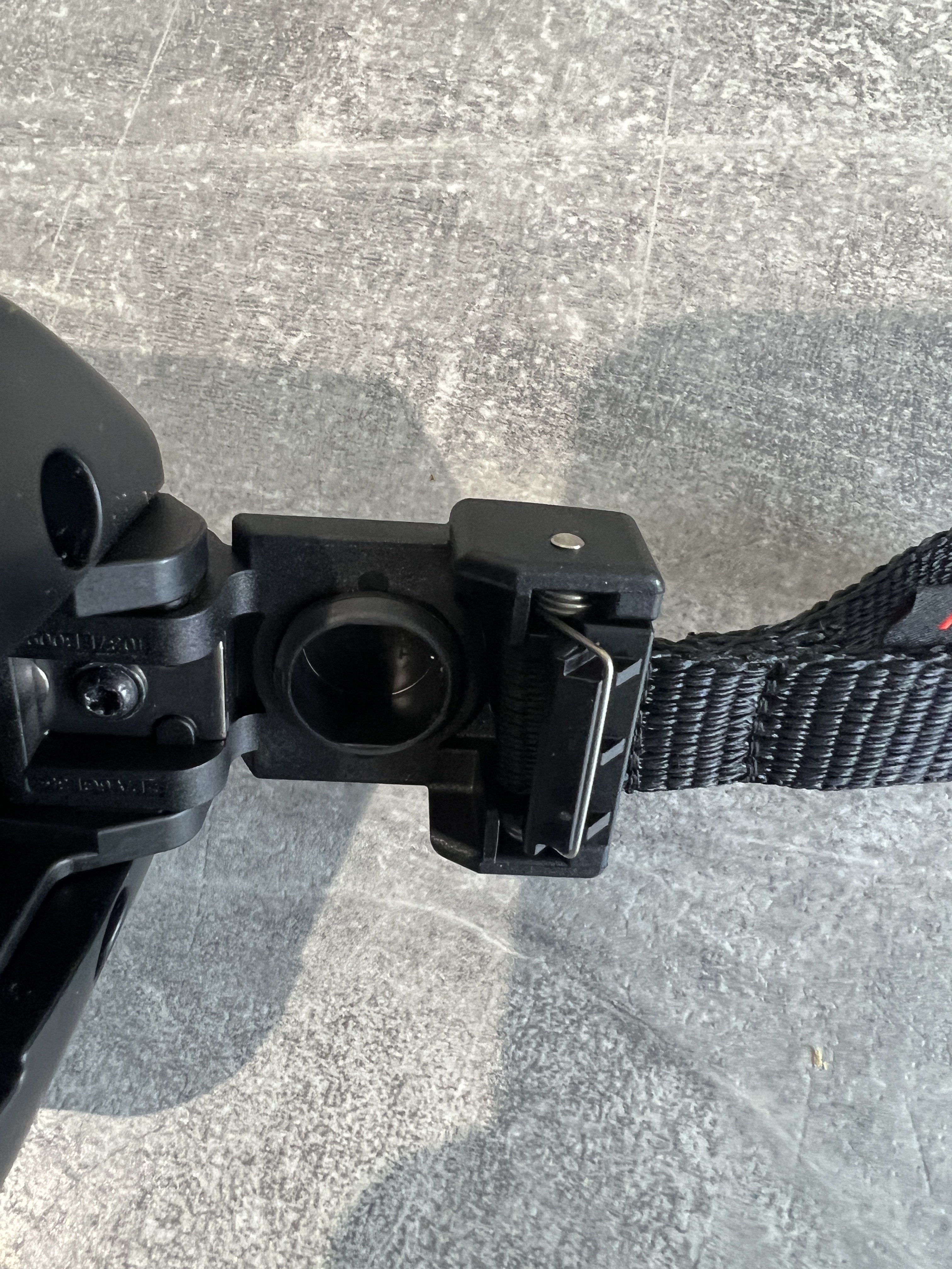

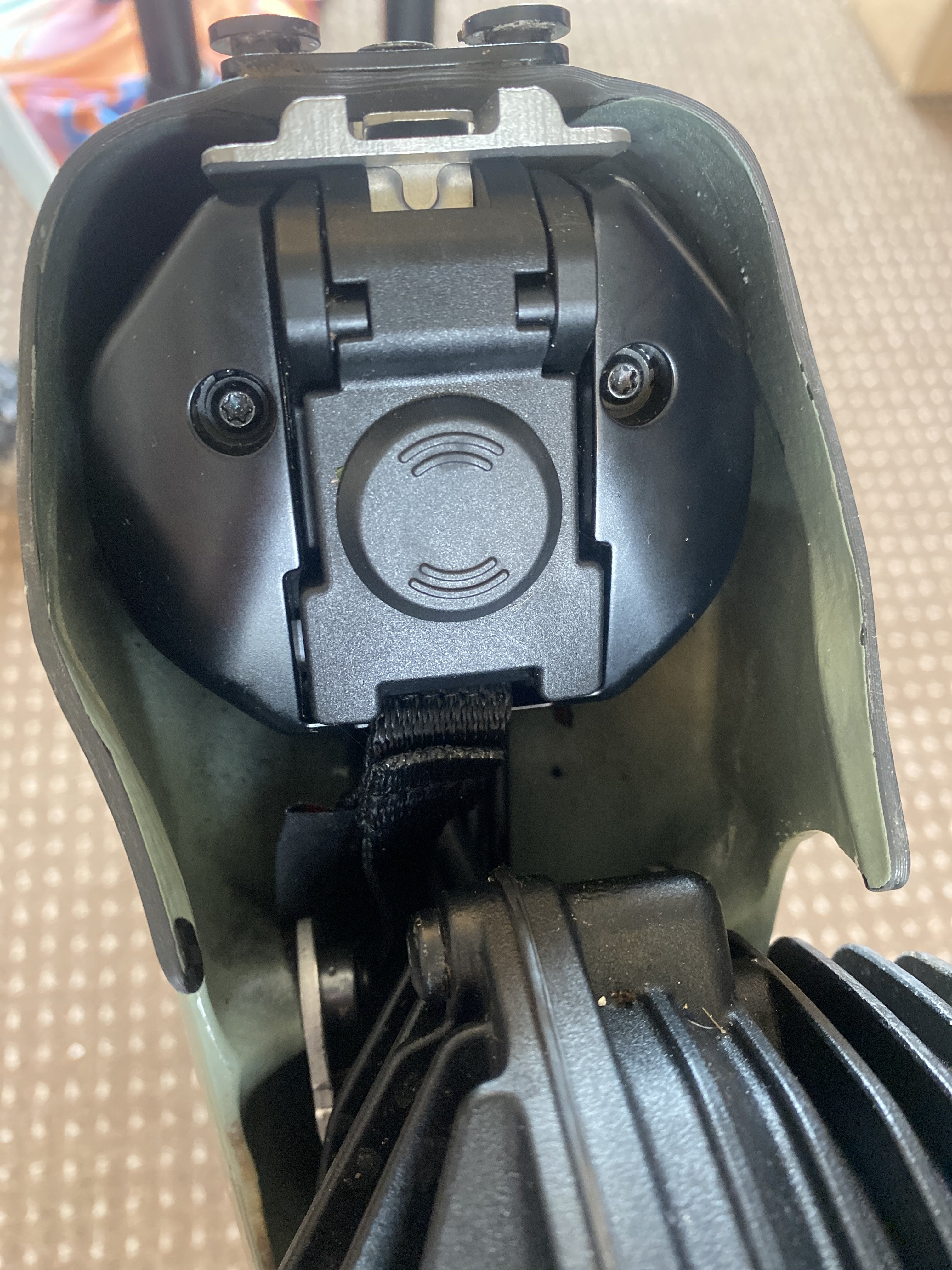

View attachment 126538View attachment 126539View attachment 126540View attachment 126541View attachment 126542So bike has landed, This is how the battery was held. is this different to, or the same as the bikes that have been failing ?

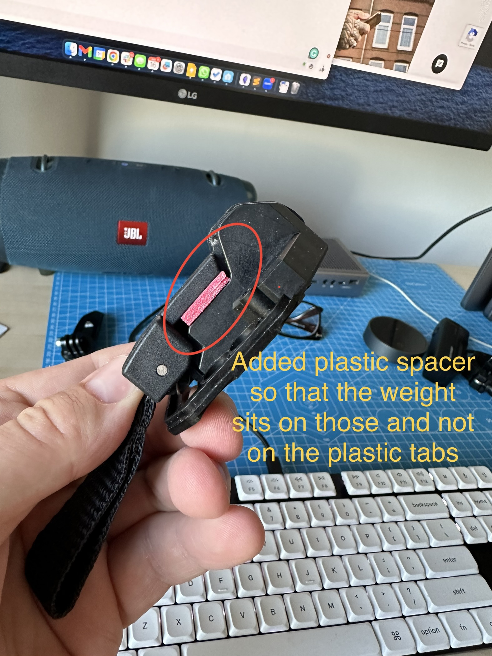

Not 100% sure, but didn't they change the position of the cylindrical features a bit , so they are no longer under the clips that brake.
old: new:
Would you mind taking of the of the plastic around the latch, to see the sides?
then we can see if they added material (simular to what we I with the red spacer):

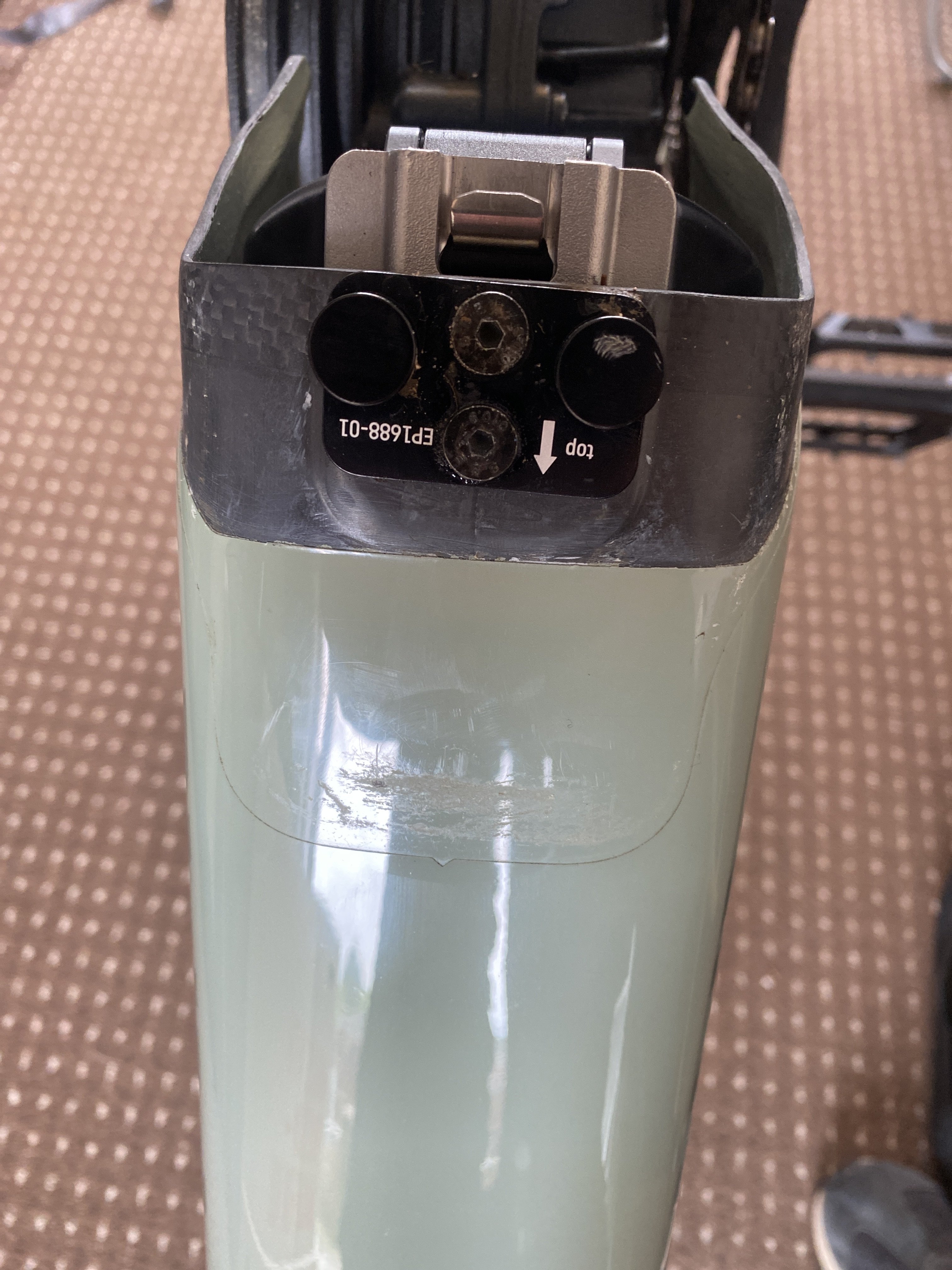

The broken latch is a long running saga now. To repeat some of my comments from earlier in the thread for the benefit of later purchasers I own a 2022 (2023 model) Whyte E160RSX that uses the same battery latch. I have 750 miles on that bike with no issues of cutting out or damage to the latch. That said, some Whyte models experienced the problem during summer 2023 but it seemed to be a much smaller number of bikes affected which led me to believe a faulty batch of latches may have been the reason. I am beginning to doubt that theory now but what seems clear and probably a common cause is the battery not being held securely. The issue on those Whyte bikes was I think unrelated.
So given the Bosch latch works as designed on my bike and most other 23 Whyte bikes what is different to the Strive set up?
1.The Whyte bikes are all ally....the Strive is carbon
2.Whyte bikes use the Bosch rail system which is steel and includes the "slot" that the latch lever fits to. The Strive does not use the Bosch Rail and has its own separate "slot" component which is ally and bolted to the bottom of the downtube.
Obviously the main forces imposed by the weight of the battery accentuated by dynamic riding forces, are on the connection between the latch and the "slot" it uses to fix into with a cammed lever mechanism. A lot of focus has been on the latch itself........but I suspect the issue could equally be the "slot". If that piece of ally or the carbon section of downtube it is bolted to flexes at all it will allow the cammed lever action of the latch to change angle and therefore weaken.
What I believe Canyon should do as a fix is to replace the ally "slot" component with a longer steel replacement bolted both at the bottom of the downtube and further up the downtube.
Meanwhile pending a fix by Canyon I believe the most effective DIY hack would be to add a strap (zip tie) that holds the battery tight to the ally "slot". That would prevent any partial separation of the latch lever from the slot caused by any flexing of the "slot" or the section of downtube it is bolted to. In addition I would add a section of hard rubber between the battery and downtube opposite the latch.

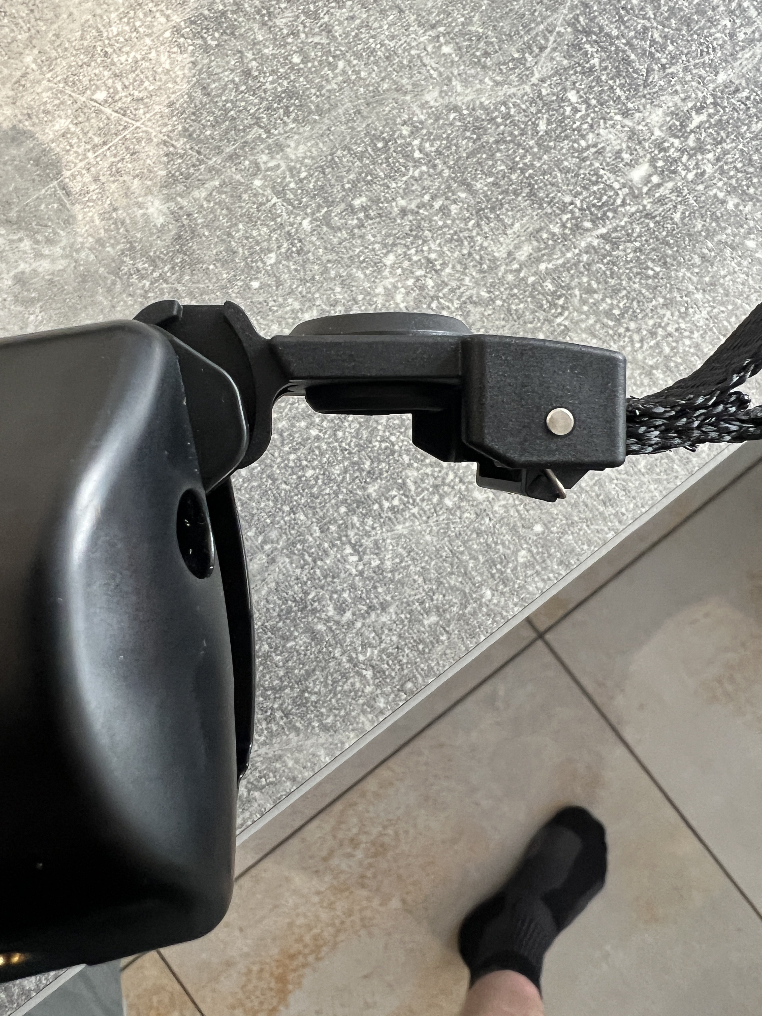

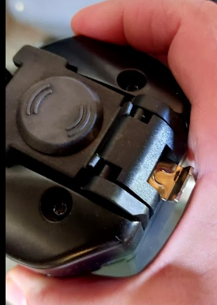

if they solved it i believe they will have added material where Hubertsk added the red spacer. here is the side view of what hubertsk showed in previous post :

Bike cut off, if I keep forcing the battery up, bike will turn on, but as soon a bump appears, it shuts down.
Latch with a lot of movement when closed.

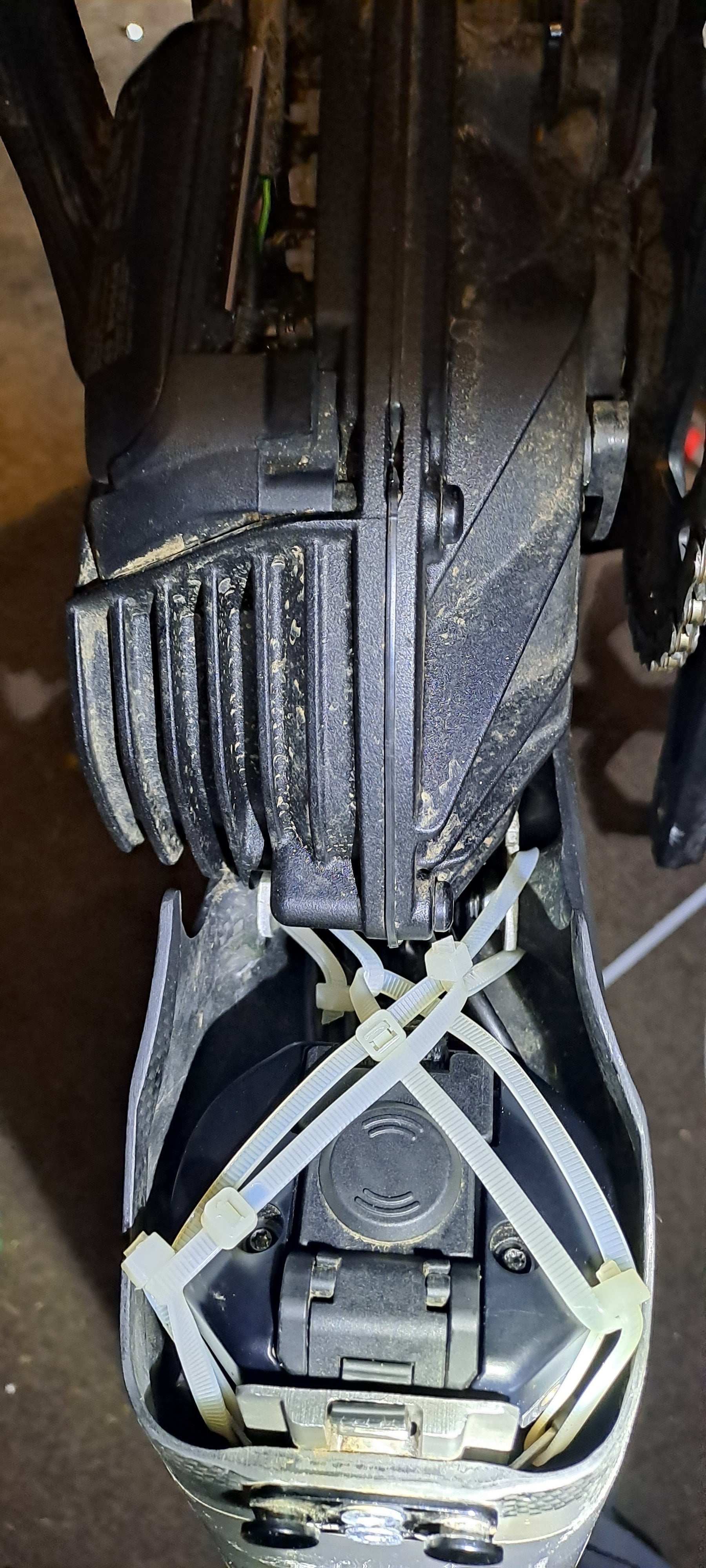

I shouldn't have to do this but I now have a non removable battery that is secure...for now. I know it looks crap but the battery shouldn't move around until I get a reply from Canyon...shocking that on a "high end" EMTB that I had to resort to this to be able to ride it...
Shaunovan,
Does it work?
There are zipties attatched to the engine, correct?
Care to take more pictures?
Thanks!

They will Come up with a fix, in the meantime few cable ties does the job.. im riding mine...

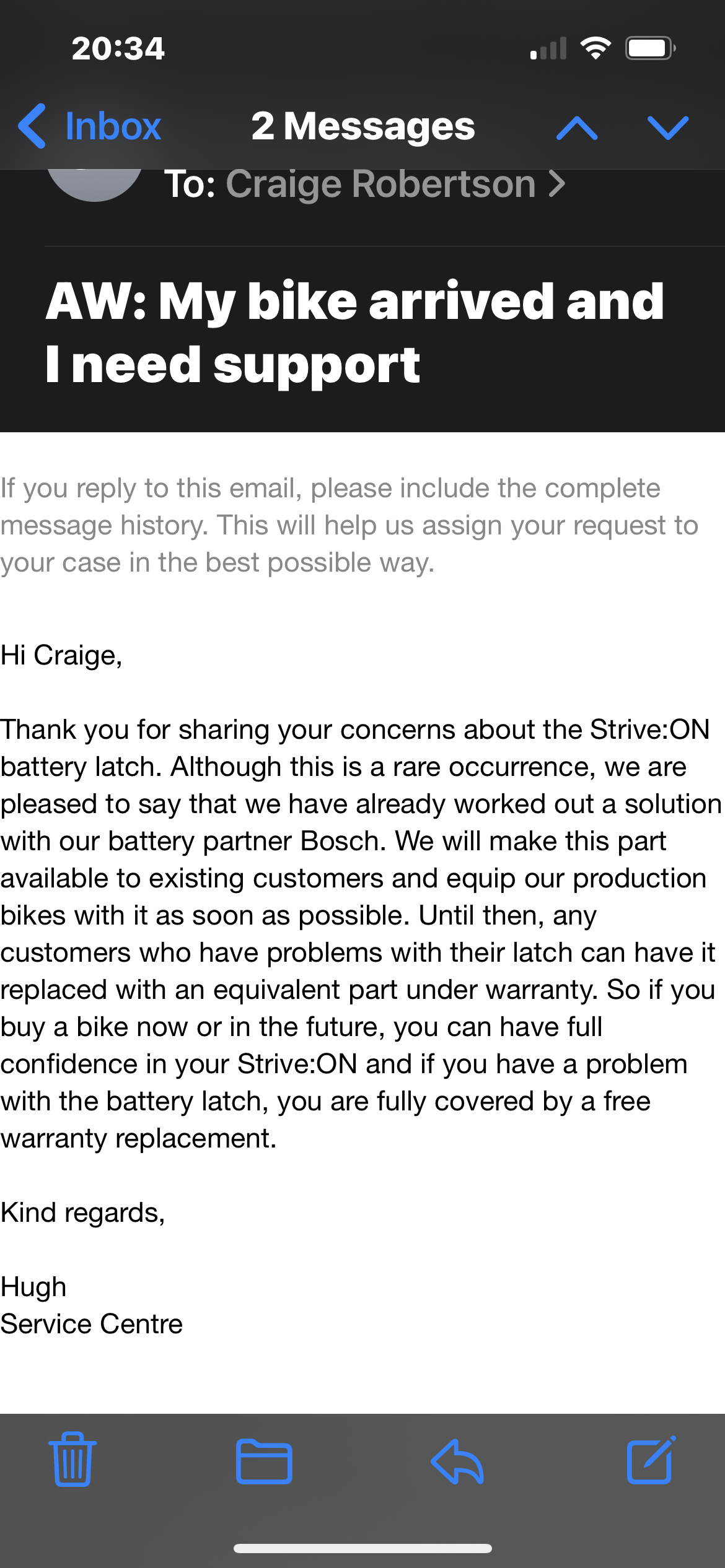

I guess the main issue is whether the broken latch damages other parts, such as the battery terminal.

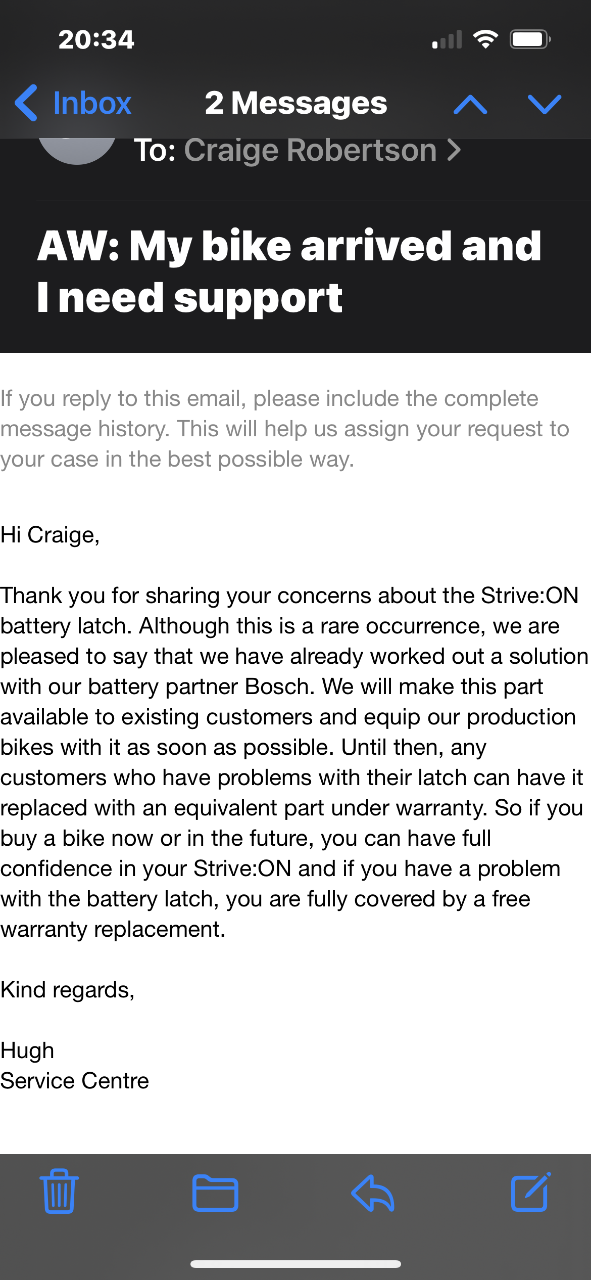

@Rob Rides EMTB do you think you'd be able to squeeze additional info out of Canyon on Bosch about this supposed replacement latch/part?
Let's hope they get it right first time and it solves the problem entirely.

Sorry to hear this mate, Get the cable ties out... iv had two runs on mine now "smashing round cwmcarn" no issues a t all, presume the cable ties are doing there job. Canyon/Bosch will soon have something out to us..

Tempted to do this to mine, even though mine hasn't broken yet, just to prevent damage and excess slop in the battery. Do the cable ties touch the carbon at all, or is there a way to make a sorta hammock of cable ties purely between metal parts?
