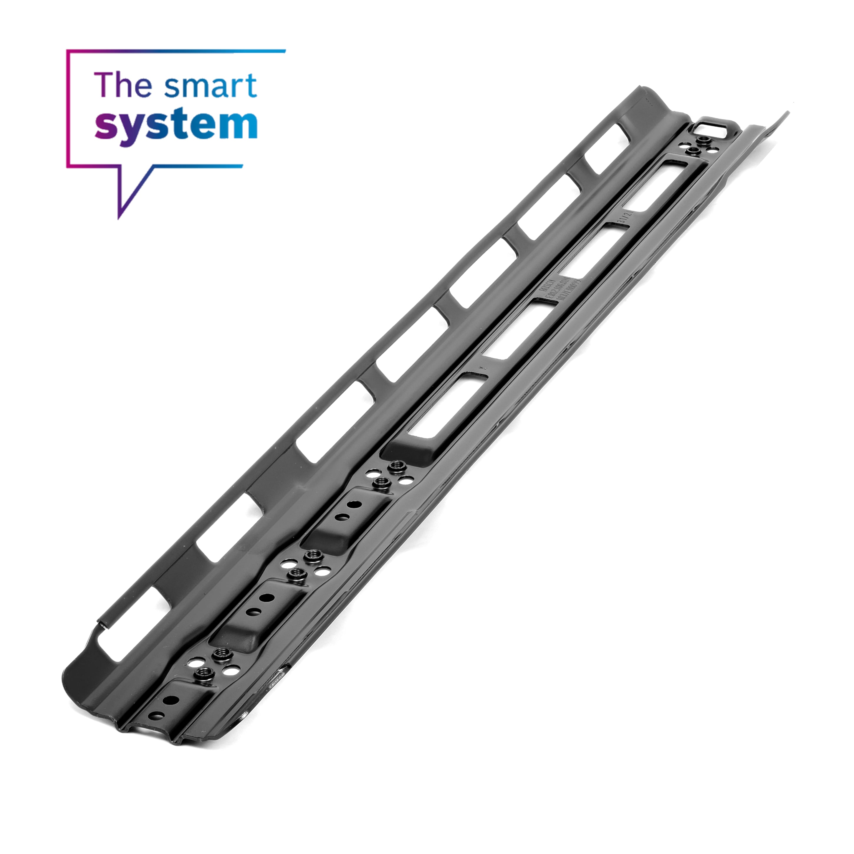

For anyone not familiar with the Bosch Rail as pictured here, the difference between the Rail system and alternatives is that the main battery connection at the top and the capture slot for the latch are both on the steel rail.......and the battery is held captive on the rail with the slots on each side of the battery sliding up the sides of the rail. So provided the top battery connector is firmly bolted to the rail, the battery and rail are in effect one.

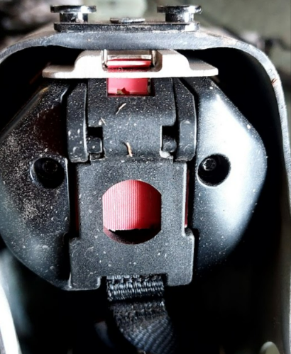

The answer I got from Canyon today was that they are working on a solution. Nothing about a solution already being in place. I was going to order the bike today before the sale ends, but this makes me not to. I will wait and see how this unfolds and hope for another sale during the winter.
FYI, to fix it temporary, I did these updates:
  1. add plastic under the pastic latch (repair the issue if broken lips)
  2. add a thin plastic part under the metal hook (avoiding play, in general)
3 weeks with my bike in warranty service, at this point my bike has more time at warranty service than out in the woods....I've called several times to canyon, always the same answer: it's processing. I had to change my holiday plans in august because the bike was at canyon's, and next week I'm going for 6/7 weeks, I want to bring my bike, but it doesn't look like the bike will be ready, I'm very very frustrated, I would not recommend to anyone buy this bike, Canyon customer service sucks, not to talk about the bad engineering that lead to this battery issue. I know all this negative comments come out of frustration, but hope this helps people to not get frustrated about this by not buying the damn bike, now a days are plenty of option, good options, perhaps better options

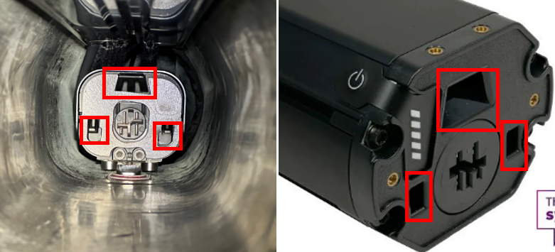

I also think that the main issue is up and down movement. the snugger it sets the less side to side movement it will have as well.
these features keeps it from moving side to side if inserted fully, i think:

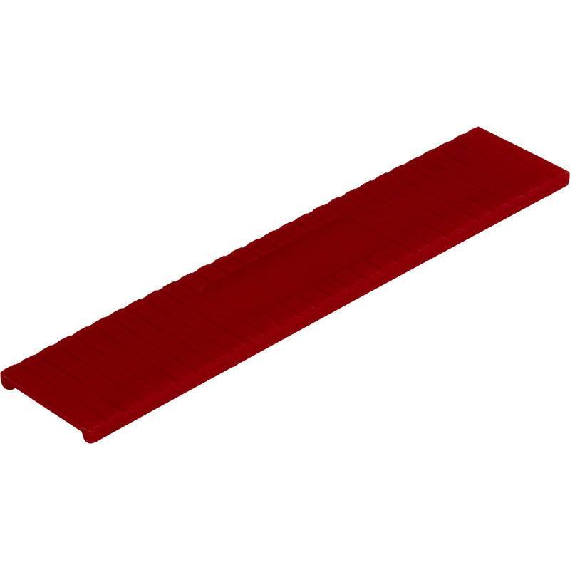

I used 3mm thick plastic part under the latch , something like this:
under the metal clip I cut out the middle of this:
